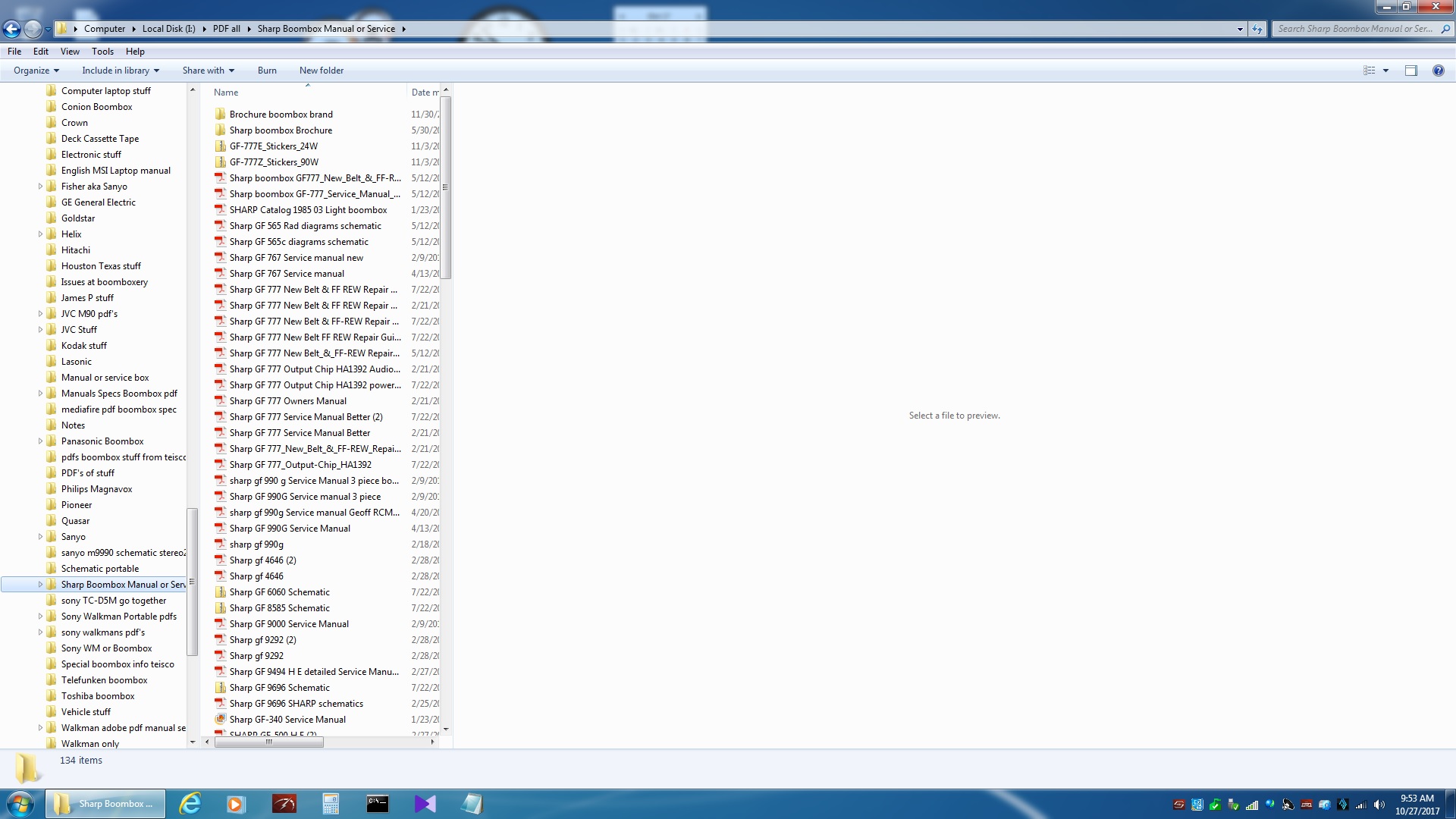

    I only have about 6.5 Gig's of pdf's yes some may be duplicate and here is a screenshot of most of them organized
    27 October 2017 screenshto Sharp boombox pdf
    yes I have info on a few boombox brands

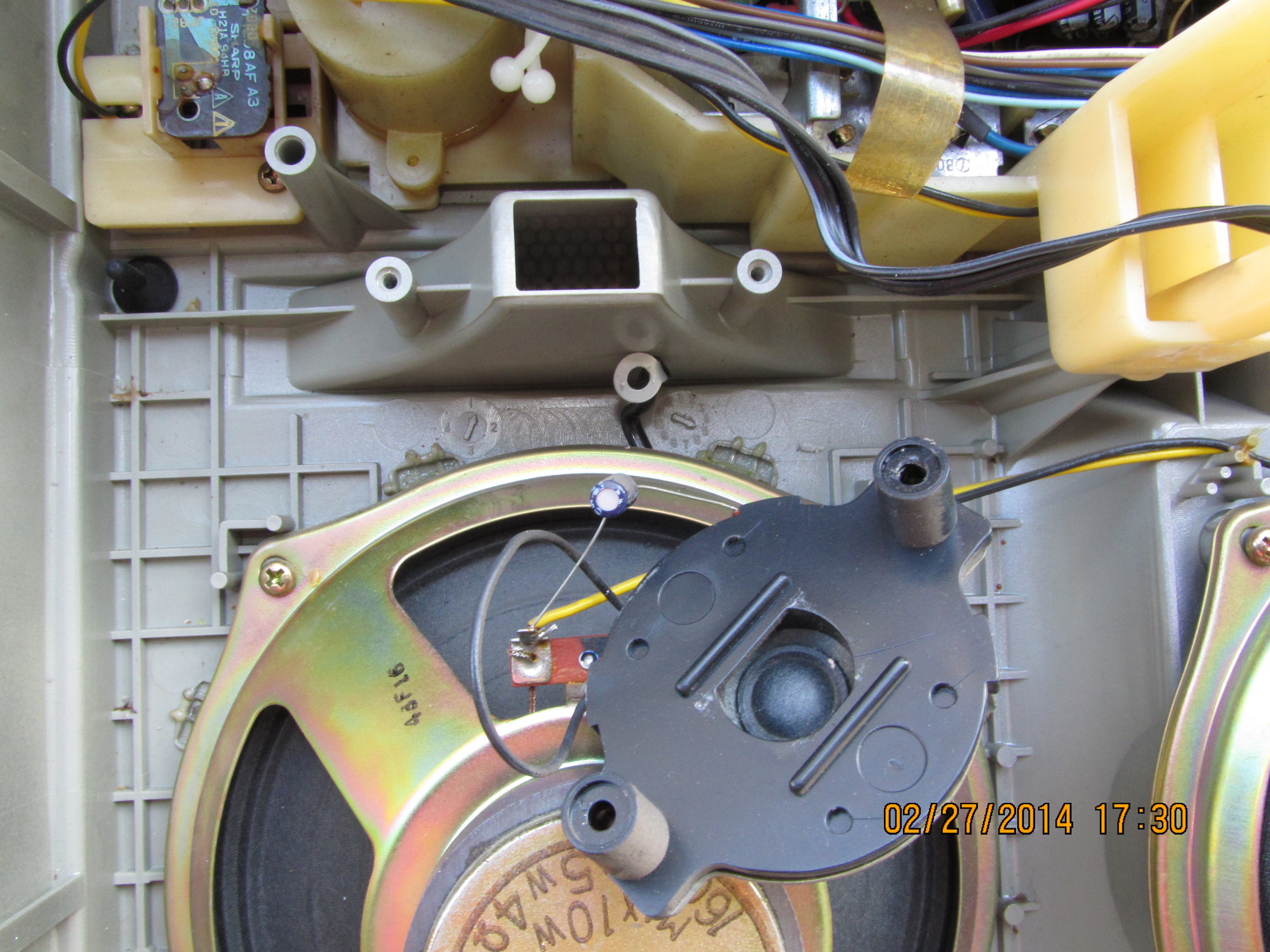

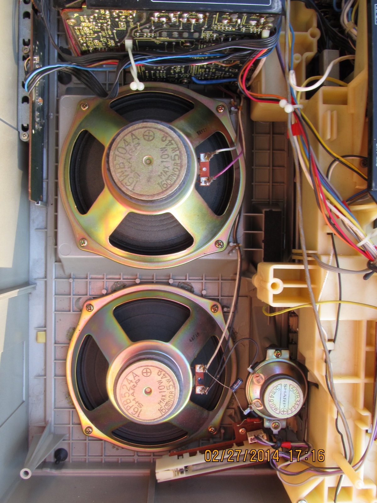

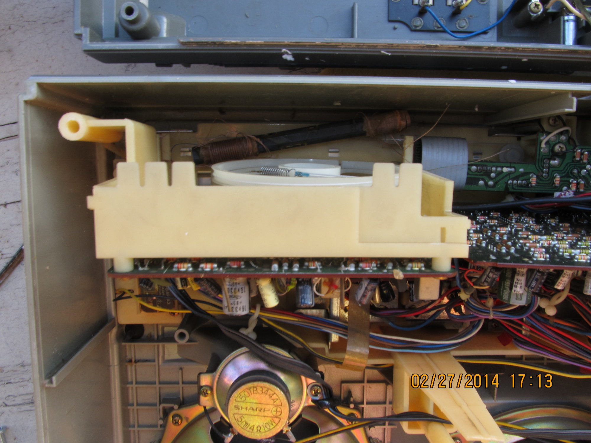

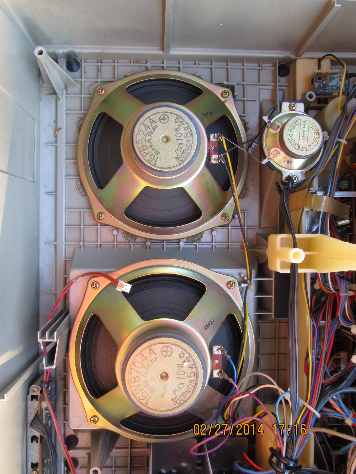

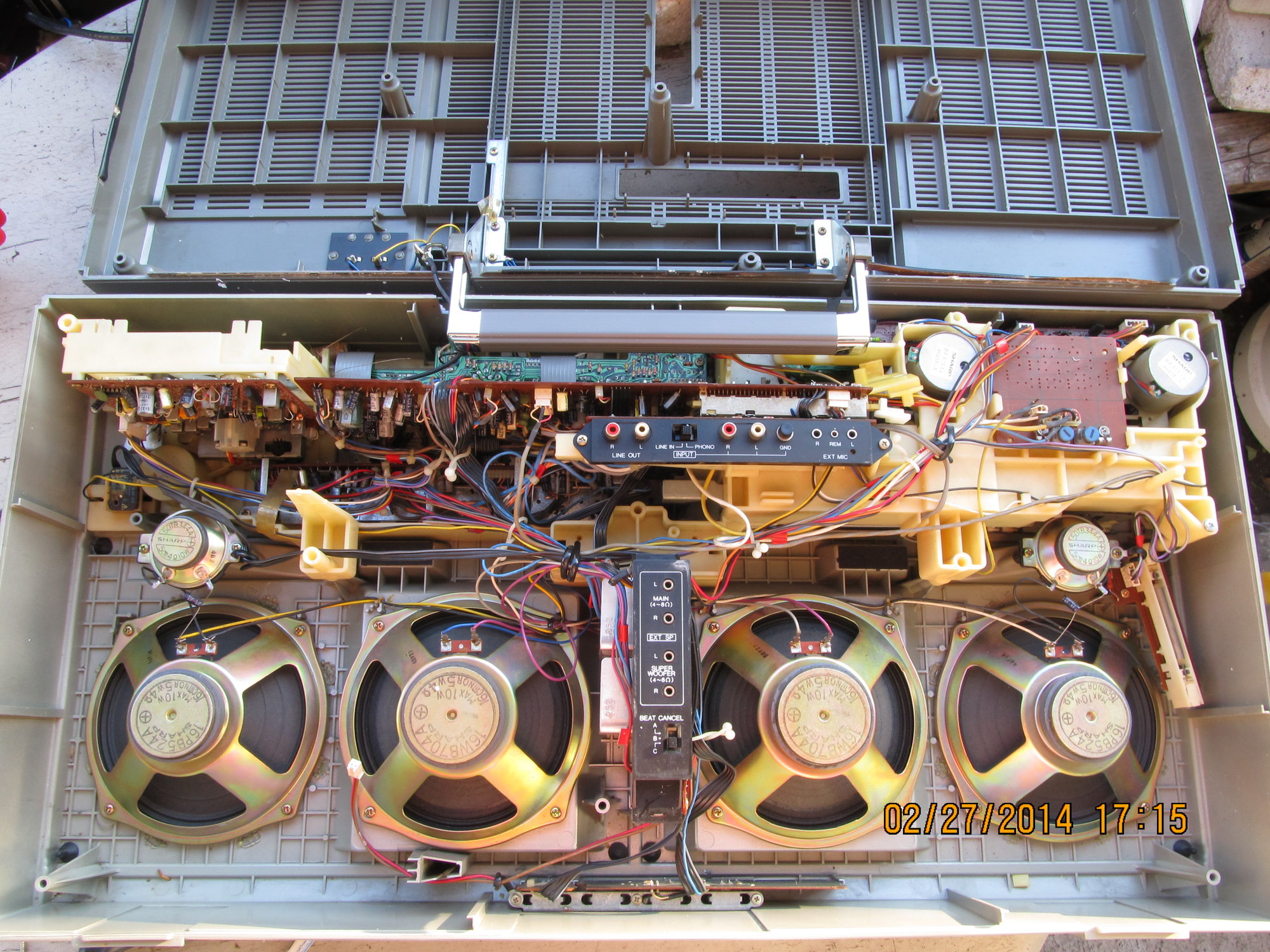

  7. Cassette2go
    500

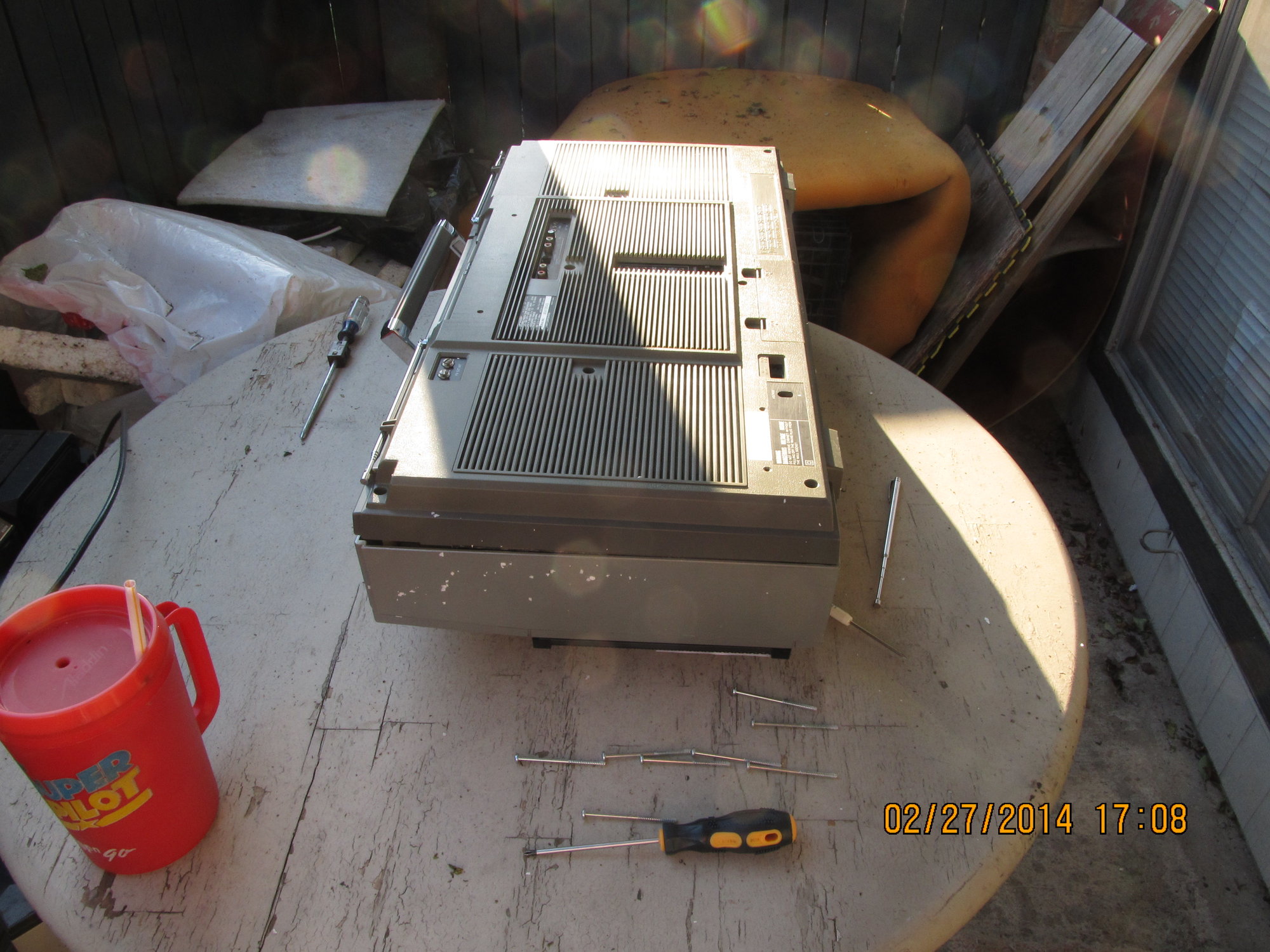

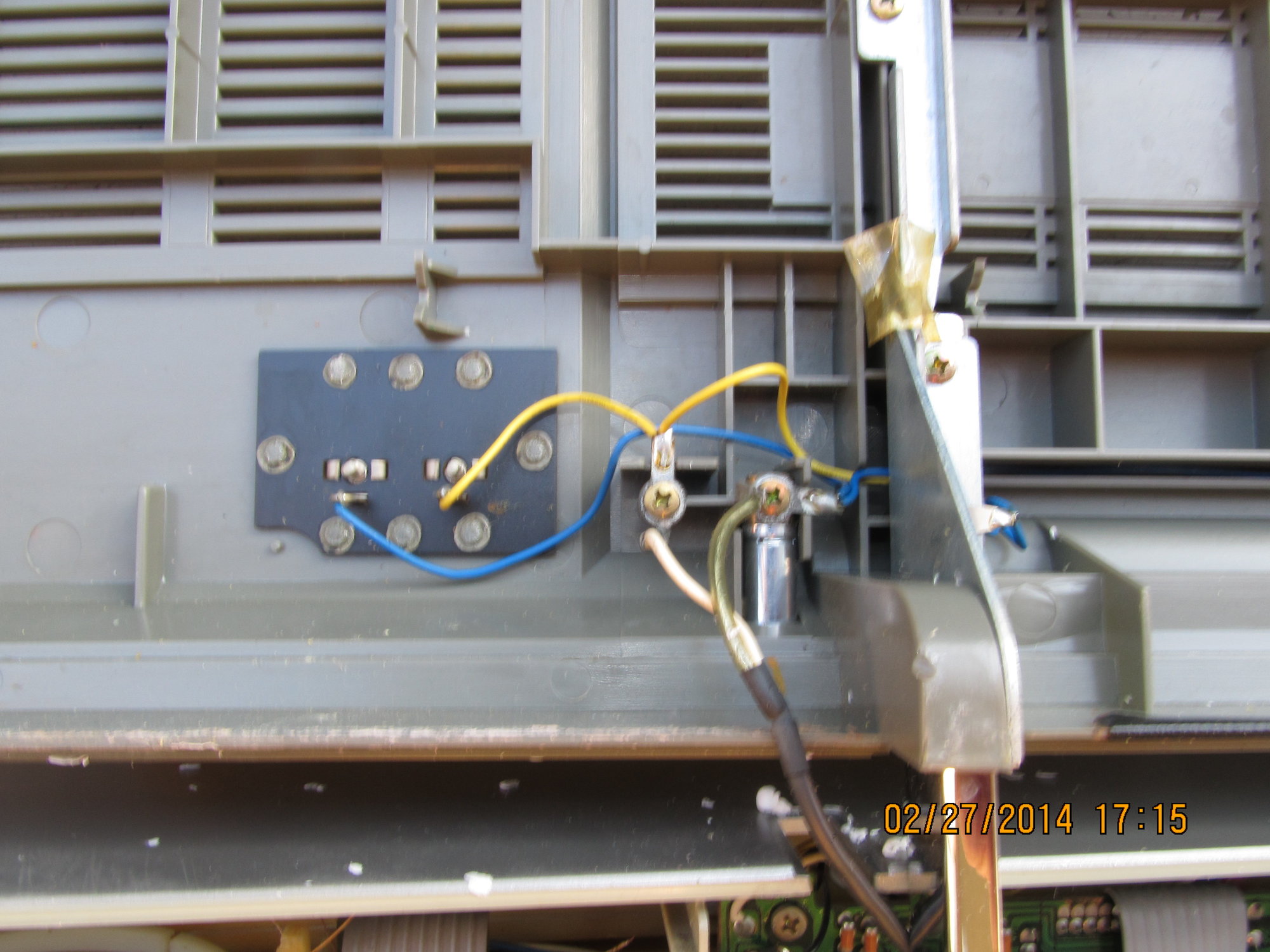

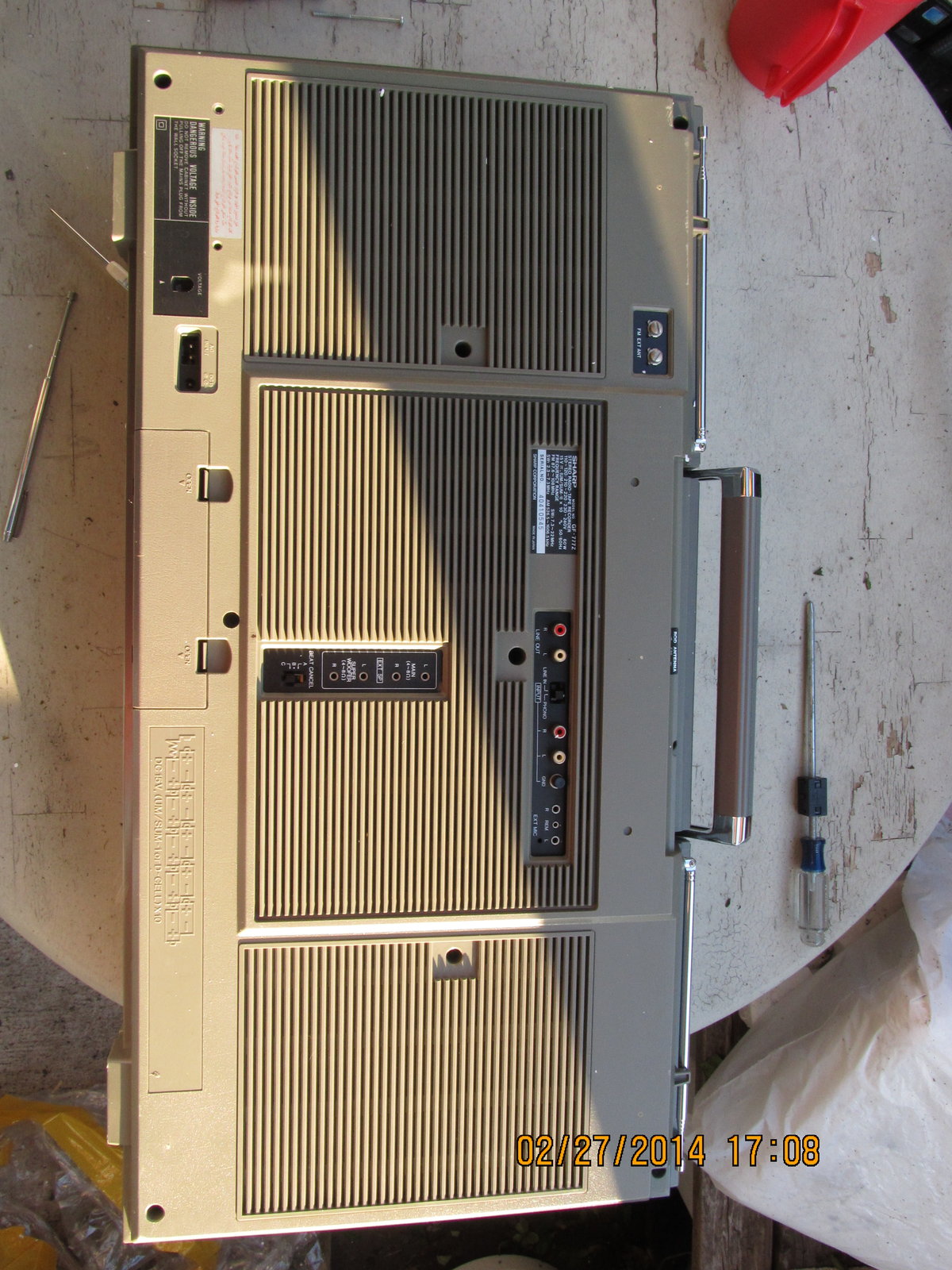

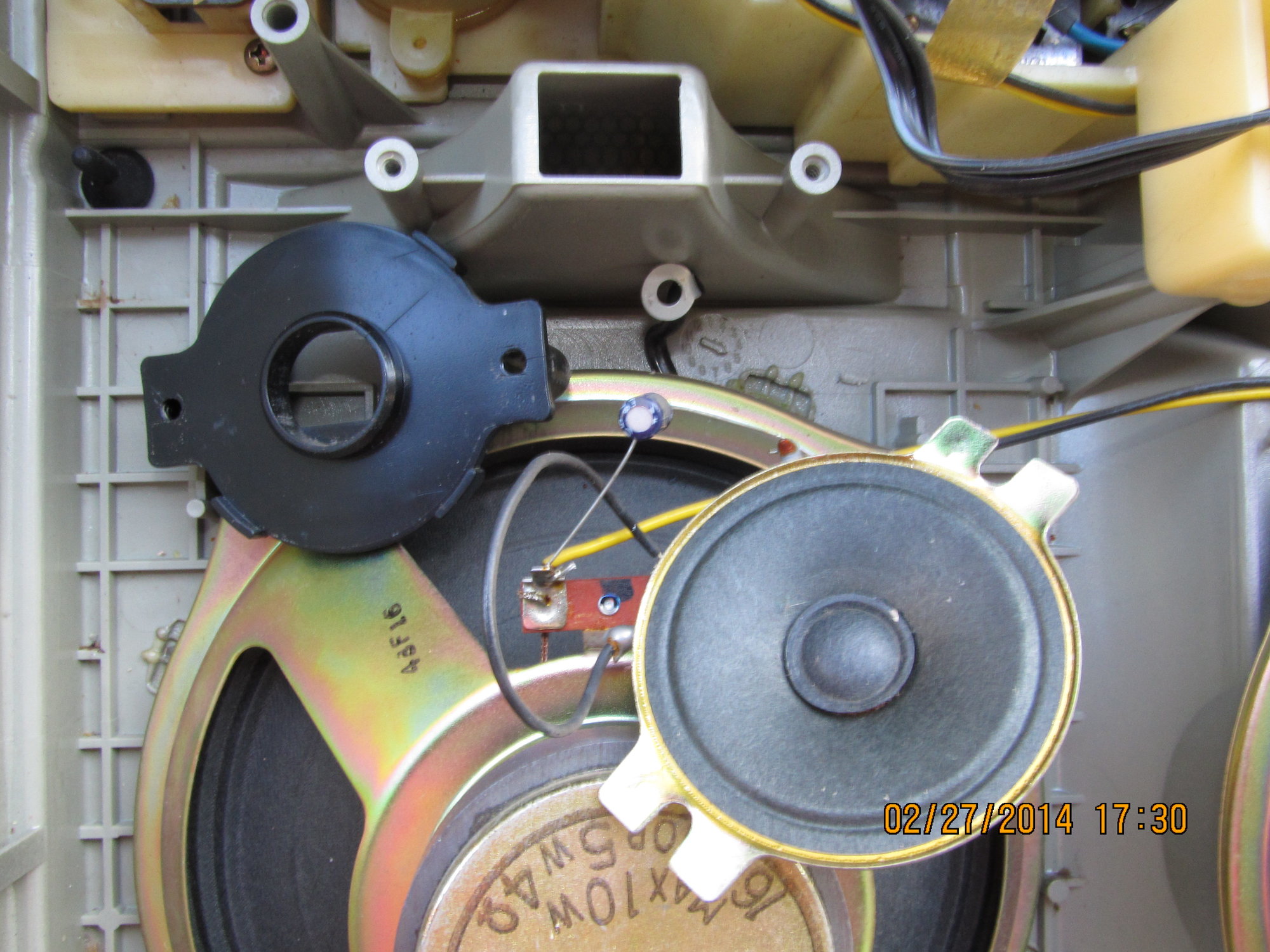

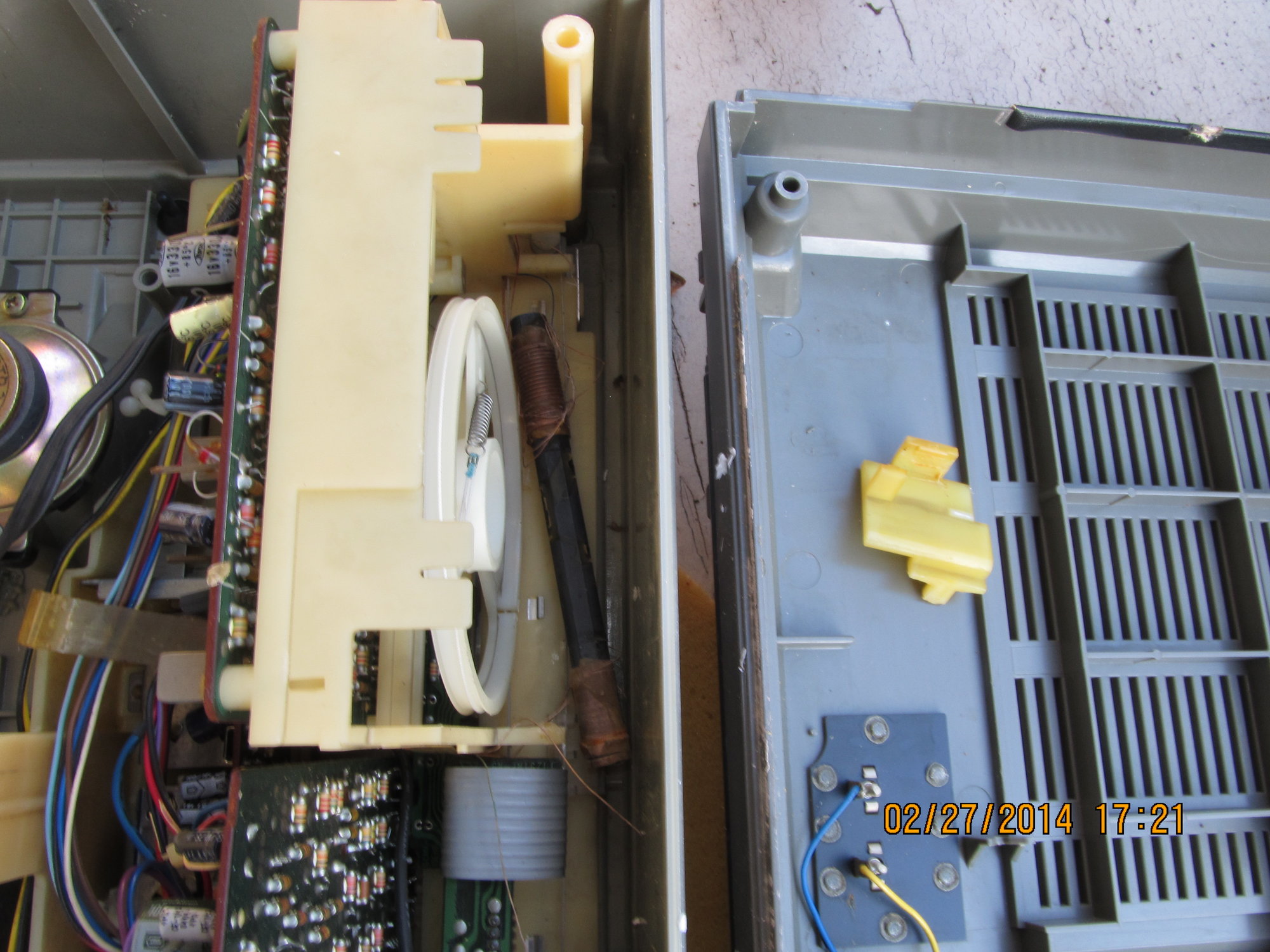

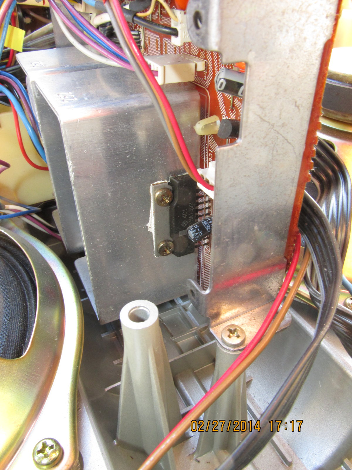

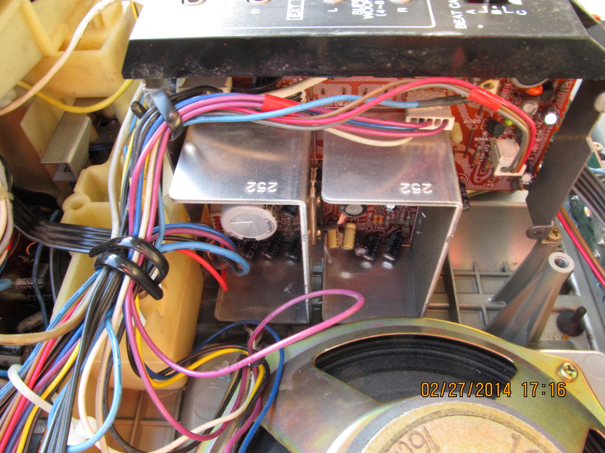

    well I do not have specific pictures of where the bar is at but I do have picture of mine when I was inside mine last and I have opened it 2 different times
    here is the first time
    IMG_2233 Sharp GF-777 27 Febuary 2014 Left end back case.JPG IMG_2234 Sharp GF-777 27 Febuary 2014 back case.JPG IMG_2236 Sharp GF-777 27 Febuary 2014 Antenna fail from shipping.JPG IMG_2237 fm antenna detail Sharp GF-777 27 Febuary 2014 Inside back case.JPG IMG_2238 Sharp GF-777 27 Febuary 2014 Inside back case.JPG IMG_2239 Right Sharp GF-777 27 Febuary 2014 Inside back case.JPG IMG_2240 Left Sharp GF-777 27 Febuary 2014 Inside back case.JPG IMG_2241 Amplifier Sharp GF-777 27 Febuary 2014 Inside back case.JPG IMG_2242 Chip ampflier Sharp GF-777 27 Febuary 2014 Inside back case.JPG IMG_2245 AM Antenna Sharp GF-777 27 Febuary 2014 Inside back case.JPG IMG_2246 Tweeter Sharp GF-777 27 Febuary 2014 Inside back case.JPG IMG_2247 Face tweeter Sharp GF-777 27 Febuary 2014 Inside back case.JPG
    thid and Longman like this.
