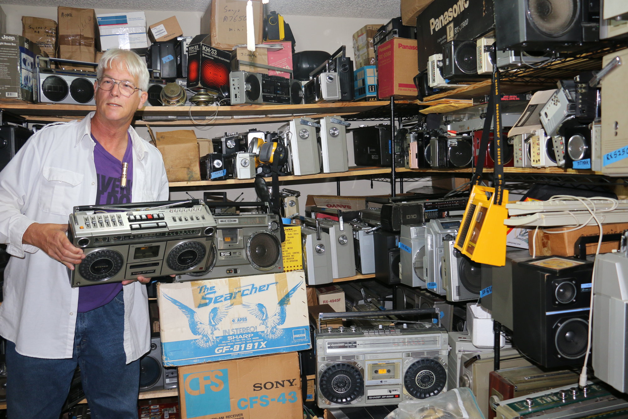

  7. Cassette2go
    500
    I just like to know which model this is as these Older sharp model's are similar in facial appearances, that I just like to see this model and I think I have the correct one that I am holding. IMG_0236 James holding posted Sharp GF-9090 Wow and flutter 12 July 2017.JPG another ( this thread needs a picture of the model in discussion where there was not one before ) Camera canon EOS 70D 12 July 2017

  8. Atomtan
    Atomtan New Member
    12
    Leicester, UK
    Yes, that's essentially the same as mine except I have the different grills.
    Quite a room you have there...........
