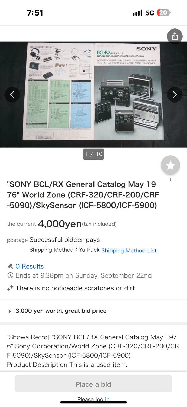

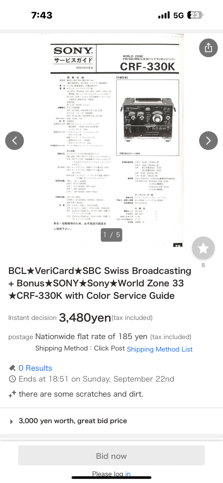

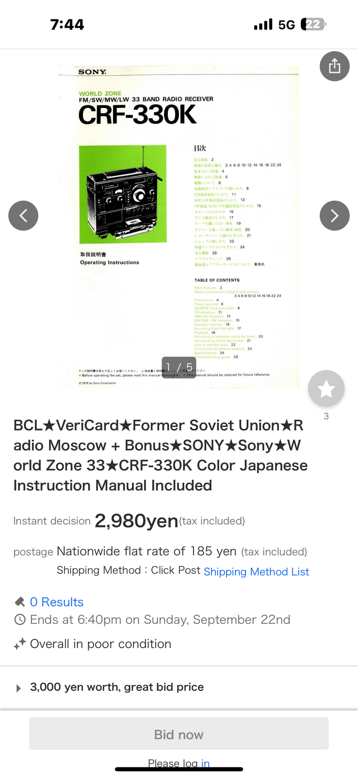

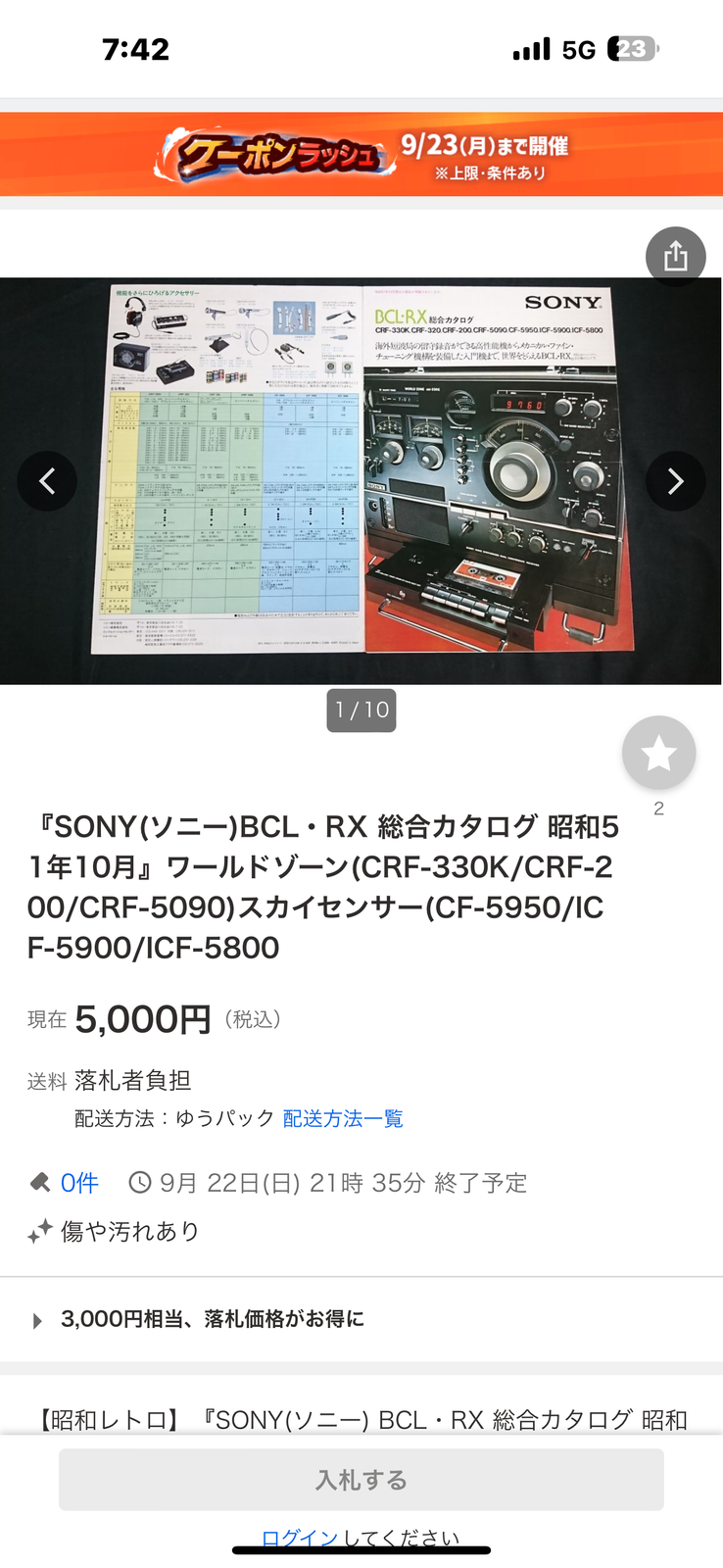

    having another Problem I’ve been trying to Order (4) items off of Yahoojapan & PayPal said no Asian Purchases at all. So is there a way around this? My Bank also said no Asian Purchase they said Mastercard has a block on all Asian Nations. And they won’t use Ebay. So is there any way around this? I needed the Complete Capacitor kit for this Radio & only Australia had it & my Bank gave me 24 hours to Purchase the kit they unblocked Australia but the Purchase had to be Quick & fast. My God I only want 4 printed items from Japan & my Bank said Mastercard are the ones & also PayPal are also saying no way!! Does anyone have know a way around this so I can purchase these?
