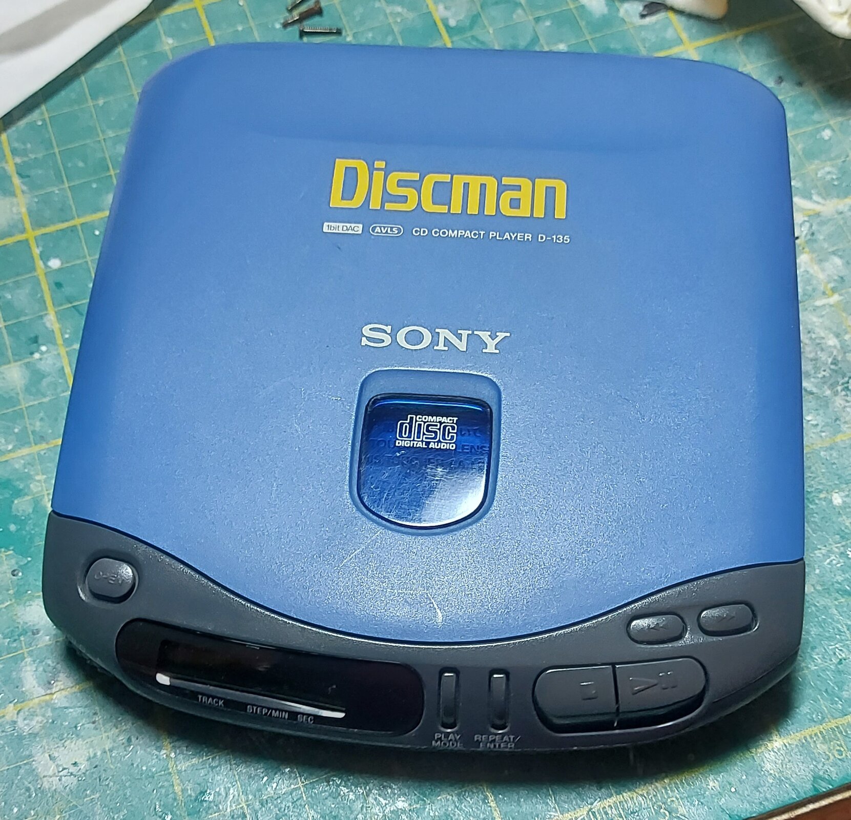

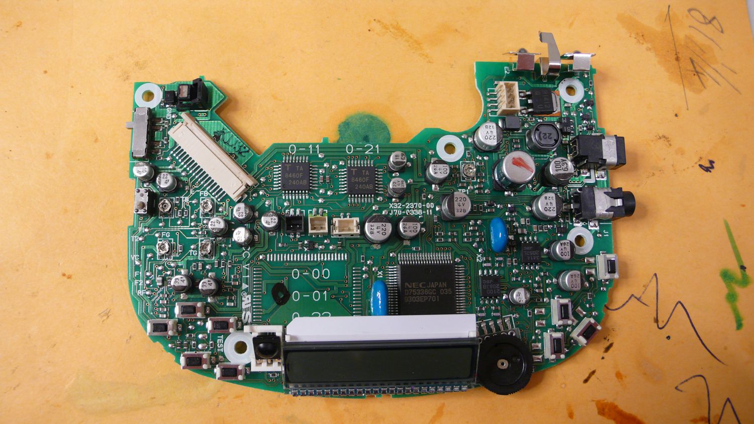

    Hi, I've recently purchased a junk lot of Sony Discmans and the two that work the most have the same problem. When I'm playing my CD's the music is a bit distorted and the lyrics are barely audible. Both of them work otherwise fine and have no problem reading the discs. I've looked at the boards but they have no visible capacitor leakage or bulging. Any sort of help would be greatly appreciated. Thanks

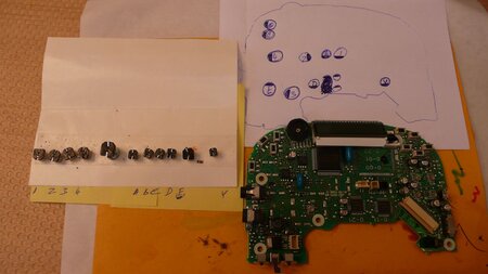

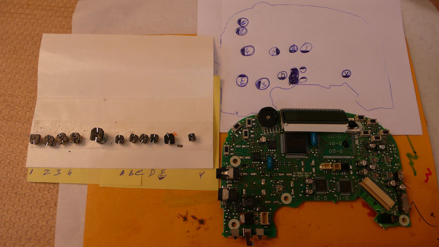

    mainboard of a similar Discman, Kenwood DPC-531, looks pretty good:
    But - all capacitors are Dead or Seriously Bad when tested for capacitance and ESR:
    Set of new caps cost more than resale value of such Discmans, hopefully your Sonys have different problem. Like bad jacks/solder joints, missing Ground, etc

    So I've replaced all the through hole and the 2 big smd capacitors on my D-135 and the sound quality is a bit better but I've noticed that when I play at low volume it sounds how it should but if I turn the volume up it starts to distord.
