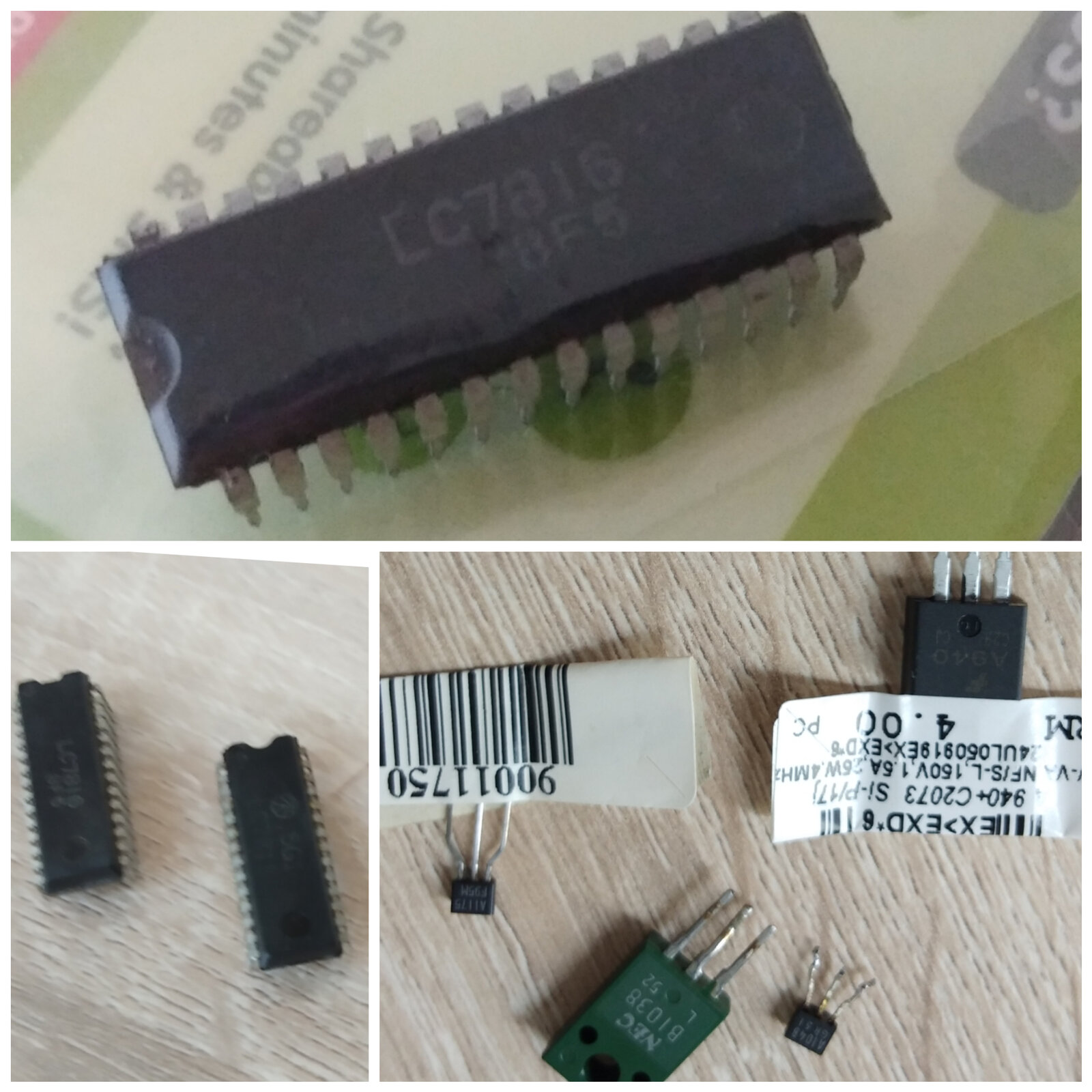

    Upon diagnostic , found many parts start failing one after another. IC chips and power supply components among some of the parts being replaced during troubleshooting.
    The schematic diagram which I downloaded online helps me a lot in tracing the problems..
    Replace the dual input op-amp also. IC is cooked resulting the left side output is garbled and low sound.
    Touching up the speaker too..

    After restoring the amplifier section, next is to look into the tuner. Lucky though there is not much problem except replacing the lithium battery for radio station memory retention.
    Replacement of push button switches with high contact resistance..
