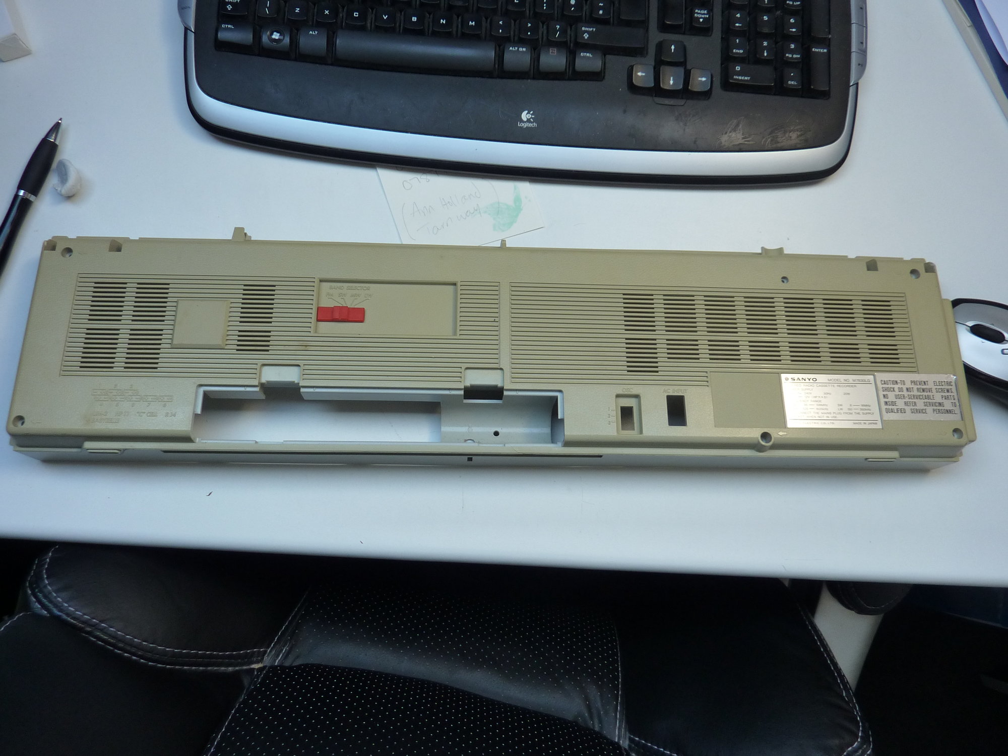

    you could retro bright the yellowing plastic....i did on a ps-f5 couple of years ago....i have also done it on boxes with good results P1040277.JPG P1040273.JPG

    Retro Bright is good stuff .

    you dont buy it you make it....lots of different peaople do it differently......above all the most important ingredient is sunshine...
    this is what i do 1 cup full of this
    http://www.ebay.co.uk/itm/TRUZONE-C...104a26b3aa0b1988802053&pid=100506&rk=1&rkt=1&
    1 spoon of this
    http://www.ebay.co.uk/itm/Vanish-Cr...562318&hash=item23887ef8b5:g:JsgAAOSwbiFZXjwz
    Mix it together and apply with a small paint brush and then put it out in the SUN......ALL day if you can
    no sunny.. no worky
    some people add glycerine to thicken it up but i never use it......then wash off at the end of the day
