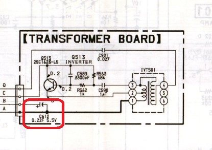

    I repaired both TCD-D7 and TCD-D8 and I remember there was a supercapacitor, not a battery for the clock power. The service manual confirms it, it's on the board that has the backlight inverter on it.
    Never bothered to check that capacitor, but it is possible that these go bad (although unlikely). 0.22F should keep the clock powered for a significant amount of time (the 60 min stated in the first post seems reasonable).

    If indeed time is lost, it means you need to replace the supercapacitor with a new one.
    The slight buzzing noise is from the backlight inverter. Recommend not to keep the light on for longer than a couple of seconds, because the backlight transformer is a common problem on these devices and it's impossible to find a replacement.

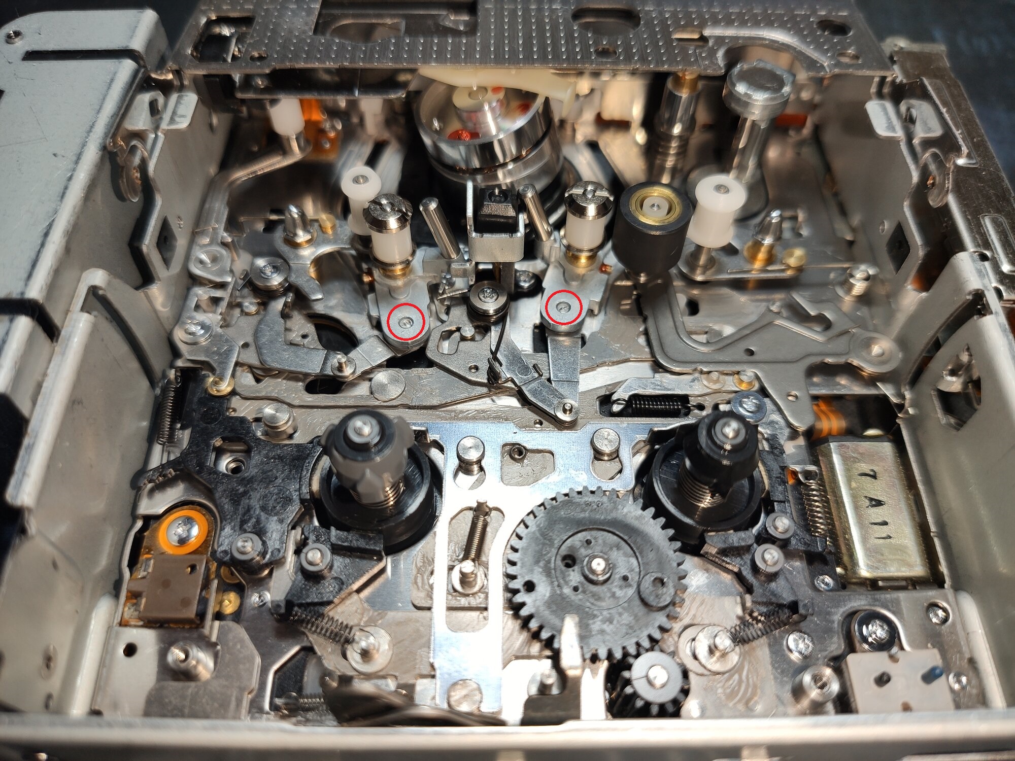

    Something that should be checked on these are the loading guides mounting points (circled in red in the picture). These often fall out partially or completely and need to be glued back.

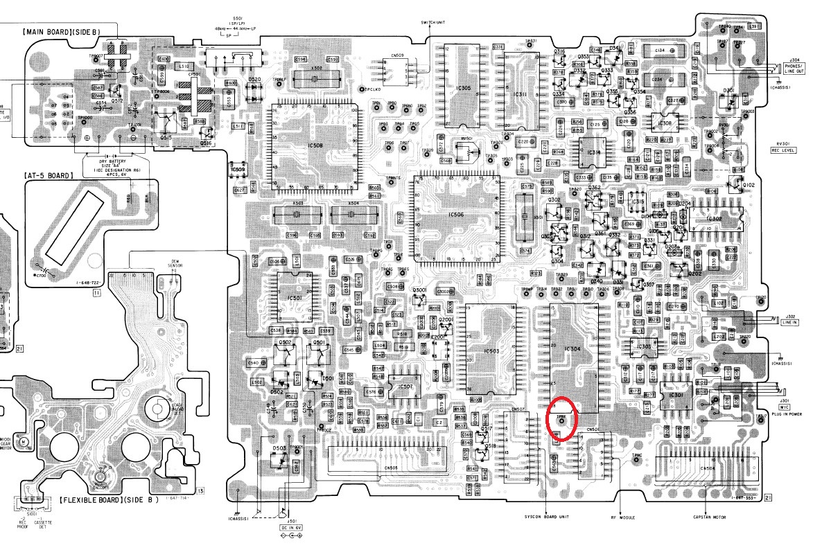

    Try to record a tape on the D8. If the tape recorded on itself plays ok, then you either have a tape path misalignent or a DPG adjustement issue (which I do not recommend trying to adjust).
    You need a scope to adjust the tape path: RF output is marked TPRF on the board, picture attached. Triggering is done directly on the RF signal on this unit, as it has a pulse at the beginning of RF.
    You need to adjust so the RF waveform if flat: if it's low on the leading edge, you need to adjust the entry guide (left); if it's low on the trailing edge you need to adjust the exit guide (right).
    The cover needs to be removed to perform this adjustment, but needs to remain connected to the main PCB.

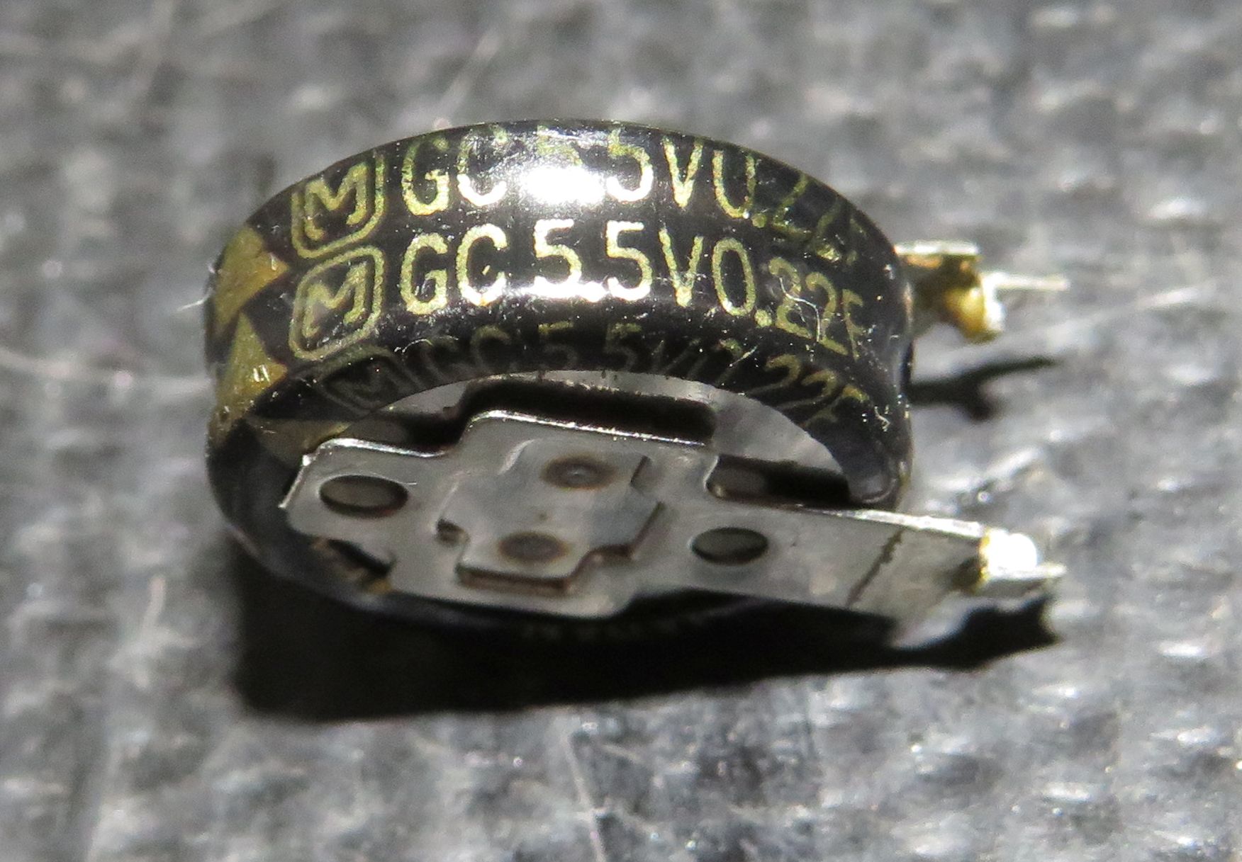

    The dimensions of the super-capacitor battery C-612 are 11.4mm diameter 4.45mm thickness , 16mm total length with the pins The arrows indicate the negative terminal (on the back side in this picture)
    The transformer board has a + indication. Easiest way to change it is to first unsolder the positive battery pack leg.
