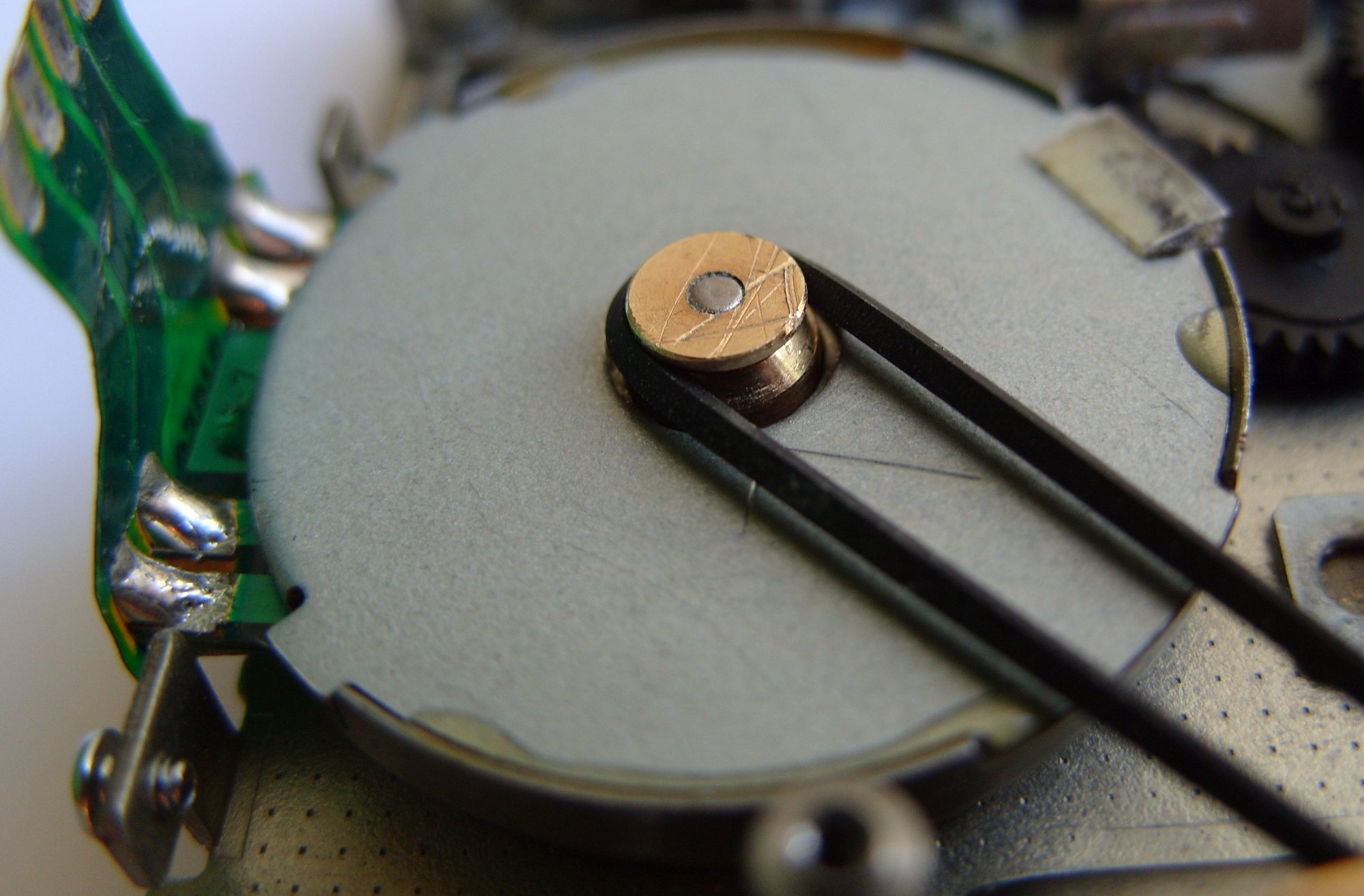

    S1050109.JPG S1050110.JPG Hello,
    I bought a Sony Walkman WM-F2097 because I like these old models.

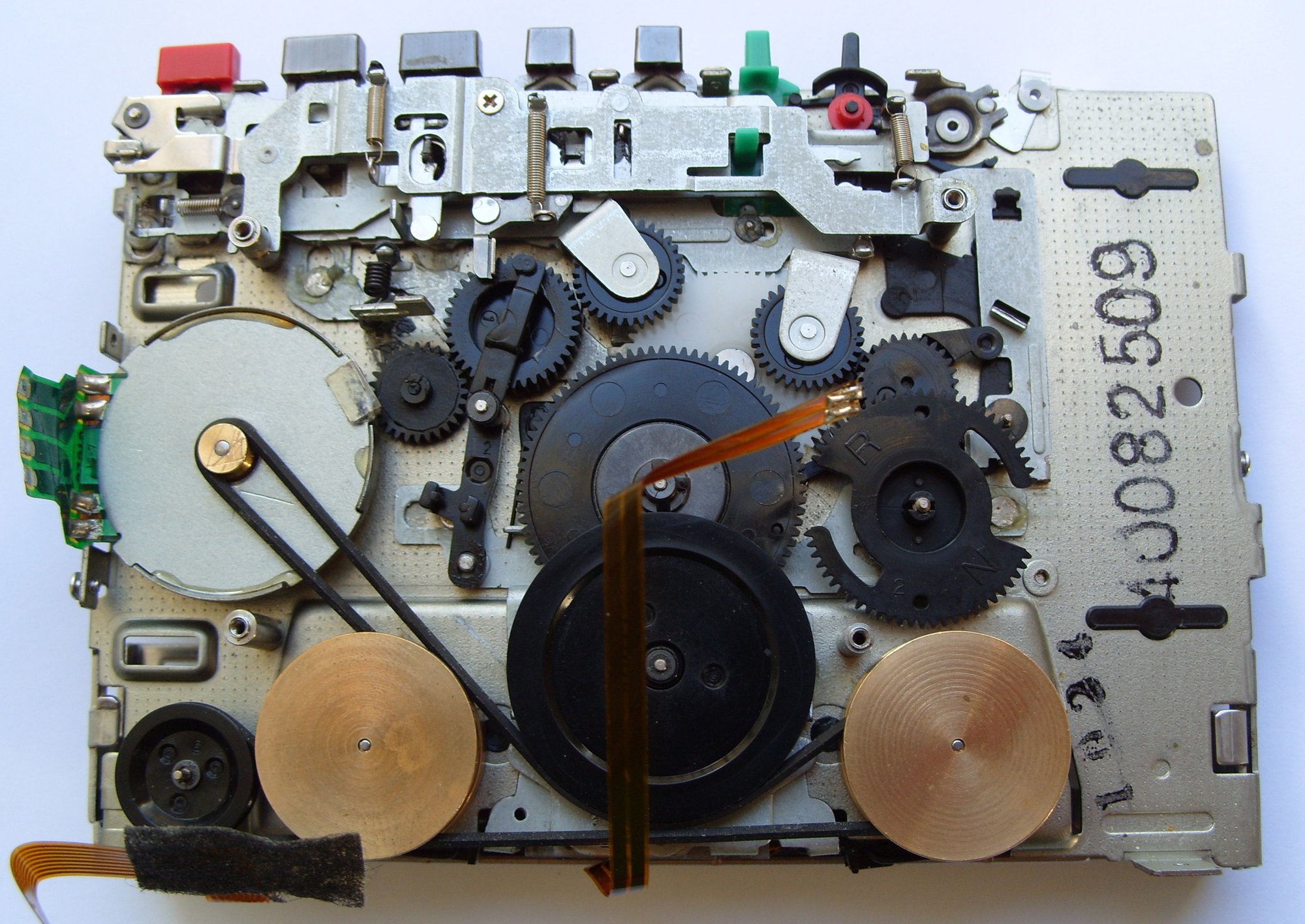

    Without even trying it I started to take it apart to change the belt and after arriving at the mechanics (which is not easy) soon I noticed that the motor shaft was very difficult to turn with fingers.
    I had to use pliers to start turning the motor shaft slowly!
    Thinking that it could be partially blocked by belt debris I dipped it 3 times in a liquid rubber degreasing solution, and I got a big improvement.
    But the motor shaft still does not turn completely free, but it is still partially not free to turn.
    Now I ask the question:
    May be that in this specific type of motor it is "normal" that the motor shaft does not rotate completely free?
    Is there anyone in this forum who noticed the same anomaly?
    Thank you

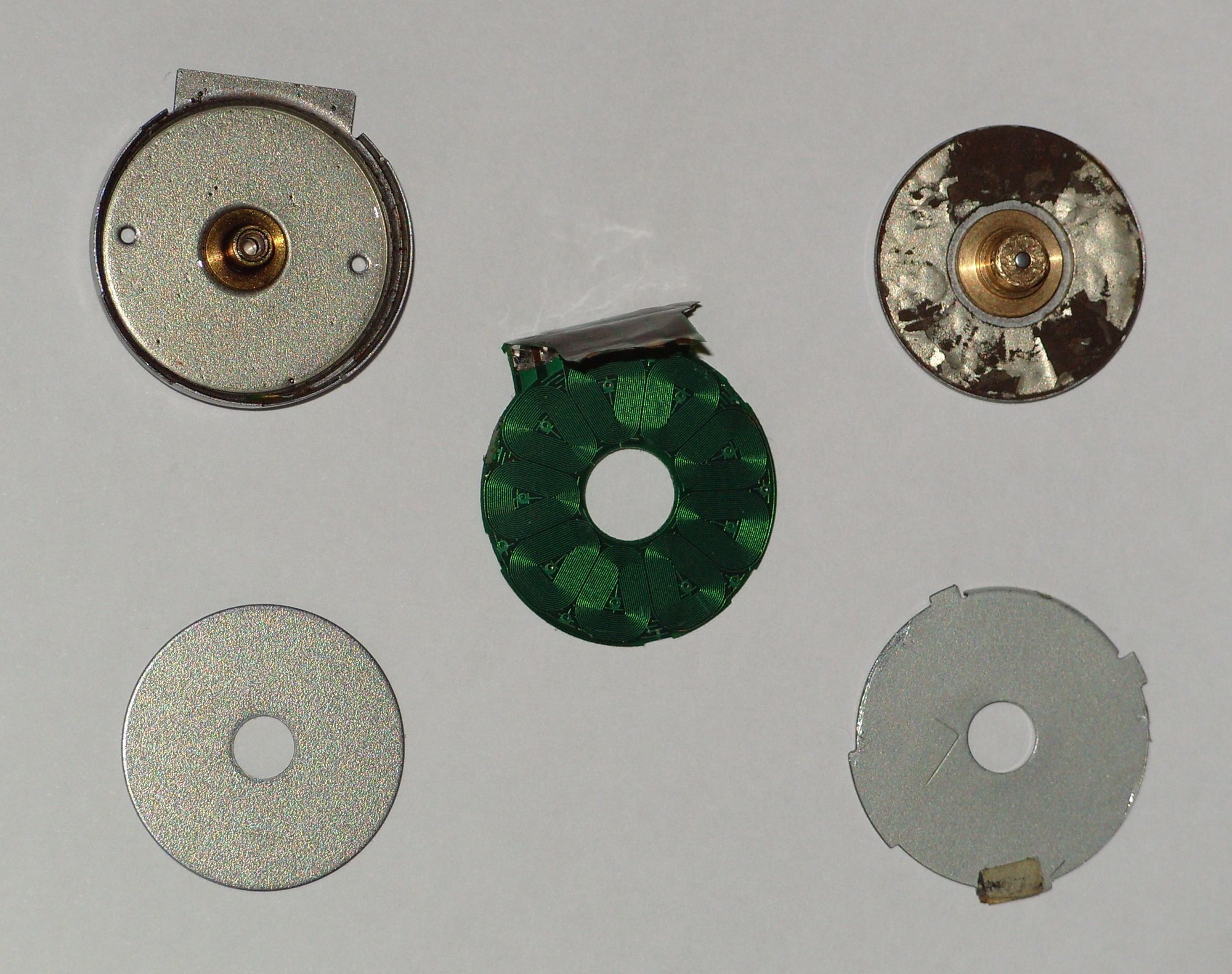

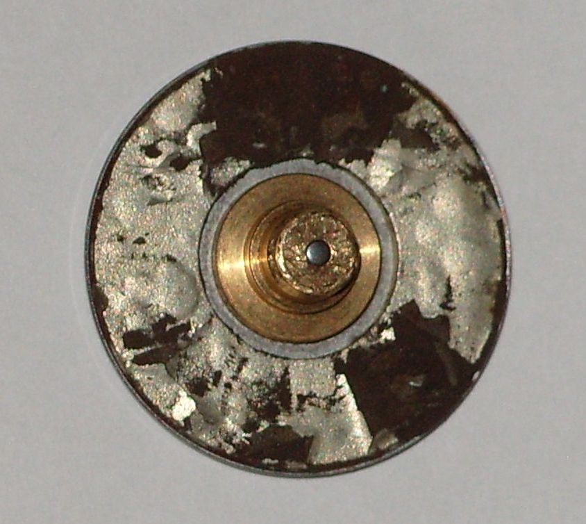

    Hi to all,
    I disassembled the motor to be sure about the real situation and effectively there are not chances to repair it.
    Like you can see in the photos, the motor magnet is very degraded.
    The WM-F2097 need a new motor.
