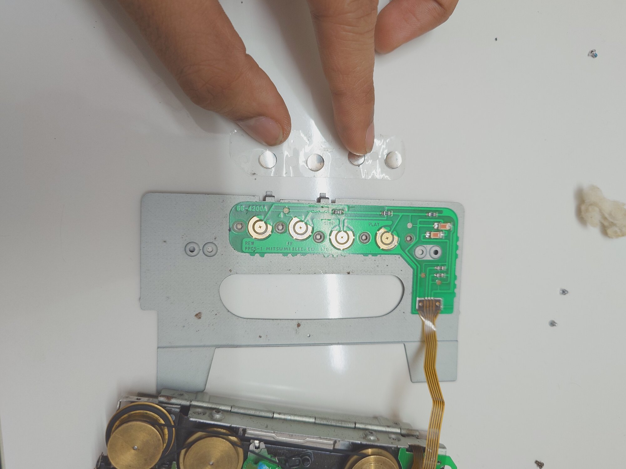

    Hello all, I recently acquired a non-functioning DX100. It powers up briefly for few seconds and doesn't respond to any buttons on front door. I cleaned the beneath of the buttons with IPA.

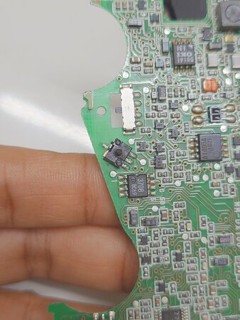

    Hi @Valentin , regret to inform that I have unfortunately broken the flex cable connecting the side switches while inspecting the device. Also, there was a green LED light when the unit powered up for initial few seconds. (Refer red circles in attached image). The gear with black/reflective patten is rotating for a second.
    I have also cleaned the buttons completely on the front door.
    Not sure how to move ahead from here. fixing the flex cable is really tough job.
  5. Valentin
    1,572
    The LED is voltage reference for the DC-DC converter.
    To eliminate tape detct swtich as a potential culprit, you need to make S903 - 1 permanently closed (base of Q706 pulled to GND via R723).
    And as stated before would check the photo detector.
    As far as the flex cable goes, you'll have to fix it, don't think you will find a replacement for that unless you design and manufacture one yourself.
