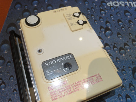

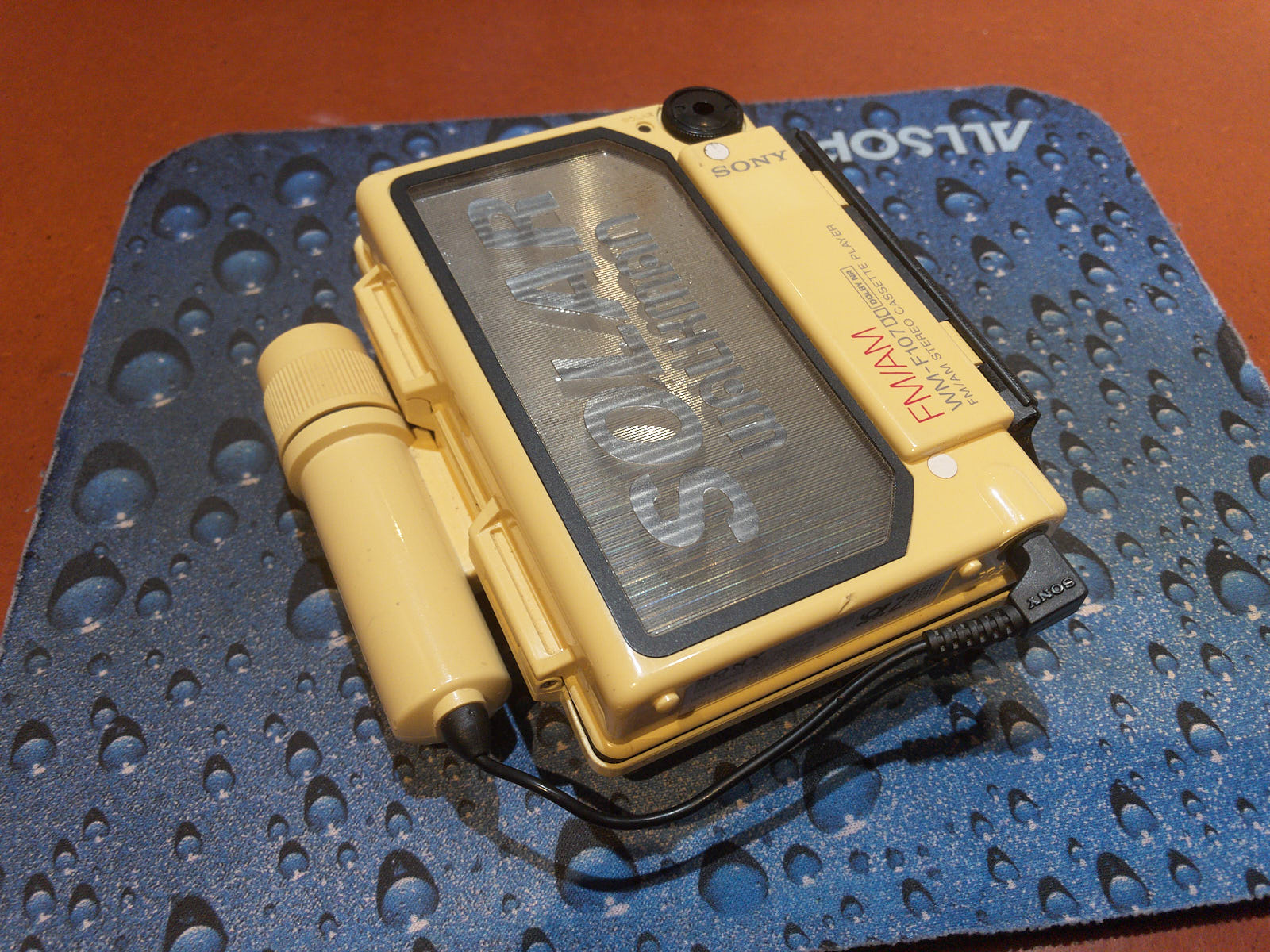

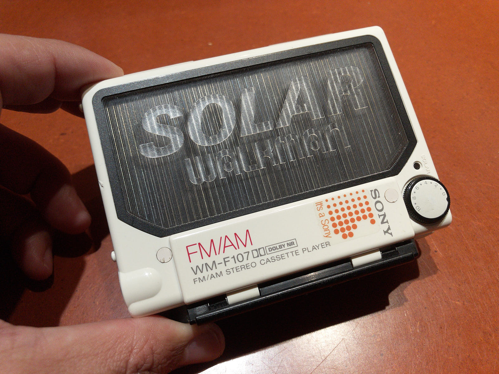

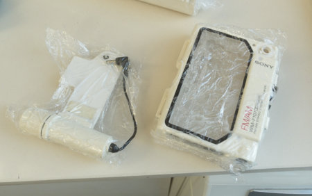

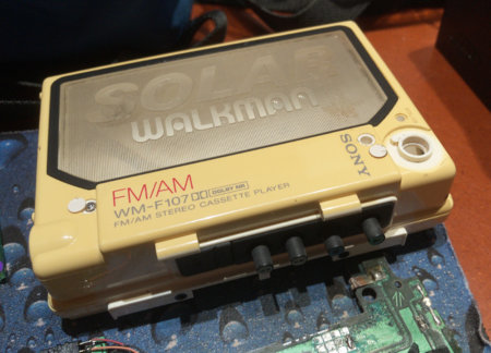

    I don't use to restore my stuff (I take it to a tech) but with this walkman I felt I can do it and encouraged to start. It has been a long process but the result is very good I think.

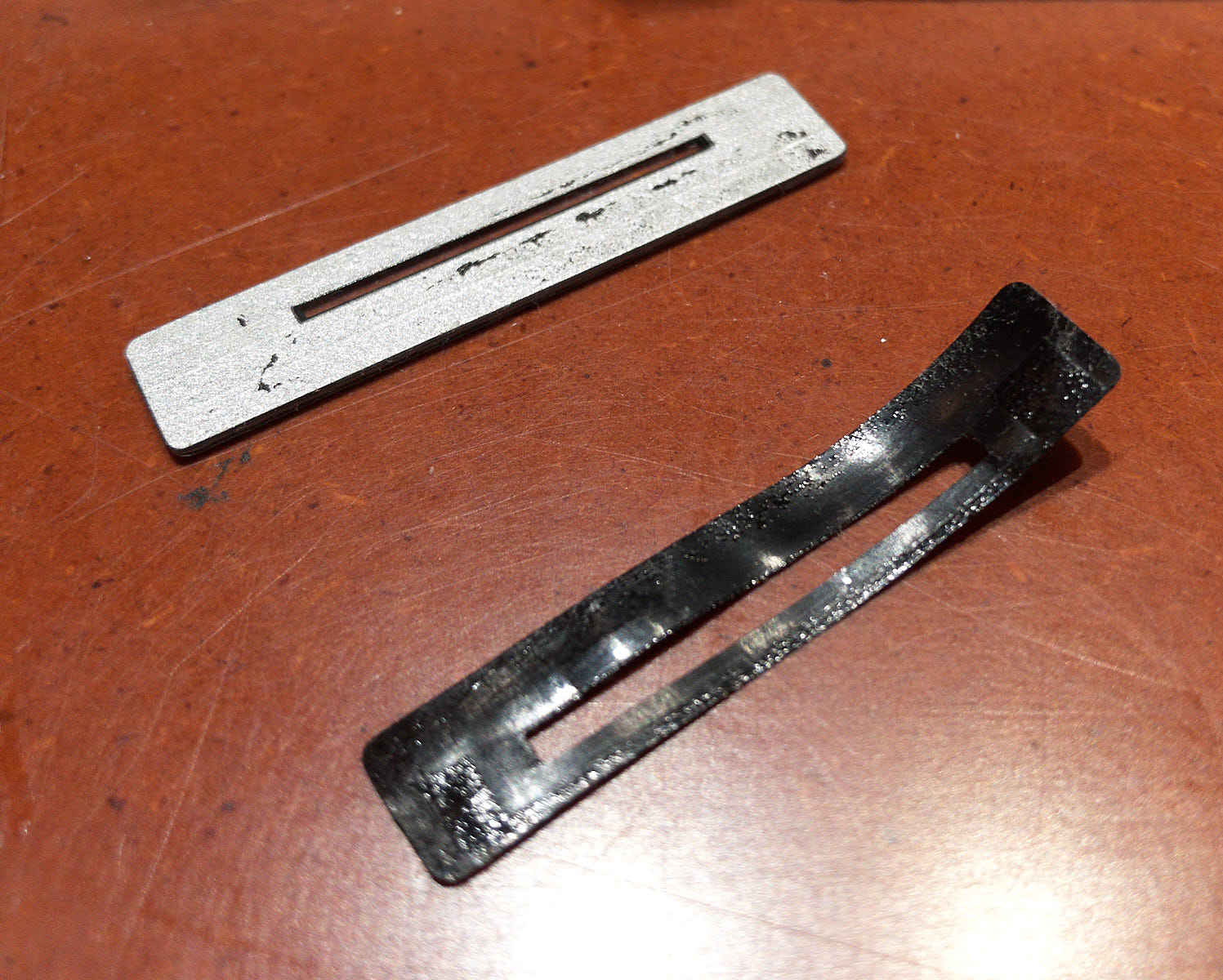

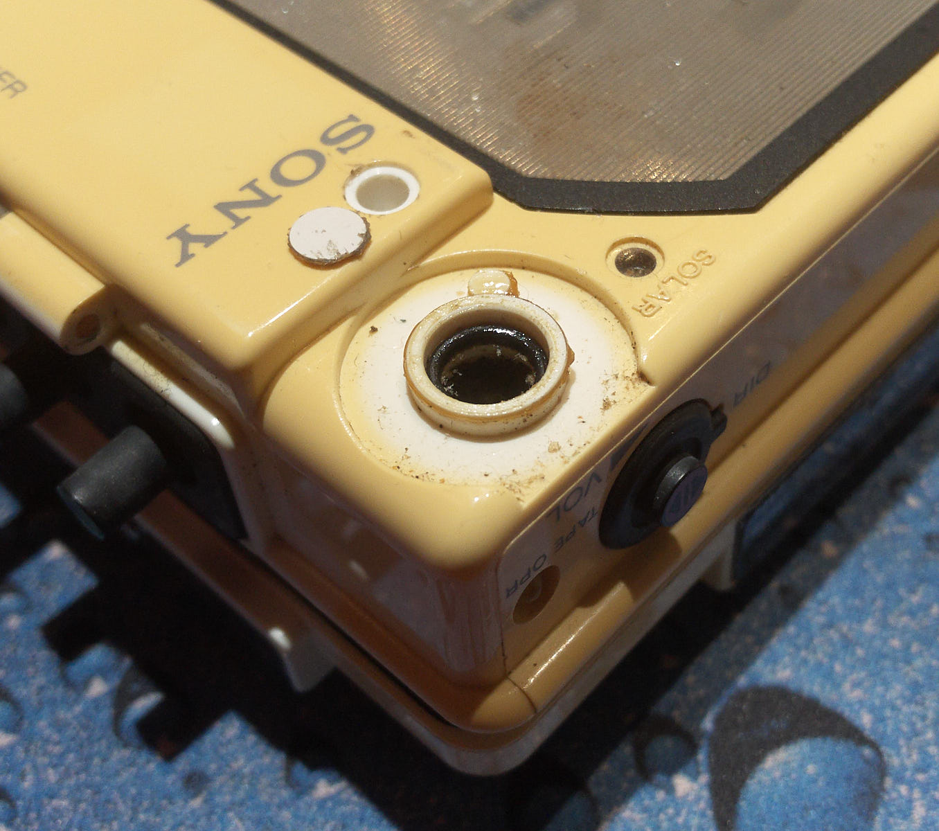

    The unit is in very good overall condition, but it's seriously yellowed (it's really a white unit) and the cover of the radio knob is missing.

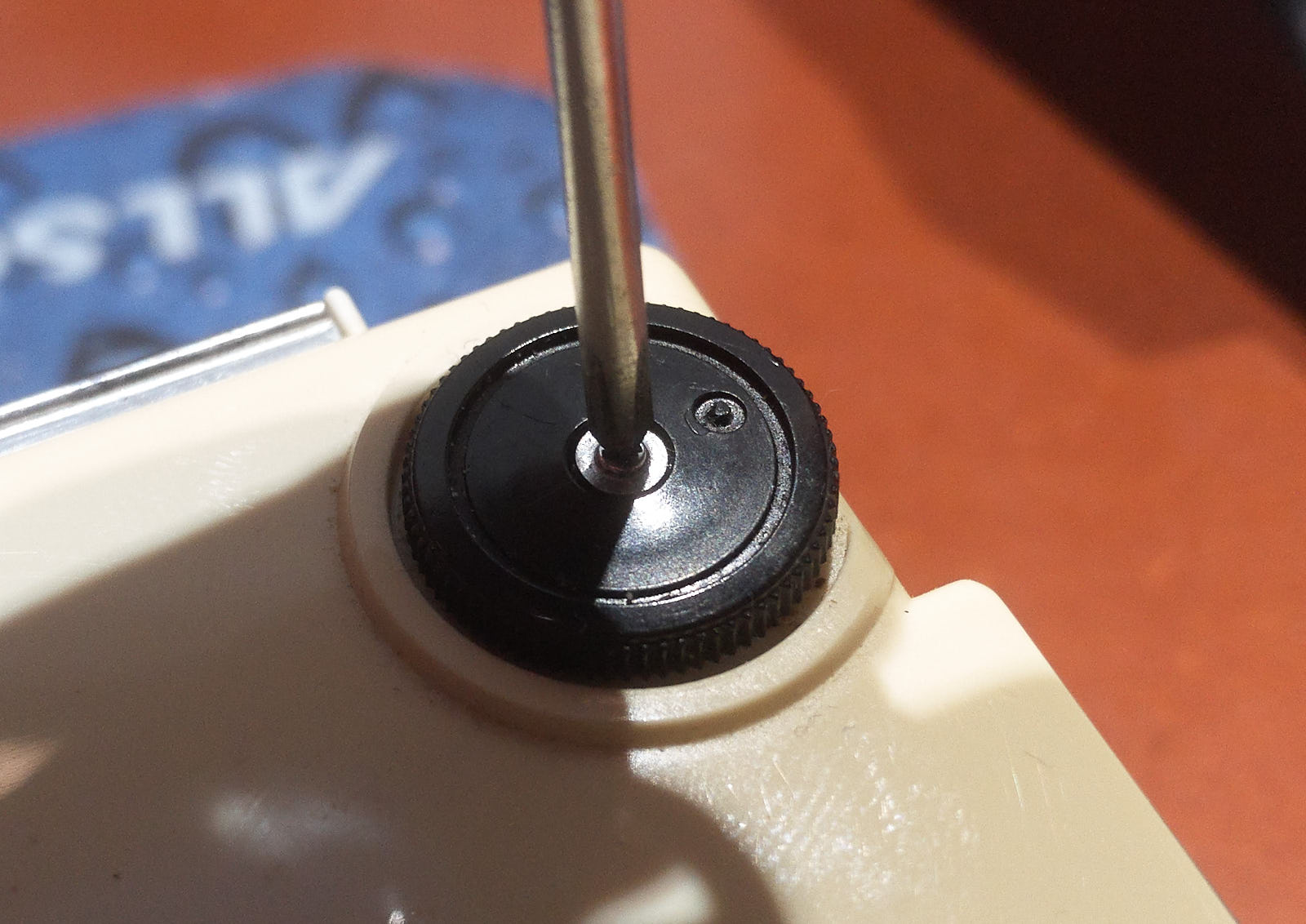

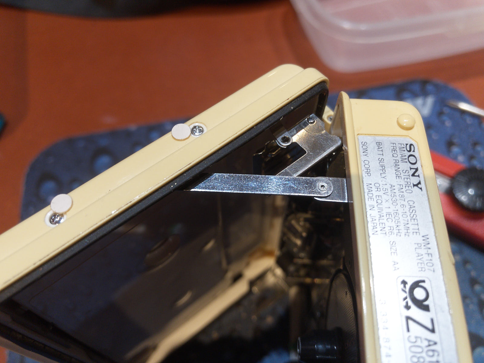

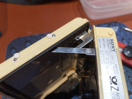

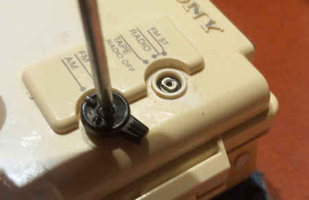

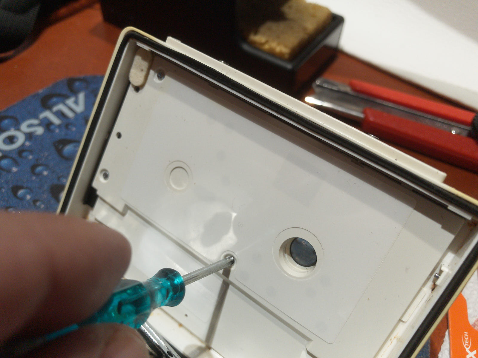

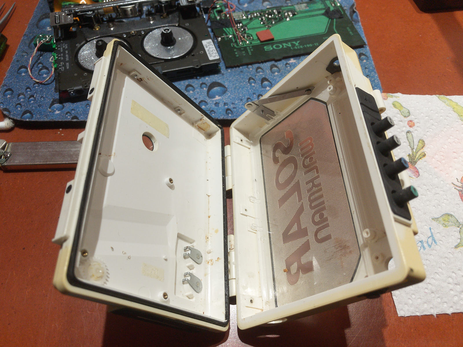

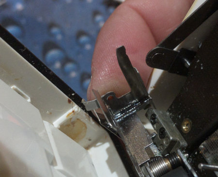

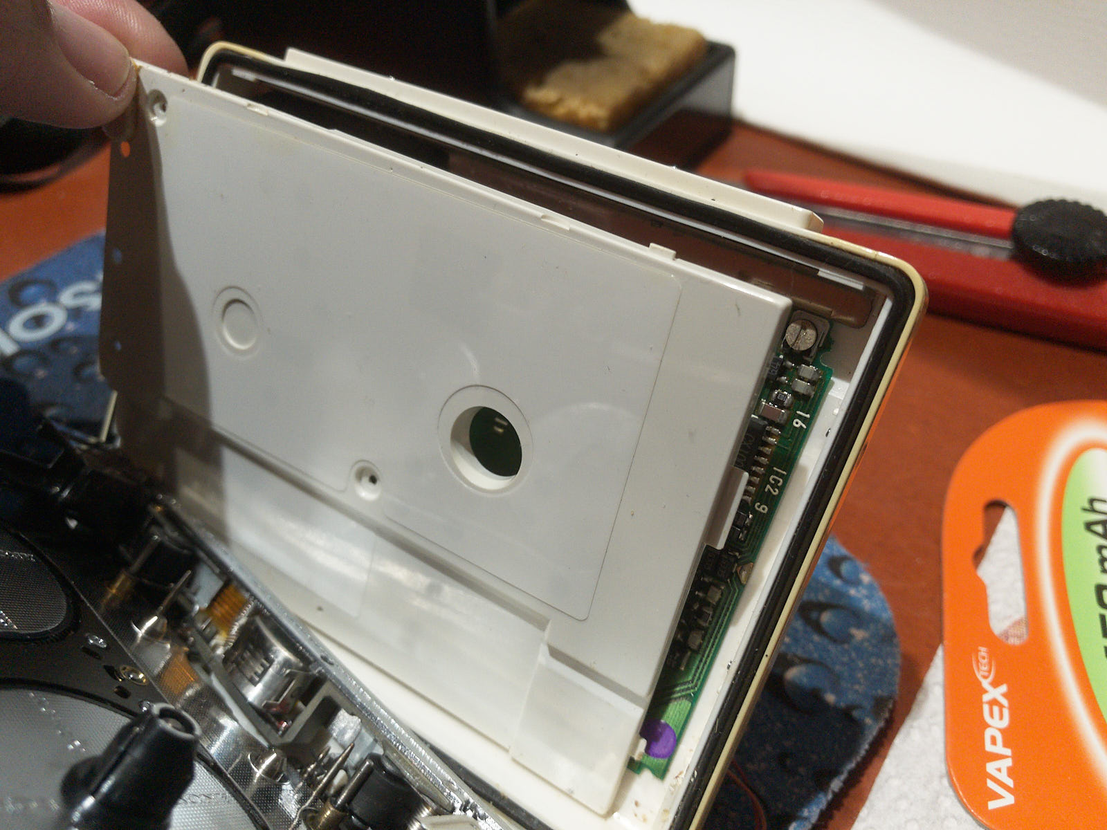

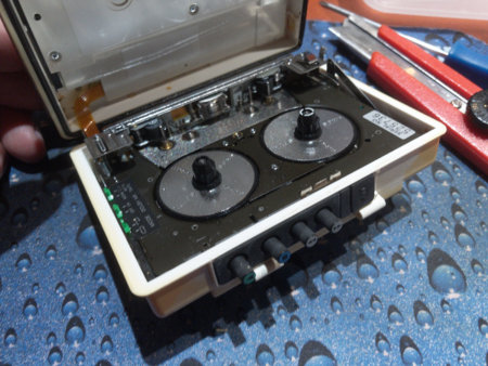

    First, uncover the screws of the shell and unscrew them to open the door:

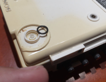

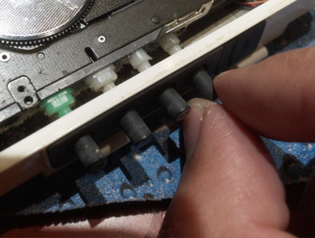

    Remove the volume knob. It's dirty inside.

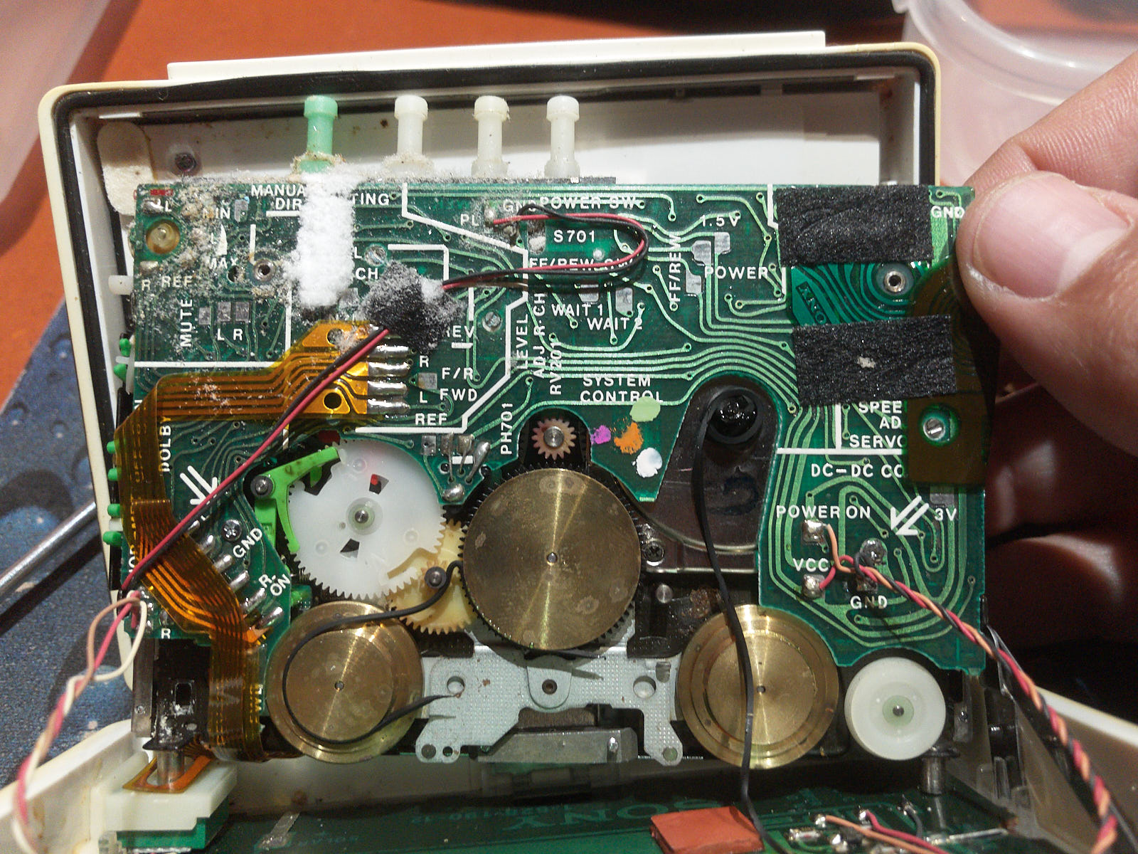

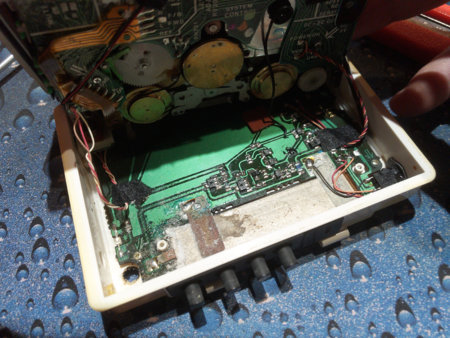

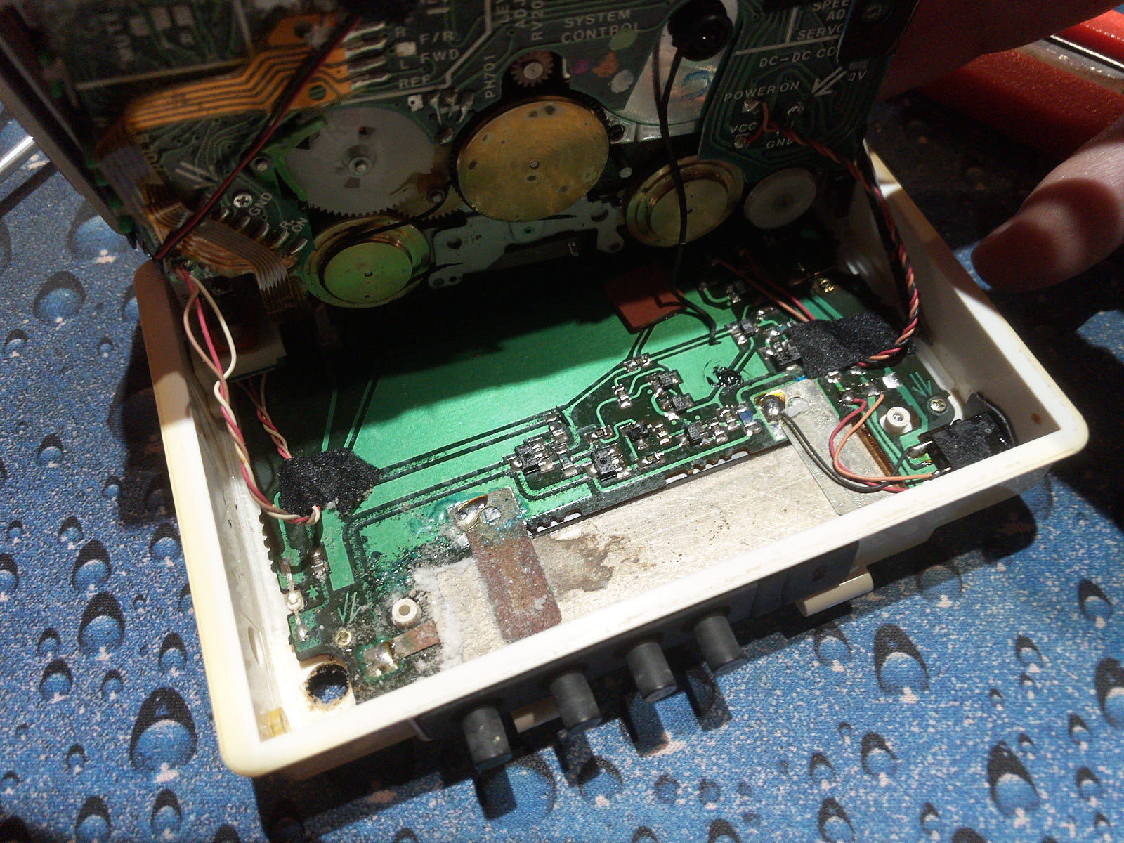

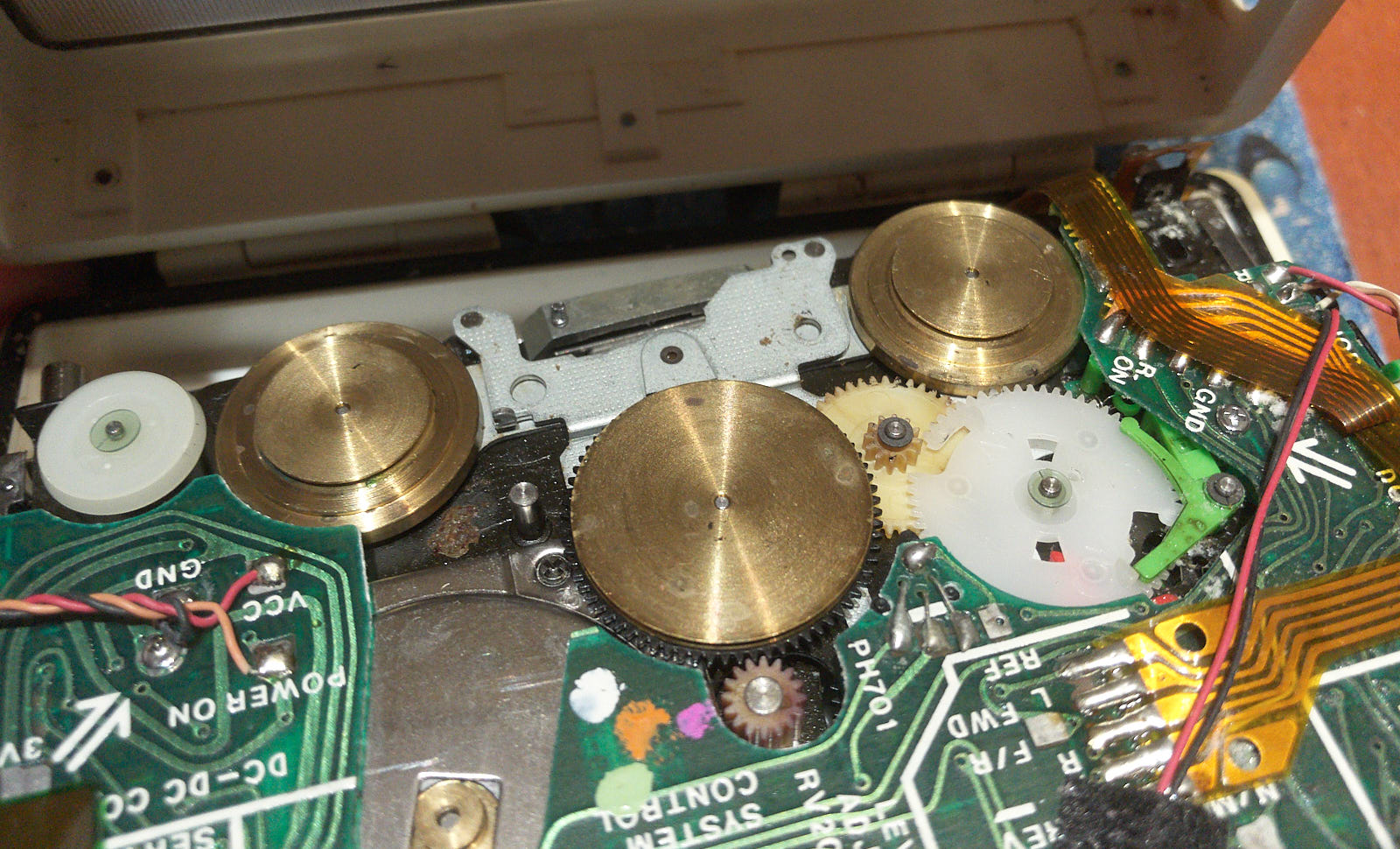

    Now I remove the mechanics:

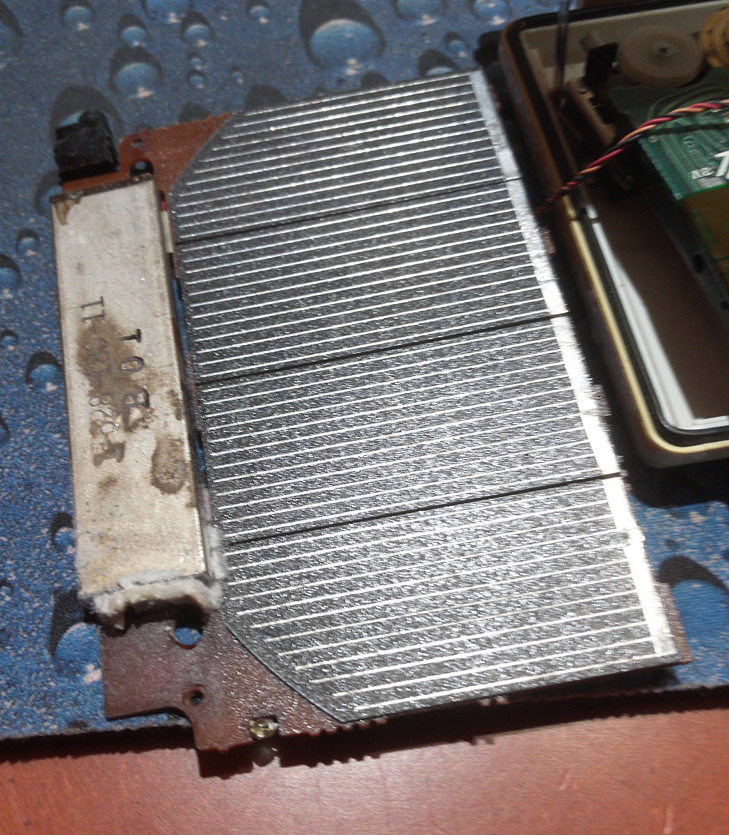

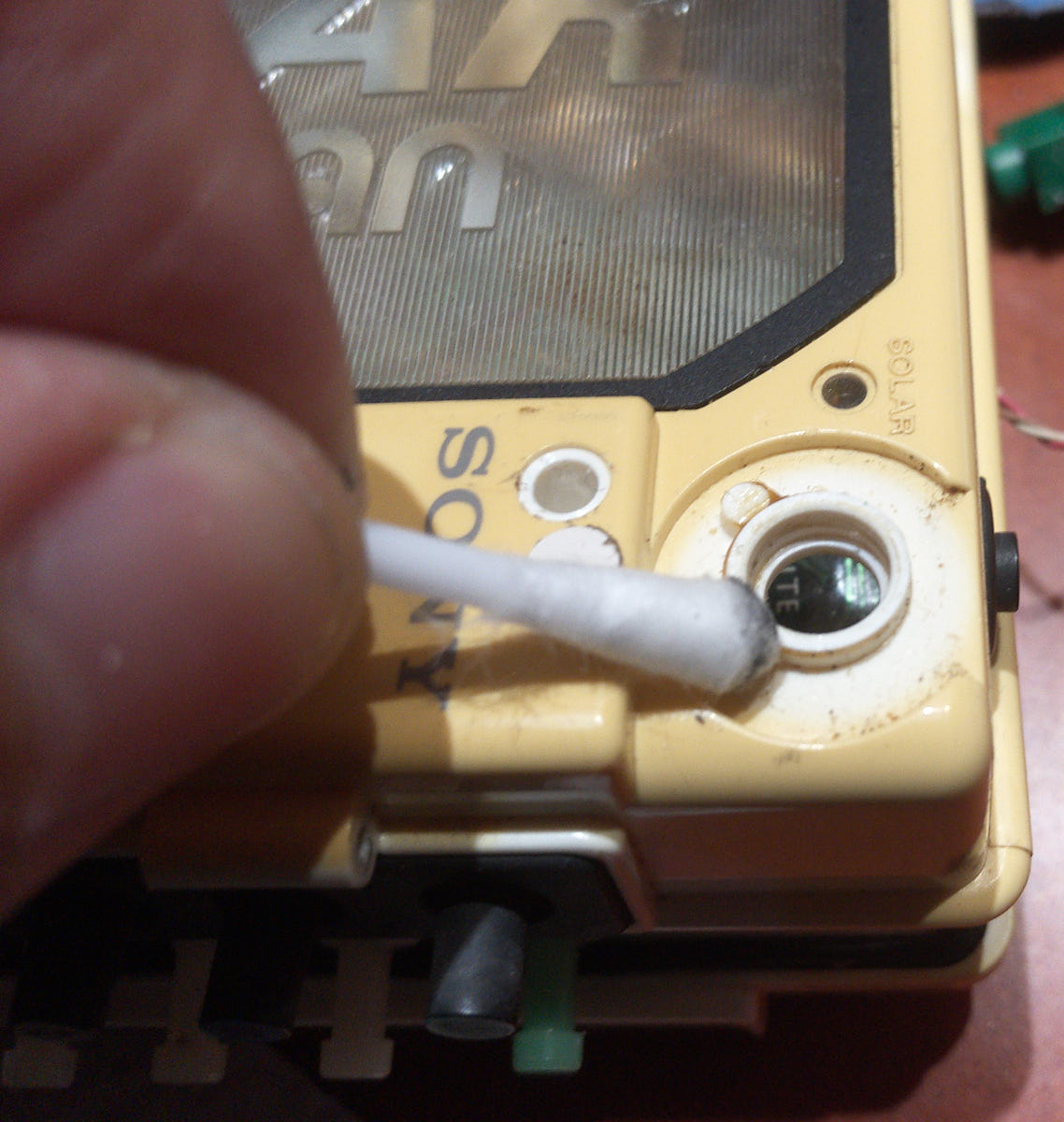

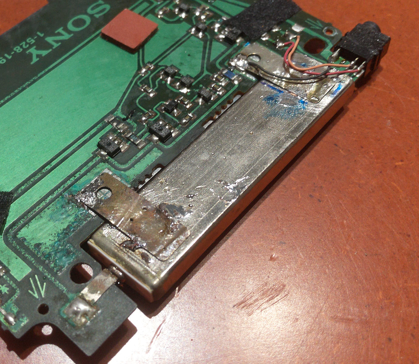

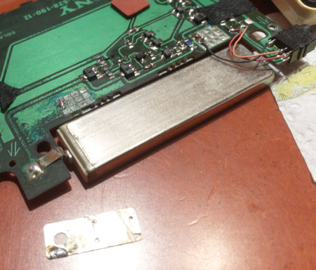

    Sadly the solar battery has leaked acid. Ugh! I'll have to replace it. The belt is melted.
    So I cleaned them thoroughly:

    The solar panel is OK:

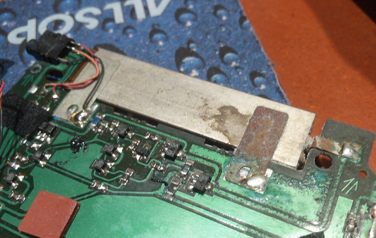

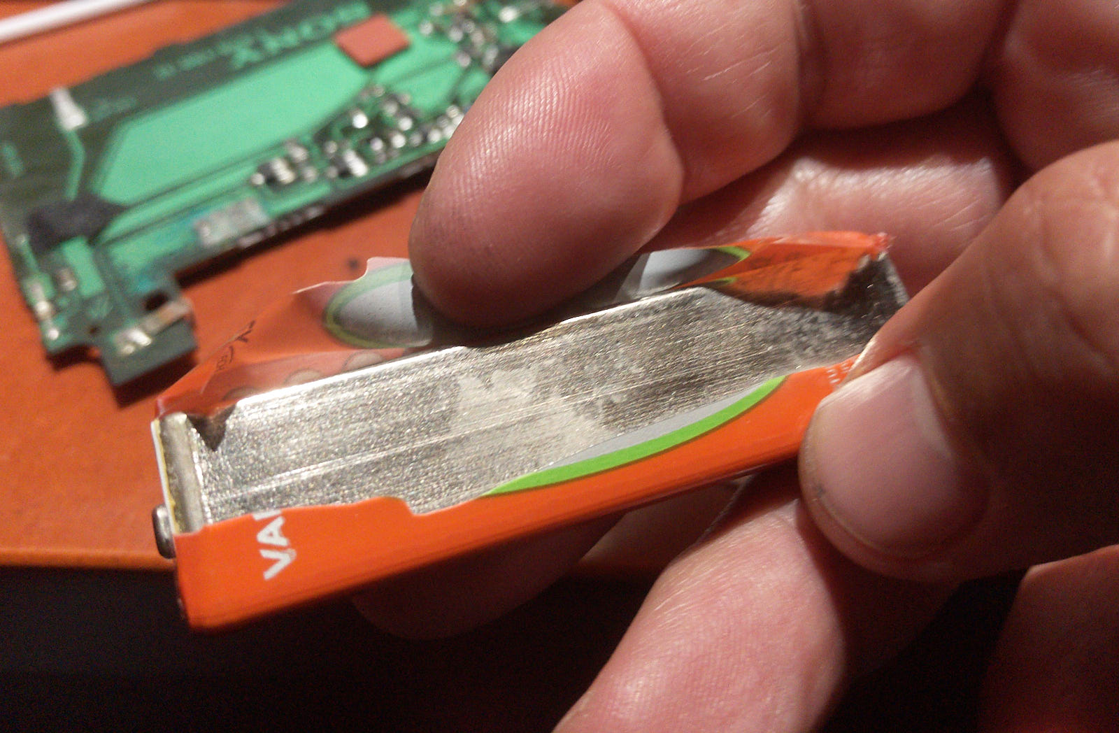

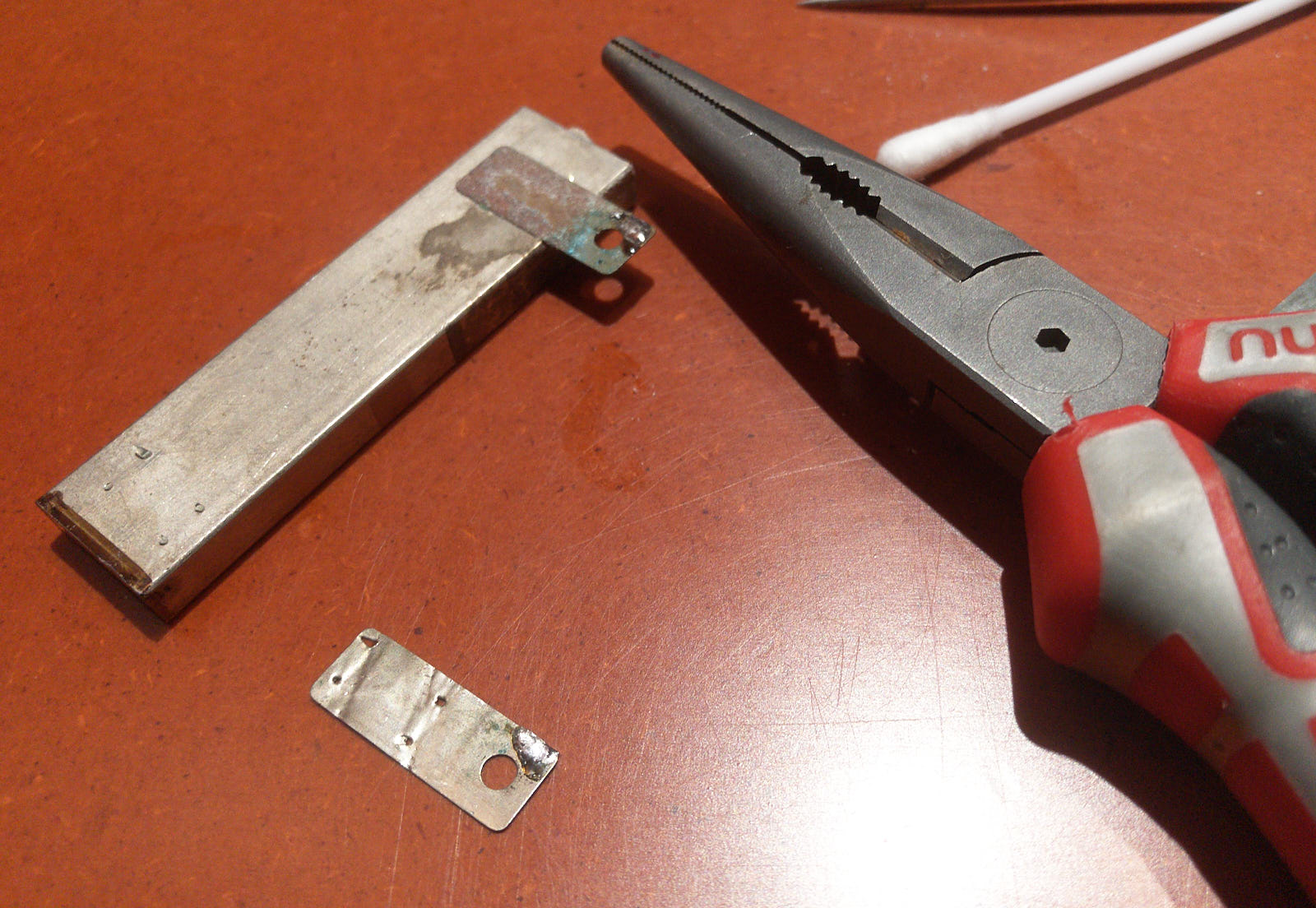

    Time to replace the battery. It's solded to the PCB:
    The acid also spread in the shell:

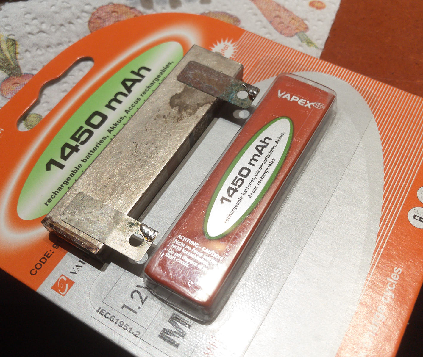

    So first unsold the battery:

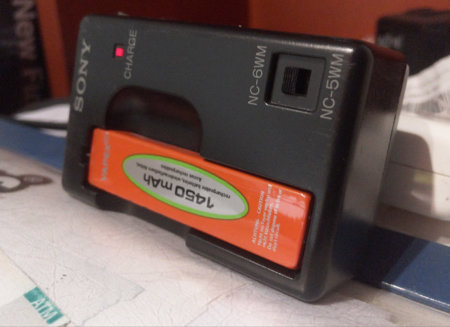

    Get a new one:
    Remove the tabs:
    Charge the new one:
    PRepare it to replace:

    Finally I solded it:

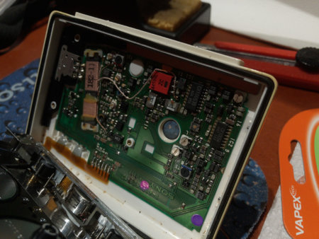

    Now continue removing selectors:
    SONY WM-F107 restoration 26.jpg SONY WM-F107 restoration 27.jpg SONY WM-F107 restoration 28.jpg SONY WM-F107 restoration 33.jpg
    Now I open the other door where the radio is:
    SONY WM-F107 restoration 29.jpg SONY WM-F107 restoration 30.jpg SONY WM-F107 restoration 31.jpg
    Luckily is in excellent condition; just a bit dirty.
    Finally the entire mechanics is off:

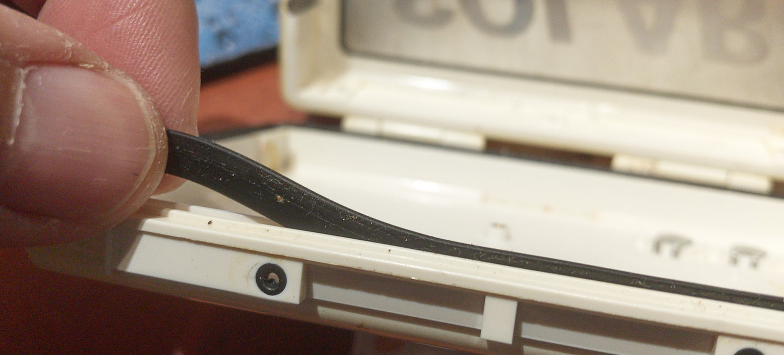

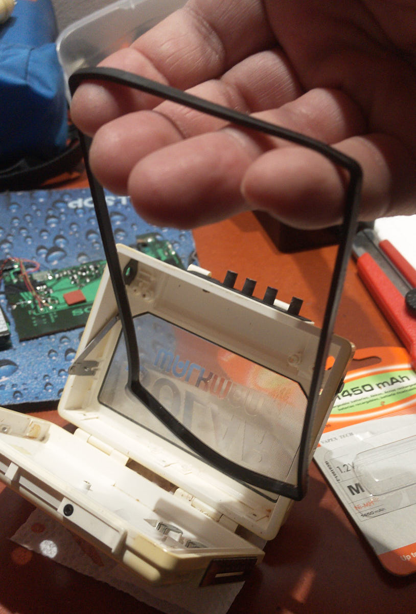

    I removed the rubber seal:
    Now the shell is totally empty:

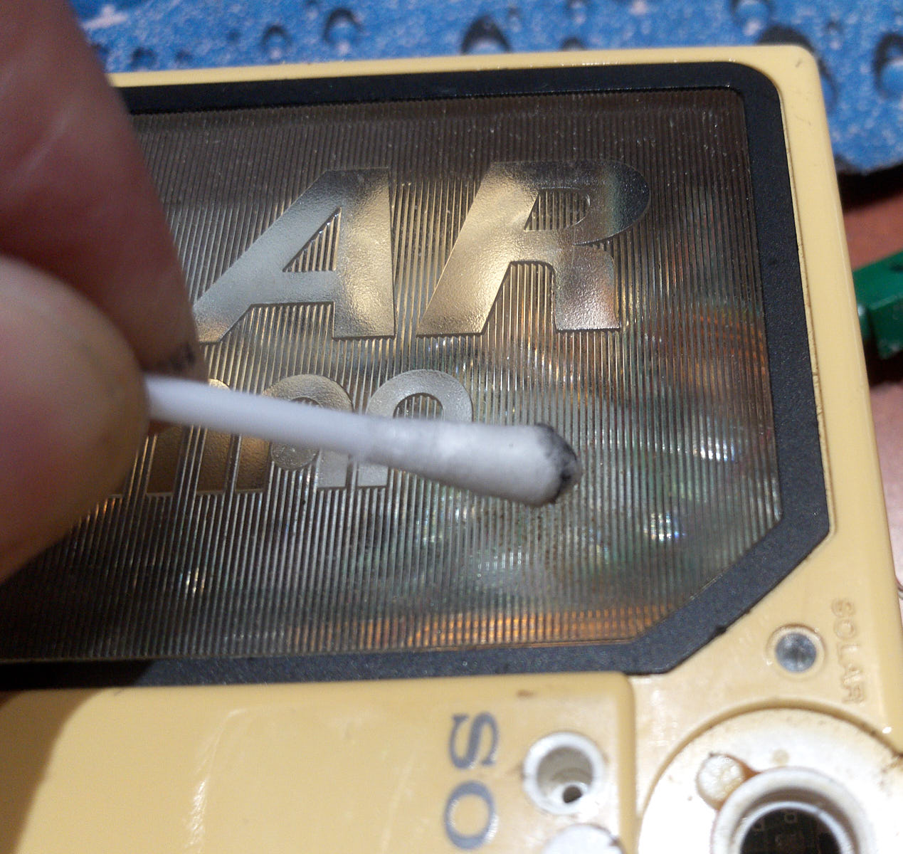

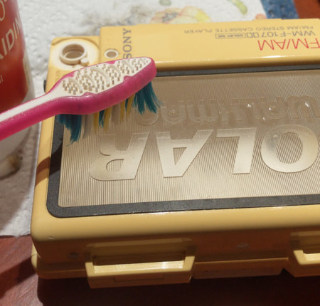

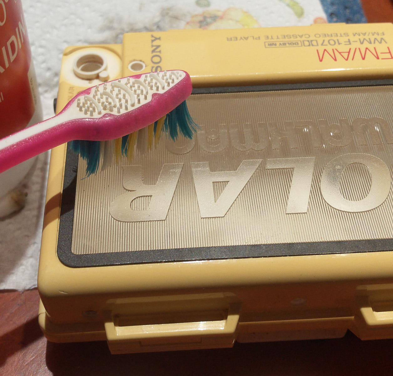

    Now I clean it thoroughly:
    SONY WM-F107 restoration 18.jpg SONY WM-F107 restoration 41.jpg SONY WM-F107 restoration 19.jpg

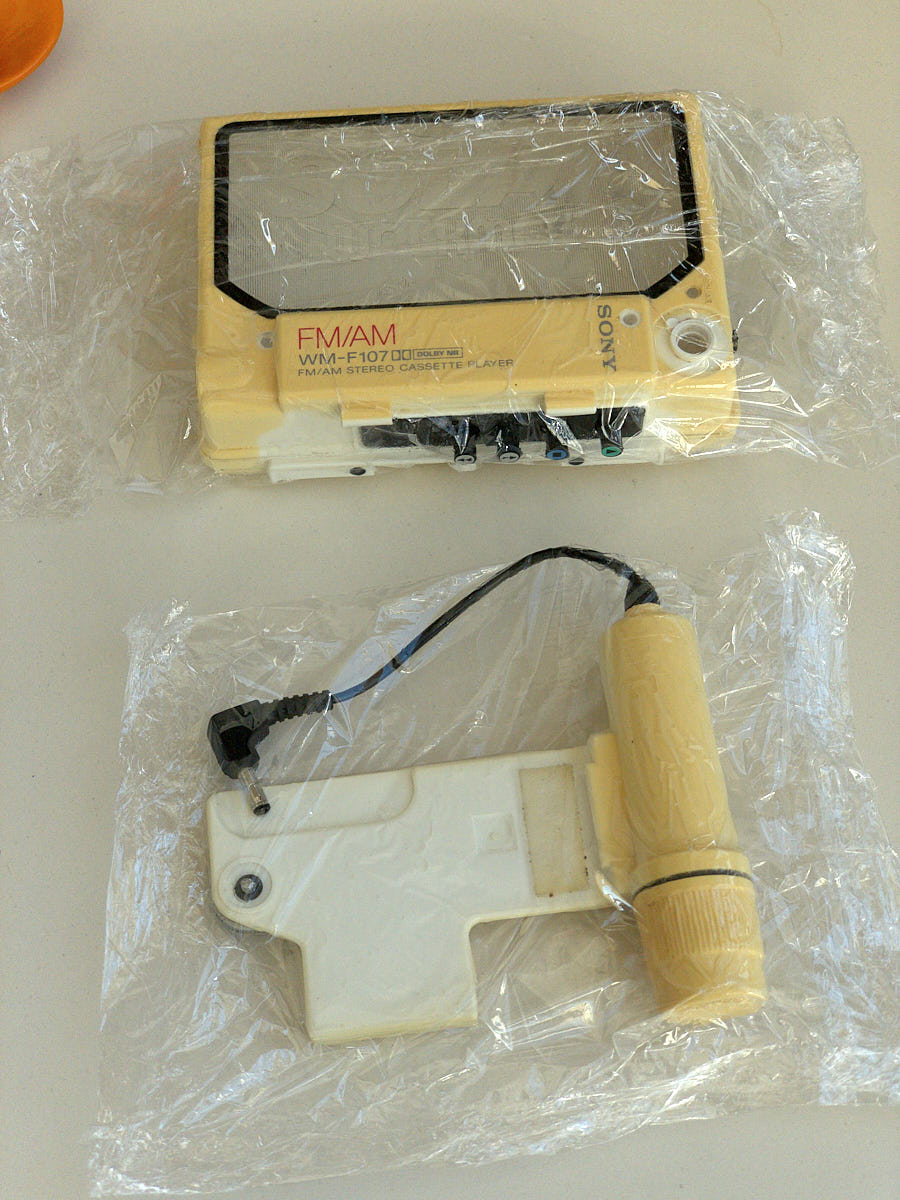

    So it's ready for a good retro-brighting!
  3. walkman archive
    1,881

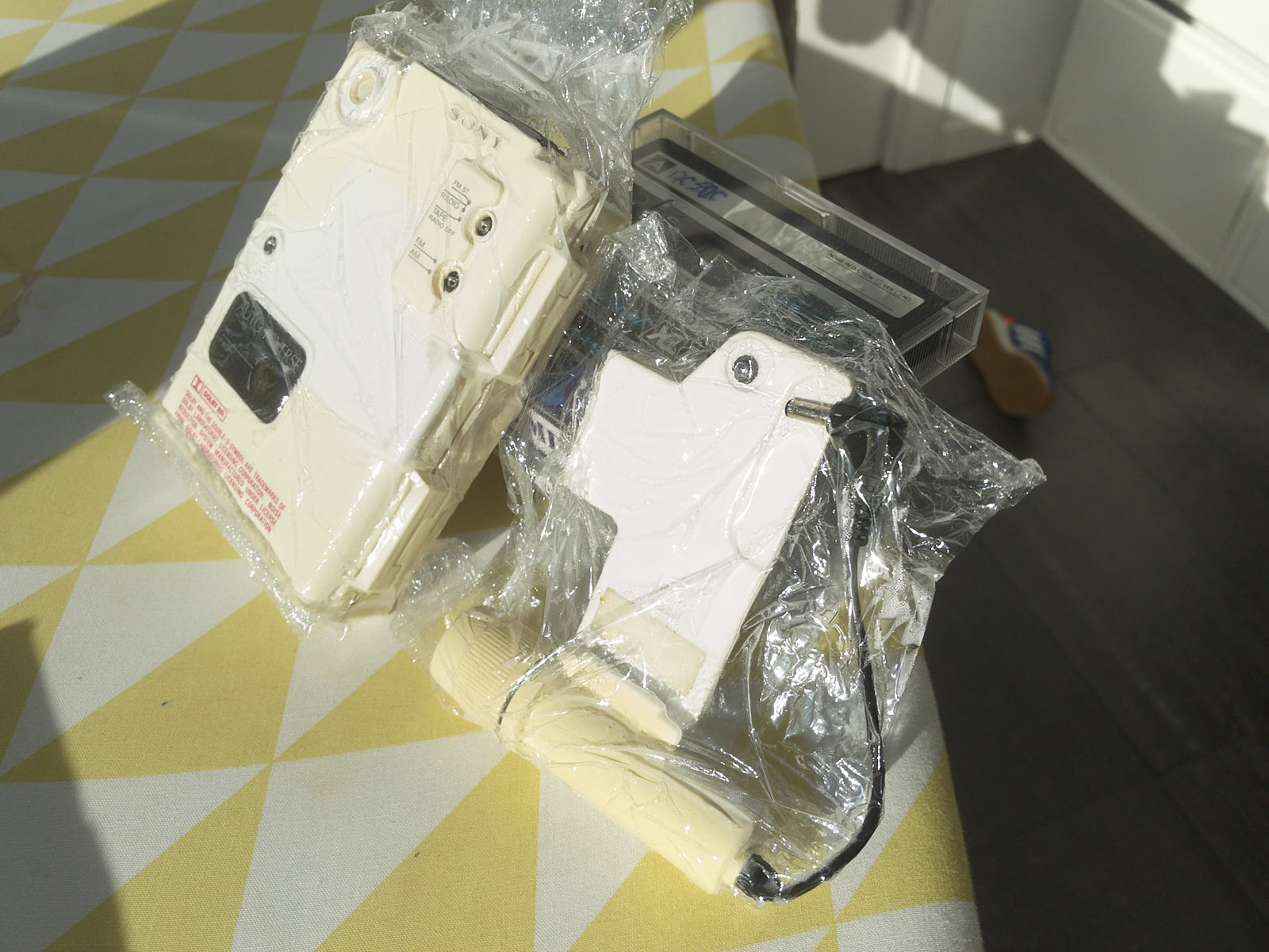

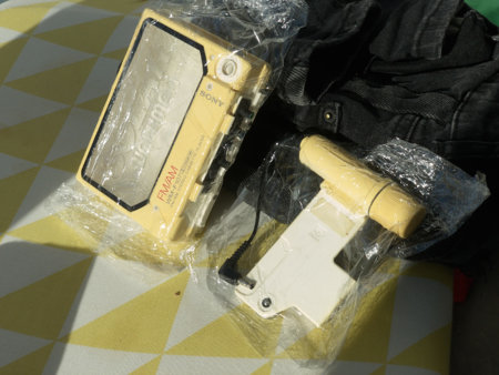

    I cover them with hydrogen peroxide cream (not sure the proper name in english, in spanish is crema oxigenada) and wwap with plastic to leave them for one entire day under the sun. The chemical will do the job:
    SONY WM-F107 restoration 44.jpg SONY WM-F107 restoration 43.jpg SONY WM-F107 restoration 45.jpg SONY WM-F107 restoration 46.jpg

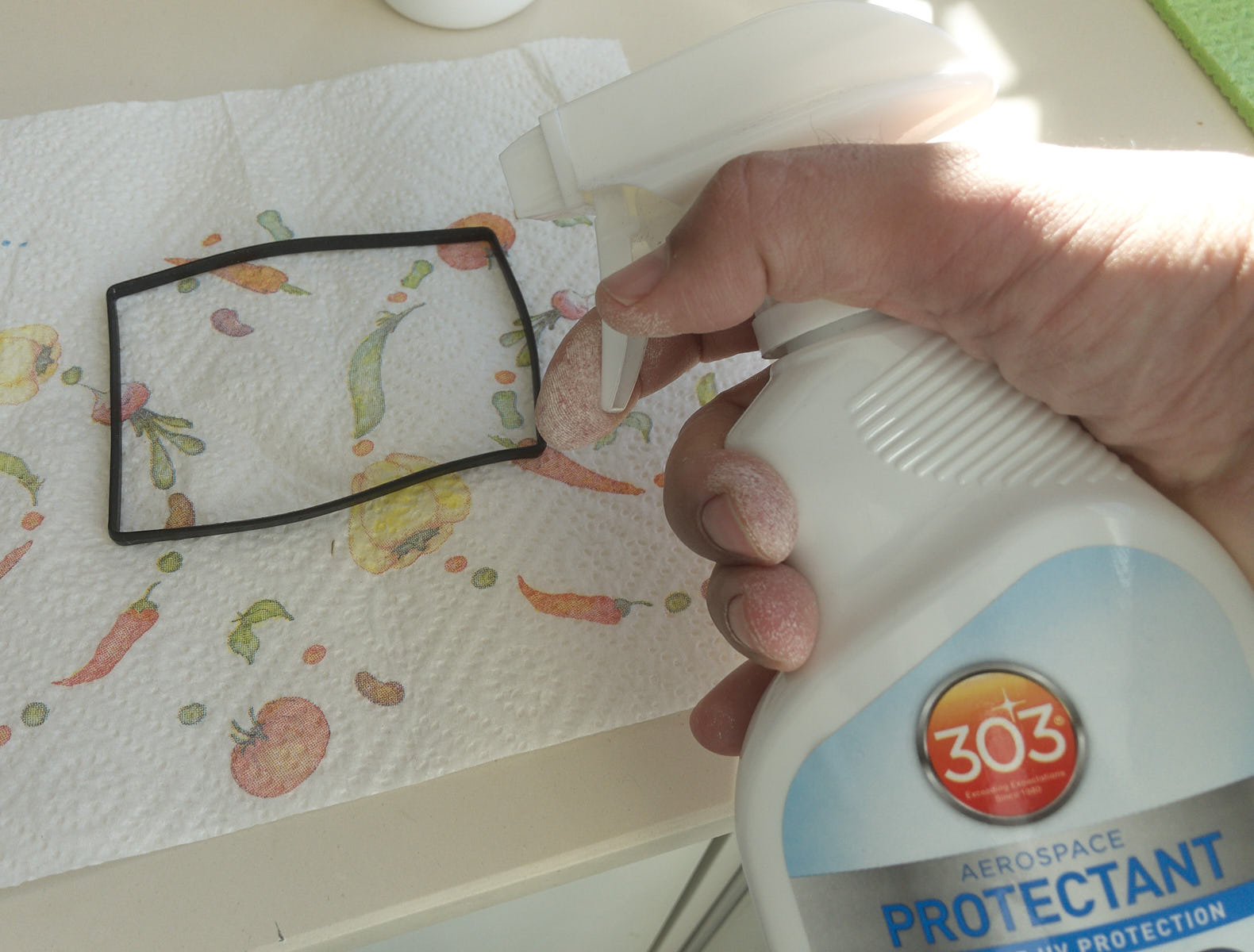

    In the meantime I restored the rubber seal with this, which applies a silicone film that protects it from the air, light and UV:
    After an entire day it end up like this:
    So I decided to give it another day. Finally it end up like this:
    Finally I washed it and this is the result:

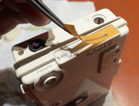

    Ok, now on to assembling it and restoring a few things. The radio dial panel fell off:
    So I had to remove the adhesive and create a new one, with high quality double-sided adhesive:

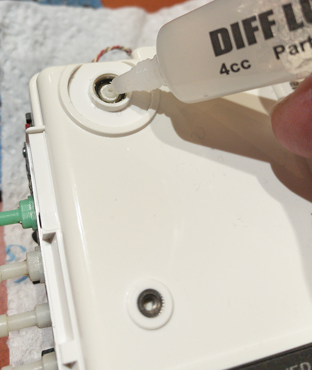

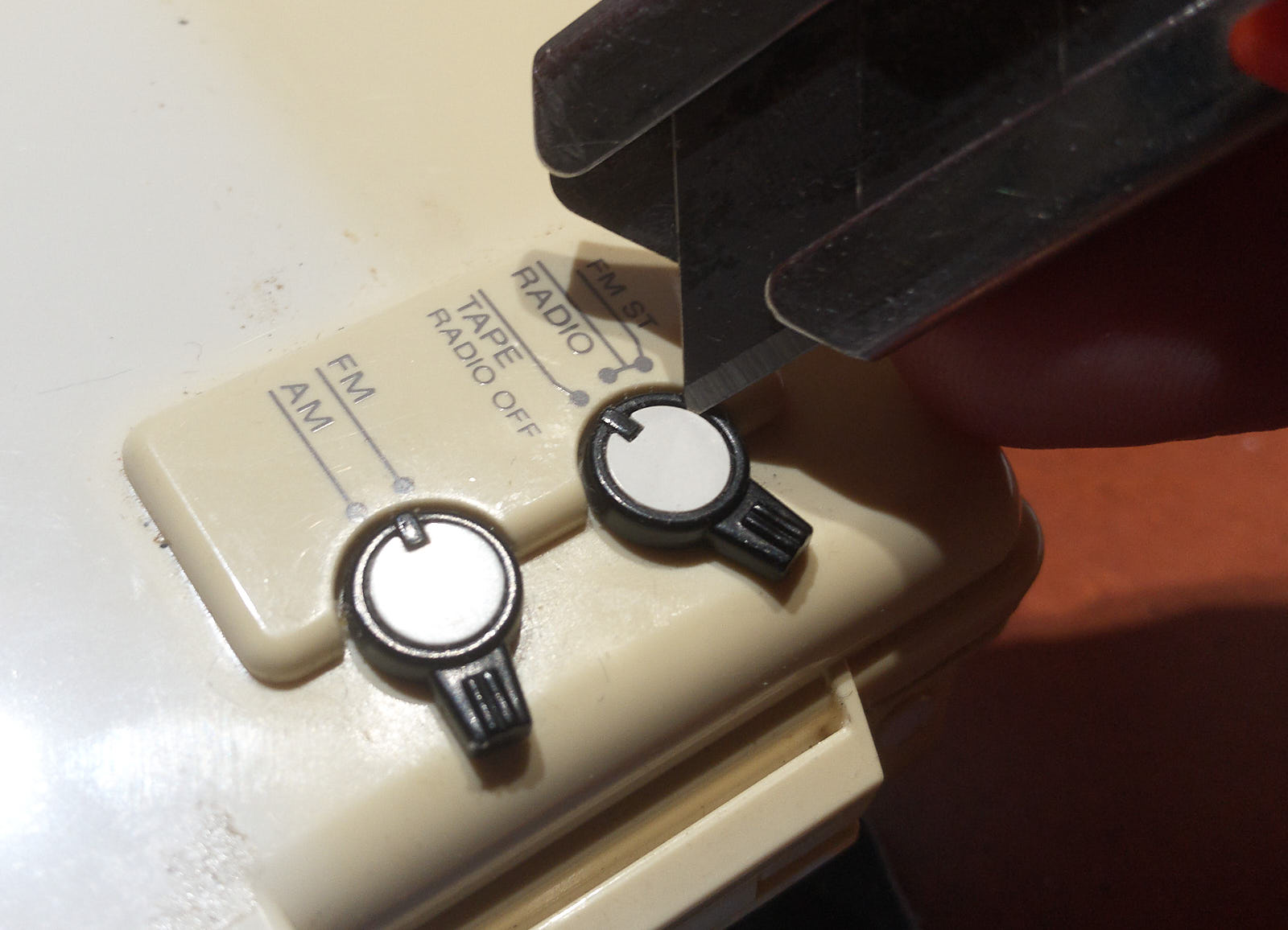

    Cleaned and relubed the knobs:

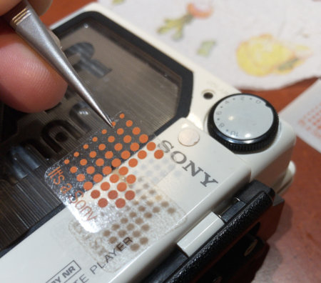

    And basically assembling it back. The final touch, a SONY sticker from @doublecee :

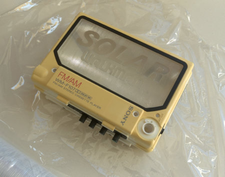

    And the final result is a walkman that works without the external compartment, sounds very good and looks very cool! Not only that, the solar panel apparently works!
    And the yellowish coloration almost went out completely (there's still just a smaaaall rest there).

    Have mixed feelings about hydrogen peroxide / retrobrite though, I feel it's the way it went, so it's the way it is, as long as the yellowing is natural aging, and not from being in a smokers home. But I can also appreciate the flip side, and I'd guess the white ones are rarer.
    I'd also be afraid the treatment would fade the lettering on the unit; does it?
    Also, if I'm not mistaken, NiMH batteries are alkaline, not acid. I think we'd have bigger problems with plastics melting if the batteries we use had acid.

    It seems not to affect the lettering at all. I haven't noticed any -even slight- damage.
    To me alkaline are the typical AA cells (not batteries). NiMh don't usually leak, at least I haven't seen any in years. But NiCd can leak acid as you saw. The big problem with acid leaking is motherboard damage.

    Great restoration, completely like new again. Do my eyes fool me though or did you solder directly onto the gumstick battery? Either way I'm at a loss for words :shock
