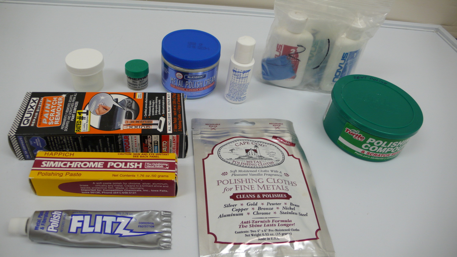

    I will post some photos of my collection, but you cannot go wrong with this set: Novus

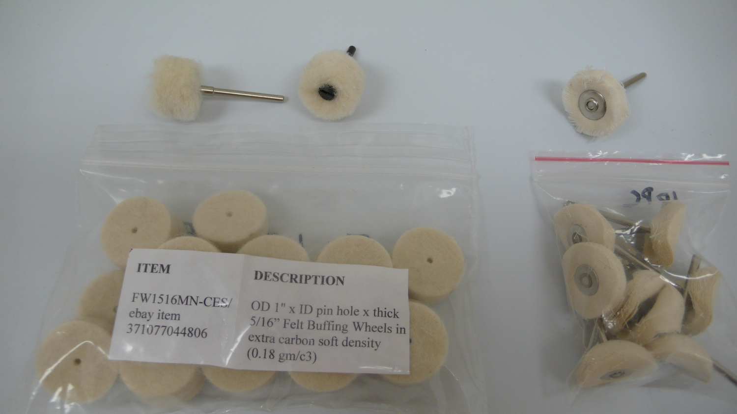

    @Boodokhan These are buffing wheels safe for plastic and acryl:
    I prefer the ones on the left, I think here is the same thing (but you have to get a better chuck). And here are the wheels with chuck attached.
    Novus is a King, but here is my collection which follows the advises of professional modellers o_O
    Once I tried Turtle Polishing Compound (the one on the right), everything else went into storage...

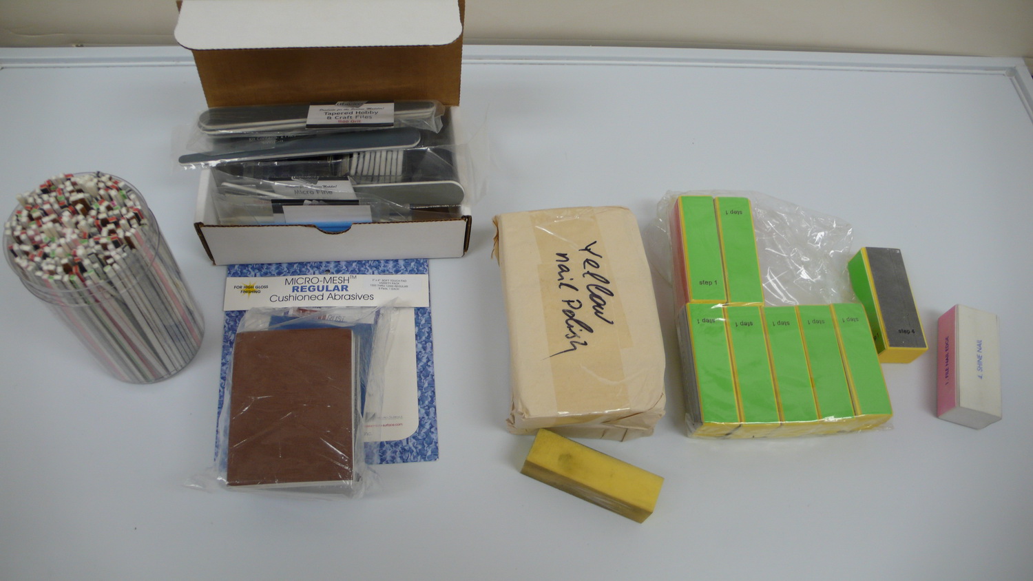

    I prefer the old-fashioned way of polishing by hand, here is my collection of sanding blocks and sticks:
    The one I recommend for Walkmans is at far right, you can get it for under a buck here.
    Use it wet and it will last forever. After polishing with "side-4/shine nail" you won't even need polishing paste!
    Micro mesh pads go all the way up to some insane grits, but for polishing Walkmans its an overkill, if needed use polishing paste.
    Brass cleaner mentioned by @Brandon or Blue Magic, I do not think it matters much. The only reason I selected out Turtle Wax is because it is the most neutral paste and according to professional modelers it won't attack any paint. Its a big thing when modeling but most probably won't matter on a 30+ year old scratch and touch-resistant Walkmans paint.
