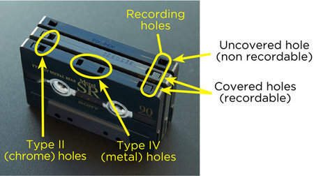

    • Those holes are meant to let the deck automatically identify the tape type and the ability to be recorded.
