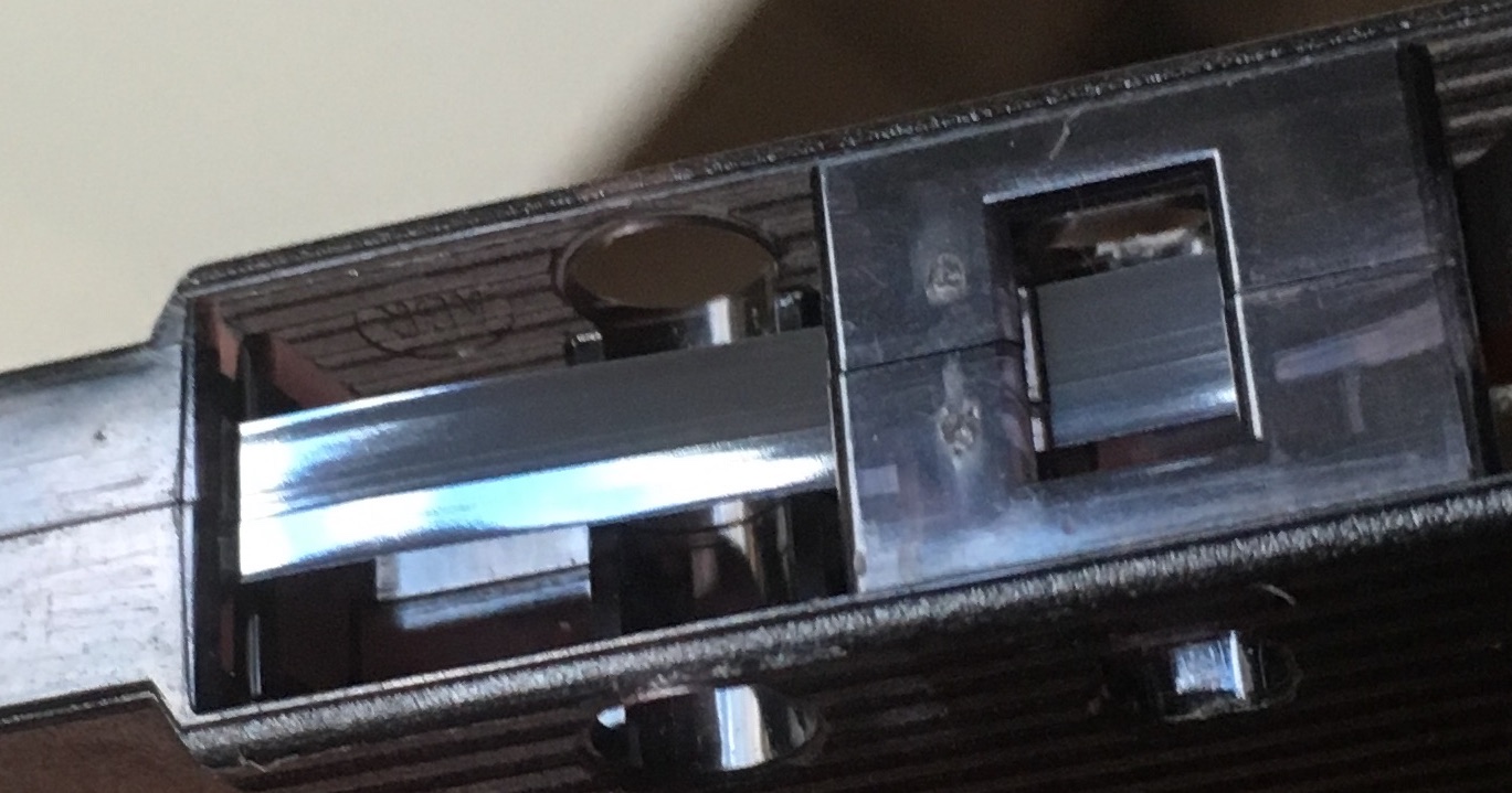

    If you check the tape surface it should appear smooth; a rail is line you see on the tape surface as if the tape had been folded. It is actually a sign of stress on the polyester substrate of the tape; it is the result of heavy compression (calendering) during manufacturing and the pull force by capstan and take-up reel during repeated play's.
    This tape (a TDK DJ2) has very evident rails
    The high frequency response of this tape, especially on side B, is very deteriorated.

    I got that tape with a batch of used Sony tapes (which are indeed fine) so I do not know when the rails developed.
    I have rails on other TDK tapes I bought decades ago and used them a lot over time. New tapes however do not have that issue, at least not immediately, rails is a symptom of bad ageing.

    In my case, rails aren't in the tape originally. They appear after playing, even in a hign end deck with excellent transport.

    It is the first report I have of rail problems on a Sony tape (also a Type IV!). All my Sony tapes do not have rails, even those mistreated when I was a teenager. For a tape deck to cause rails it needs to be heavily misaligned, you would have noticed it on any tape.
