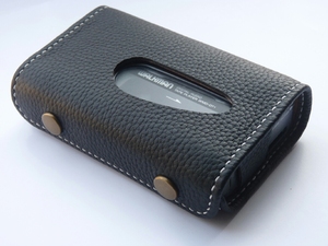

    Saw an interesting, visually appealing fix to the battery hatch issue this model often suffers from:
    I mean, it looks pretty fine, compliments the design. Anyone recognize what kind of material this is? A wide rubber band perhaps or cloth? If cloth, makes me wonder how it it is kept closed.
