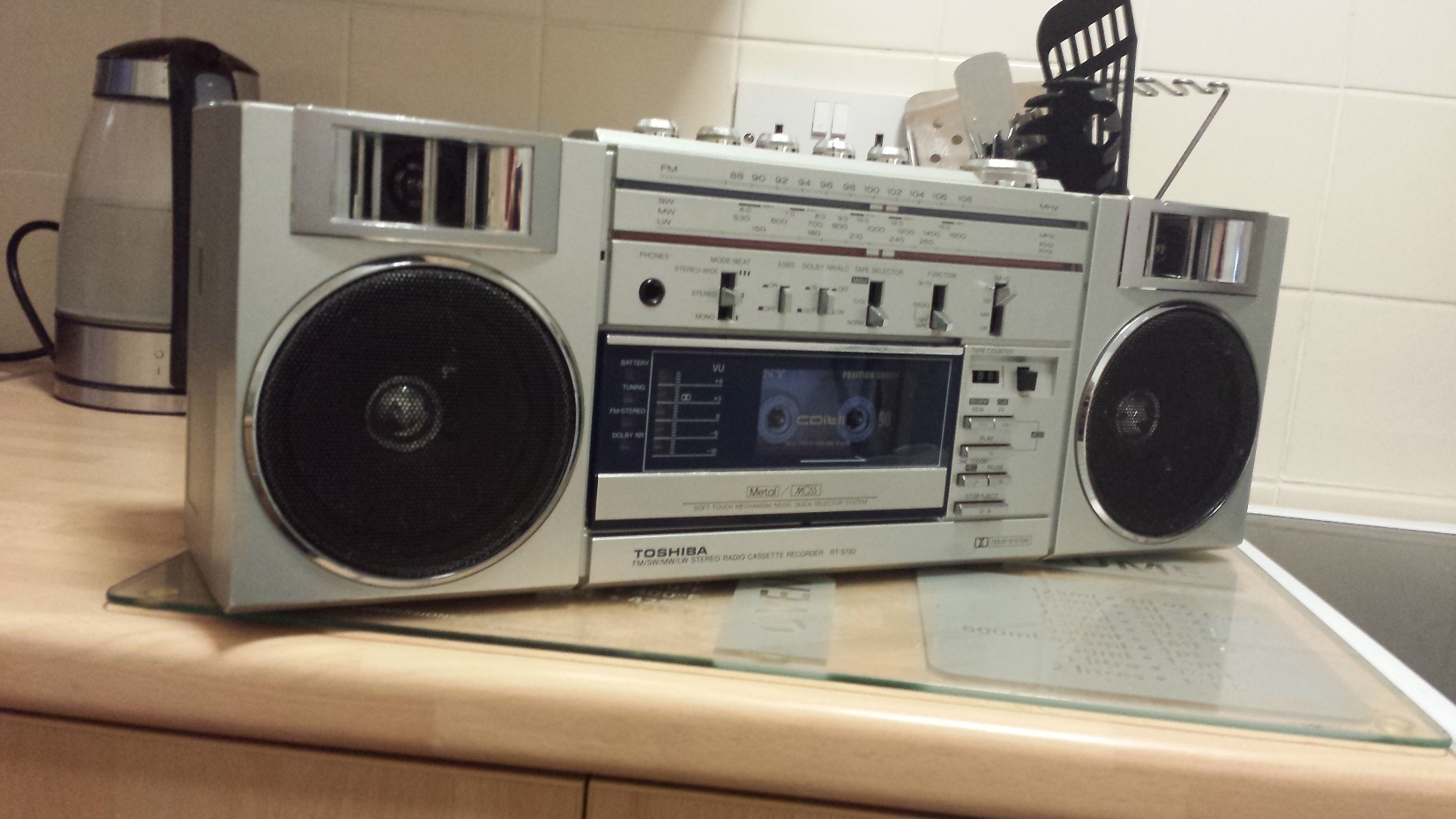

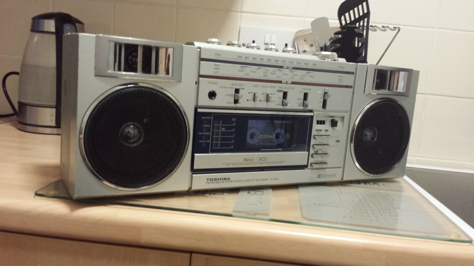

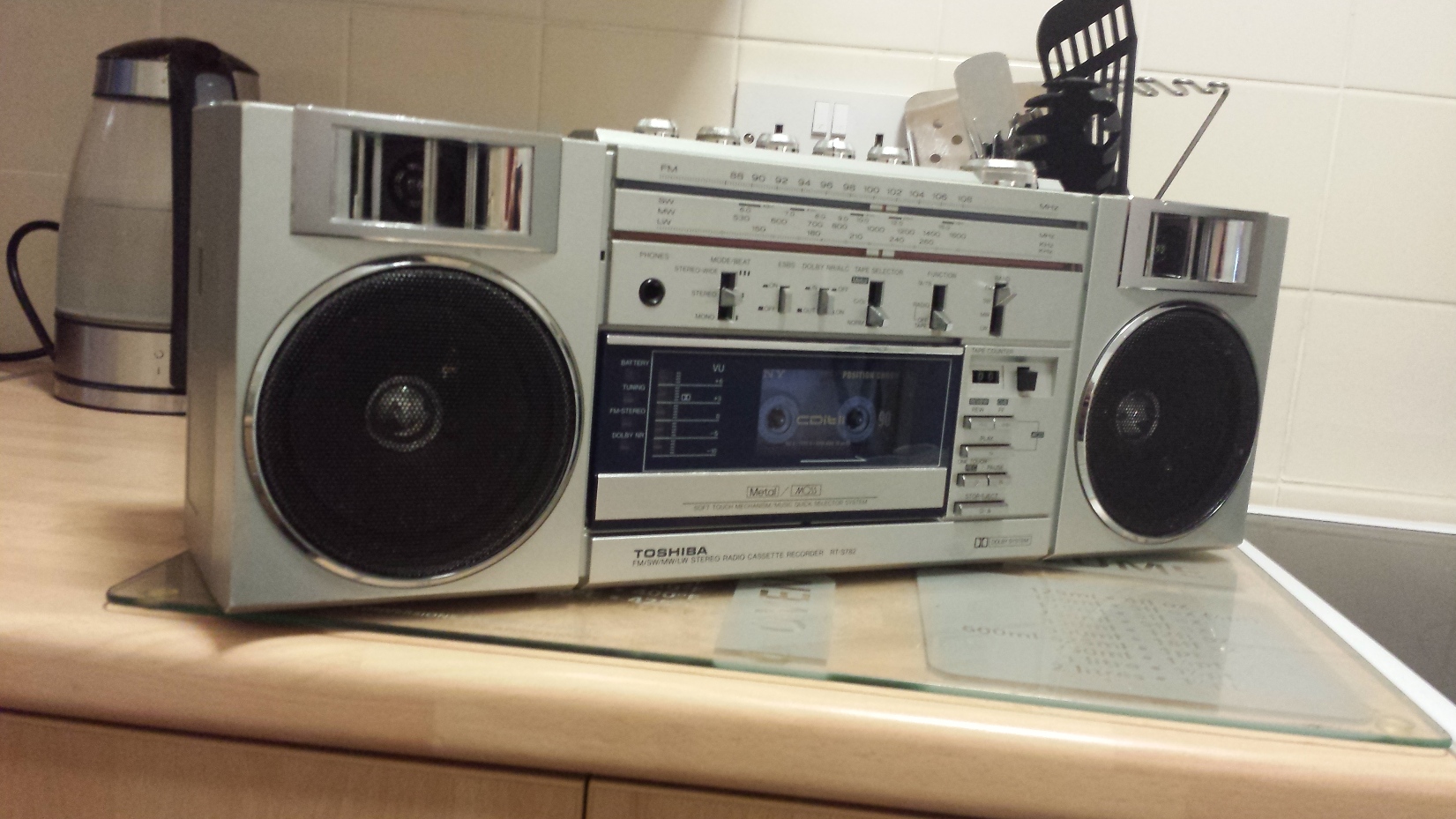

    I stopped off down my local flea market today and picked up this 'box for a whopping £7! It's in pretty good nick cosmetically, with both aerials intact and no cracks. It's missing the battery door, but nothing a little masking tape can't fix!
    The radio section works fantastically - possibly the best sounding small 'box I've come across so far. Nice tight bass response and clear across the high frequencies. It's got all the bells and whistles I'd need plus a gorgeous LED VU meter on the front. I can crank the volume all the way up and it doesn't distort at all! Amazing.
    The tape deck needs re-belting (and it's stuck on play somehow), but it has Dolby B, manual record level control and Tosh's MQSS system, much like Sony's AMS. I'm looking forward to giving it a try.
    I'm very happy with it. One question: the function selector switch has a position marked 'TA/TB', and there's a 5-pin DIN socket on the back marked the same. Is this an auxiliary input?
    Some photos:

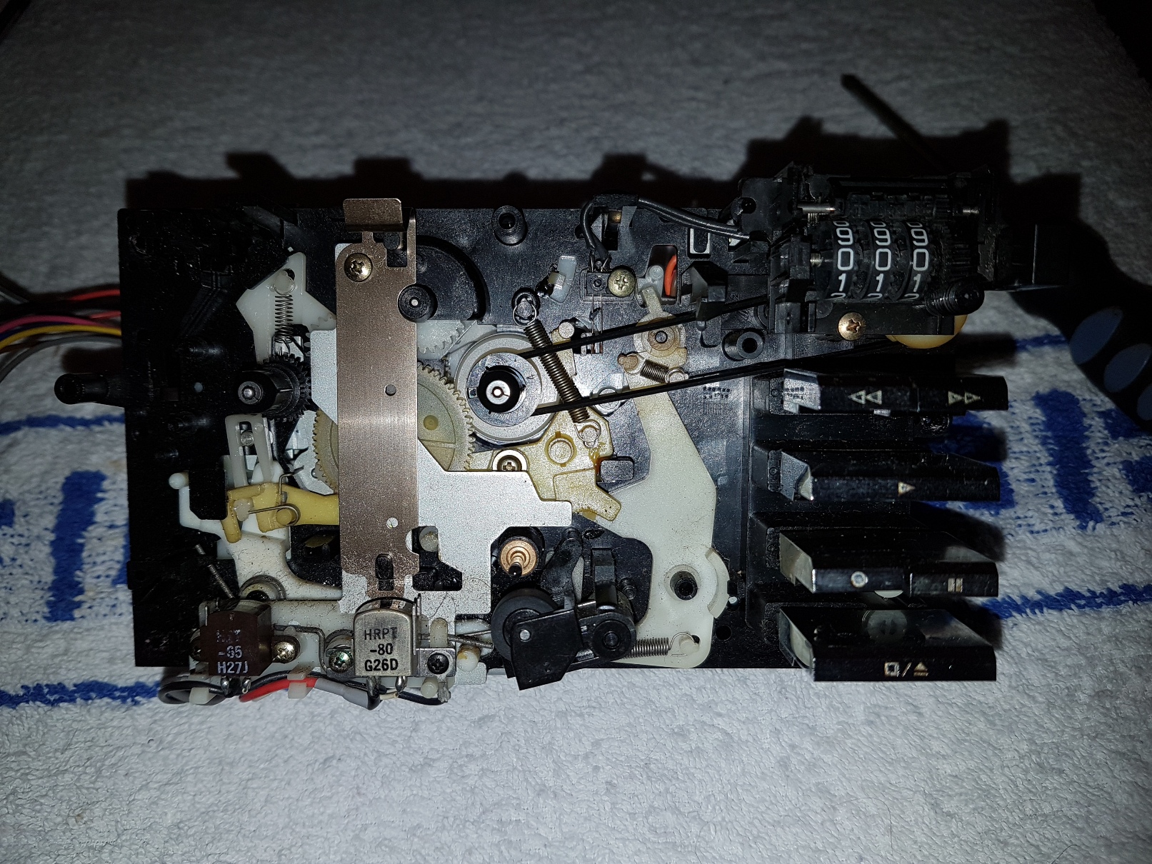

    Wow! Nice deck shot. Is it difficult to replace the belt on these? I've only done a couple of changes in the past and this is quite a complicated-looking deck.
    Thanks!
  7. nickeccles
    nickeccles Well-Known Member
    643
    Littlehampton West Sussex

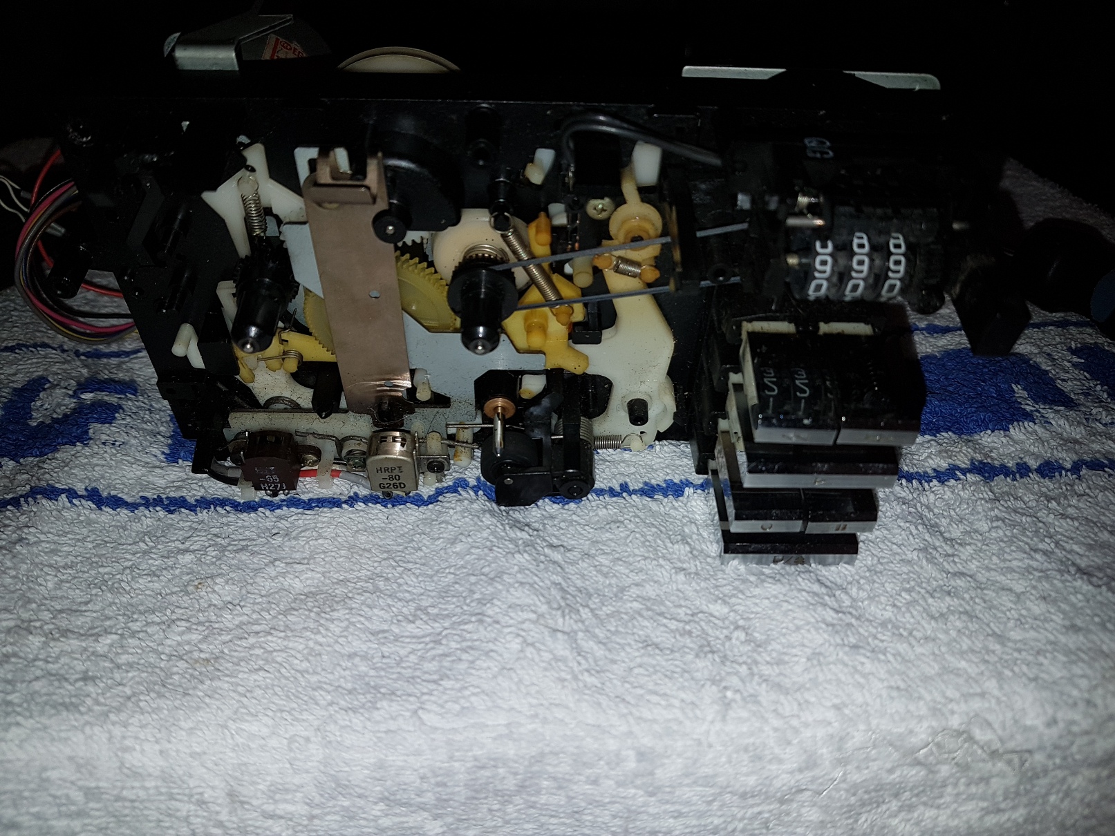

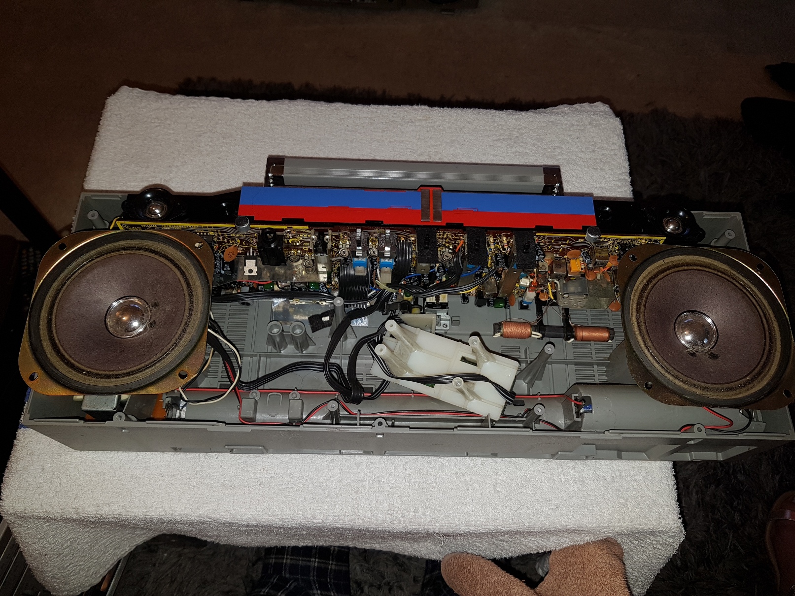

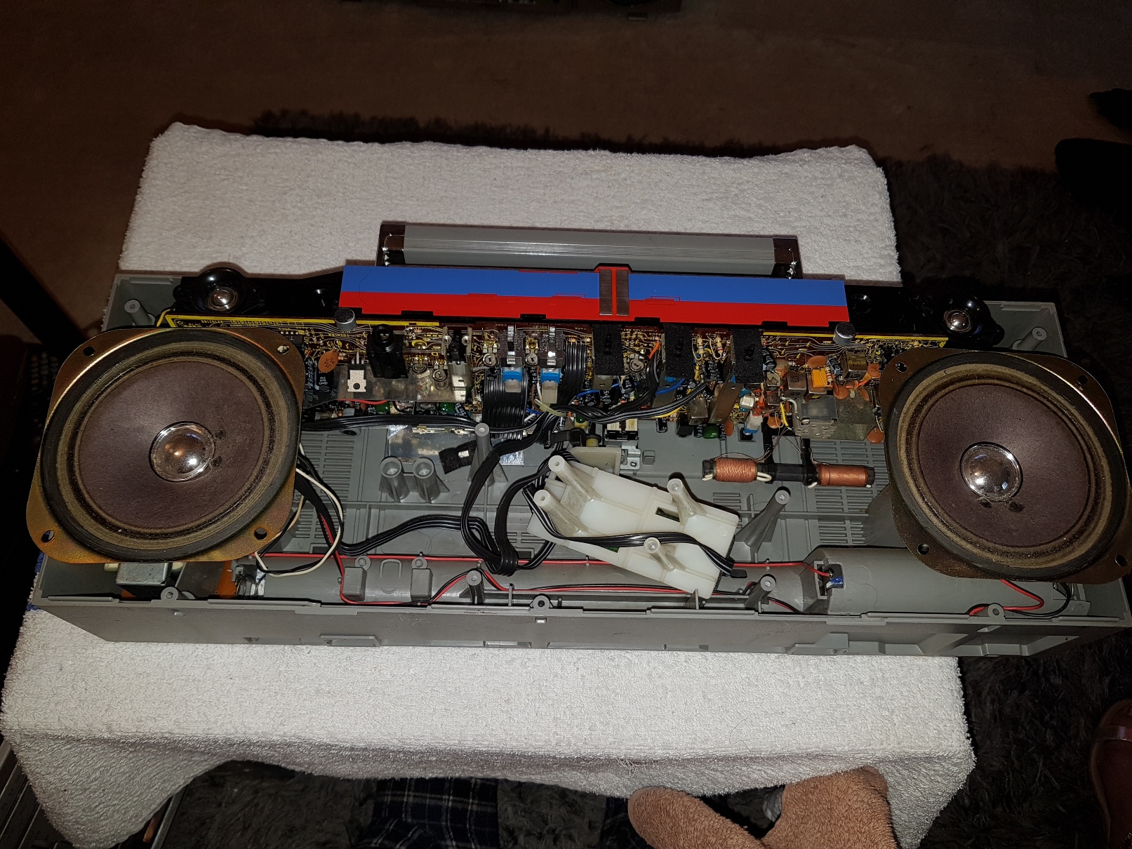

    Kitchen the decks are childsplay to work on I meant to mention that sorry.............
    Remove the front, unplug the deck audio & motor cables & I think 2 screws & simply lift it out of the cabinet :wink:
    Replace belts clean & oil capstan bearing - Put deck back in & while still open, power up the deck & deep clean the heads & pinch roller.........so much easier when the front is off!!

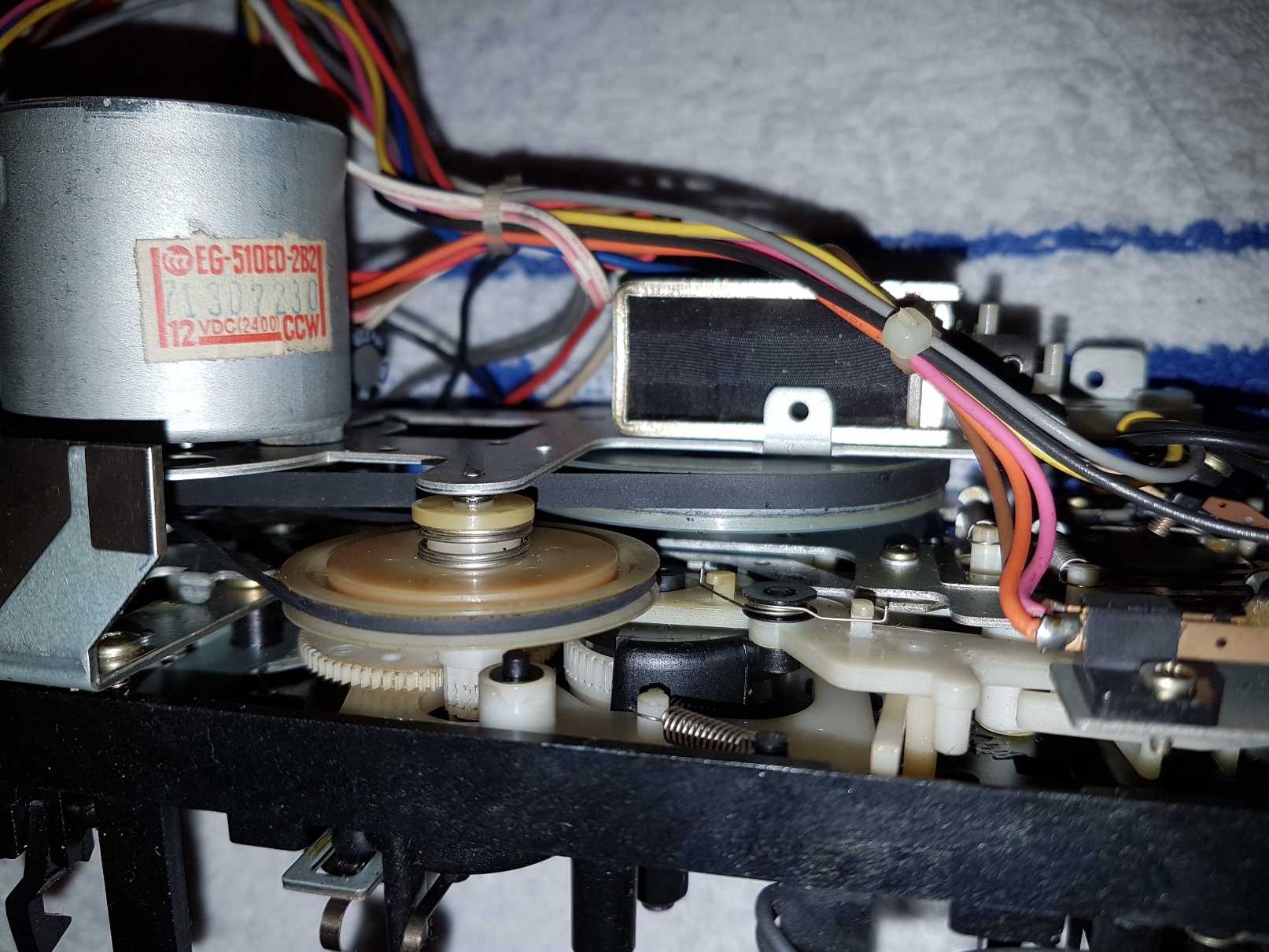

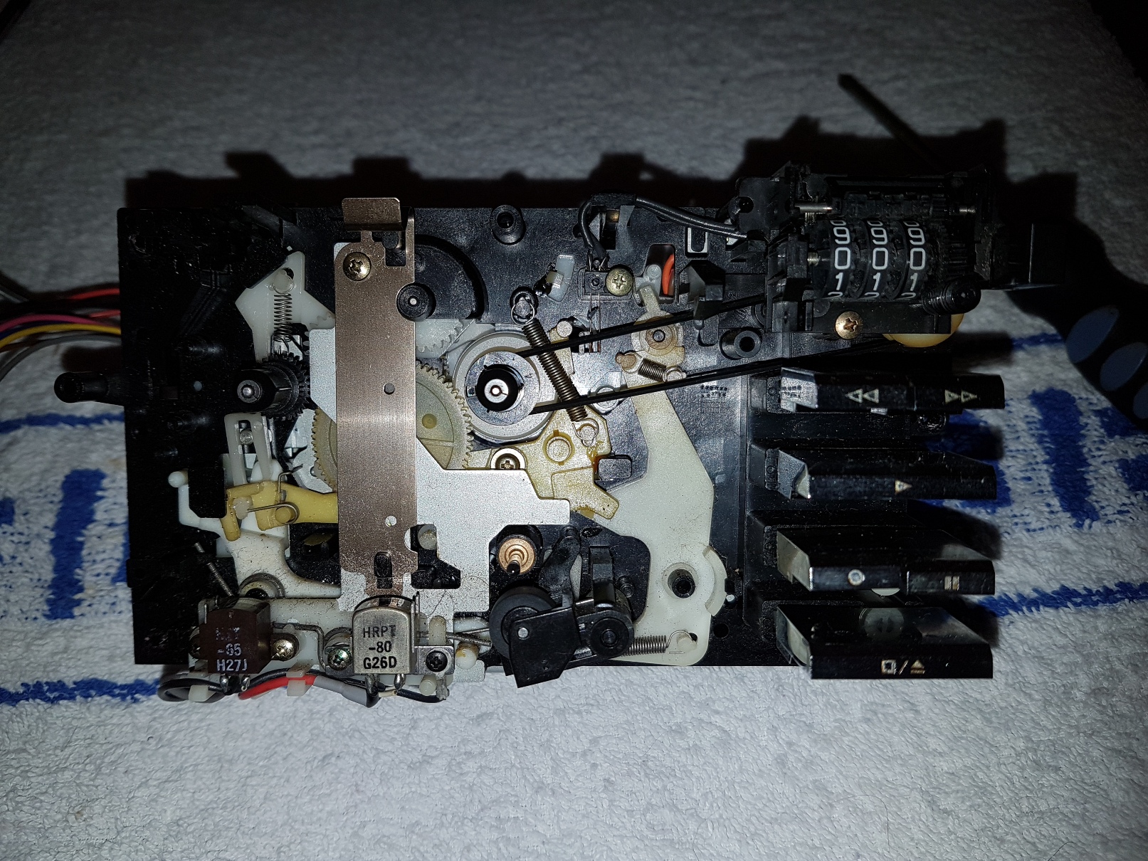

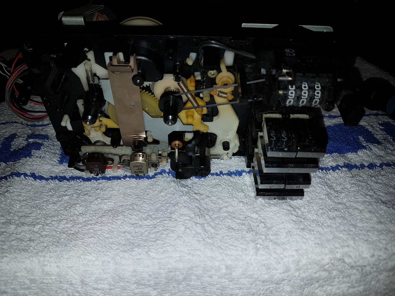

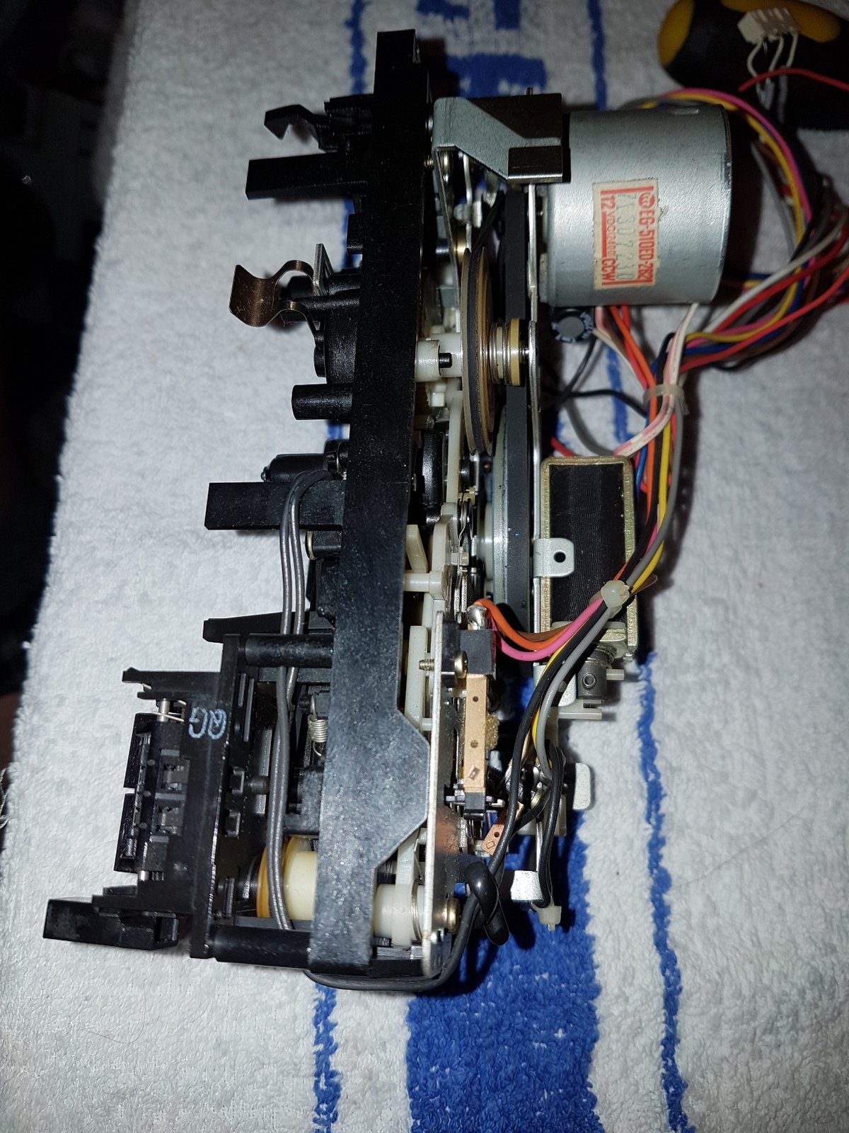

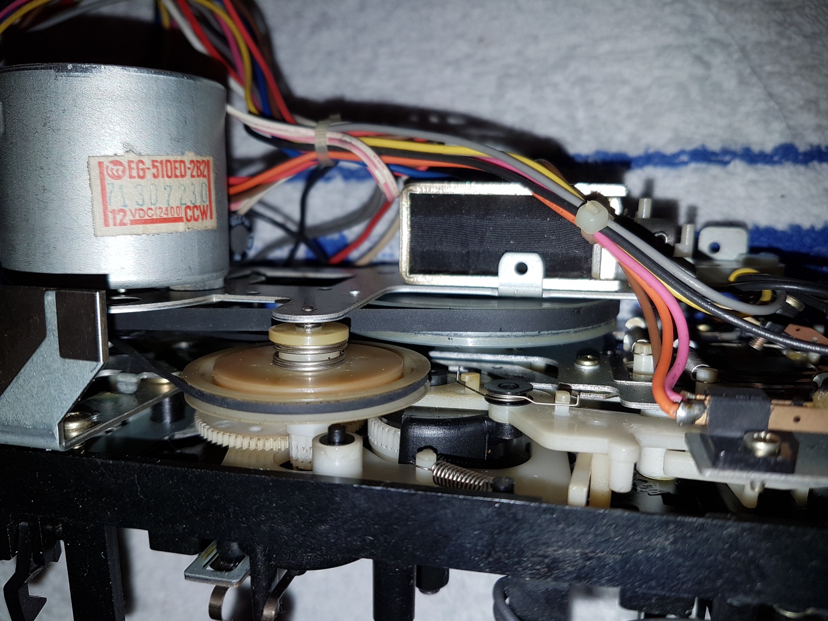

  15. sickly_b
    sickly_b Active Member
    146
    Cheshire, ENG
    Hi there - I've read with interest your excellent posts re this cute Toshiba box

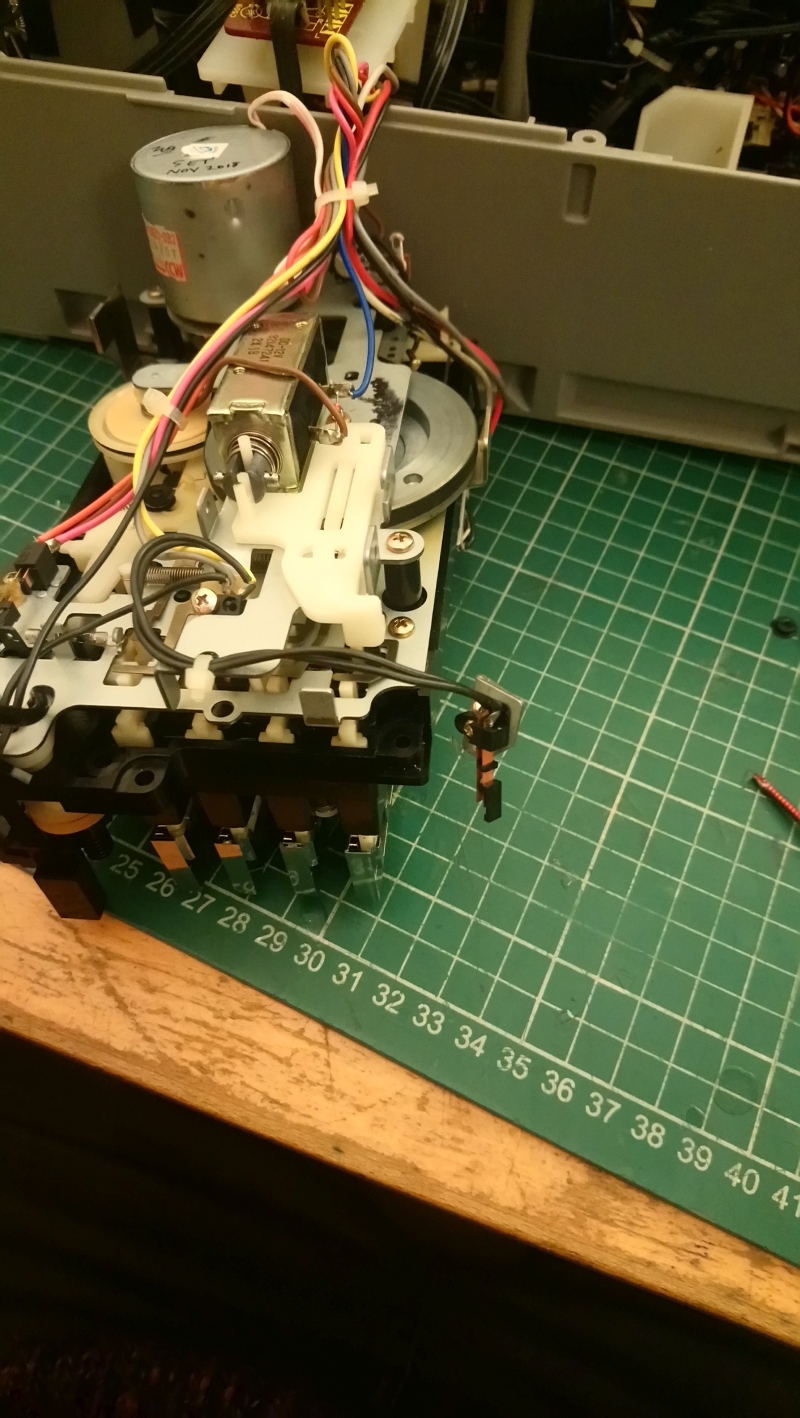

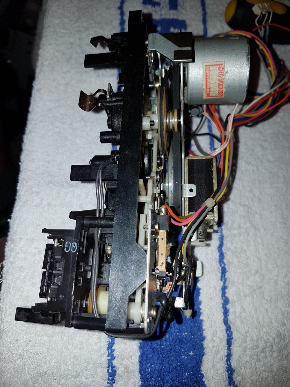

    By coincedence, this model fell into my hands recently - I serviced it but with a gap of a few days in the middle (risky!) and on re-assembly I had 1 leaf switch that I could not work out how to position..
    The fact that I had removed it for disassembly should have been a strong clue, seemed obvious, but for the life of me I couldn't work it out...
    Anyway, I put it back together and it's sounding great and playing well - with no obvious faults, even though I left this switch floating!!
    I can't quite tell from your excellent photos and guide where it should go - I was looking for a picture of the rear of the transport
    - if you can help I'd really appreciate it (you've already helped greatly of course by documenting your work so well)
    Here's hoping!
  16. nickeccles
    643
    That switch caught me out too like a kipper! :lollegs:
    I don't have any shots of the other side of the deck so unable to help or indeed remember where it goes! I can remember that it goes where one of the screws you removed to split the deck! take deck out again & try see if the wires help you guide it to it's place! Mine is all wrapped up & in storage now so I can't look at it :(
    I remember it leading me a right merry dance though!!

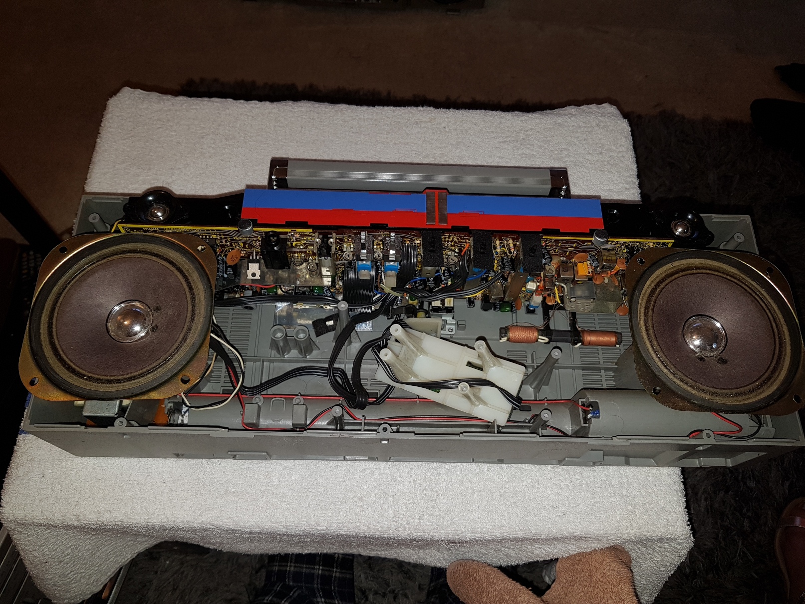

    I remember now! This is where it goes! Don't ask me how it operates or which way it goes but you have that stupid "Triangle" mount which slots into the small slot right next to the screw! Same screw holds it in place obviously! :biggrin: :biggrin: :biggrin: I wasted hours on this bloody switch & the original images of the 1'st one I had are long gone.......They held the key to this puzzle!!
    Here is mine along with it's original replacement speakers - The old ones were shot & completely worn out!! Now it's sweet & works like new! I really like these stereo's! :reelspin: :reelspin:

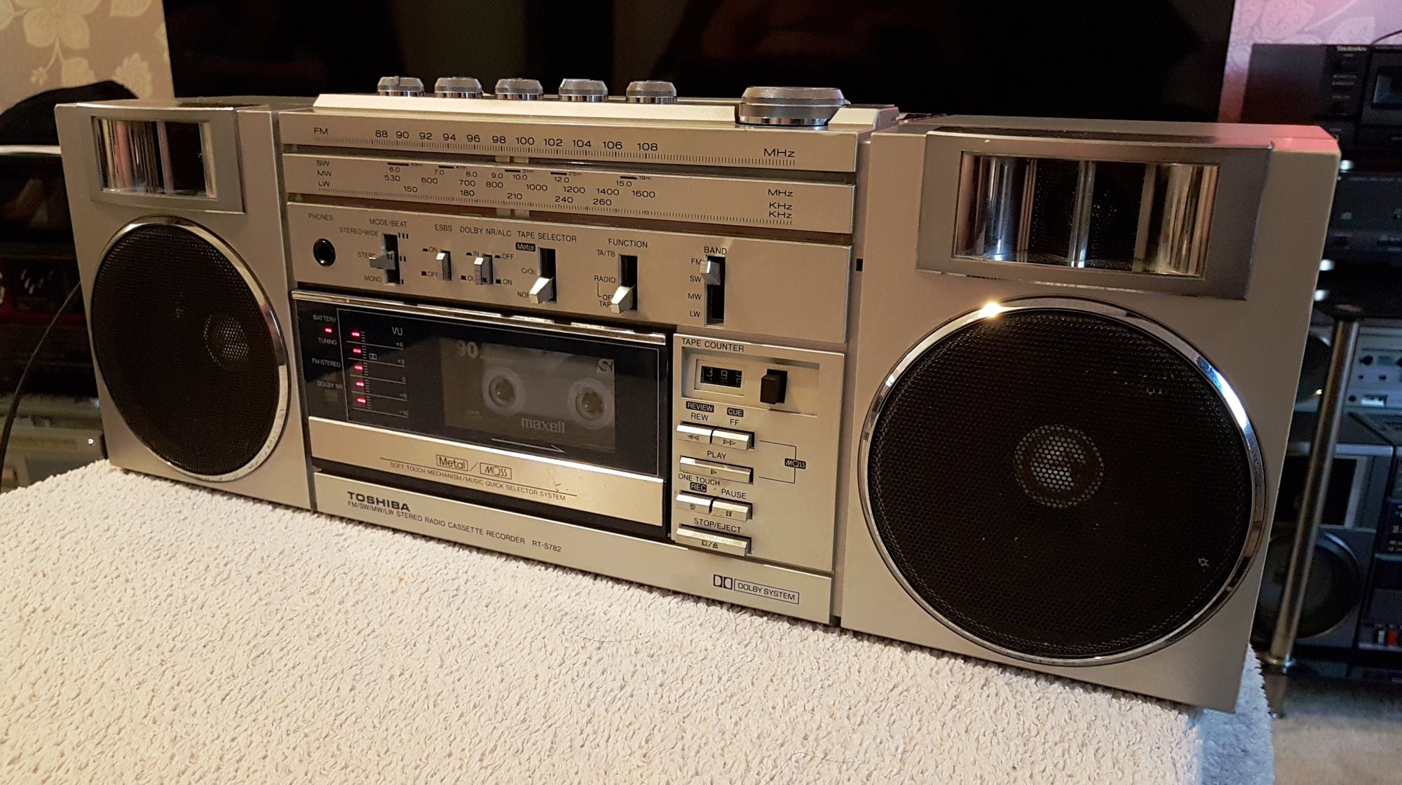

    amazingly, this unit was sent to me (in near showroom condition) in error!
    I ordered something on ebay and the fella sent me the tosh by accident and my item to someone else. It was going to be a hassle and cost quite a bit to return and recover the original items so he said are you happy to keep it?
    It still has the 'BEAB Approved' Safety tag on it and I love the sound of it - the build quality inside, WOW - better than a lot of 'proper' tape decks with its massive flywheel
    It's had a little clean but really didn't need much. Used Meguiars Plast-RX on the perspex window - have you used this stuff? V handy for boomboxes and walkmen
