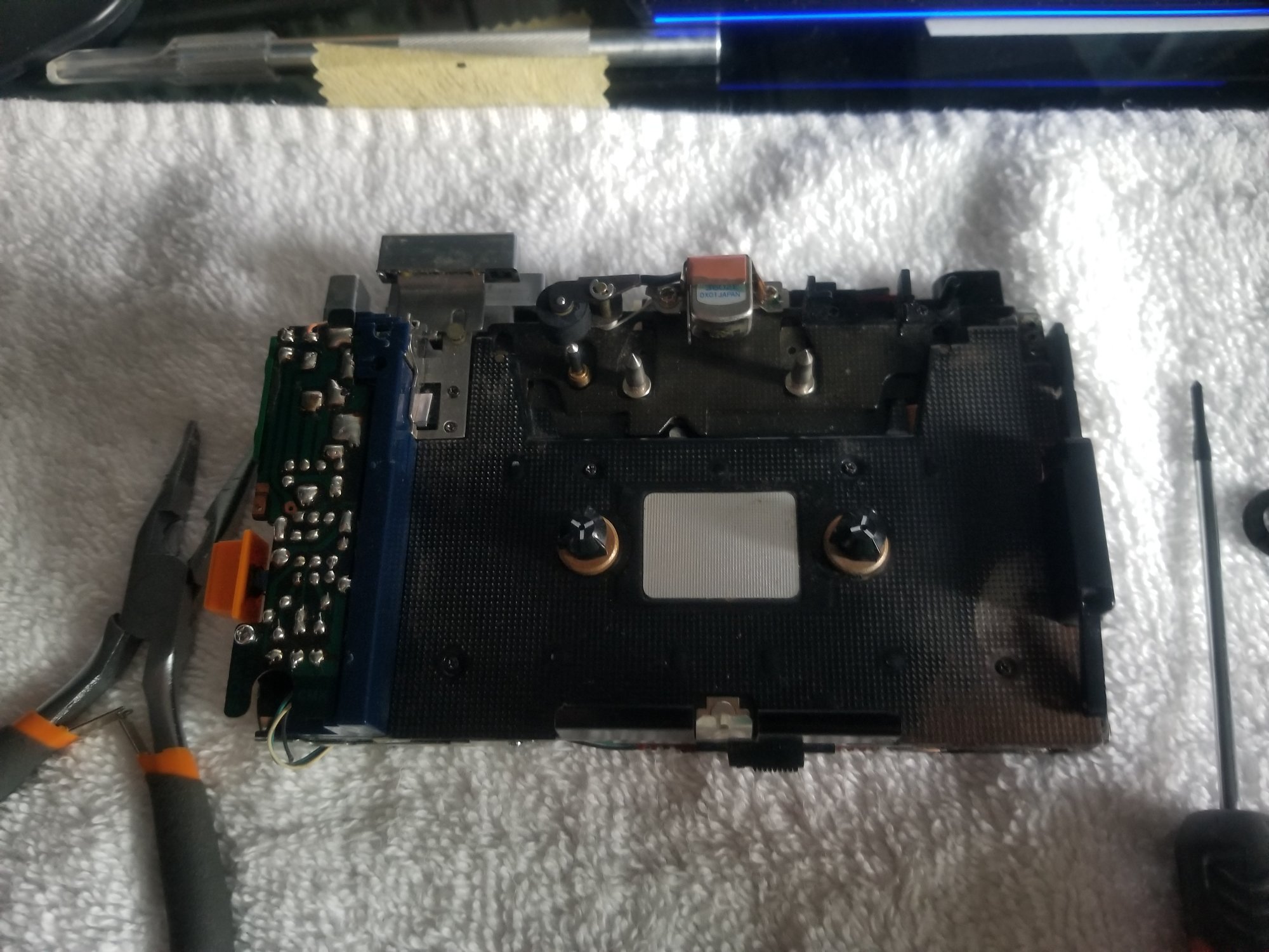

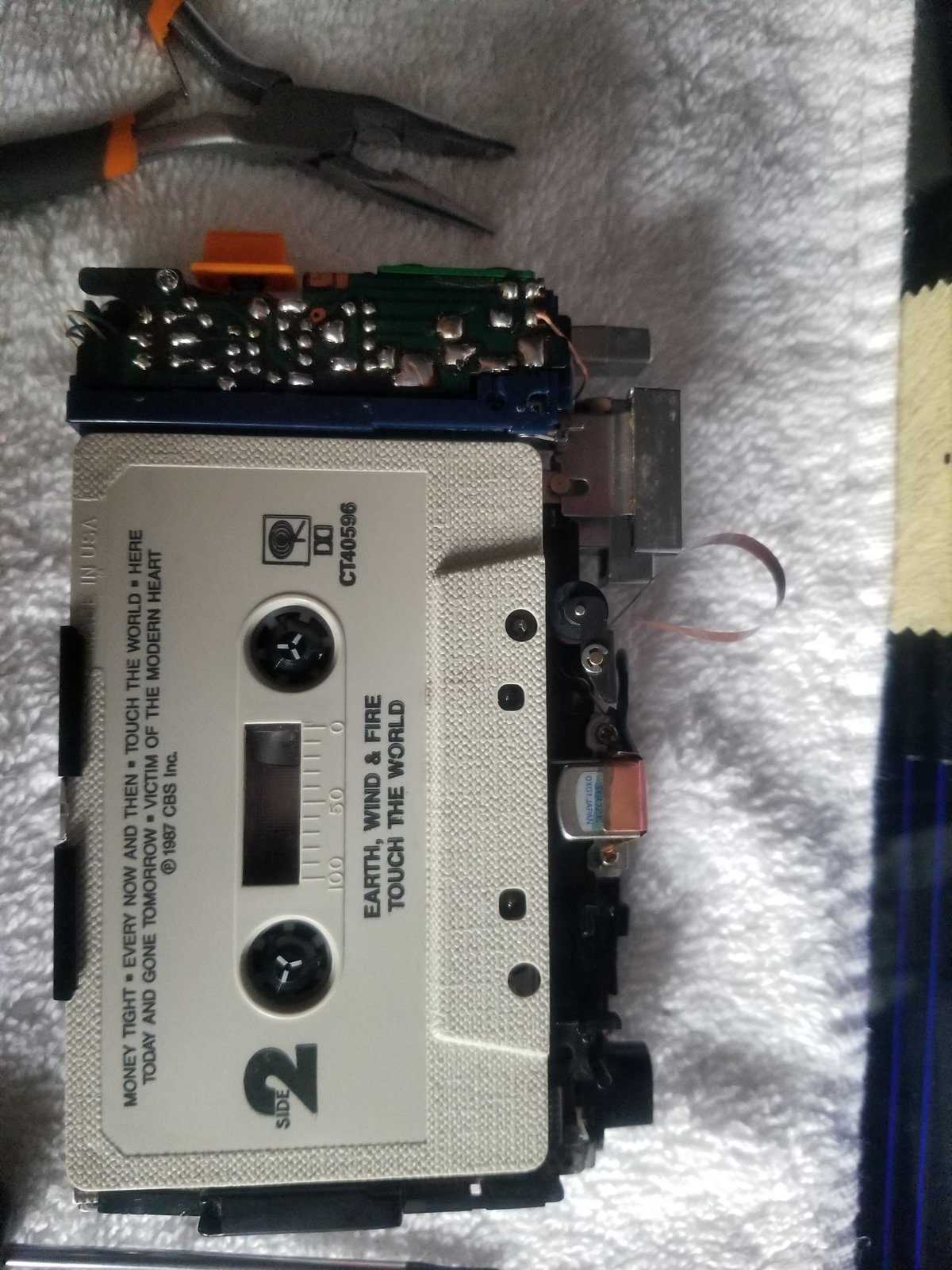

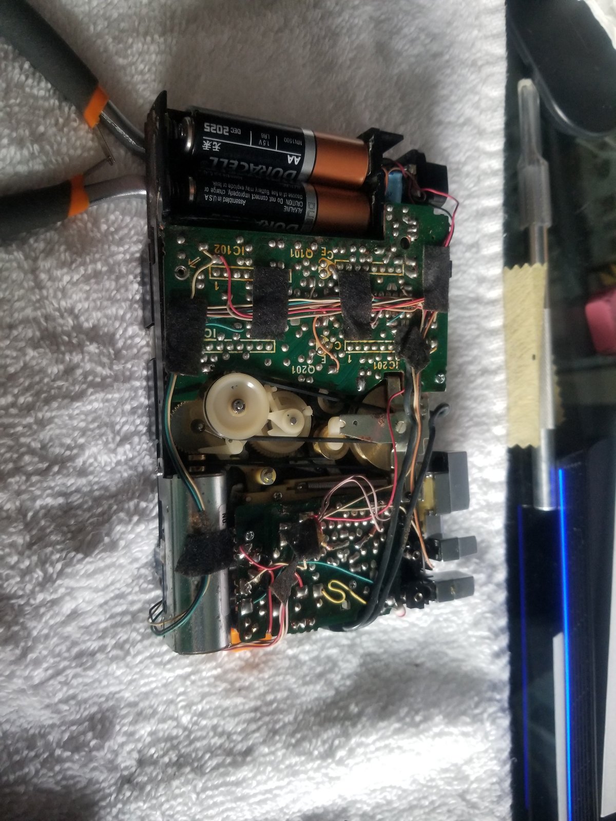

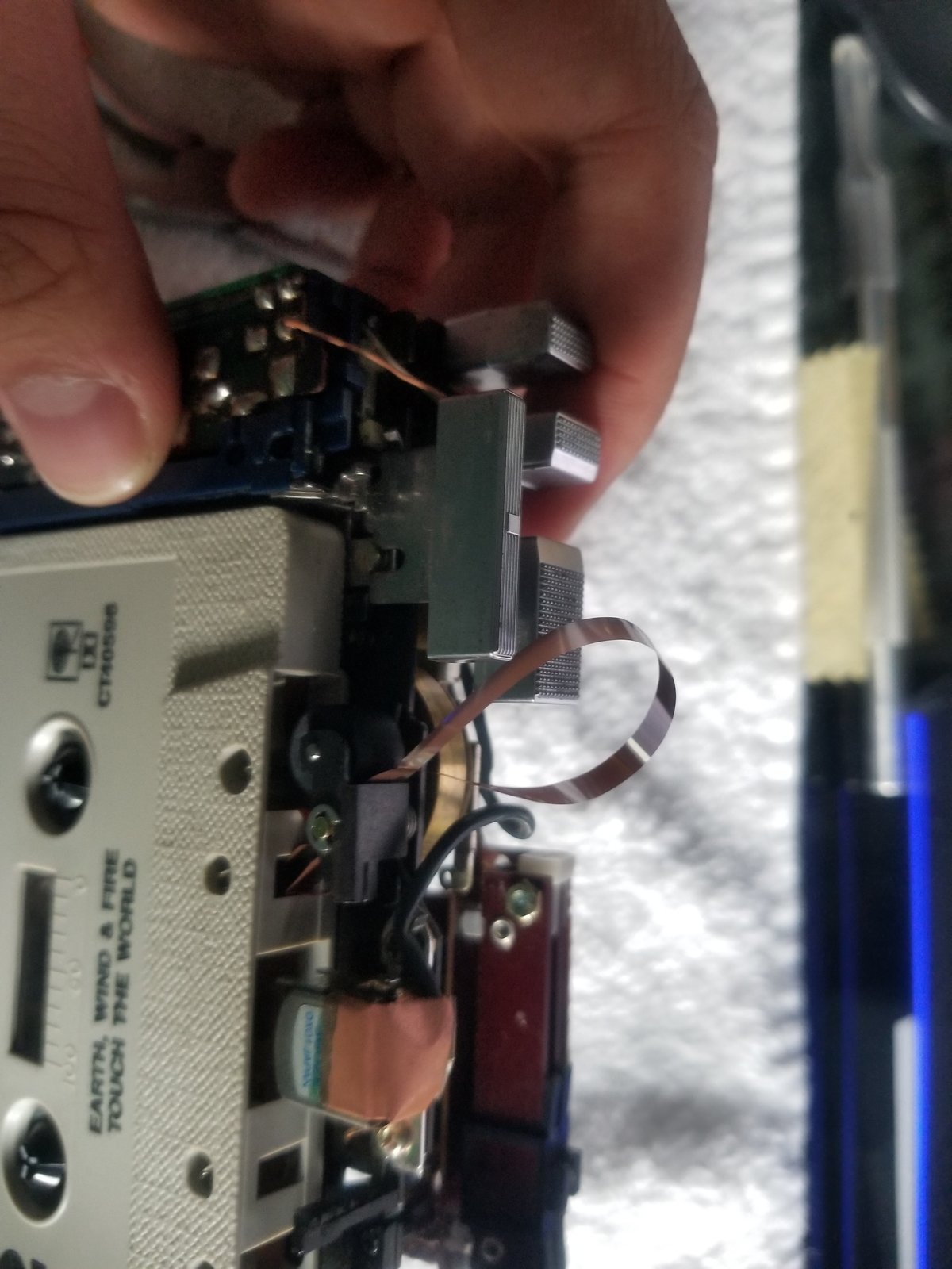

    Hi all,
    I recently acquired a Sony Walkman TPS-L2. I've replaced all the belts. I tried to play a cassette and it didn't reroll the tape back into the cassette, it just started spooling it out of the top. I believe the culprit is that the other roller isn't rolling the tape back into the cassette. Please help. My mother's birthday is on the 17th but I leave for college on the 12th. Also, What is the best way of retouching or replacing the decals and prints on the body (not shown).

    The belt that attaches to the motor is not a normal circular loop. It has to be inverted so it's like a figure 8.
    Get this wrong and your take up will spin in the wrong direction compared to the capstan and your tape will just spill out as described.

    Im going to make a few assumptions here based on the info
    Tape spools out because the take up hub is going counter clockwise due to the belt being attached to the motor wrong.
    You have subsequently sorted that issue, but now the sound is dull and flat sounding?
    If this is the case, you have a head alignment issue and this is a doddle to fix. But we probably need to clarify the first points are correct first
