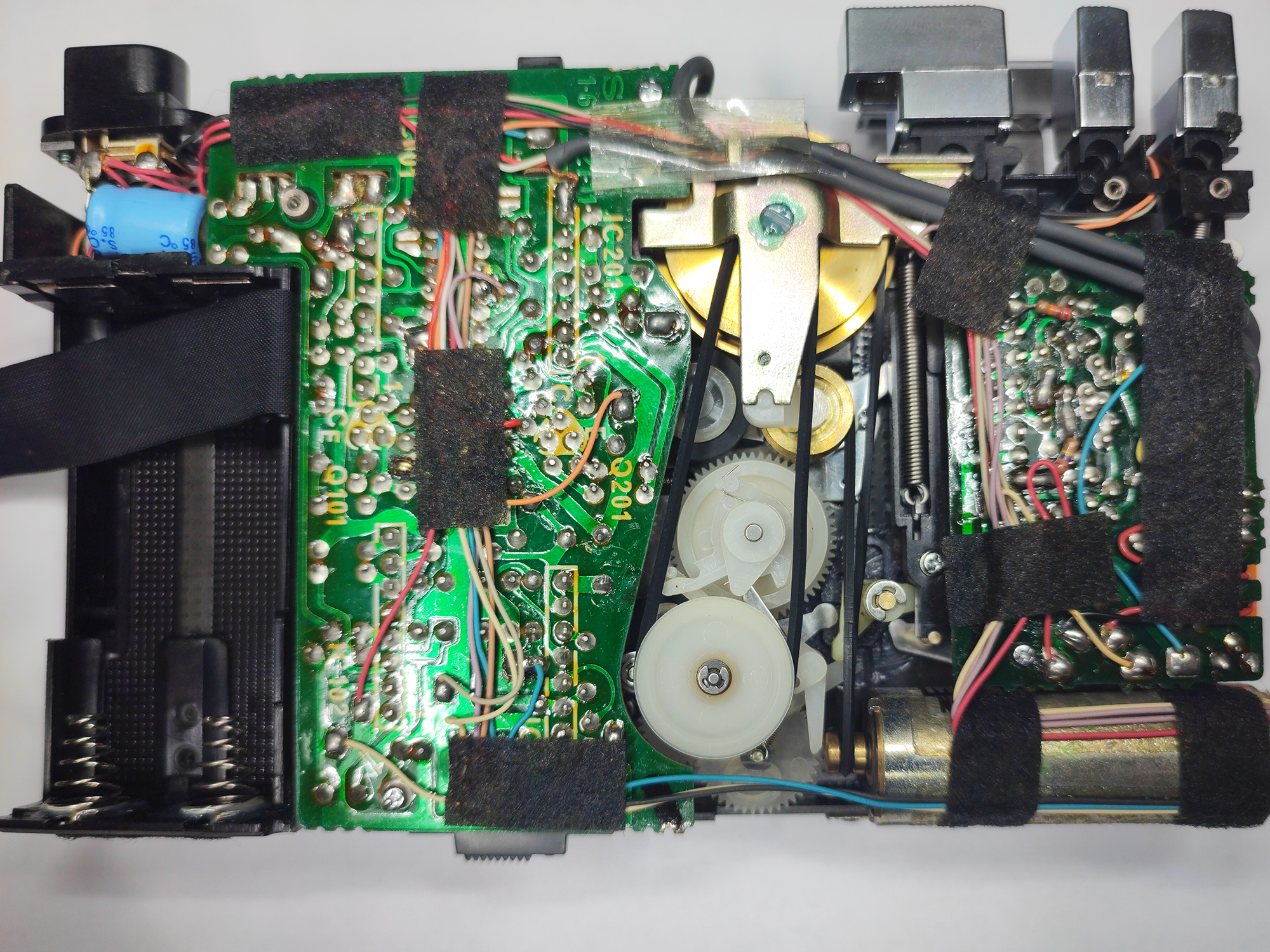

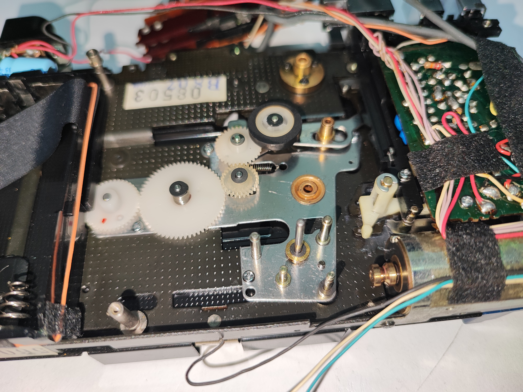

    When the TPS-L2 arrived, I immediately opened it up to see why it wasn’t working (I suspected the belts). As you can see, the interior of this Walkman is in pretty good visual shape, and I believe no one had opened this TPS-L2 before me.
    The first thing I noticed when I opened it was that the motor was seized. But with a few turns using tweezers and a few drops of sewing machine oil, I managed to unseized it, and now the motor spins without any issues, and it doesn’t make any unusual noises. During the same session, I replaced the belts, idlers, and the pinch roller. When I reassembled it, this is how it played music – Cue sound of a dying coyote:

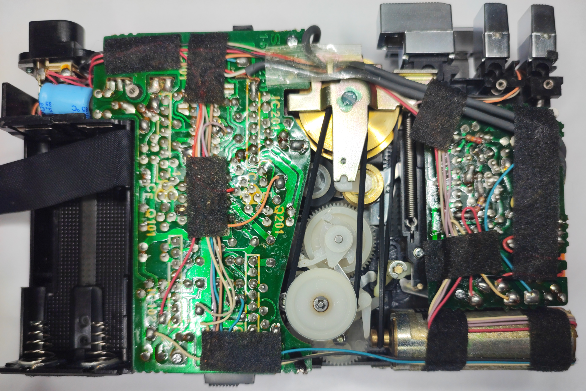

    I then disassembled the Walkman AGAIN and this time took out ALL the gears and wheels. I washed everything in alcohol, cleaned all the shafts with alcohol too, and following Valentin’s instructions, lubricated everything with sewing machine oil. I only used multipurpose lithium grease in two spots where he indicated.
    NONE OF THIS HELPED, THE SPEED IS STILL TOO SLOW.
    What I noticed is that without a cassette inside, all the gears spin constantly/at the same speed, without skipping or slowing down. You can see it here:
    But as soon as I insert a cassette (I tried multiple tapes – it's not the tapes), everything slows down, and you can visually see how much the speed has decreased and how the main gear “skips”:

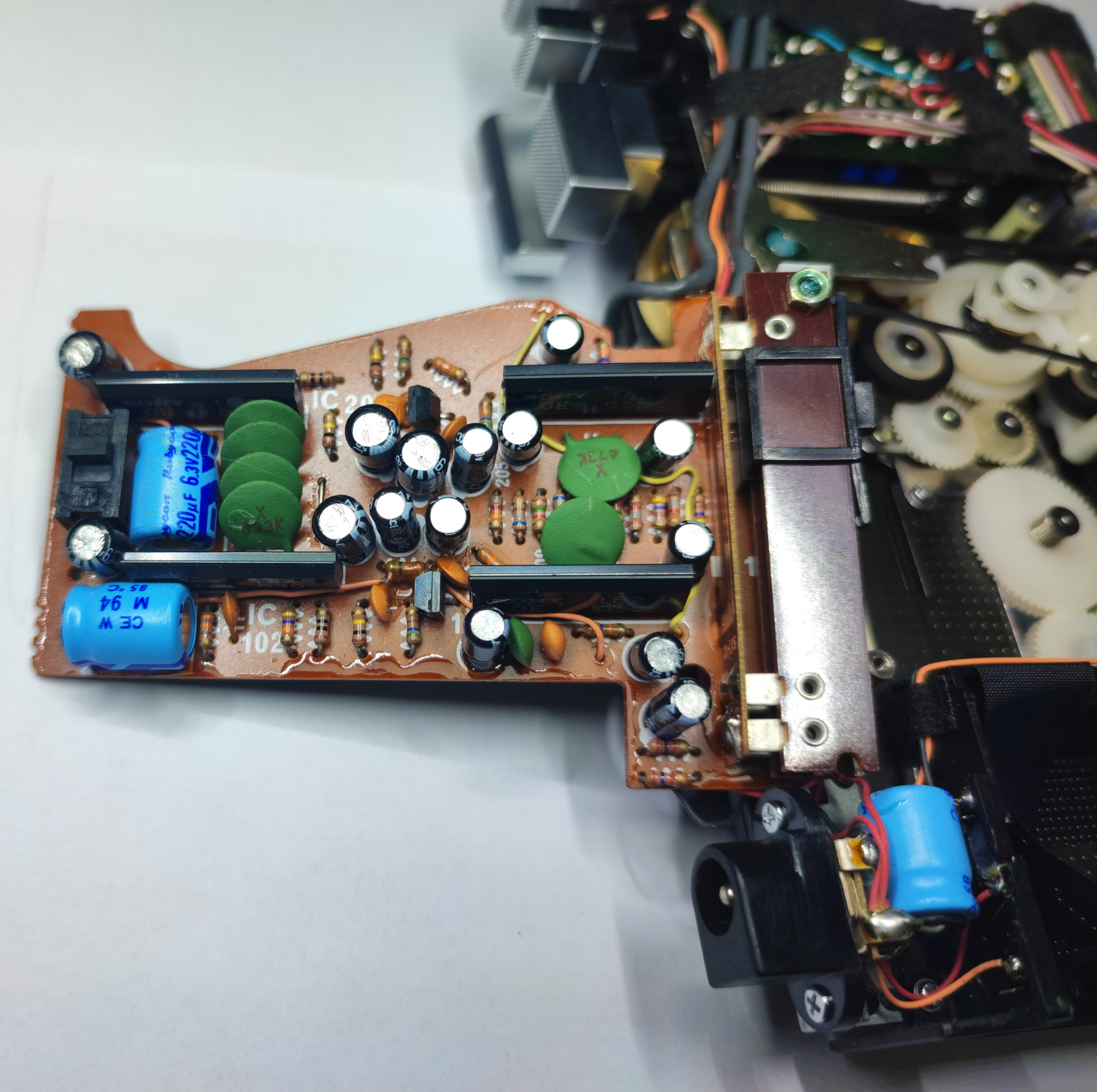

    At that point, I thought maybe some of the caps on the Servo Amp Board were bad, and the motor wasn’t getting enough voltage (from what I see in the schematic, the voltage on that rail should be 1.3V), so I did some measurements with and without a cassette:
    Voltage without a cassette:
    Voltage with a cassette:
    I'm currently out of ideas... Maybe I missed something, maybe I forgot to check something, maybe something didn’t cross my mind. If you have any other ideas, don't hesitate to write.

    The fact motor voltage is higher with load (a cassettte in) is normal, it shows the servo is compensating for the higher load, thus regulating the speed. That is what it's supposed to do.

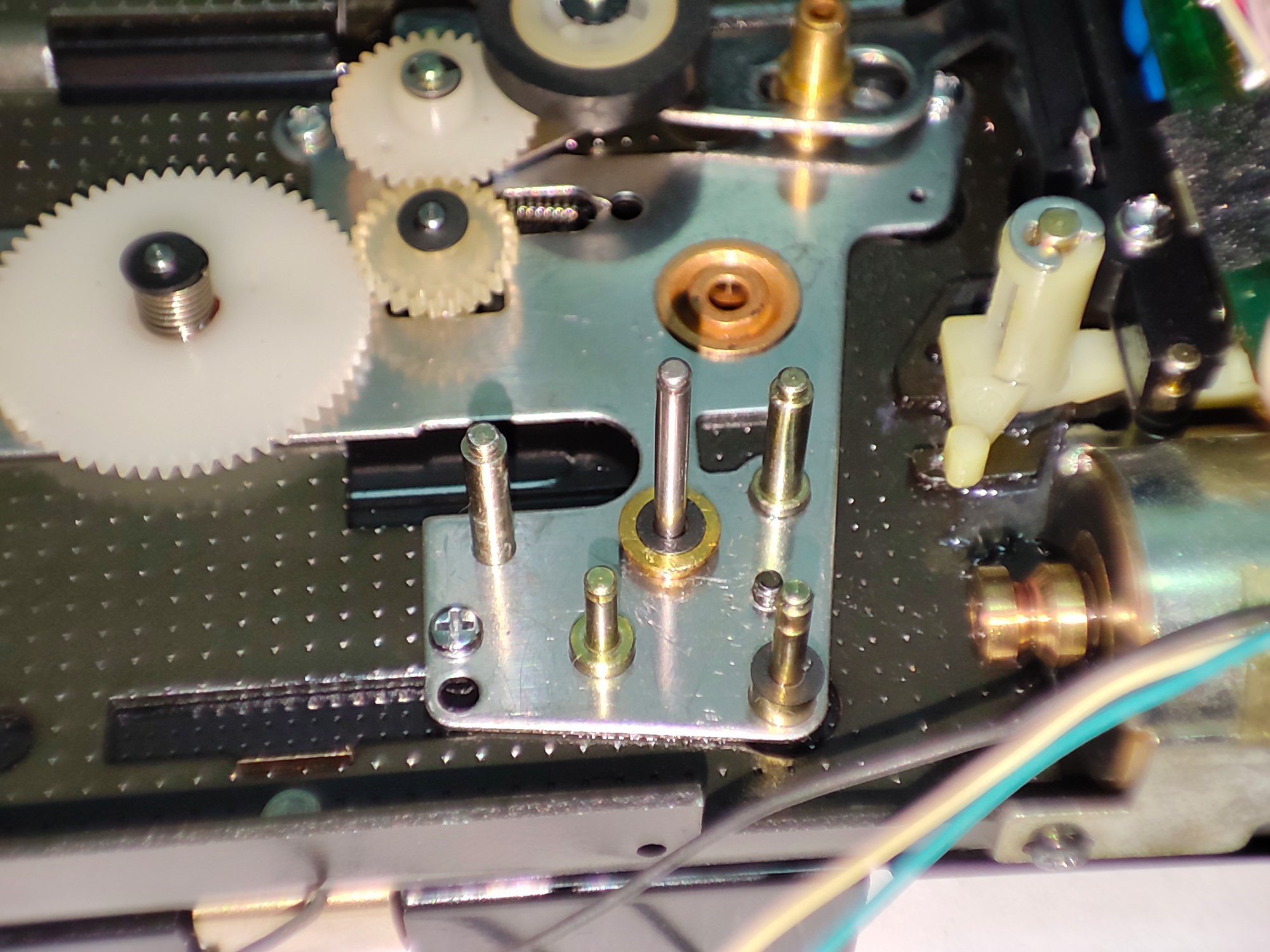

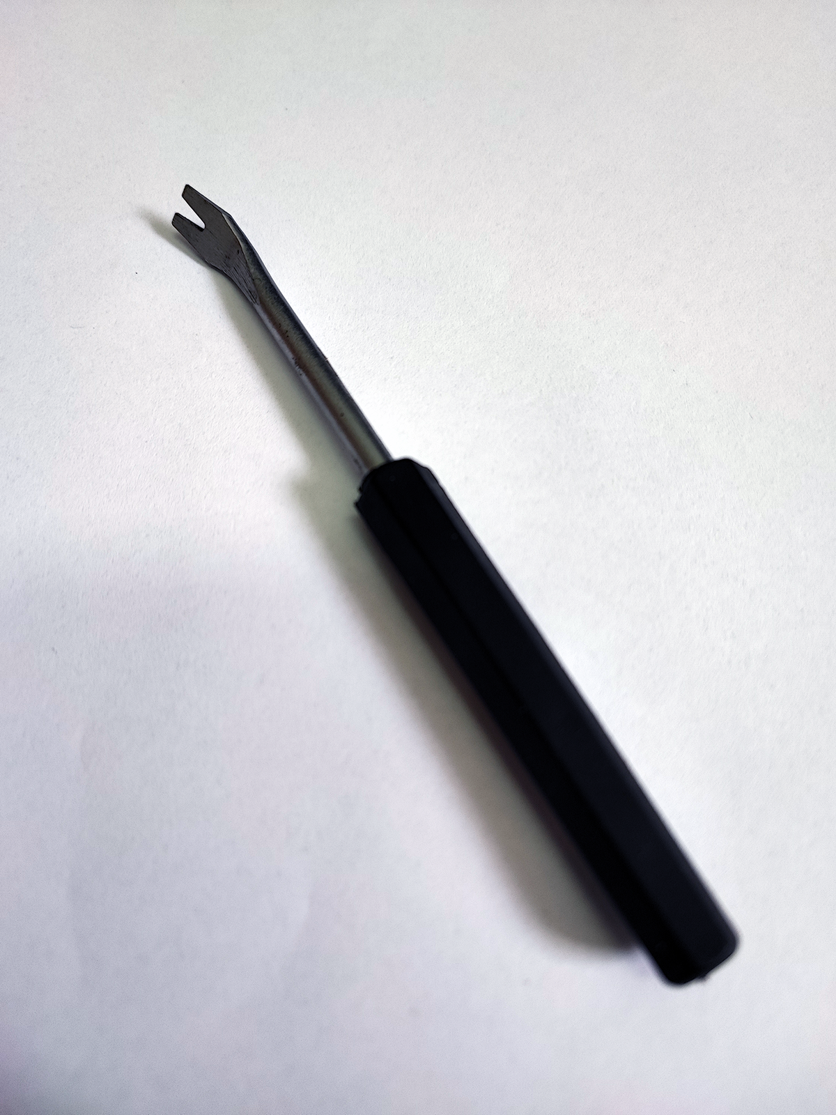

    I did. After I took all those other gears out (don't know which one's called what just yet) I used this lever/pry tool on the front - it wasn't hard at all.
    Used this tool to remove takeup reel

    Well, that's interesting. Does your takeup reel have a brass retainer or the shaft is pressed just into the plastic reel ?
    I asked because on all TPS-L2 units I've seen, there's a brass retainer which is very hard (meaning it won't come out without a puller) to take out.

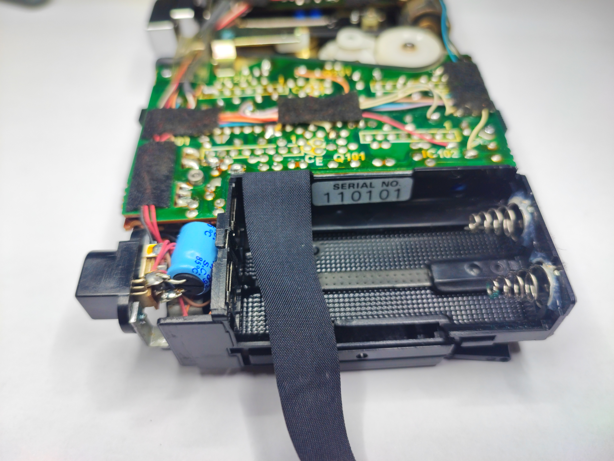

    What's your TPS-L2 serial number and what PCB does it have ? The one with electrolytic caps or just tantalums ? Please post a picture with components side.
    Emiel likes this.
  7. Mladen Gavrić
    Mladen Gavrić New Member
    20
    Bosnia
    Shaft is just pressed into plastic reel. US Serial No. 110101; It's one of the earlier Gen 2, if I'm not mistaken.
