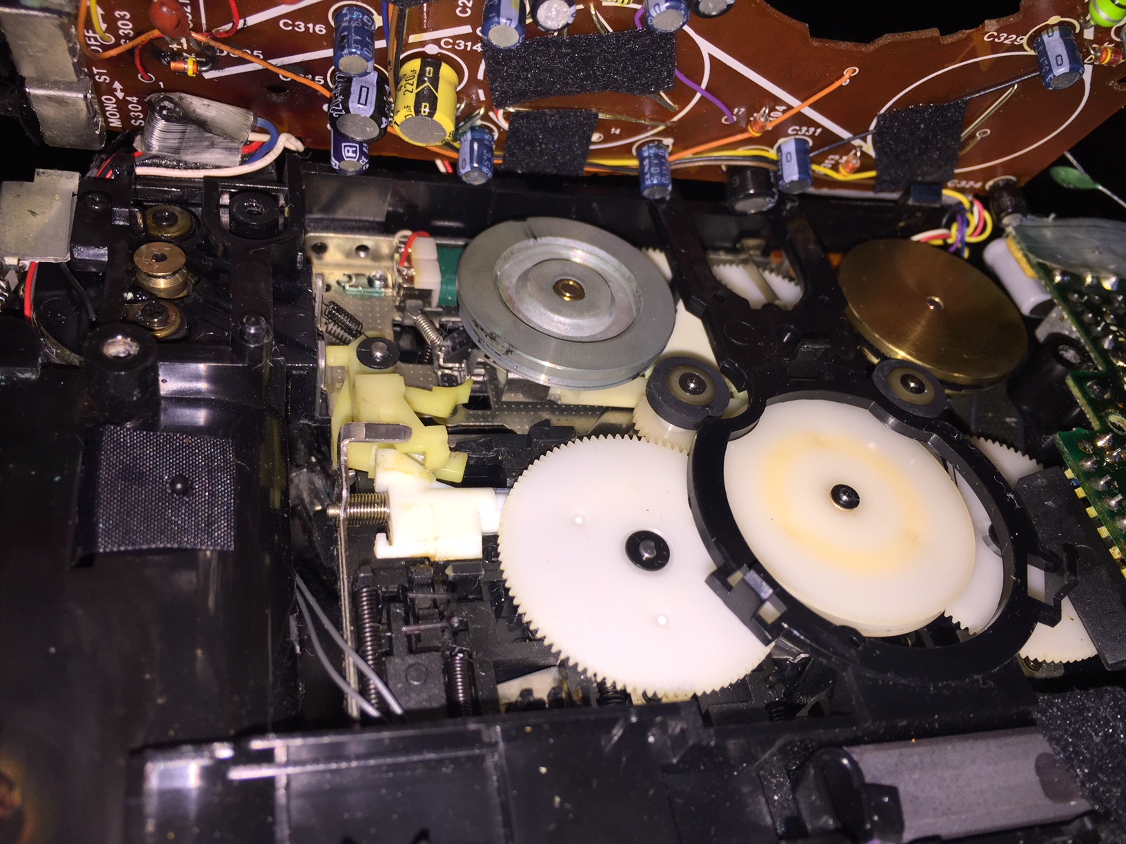

    i'm trying to rebelt my WA-8000 - the initial major belt had turned into black fudge - but i can't figure out the belt-line - does anybody have a pic or manal, please ?
    b.t.w. what a pain in the butt to open that thingy :scratch2

    thanks matey, got it - unit is rebelted but still gives me trouble because i don't get any sound from cassette - as lovely as this unit is - i hate it for beeing such a (mechanical) misconstruction :hmmm
