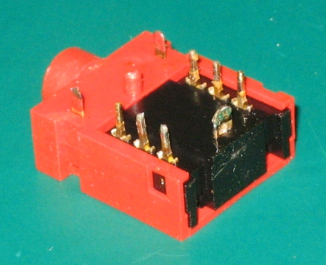

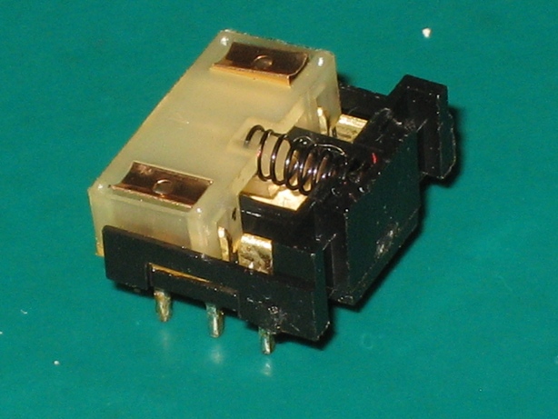

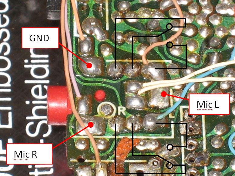

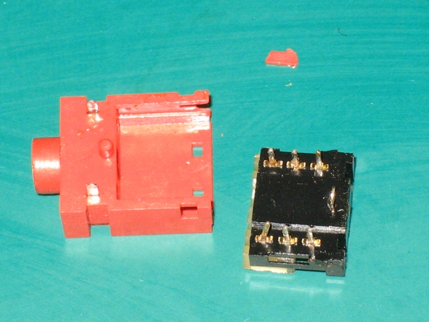

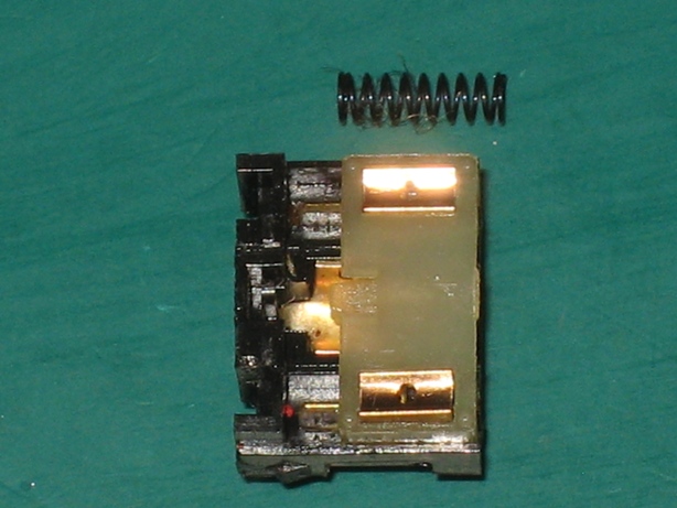

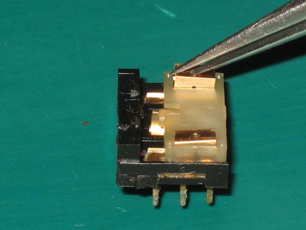

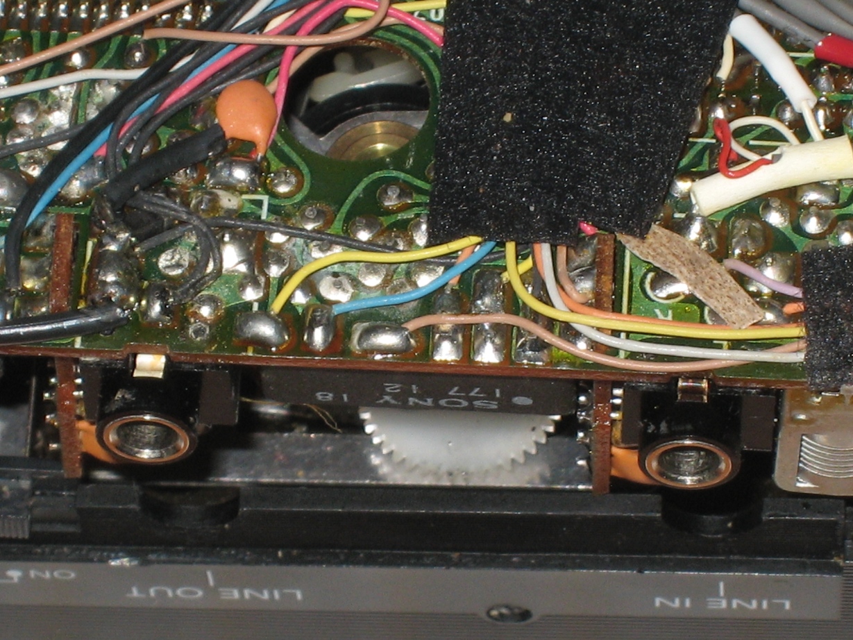

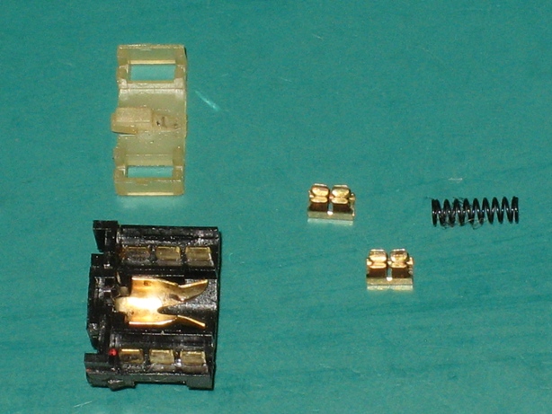

    I had a look at the Mic socket from my scrap D6C and it does have a 2 pole changeover slide switch built into it. The switch is in a separate module which can be removed and taken apart. The switch changes the inputs into the record level potentiometer from the Line In socket to the outputs from the Mic Pre Amp when a jack plug is inserted into the Mic socket.
    Here are some photographs.
    You will need to be very careful removing the switch module from the red plastic Mic socket casing, which is very brittle and will break easily - mine did.
    WM-D6C schematic showing the Mic socket and Line / Mic automatic switching.
    Position of the Mic and switch connections on the PCB.
    The Mic socket with switch module.
    Take care not to break the red socket when removing the switch module - it's brittle.
    The switch module.
    Remove the spring - be careful doing this.
    Lift out the wipers. They will lift out easily.
    The switch module disassembled.
