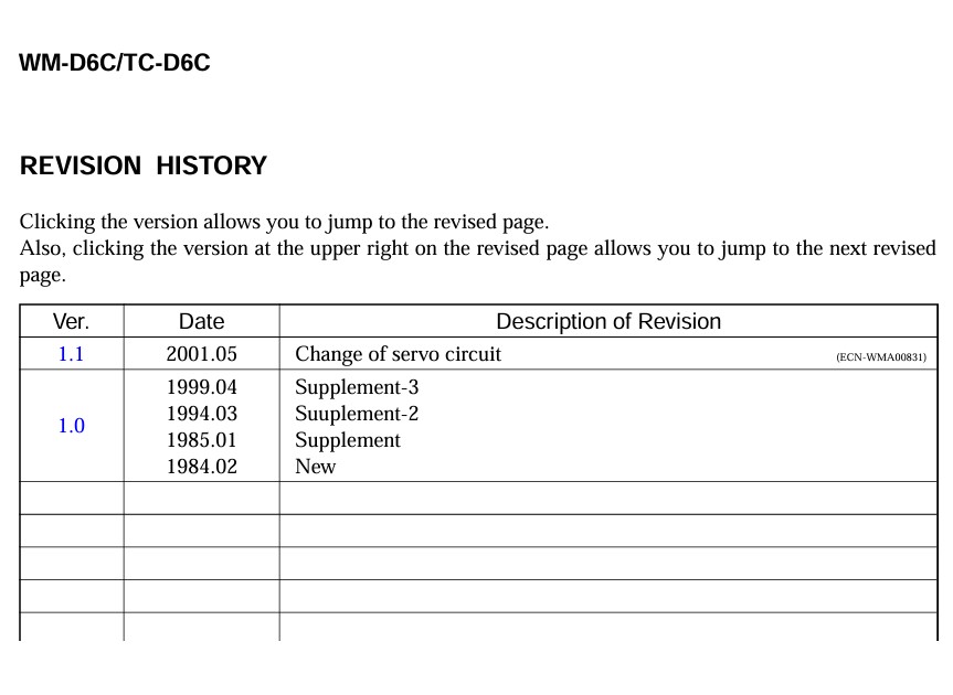

  9. Silver965
    Silver965 Well-Known Member
    715
    Torino
    I confirm what is written I looked at the entire manual with the revisions that
    I have I found the changes made to the circuit with the various components as explained by @dotneck335
    This is the last page of the manual with the dates of the revisions starting from the bottom 1984 when it came out...going up
    The 35712 head in the manual that I have is not seen anywhere and probably Sony has never specified this modification

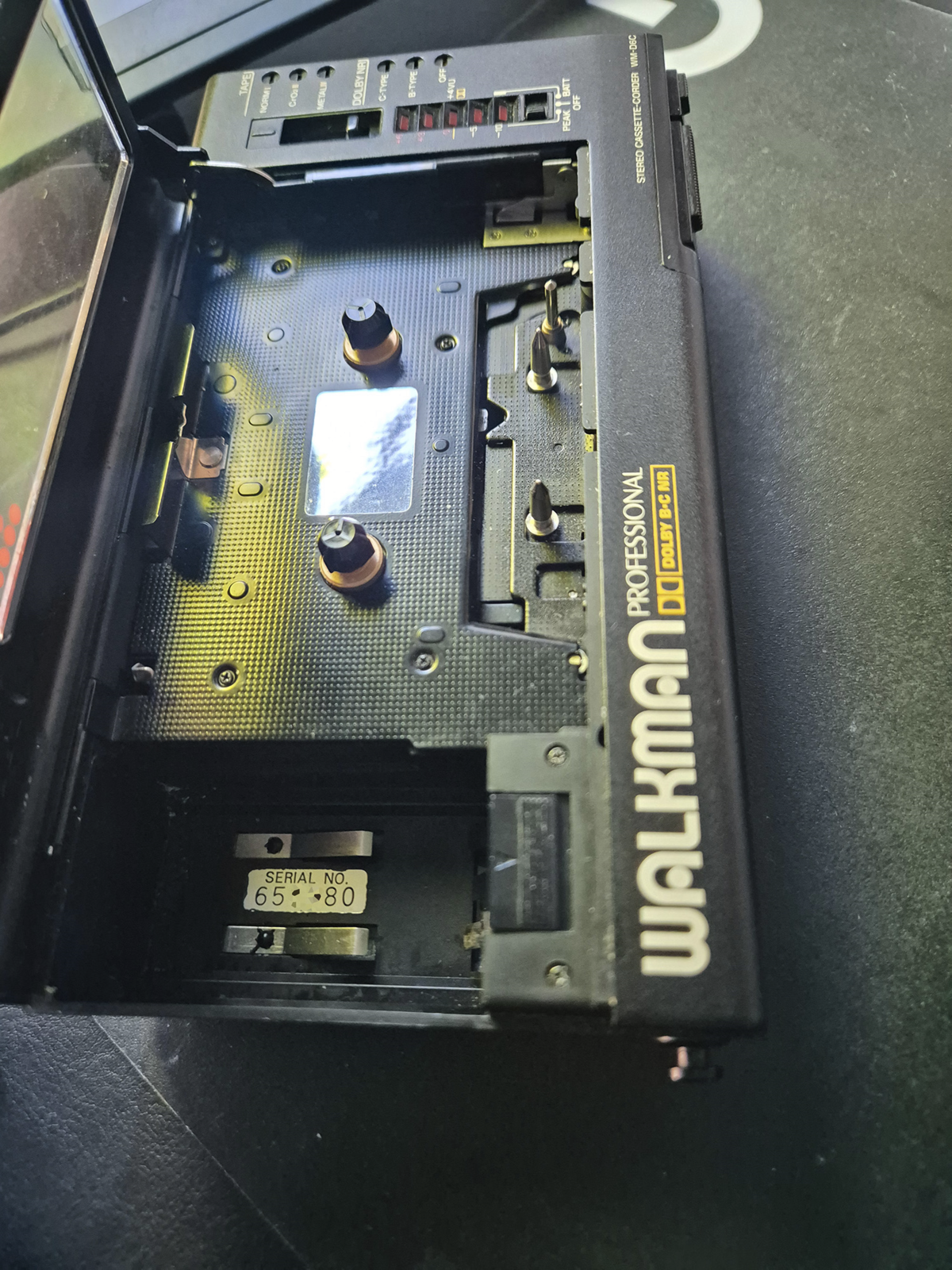

  12. djsubtronic
    djsubtronic Member
    40
    I got a weird one, my D6C has the regular non-pointy 35711 head and the old through-hole PCB, but the serial number is 651xxx..... :areyousure:

  14. dotneck335
    dotneck335 Active Member
    119
    Los Angeles, CA
    "I got a weird one, my D6C has the regular non-pointy 35711 head and the old through-hole PCB, but the serial number is 651xxx..... "
    Are you absolutely SURE that number has SIX digits? It sure sounds like a five-digit unit.
  15. djsubtronic
    djsubtronic Member
    40
    Yeah 100%... the only explanation I have is that someone changed the sticker or something but doesn't make sense or look like it was ever removed. Didn't look like it had been opened up before I got it either.
  16. dotneck335
    119
    Los Angeles, CA
    In all my research, I have NEVER seen a serial number that high----highest has been in the 50xxxx range. Got a picture of it?
  17. djsubtronic
    djsubtronic Member
    40
    Sure, here it is:

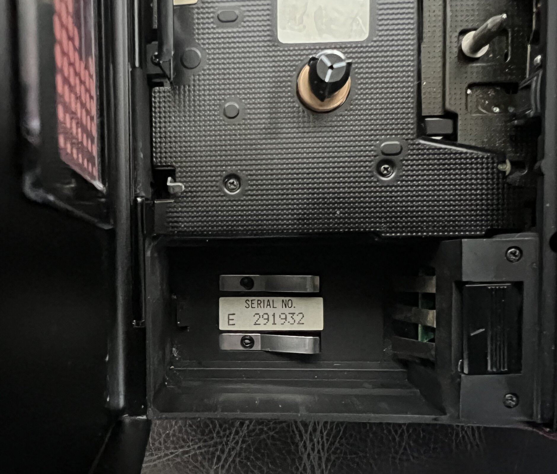

  20. Kiwinut
    Kiwinut Member
    78
    New Zealand
    I wonder if it’s had a head job at one stage?
    Can anyone shed some light on my serial number
    Cheers Kiwinut
