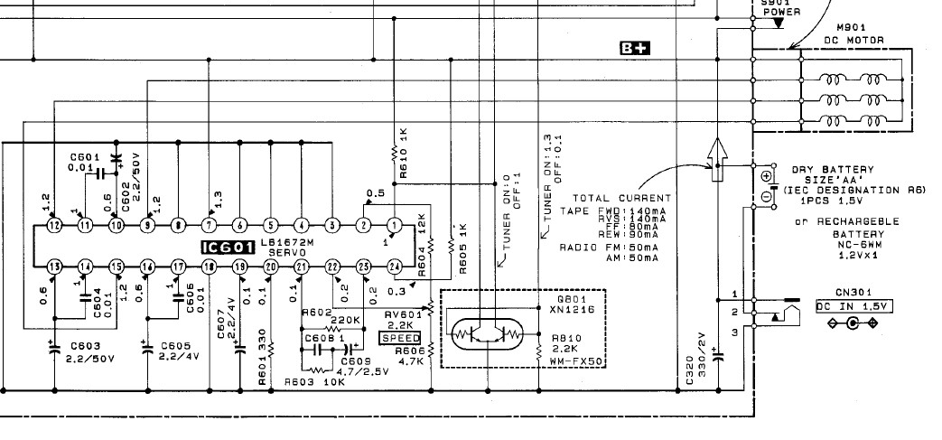

    I got a non working SONY WM-EX50 for free.
    No sound - I hope a recap will fix this.
    The motor is acting strange - changing speed, weird noises and I have to apply light pressure on the PCB where the flex cable is connected, that it even spins.
    I suspected the flex cable, desoldered it and it measured fine.
    I lubed the bearings a little bit, the motor sounds better but I think it is still noisy.
    When removing caps I noticed a strange thing, there are unpopulated solder pads for 2 caps, the caps are present in the schematics (C602, C603) in the motor servo circuit.
    I did find the datashet of the servo chip: https://www.digchip.com/datasheets/download_datasheet.php?id=493793&part-number=LB1672M the caps are not present in the schematics there.
    Any ideas what could be wrong with the motor?
    Why the caps are missing - cost cutting?
