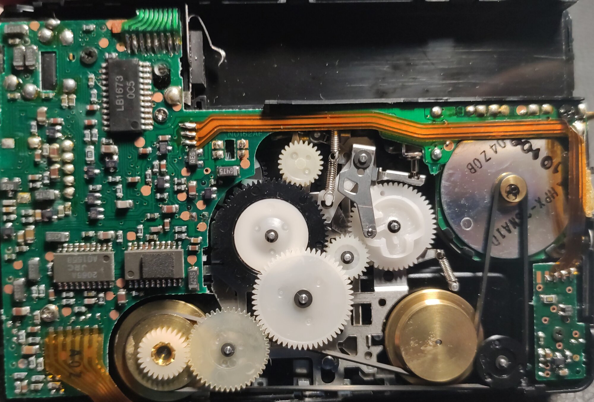

  3. Valentin
    1,382
    1 & 7. Post some pictures of the remote. It must have a seam where it has clips, it's unlikely the entire assembly was molded and can't be opened.
    2. If the original belts are not loose, keep the original ones.
    3. For what specifically ? For shafts of rotating parts watch oil is to be used.
    4. The CP-E7 I serviced had a very high w&f (0.7% WRMS) on FWD and a slight high frequency clicking noise.
    Judging by the w&f figure, incline more towards clutch gears being good. But unless you remove the clutch, it's impossible to tell the condition.
    It's the gear in the middle that is part black, part white. Keep you finger on the assembly while removing the cut washer, because if the small gear is broken, the clutch spring will tend to push everything up and all the parts will end up flying.
    5. Judging by how slim the unit is, it's likely it has no electrolytic capacitors. CP-E7 for example doesn't have any electrolytics, but then the boards are differnt (see picture attached).
    6. Don't think so. Probably the sidecar isn't making a good connection.
    8. Check the condition of the clutch gear and eventually lubricate the motor + capstan bearings: https://stereo2go.com/forums/threads/how-to-lubricate-the-capstan-bearing.7260/.
    For the motor that's loud there's only one solution: to clean and lubricate its bushing.
    Motor is similar to these ones (https://stereo2go.com/forums/threads/how-to-diassemble-and-lubricate-sony-wm-ex-fx-gx-motor.7940/), but the PCB with coils is kept by some metal tabs (which need to be bent back) instead of glue.
    The erratic behavior of playing 2 seconds and reversing may be caused by a dirty FWD/REV switch. The microcontroller doesn't know which side it's playing, so it reverses constantly trying to find the position.
