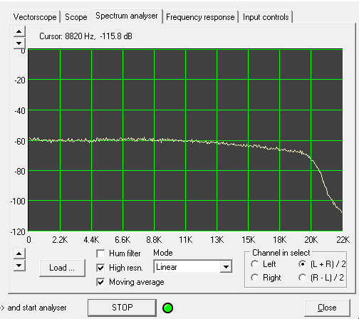

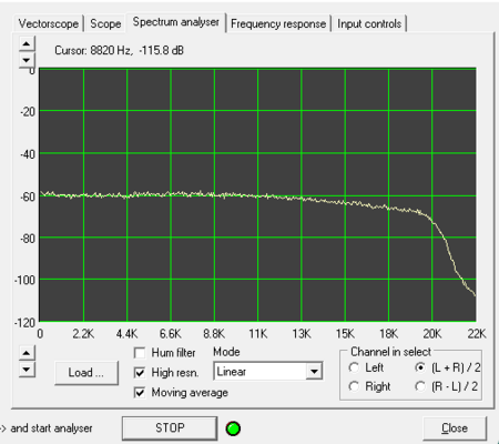

  6. Valentin
    1,548
    I think AIWA considers just the part of the frequency response that is flat (+/-0dB), hence why the apparently poor spec.
    Measurements I've done show that 12.5kHz is right about where the FR starts to rolloff, but the -3dB point is around 18kHz.
    Same is with W&F specs, AIWA gives figures of "<0.45% (RMS)" on top models, but in practice they have much better W&F.
    Also fact they don't put W in RMS can mean they're reffering to the unweighted figure, which will be higher.
