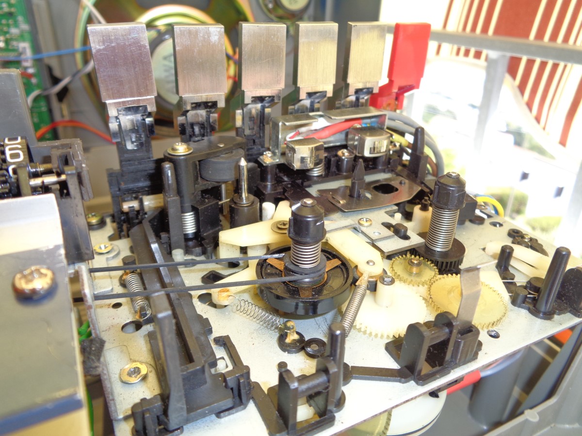

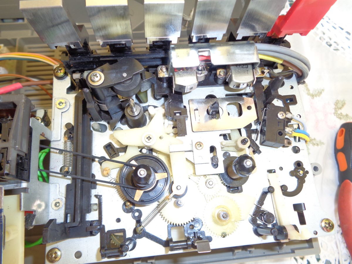

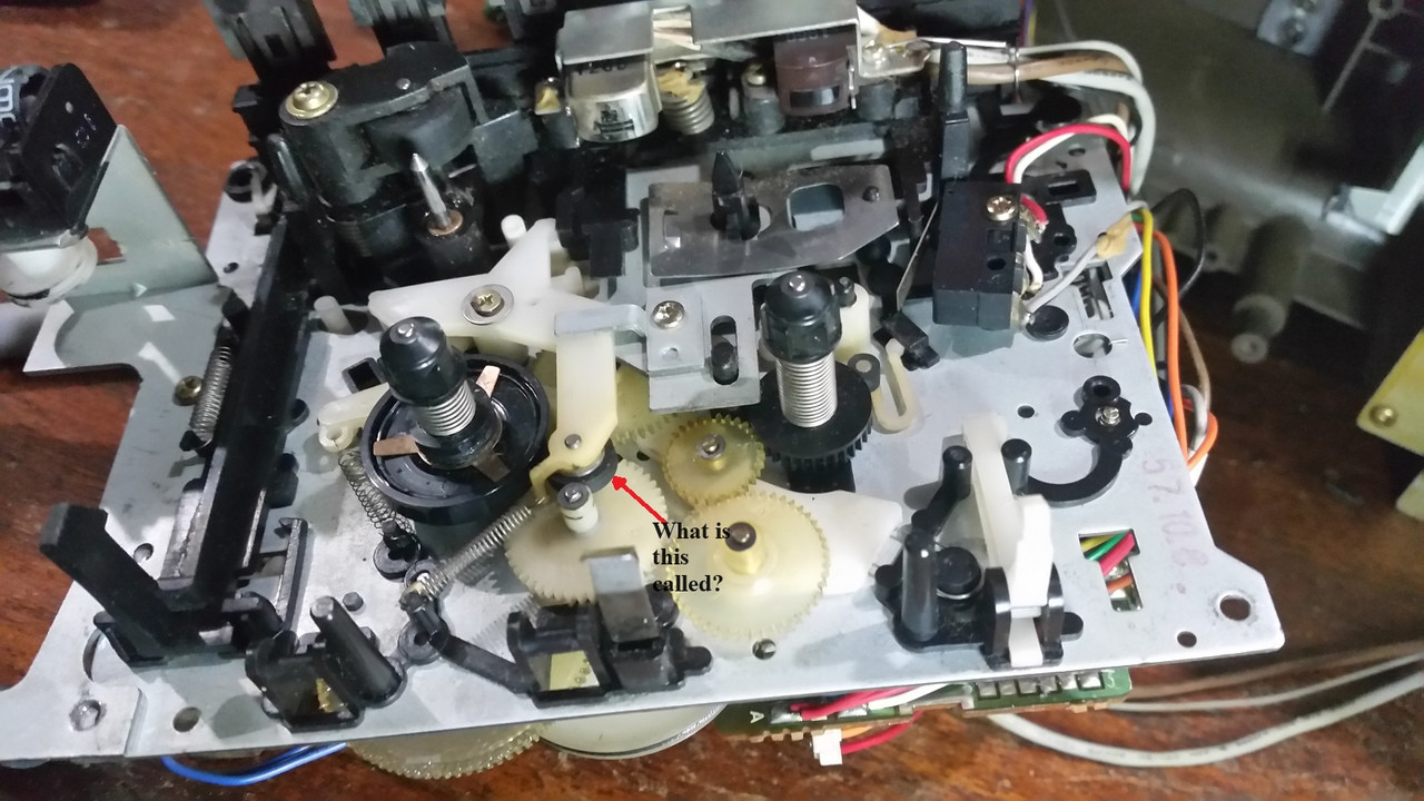

  10. MICHAEL MURRAY
    MICHAEL MURRAY Member
    59
    Dublin Ireland
    Just opened it up and changed the belts.
    But I found another issue , the supply reel is not turning on play , but that is because of the tiny pinch roller in the picture. Its rock hard and needs to be replaced.
    The cog is turning fine but it is not engaging with the pinch roller, probably because the rubber has shrunk and is hard.
    Anybody know where I can get one of these tiny pinch rollers? Thanks.
    15,576
    You might have to mic it for OD/ID and look around the net, some of the information on this site might help
    https://www.russellind.com/prbline/prb.htm
    In a pinch you might be able to find rubber tubing with the same dimensions.
    MICHAEL MURRAY likes this.

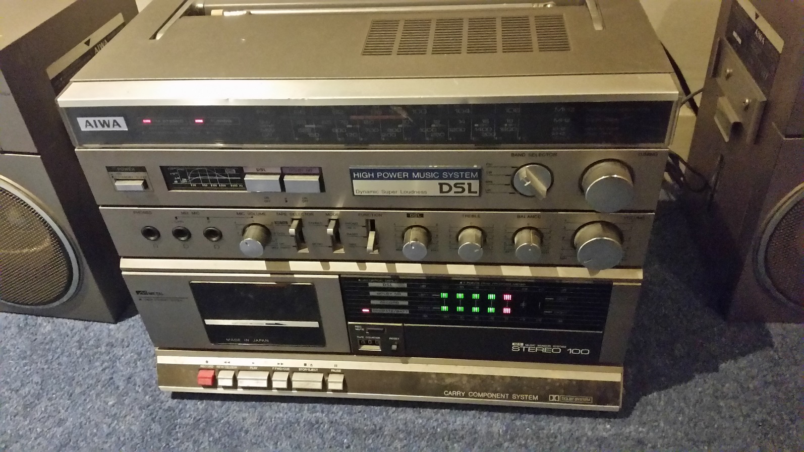

  12. Silver965
    Silver965 Well-Known Member
    710
    Torino
    it has the same mechanics as the cs770...and similar
  13. MICHAEL MURRAY
    59
    Dublin Ireland
    Thanks a lot guys. I managed to pick one up on eBay for €10. LOL.
    Ill fit it at the weekend.
