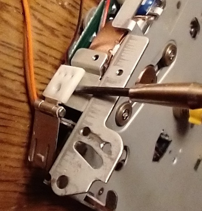

    11. The battery plate or lid is soldered to the main board and screwed to a small metal and white plastic plate attached to the chassis. Remove its screw. The white plastic part of the plate includes a hidden pin that indexes into its small metal support plate. While lifting that corner of the main board, use a very thin pry tool to disengage the locating pin. This way you do not have to desolder the battery plate from the main board.

    12. The YORB and red/black wires have to be fed toward the chassis, through the gap between the main board and the motor board. The motor board is surprisingly flexible, to a point, for clearance.
