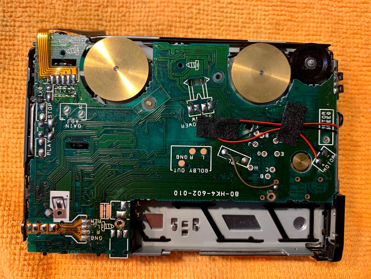

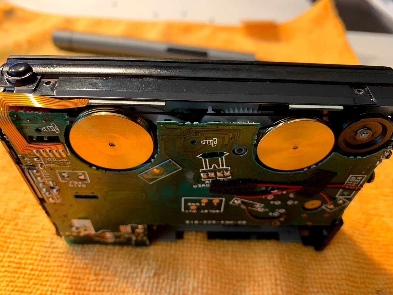

    I have this nice looking Aiwa hs-p505 mk2, which is in desperate need of belt replacement.
    Since I don't have the service manual, and I was unable to find it, do you know which parts of the main board needs to be unsoldered in order to have access to the pcb ?
    In the pictures below I already removed the screws but the pcb refuses to free itself :)
    Thanks !

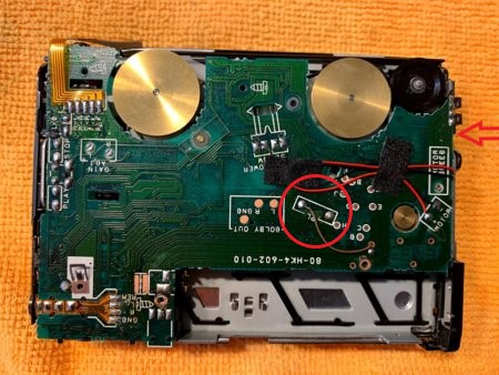

    Hi, see edited picture below red circle desolder these 2 points and remove the screw arrowed if you haven't already done so, hope this helps.

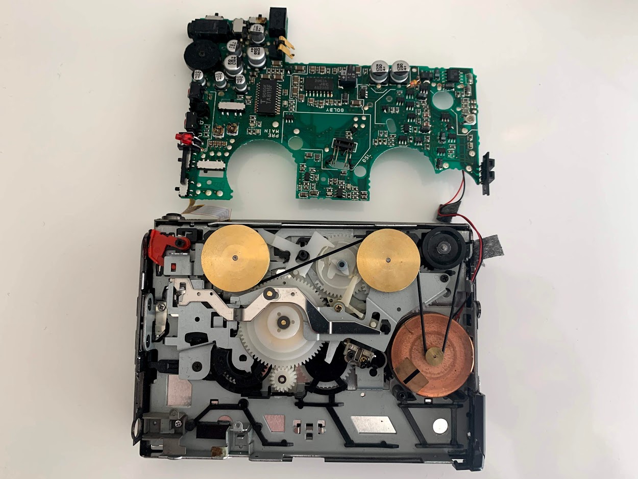

    Success !
