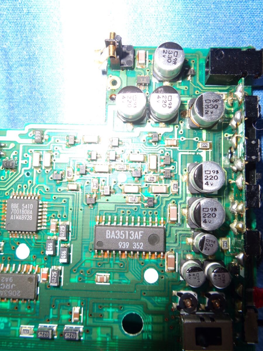

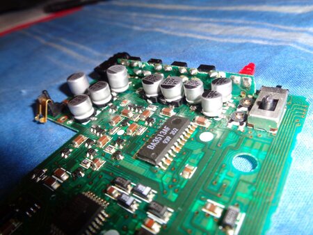

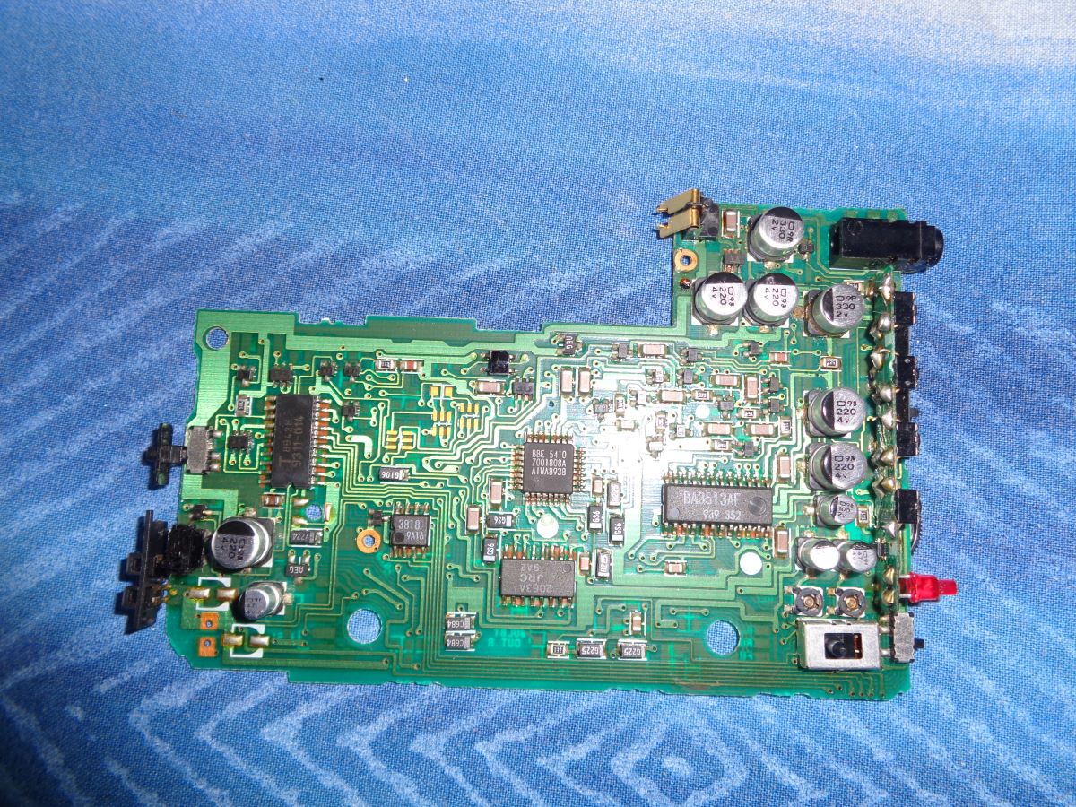

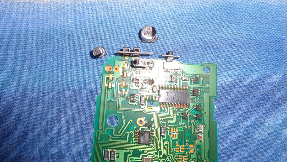

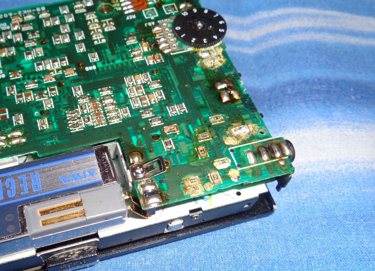

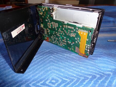

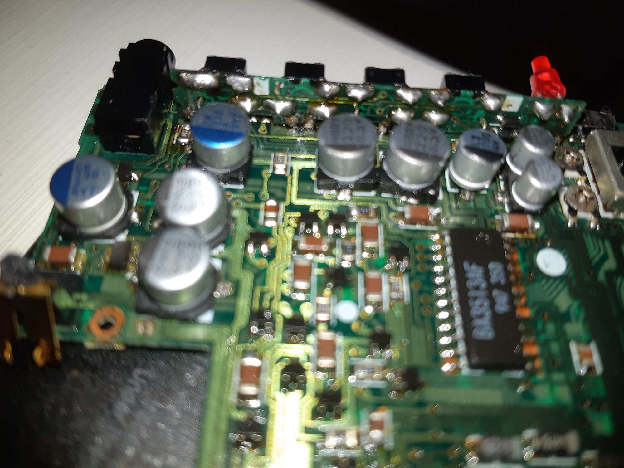

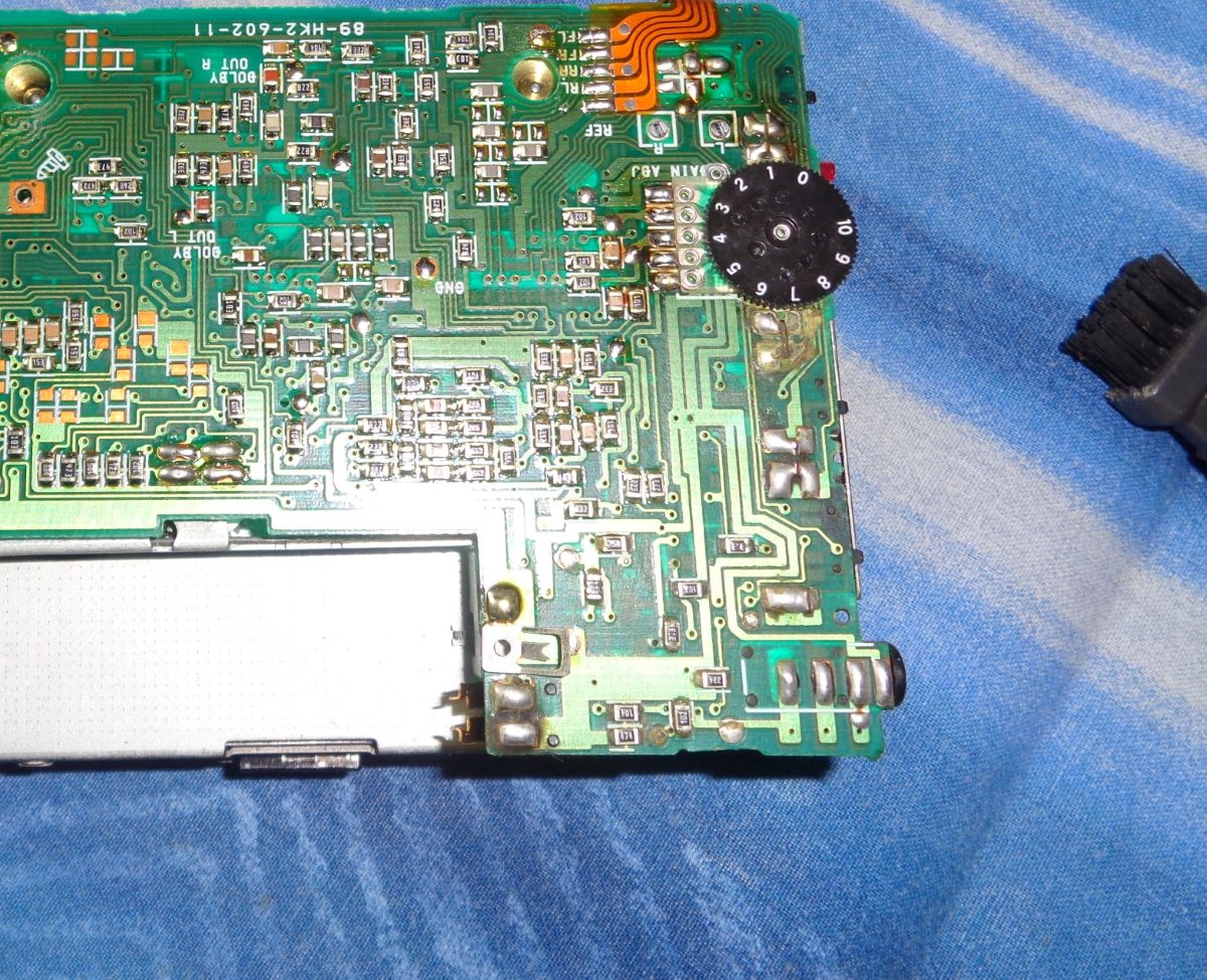

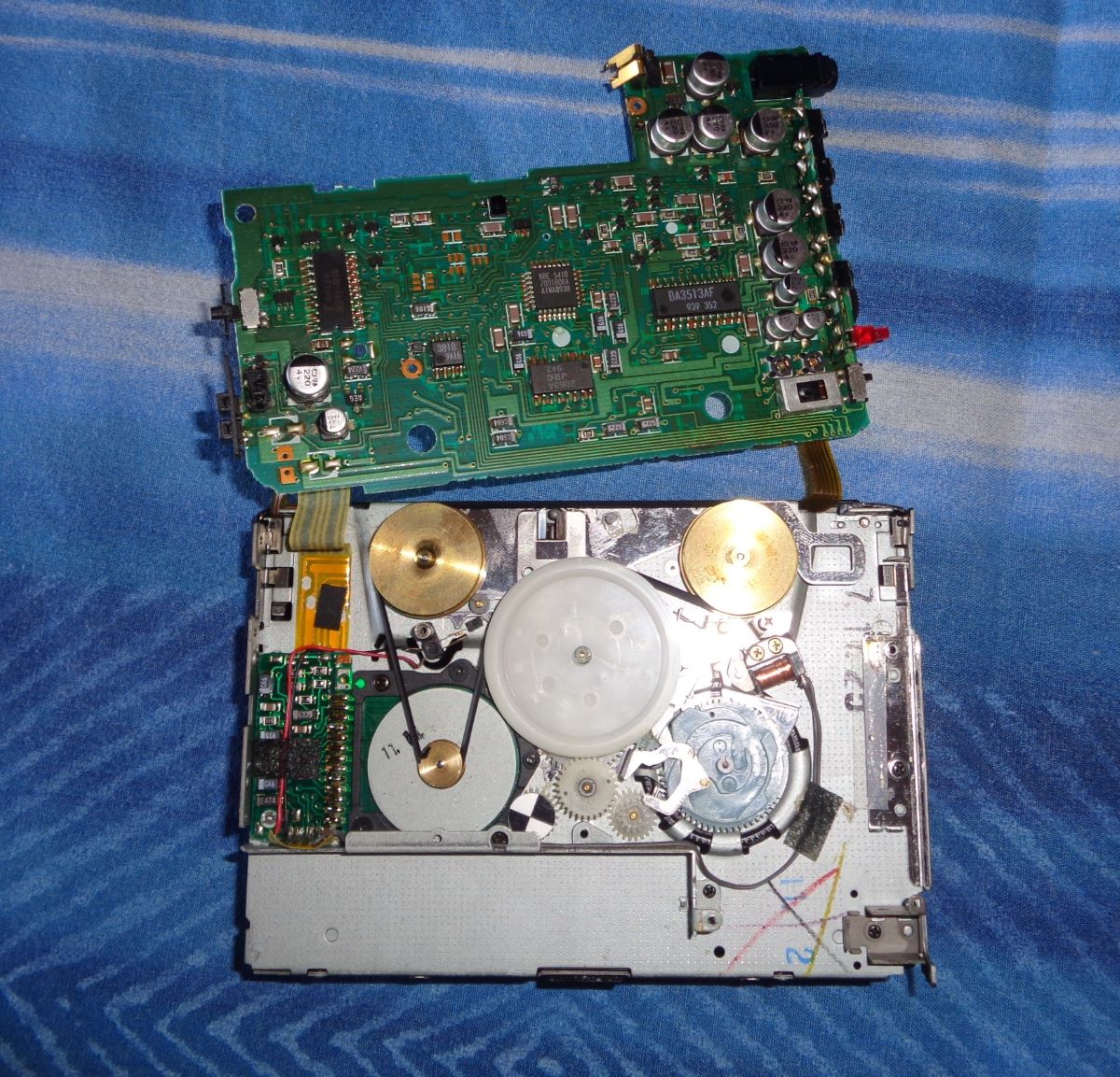

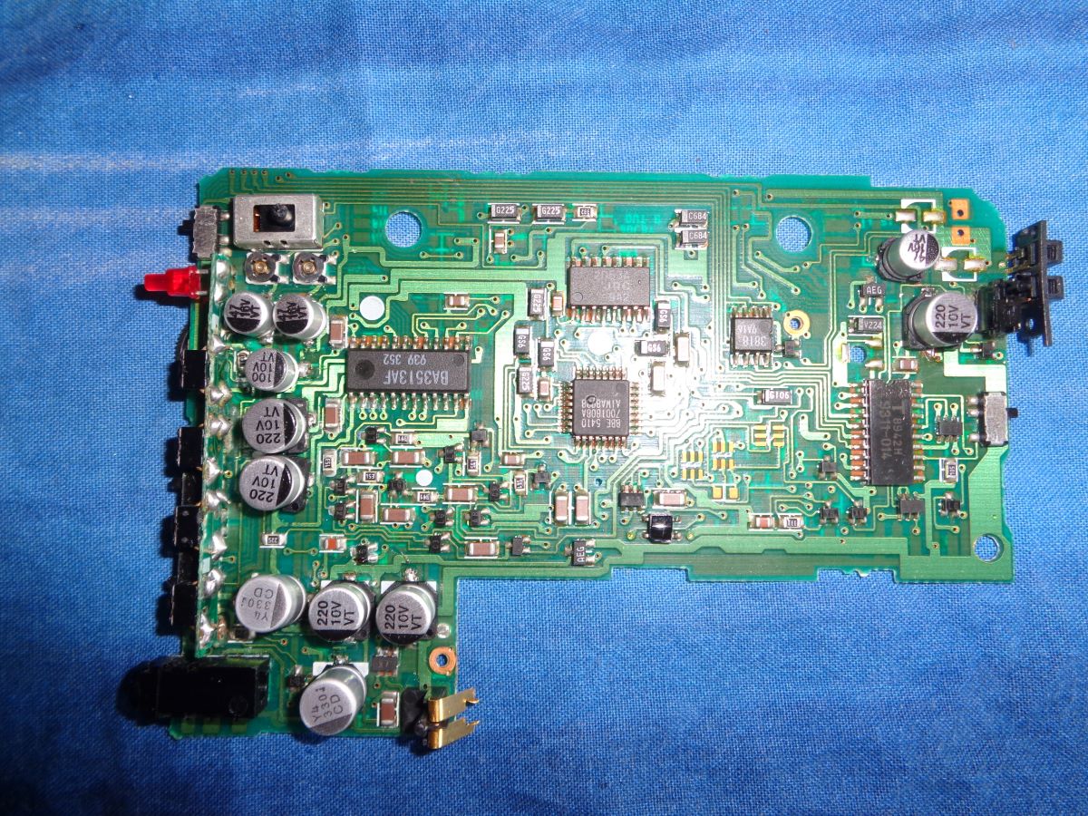

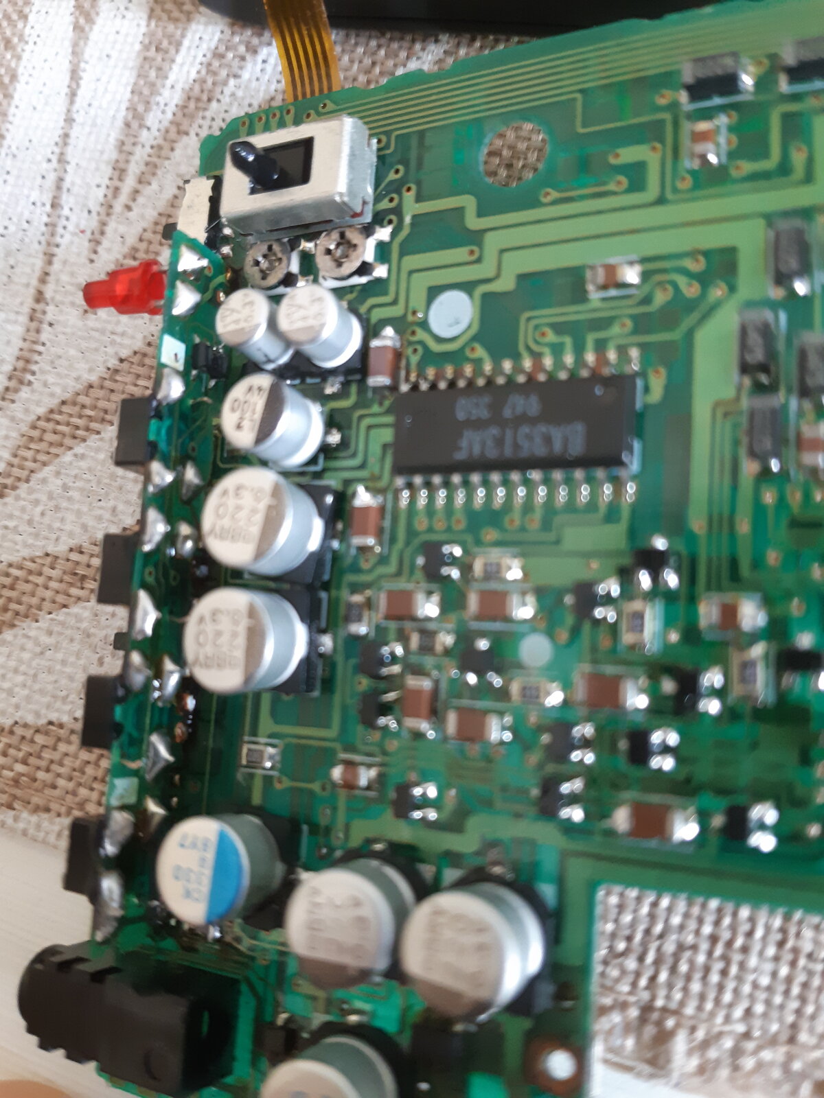

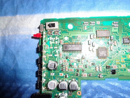

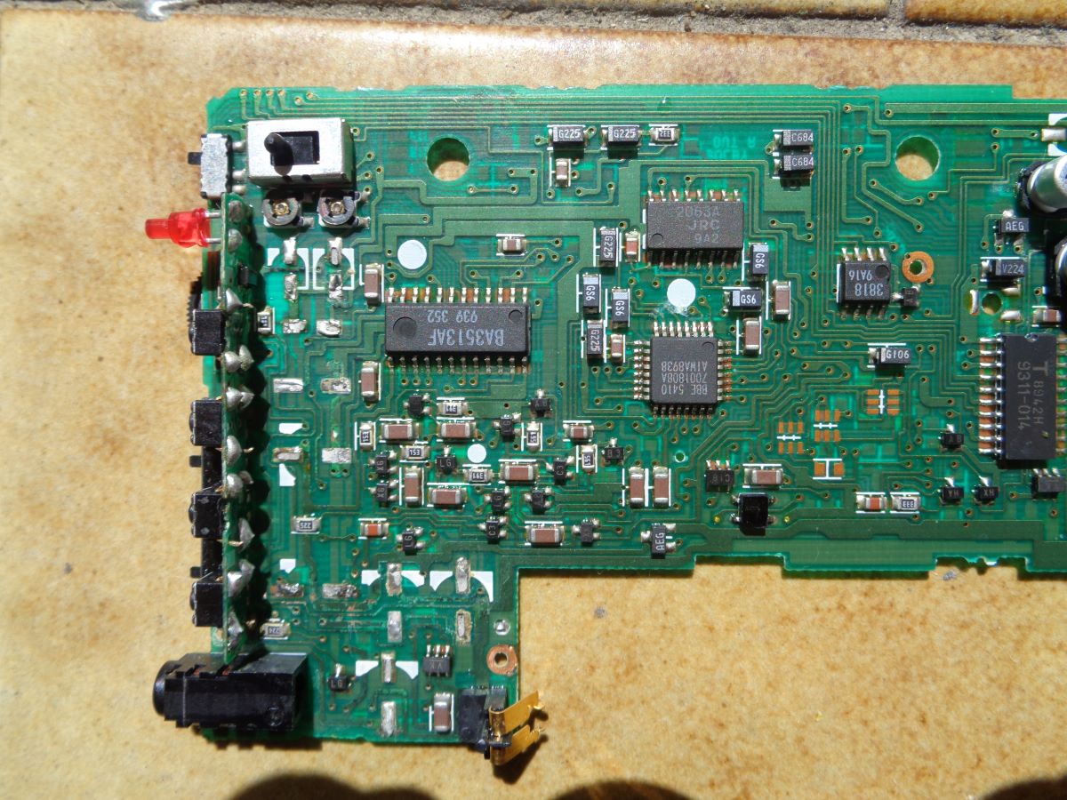

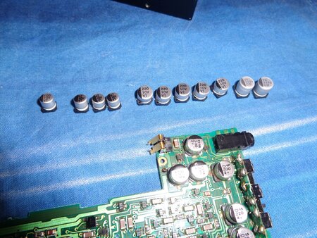

    This week I reset this walkman ... Mechanically it was ok but nothing was heard from the headphones, only the noise of the engine ... I found the capacitors here from a dealer in part and others via the internet. I could not find them the same voltage as the originals ... but in the end now it sounds great ... :yesss: and beautiful for me

  3. Silver965
    Silver965 Well-Known Member
    710
    Torino
    if you need more photos ask

  5. mattb1970
    mattb1970 Member
    96
    Great work!

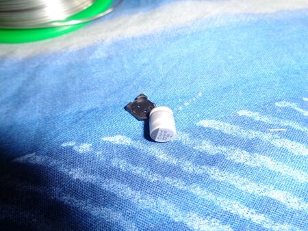

    What method did you use to desolder the SMD caps, hot air gun or soldering iron?
  6. Silver965
    710
    Torino
    Thanks mattb1970 or a soldering iron with fine tip and temperature regulation

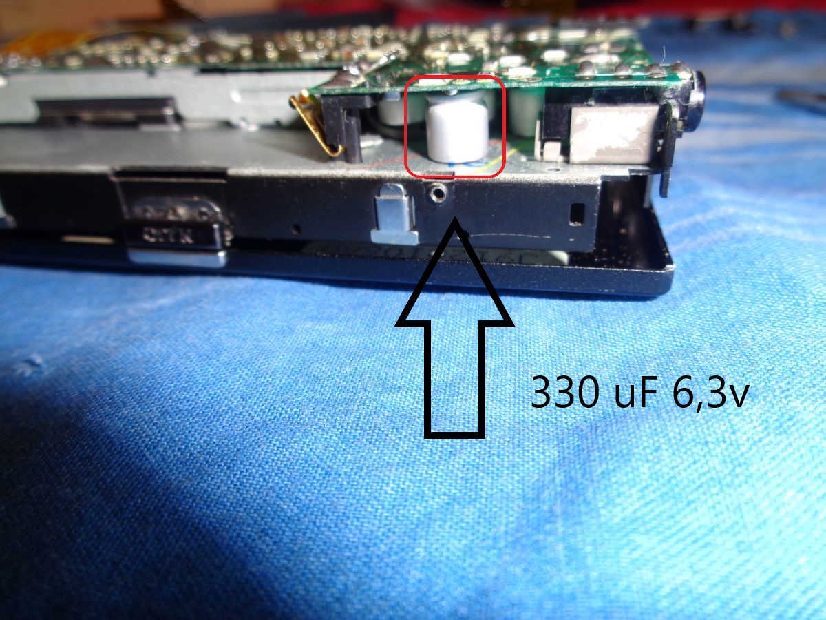

  7. Boodokhan
    2,476
    excellent job. I have few of this model and they need to be recapped.
    Can you please list the capacitors required for this model? thanks
  8. Silver965
    710
    Torino
    Thanks Boodokhan
    list of original capacitors
    2 x 330 uF 2v
    5 x 220 uF 4v
    3 x 47 uF 4v
    1 x 100 uf 2v
    Boodokhan likes this.

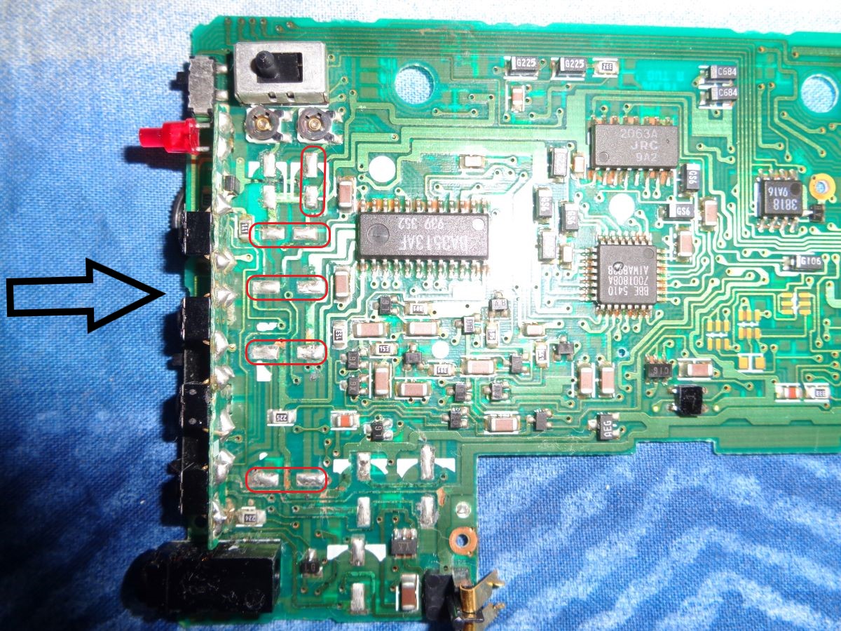

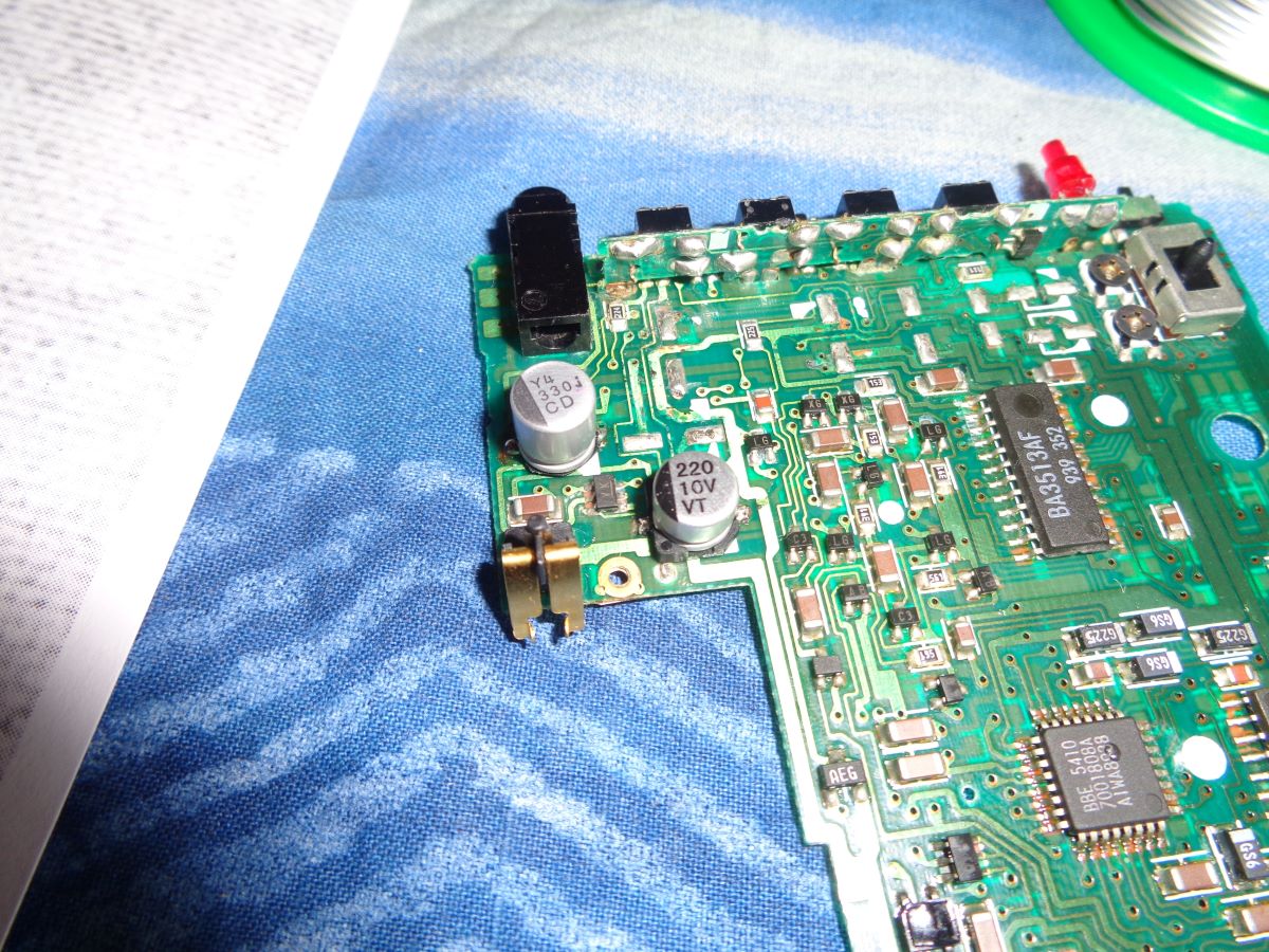

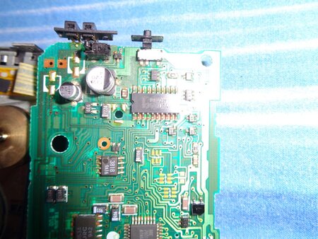

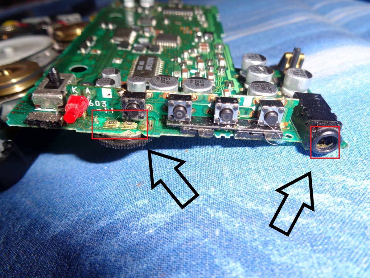

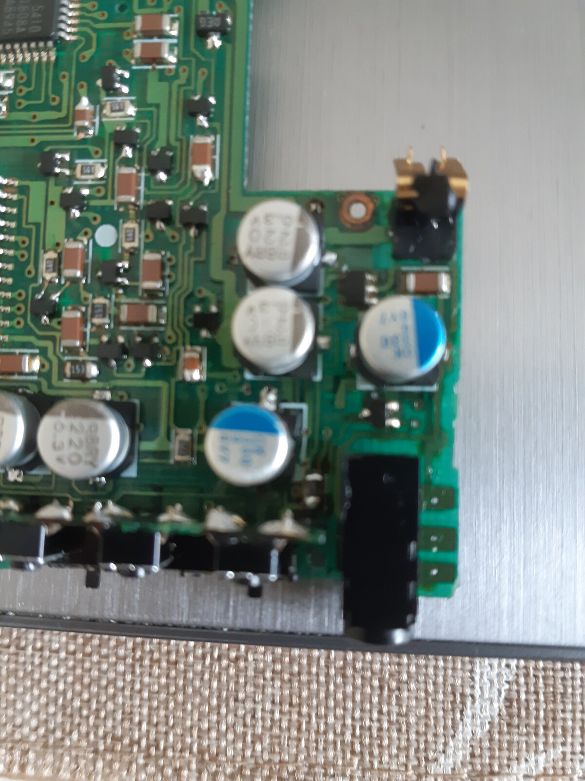

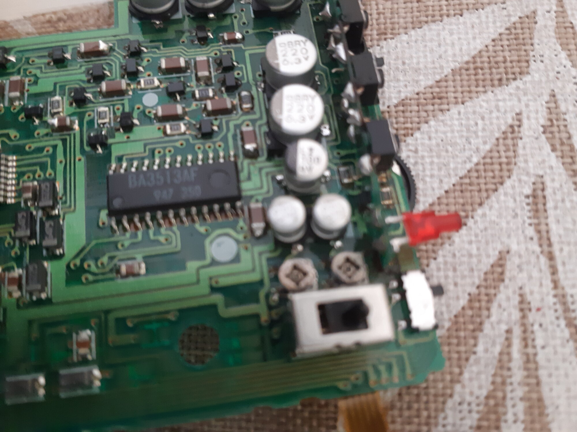

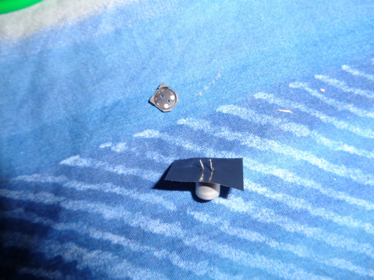

    Following your example Silver965, I try to restore an Aiwa Hs-PL505, same problem as yours, no audio, mecanically 100% ok.
    I got the caps, someone wiht higher voltage rate than orginal ones but the correct size. Desoldering was a hard work...
    But I think was ok, after solder the new caps, sound seems to be ok but the buttons, play, ff, revwind didn't work. When I connect the battery the mecanisms runs as think it should, checking and adjusting the tape tension, but not further response when I press the buttons play, ff or rew. I'm very dissappointing as I took extremely care during all process of recap. I was reviewing the joints between the main pcb and the secundary pcb in which the bottons are located, It appears everithing is ok. I was wondering if the problem coud be I connected the battery wihout the caps before I solder the new ones. Could this affect to the IC logic? I post pictures as soon as posible. Do you have the service manua?
    Someone have an idea what would be the problem?
    many thanks in advance

  18. mattb1970
    mattb1970 Member
    96
    I don't think connecting power with the caps removed would cause damage to the IC's.
    I would do a continuity test on the power and ground connections between the main PCB and the secondary PCB, I understand this is not so easy without a schematic/layout diagram.
    Alternatively, resolder each joint between the 2 PCB's, adding a bit of flux to help the joint flow nicely.
    Does this model have a wired remote control in the headphone jack that you could test functionality?

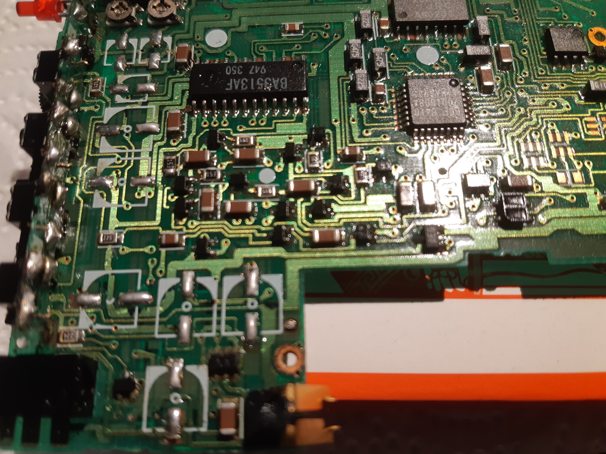

  19. JUAN ANDRES MONTIEL DIEZ
    JUAN ANDRES MONTIEL DIEZ Active Member
    191
    Spain
    Thanks for the reply mattb1970, yes I have resoldered each joint, using previously a litlle bit of JCB flux, the new solders appears to be ok as far I can see. I'm triying to take a good pictures to show it, but I'm not very good with the camera :(
    Unfortunately I don't have the remote control in order to make the test you mentioned, I think too the best way is a continuity test between 1 and 2 pcb's but I can`t find the service manual.
    Could be a solenoid issue? I think is not likely because some functions still works in this case
  20. mattb1970
    mattb1970 Member
    96
    The fact the mechanism is tensioning the tape when a battery is inserted is a good sign.
    I still think there could be a bad connection between the PCB's. Can you find a ground trace on the main PCB (battery contact) and check for any continuity on the secondary PCB. If nothing connects to ground you may have located the issue.
