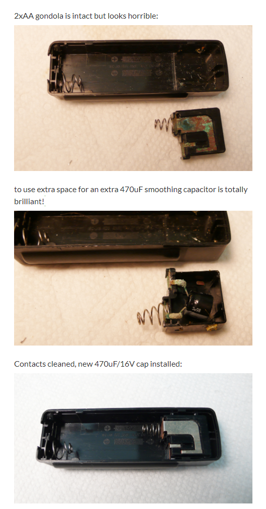

So after contacting the eBayer I got this from and he agreed to let me send it back, I decided first I would have a crack at trying to get it to work again because boy did it sound soooo good when it was working just for a moment. I took the battery gondola apart carefully and removed the corrosion that was behind the spring on the side where the voltage smoothing capacitor is. I used a wirebrush and some good old DeOxit. The 470µF smoothing capacitor looks to be in really good condition, it might even be new as the seller said their technician worked pretty hard on the item. I don't see any leakage, or bulge etc. Though I did notice that the soldering is very, very barely still connected (see the red circle): Unfortunately it snapped when I gently laid it down after taking a photo. I don't have a soldering iron of any kind (I will go buy one after Christmas) so for now I just used the force of the wire to prop it up underneath the outlying piece of solder. The connection is pretty solid and should last a long time, but I will endeavor to solder it properly together as soon as I can. Then I put it all back together and heated the gondola up a bit to dry out the rest of the Deoxit residue. Looks pretty clean now. I used my Maxace obsidian balisong to pry the battery compartment out. Unfortunately I was stupid enough to rest the back of the device against my belt buckle for only about 5 seconds, which was long enough to give it 2 small scuff marks on the black metal paint on the player's spine. You can see inside the red circle above. An idiotic mistake, but I guess call it the cost of doing business / price of progress. It was totally scratch or scuff free beforehand. Maybe I'll find some way to polish it again black or something. Either way, it'll be living inside its case from now on but this still makes me sad. It works again. Tested with 2 different kinds of LR03 1.5V batteries. The bottom of the battery gondola says IEC JIS ASCI RO3 AAA or NiMH gumstick, but I cannot for the life of me find these R03 batteries anywhere. From what I could find online, they are much older and far less long lasting than other batteries. What I think made it work though was not actually cleaning the gondola (though it could have been) but actually, the STOP/EJECT button seems to be a bit finicky. So I think when I had pushed down to stop the device, or when it got stuck like I explained above and it was next to impossible to move the tape. I think it got a bit "locked" or something inside the device and likely it was stuck on some setting that was telling the device that the stop button has been pushed. It started working when I gently 'pumped' the STOP/EJECT button and I felt a little kind of click which I hadn't heard before. So I think the mechanism might need an oil/grease. Next step is to open it up and spray some DeOxit into the volume pot to remove the corrosion/scratchiness sound there when turning the volume knob and to make sure the inside of it looks fine. Plus to check the situation with the stop button. All in all though what can I say except this is just an amazing device. I absolutely cannot for the life of me believe how loud and clear the sound is. DSL on setting 1 makes Beethoven's Fifth feel so "full", the noise reduction works amazingly without cutting out those sharp violins and DSL 2 really kicks in and elevates the bass but without it being totally overdone like the "Mega Bass" SONY versions. I would say this is even slightly ahead of my recapped mint condition WM-DD3. Especially in how loud it gets. Absolutely no need for an amp here at all. Between this and a hopefully soon fully working WM-DC2, I will be in heaven.
