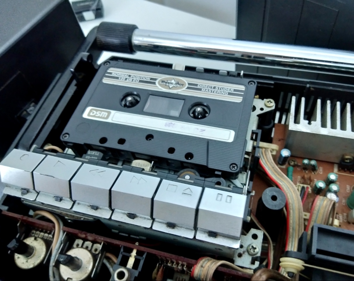

    This unit was bought several years back, due to its run down condition I can only do restoration part by part. Earlier I have managed to done up the imbalance stereo cause by the selector switches and replace the foam for the passive radiator. Now after four years, it's time to work on the tape deck. It's indeed heavily used by the previous owner as I can tell by looking at the mechanism and the overall condition of the deck.

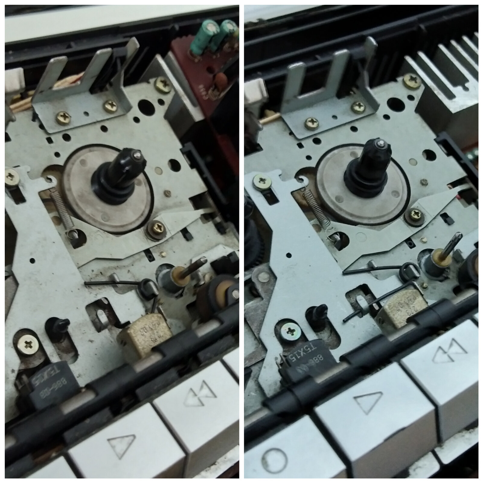

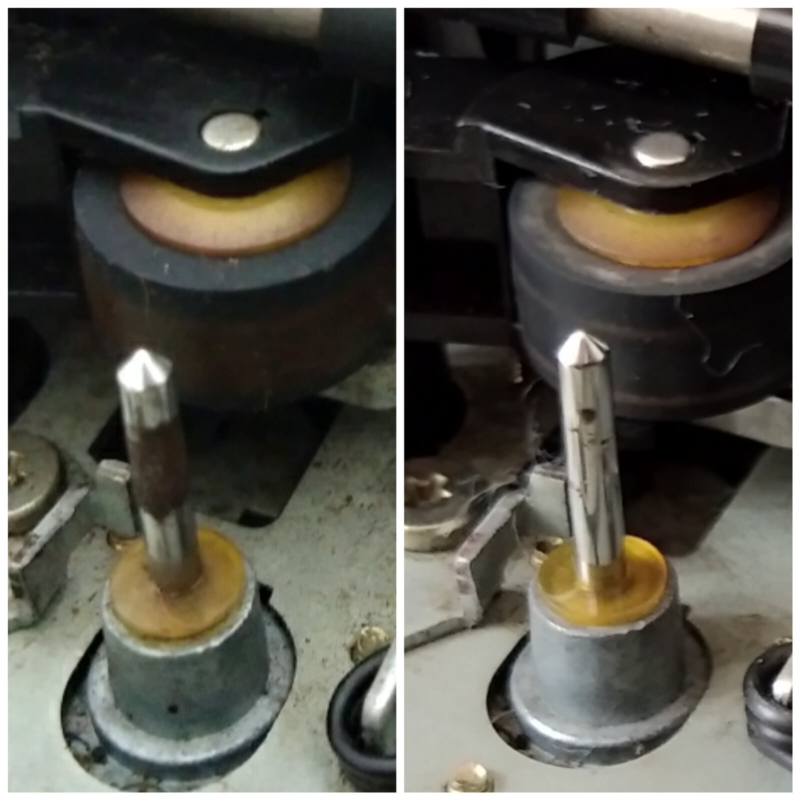

    The play, fast forward and rewind not functioning due to the motor seizure. The pinch roller and tape head fail to engage as the push up mechanism was jammed. I have to tear down the whole system to service and lubricate every single parts.
    Cleaning - before and after..
