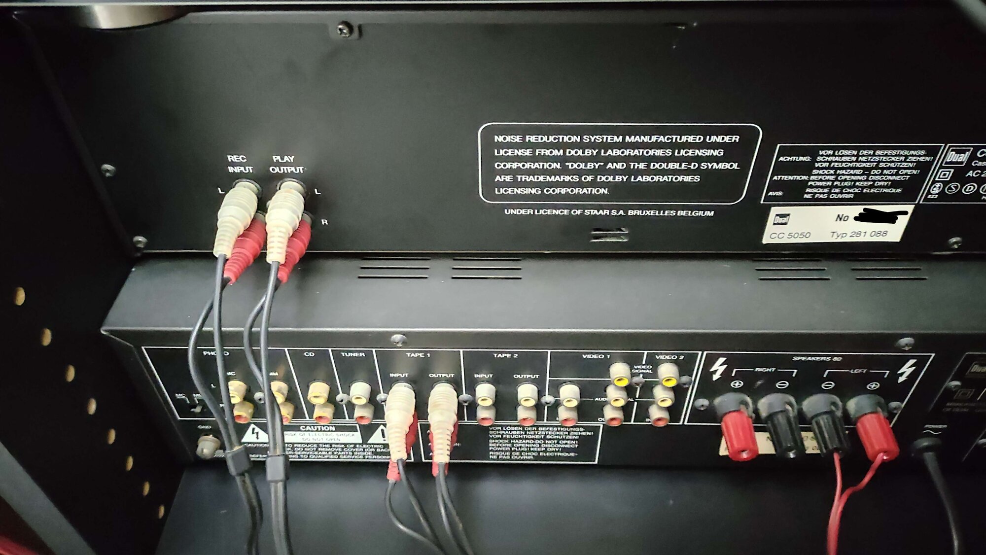

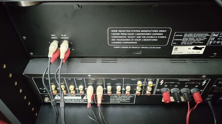

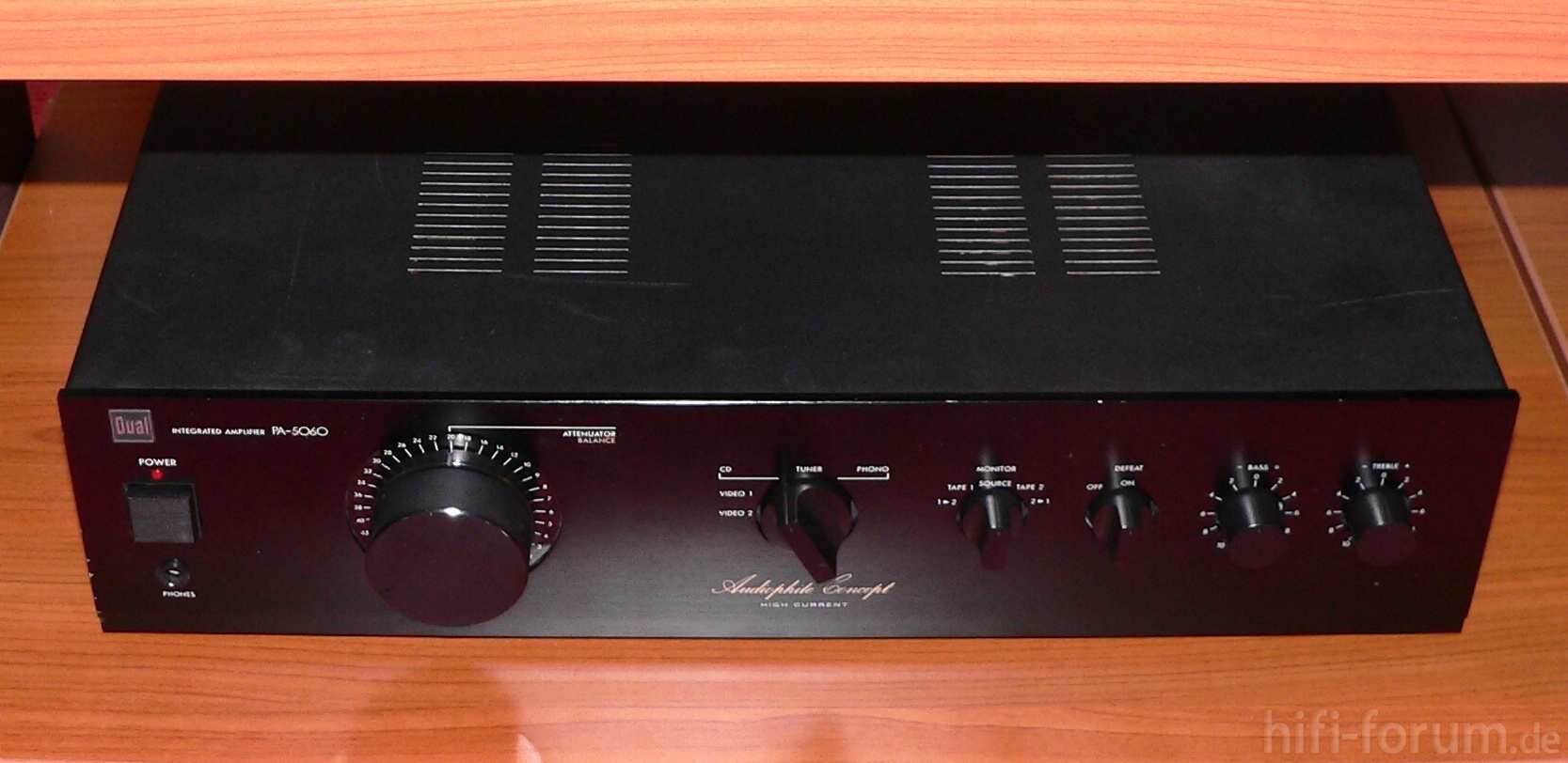

    I'll include a photo of my amp and the ports in the back of my deck (on top) and my amp (below).
  6. TooCooL4
    3,090
    Can't really tell if you have it connected the correct way round, as I can’t see the whole length of the cable.
    This is how you should connect the tape deck, the Play Output on your tape deck should go into the Tape Input on your integrated amp.
    The Rec Input on your tape deck should go to your integrated amps Tape Output.
    Make sure you select the correct setting on the front of the integrated amp.
    If that does not work, try the Tape 2 loop just in case the Tape 1 loop is faulty.
    I also recommend you clean the connection terminals of both the tape deck and integrated amp for a cleaner / clearer sound. You are not getting a good electrical connection at the moment.

    Okay, I had the Play Output on the deck connected to the Tape Output on the amp and vice-versa, oops XD
    So this meant that in order for me to hear what the cassette deck was outputting, I had to choose "Source" on the "Monitor" knob in the amp. Having connected it the way you said, both the "Tape 1" and "2 > 1" options on the amp output the deck's sound.
