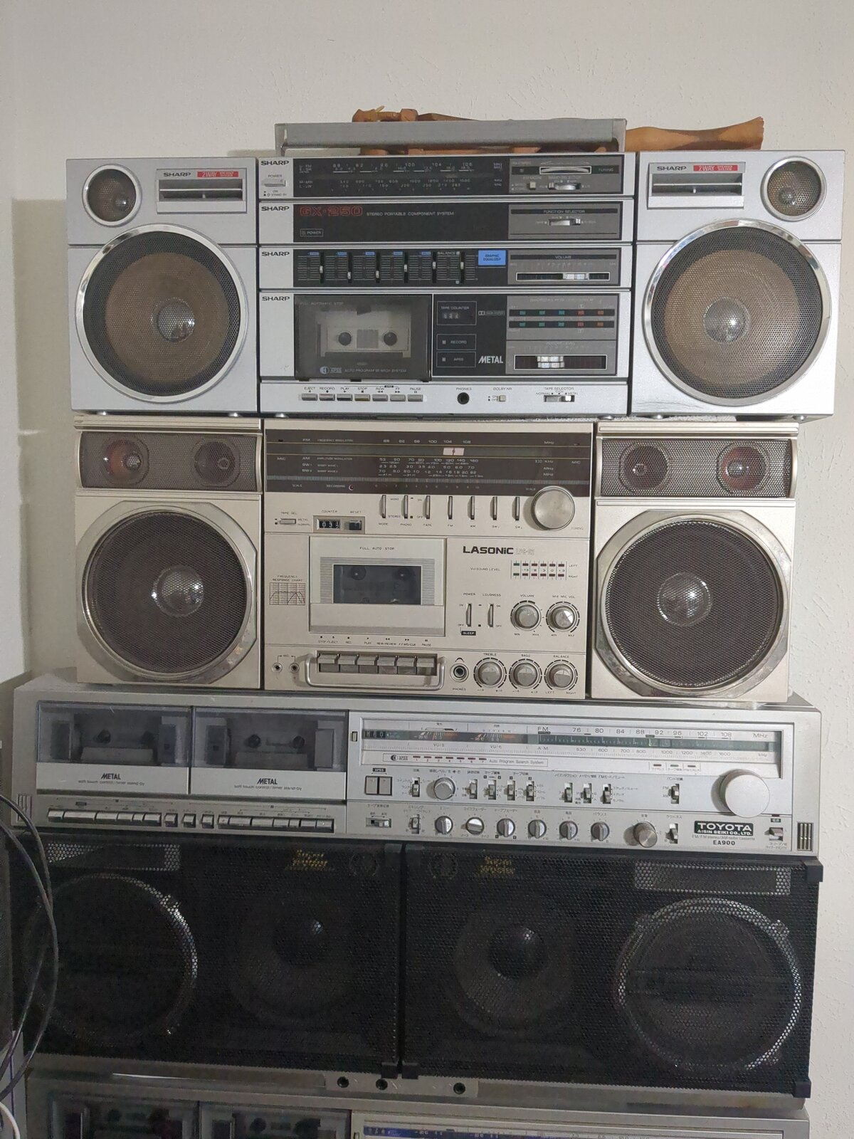

    Shark GX 250 has Dolby
    That is the sharp at the top of this picture. For reference, the next model down is a lasonic lpc-82 and then the bottom in this picture is a Toyota ea900

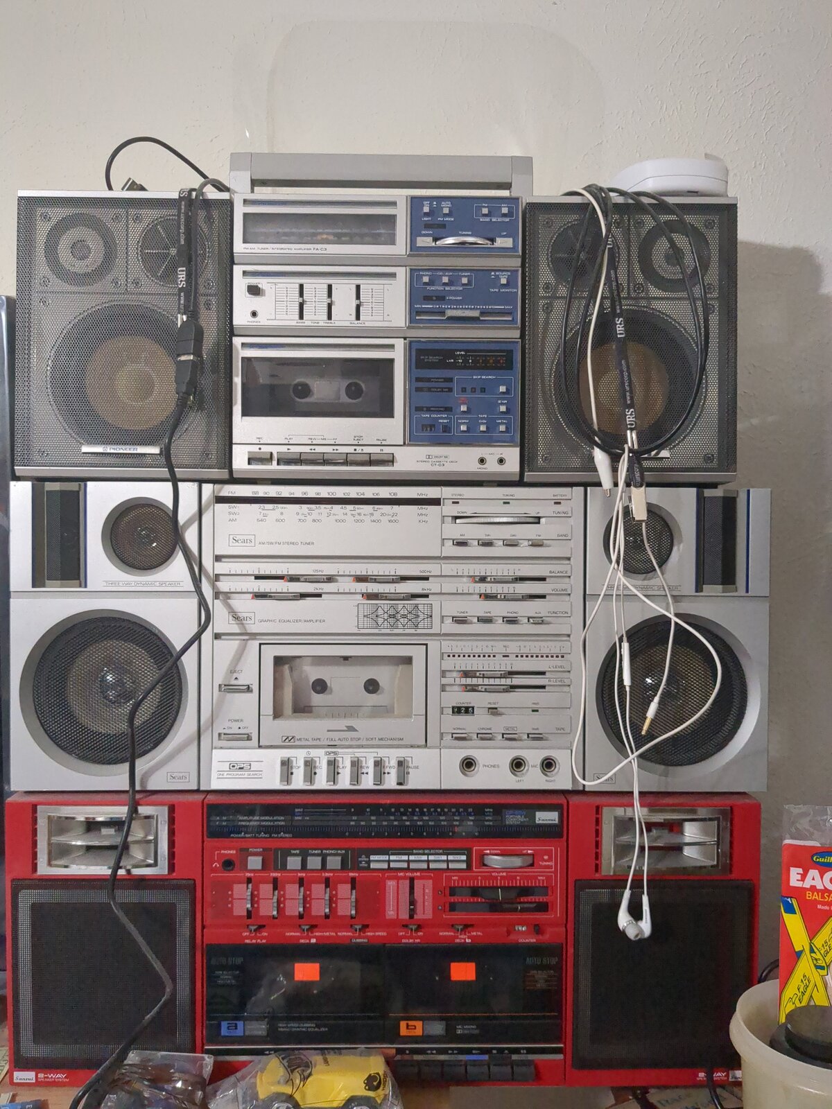

    The Sears I don't recall the model number. I'd have to take it down and look on the back to get the model number but it has its own anr brand of noise reduction 17185052311607305702680076259911.jpg
    The model on top is a pioneer ct3 I think which has new surrounds on the woofers. The Sears. I still need to replace the motor in it. And the red one is a sansui w55 I think and it needs a total rebuilding new belts. That's what I said. I'm speaking to this phone. I haven't gotten around to doing that yet. Someday soon.

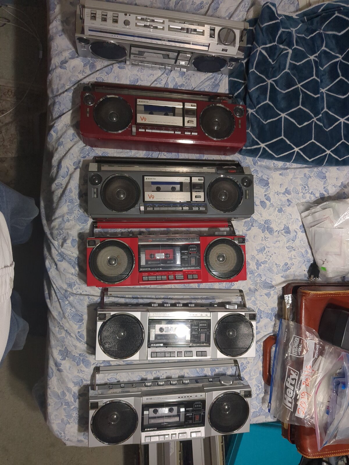

    Sanyo mr-v9 & m7790 also have Dolby, I also have a black one m7790 not in this picture 17185057476887867324421441880433.jpg
    The box is standing up is a sanyo m7950k and it does not have Dolby does not have, but it does have shortwave whereas the models that are laying down on their back do not have shortwave but do have Dolby. Ps all of these the cassette players work because I've rebuilted all of them. decentman4you2007@gmail.com
