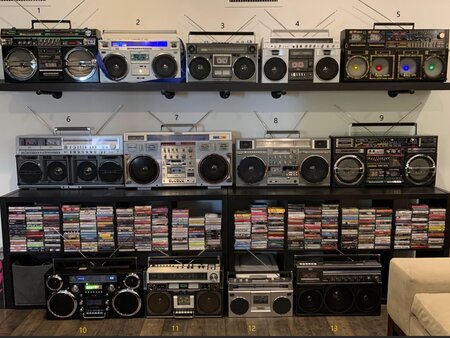

    Hello Fellow Boombox Fanatics! I saw this on reddit with no solutions, and had the same question as this person, so I am reposting it here with some modifications:
    I would like to connect 8 boomboxes to my Google Home system, and would love ideas on how to do it.
    The Goal: I have Google Home speakers, which play off my phone through Bluetooth. I want to be able to play the same song on all of my Google Home speakers, and these 8 boomboxes, at the same time.
    The Current Plan:
    1. Use a Chromecast Audio (example) (discontinued device that plays bluetooth music with a 3.5" output jack), connected to
    2. a headphone y-splitter (example), which is connected to
    3. two 5-way splitters (example), and, connected to each of those,
    4. three 3.5"-to-RCA cables (example)
    5. I'll hook each to the RCA line-in on the back of each boombox.
    Plan B: Is there a Bluetooth-to-FM transmitter powerful enough so that I can get good sound quality? The one I have for my phone is pretty weak, and I don't think I can do this and also use the Google Home feature, so this is a distant second choice.
    Is there a simpler, more effective way to do this? Will I loose a ton of volume by splitting the output so many times? I do not want to mod the boomboxes to be bluetooth.
    Advice welcome!!!
    Example (not mine):
    Boodokhan and Silver965 like this.
