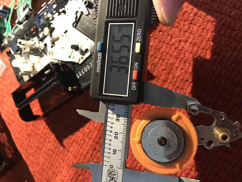

    hi,guys,

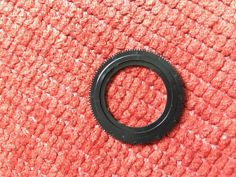

    After a few months of hard work,I'm glad to announced that the most simple and most
    beautiful and most powerful gear of SONY DD CENTER GEAR is produced!

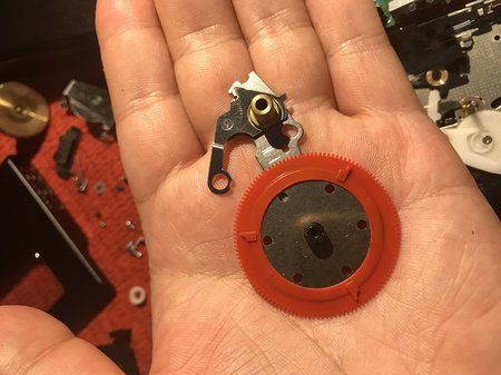

    It's fully made of durable plastic(POM),and it's easy to install,no need using glue or screws.
    I called this version "buckel design"
    this gear is fully functional in all type of sony walkman using this type of big center gear, including
    WM-DD/WM-DDII/WM-DDIII/DD100/WM-DC2/WM-DD30/WM-DD33/WM-2(Later models)/WM-F2/WM-R2/WM-5/WM-F5/WM-D3
    it ALL fits well.

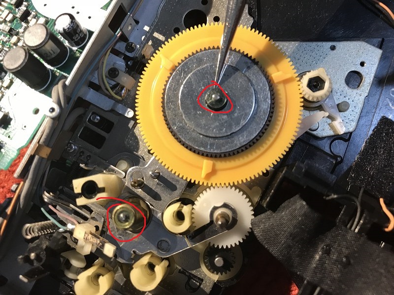

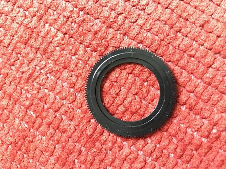

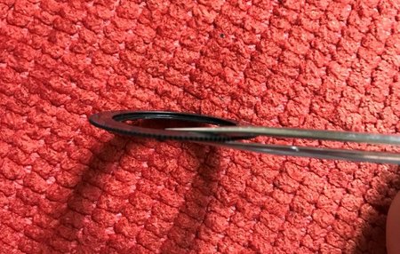

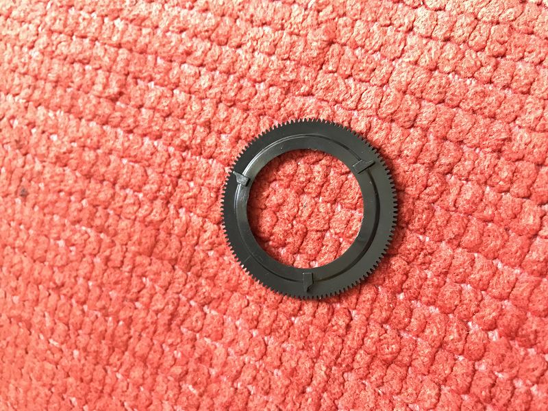

    here is view from the bottomside:
    and here is from the upper side:
    and here is the sideview:
    here is the Schematic diagram:
    dimensions

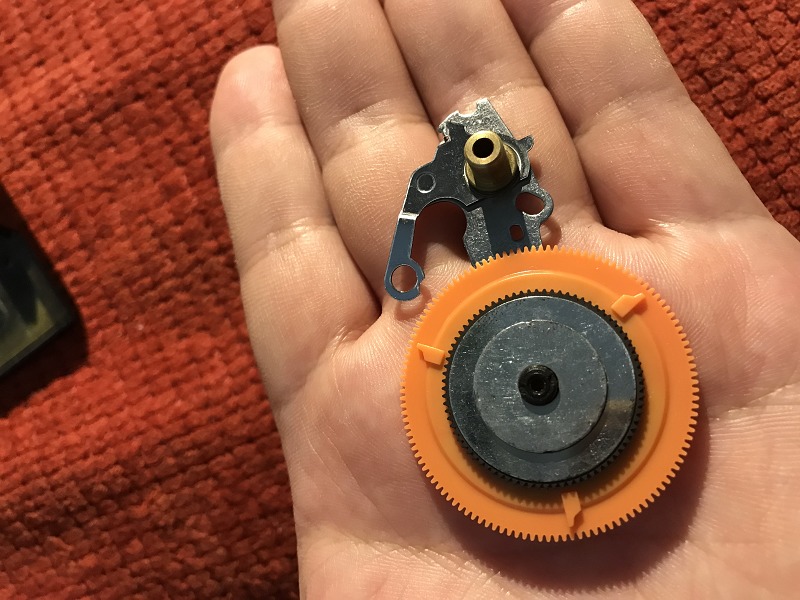

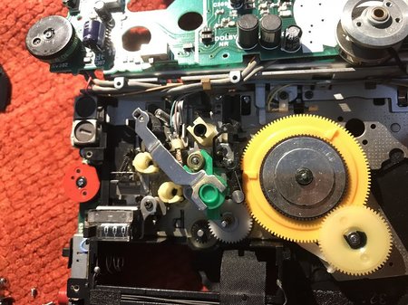

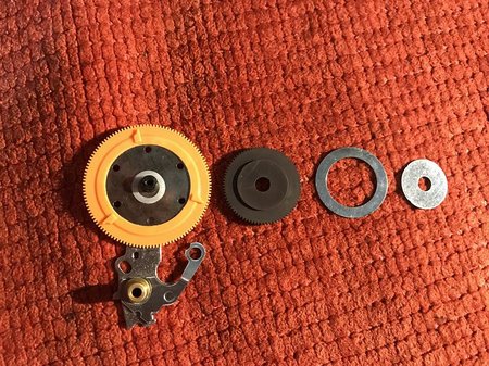

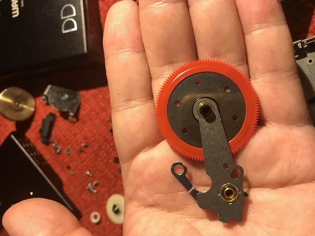

    here is some gear photos I just install in different models:

    hi,Jorge,
    It is NOT the same gear made by Mihokm.
    Mihokm had done gourious work on DD center gear,his effort is historic! his excellent job Will be remembered by all SONY fans.
    This brand new gears are made by me and a friend in China, we proposed a new mothod to solve the DD center gear problem and made it a reality.
    and by the way, what kind of idler tires are you looking for? maybe I can offer some information.
    wish you luck.

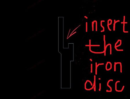

  5. T-ster
    1,464
    No screws on this one so how does it attach?
  6. David-ease
    David-ease Member
    30
    China
    There is a slot in the middle of the inner ring of the gear, and the gear has great flexibility. When the iron plate is inserted into the gear, it can be firmly attach。

    The number of teeth on this gear are exactly the same as original
