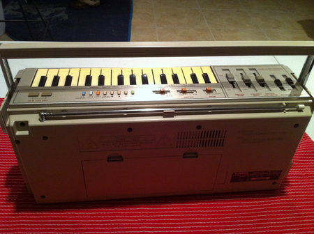

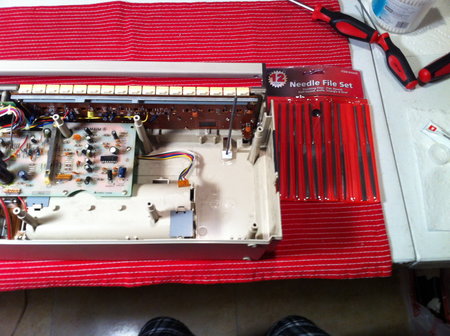

    Here is my "comeback" story of an easy fix for a broken antenna. NewOldStock Casio CK-200 got its antenna dislodged the moment it was pulled out of its retaining clips.

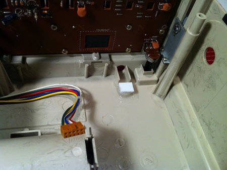

    Six screws and four quick-disconnects later the problem revealed:

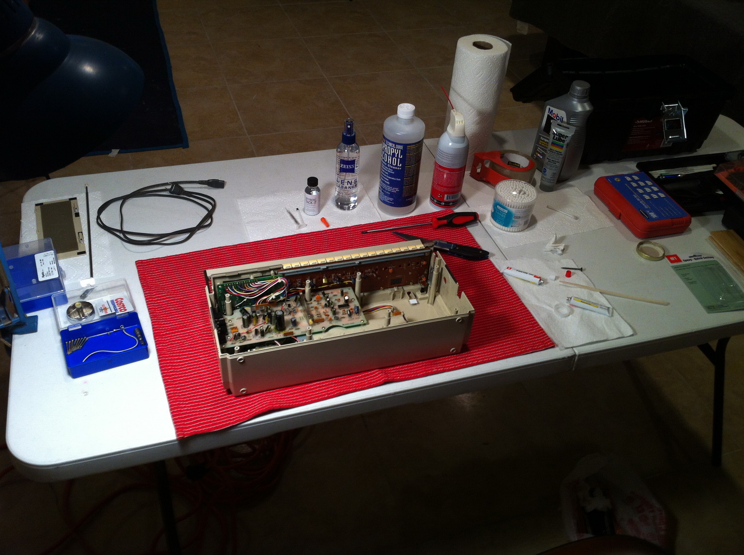

    Paper-thin piece of plastic is all that kept antenna attached to the case... In the absence of my stashes of tools and polystyrene sheets we revert to the good'ol'trick of using CCs, polystyrene glue (and my all-time favorite tactical folder: MercWorx Lachesis):

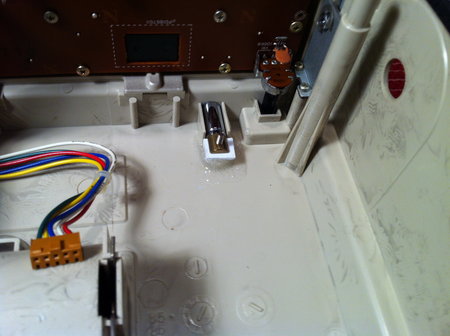

    24 hours later, once plastic pieces got "welded" together the piece got reinforced by generous amounts of epoxy glue:

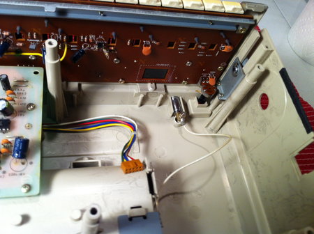

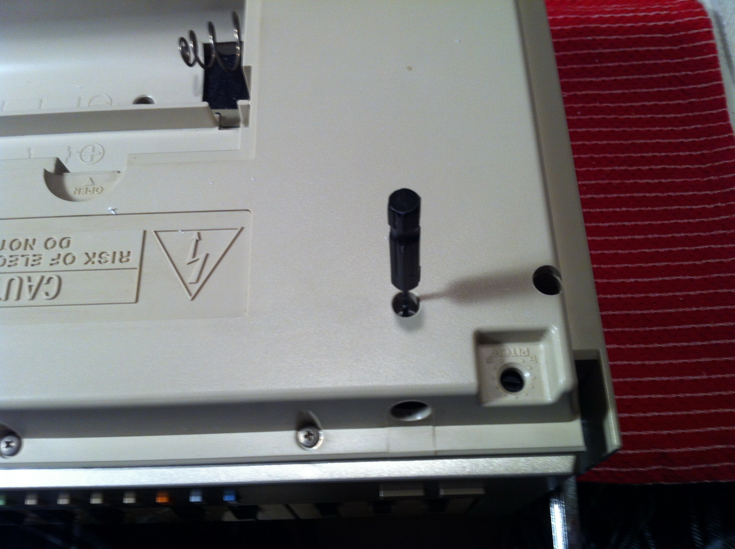

    Hole drilled and adjusted to the correct size with round file:

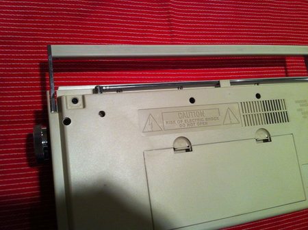

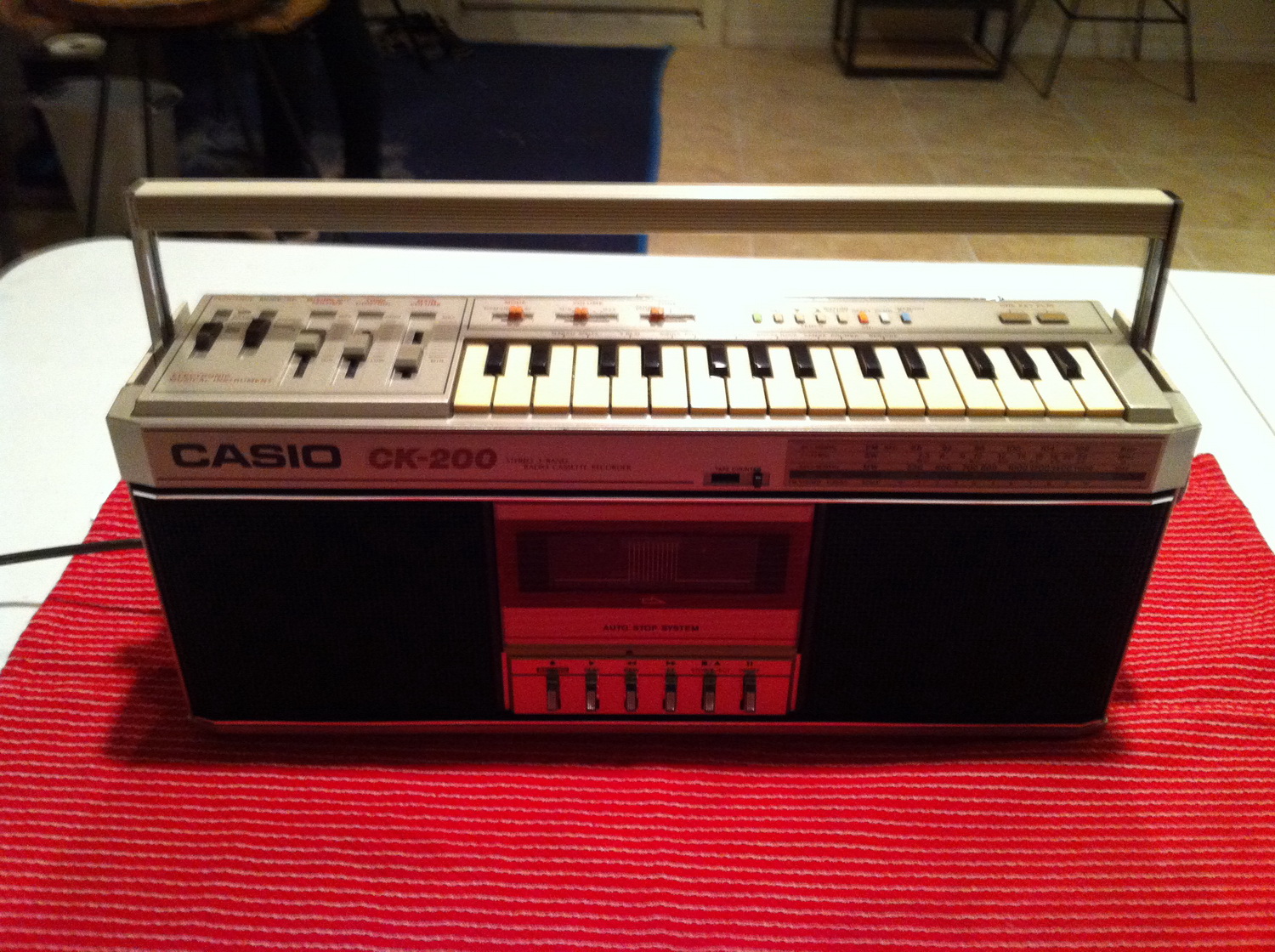

    Mission Accomplished:

    It took 3 years searching for a brand new CK-200 and finally I found one in Germany. As soon as I received it tried to test the audio and just by puling the antenna noticed that I broke the base plastic that holds the antenna to the main unit. I cannot believe how fragile antenna compartment is in this unit. So I completely ruined my day. I discussed this issue with Jorge and he offered me his help as usual. I am very lucky to have such a great friend.
