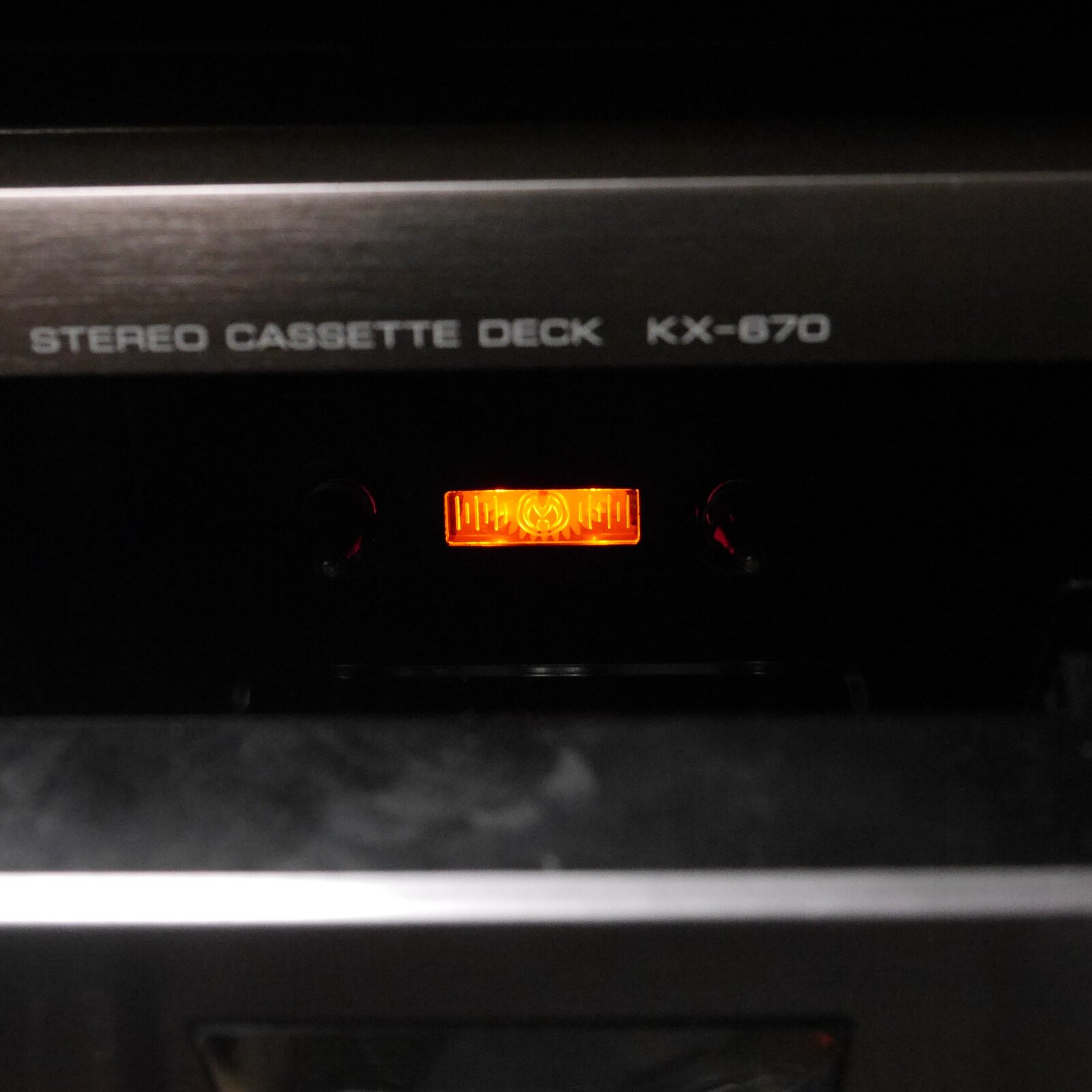

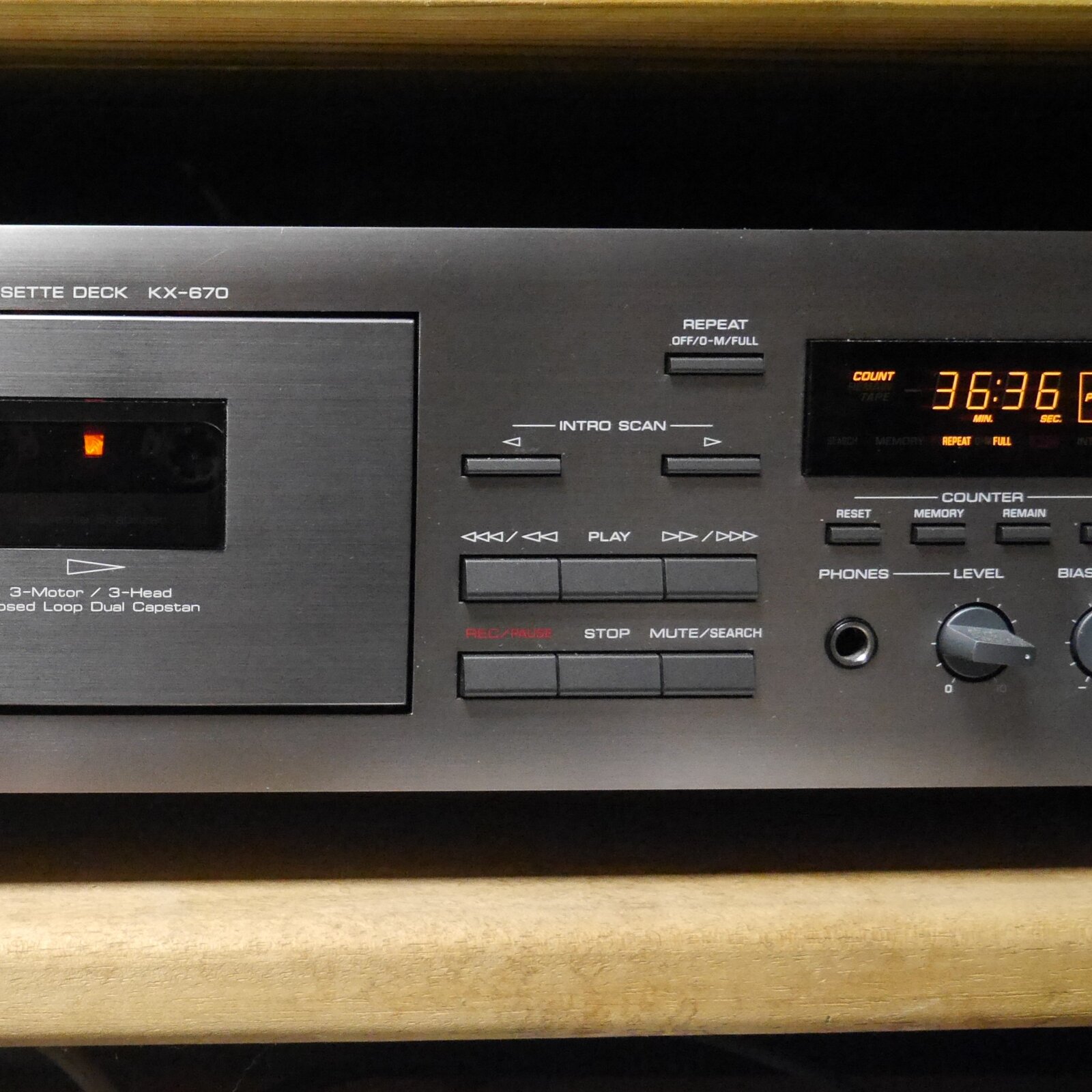

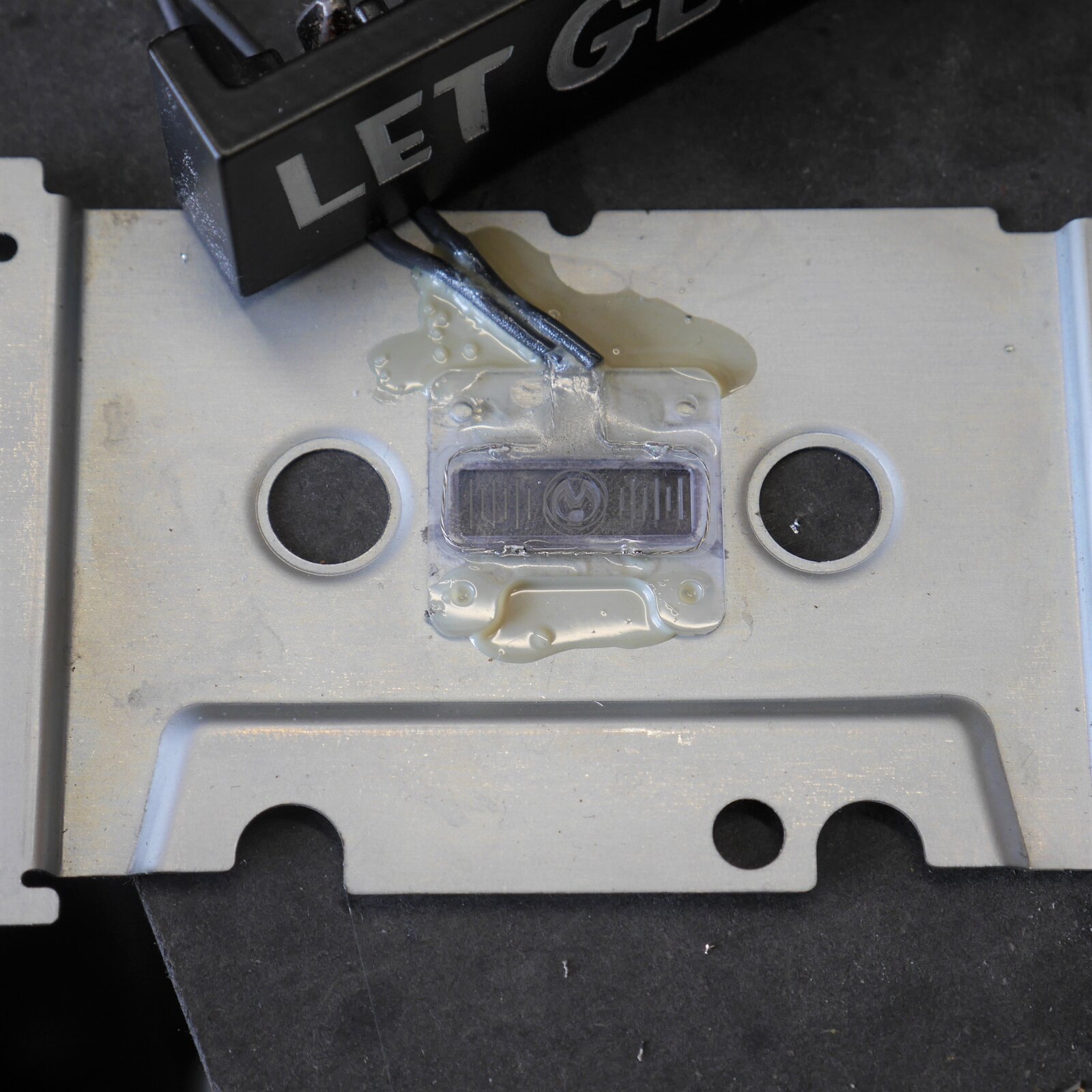

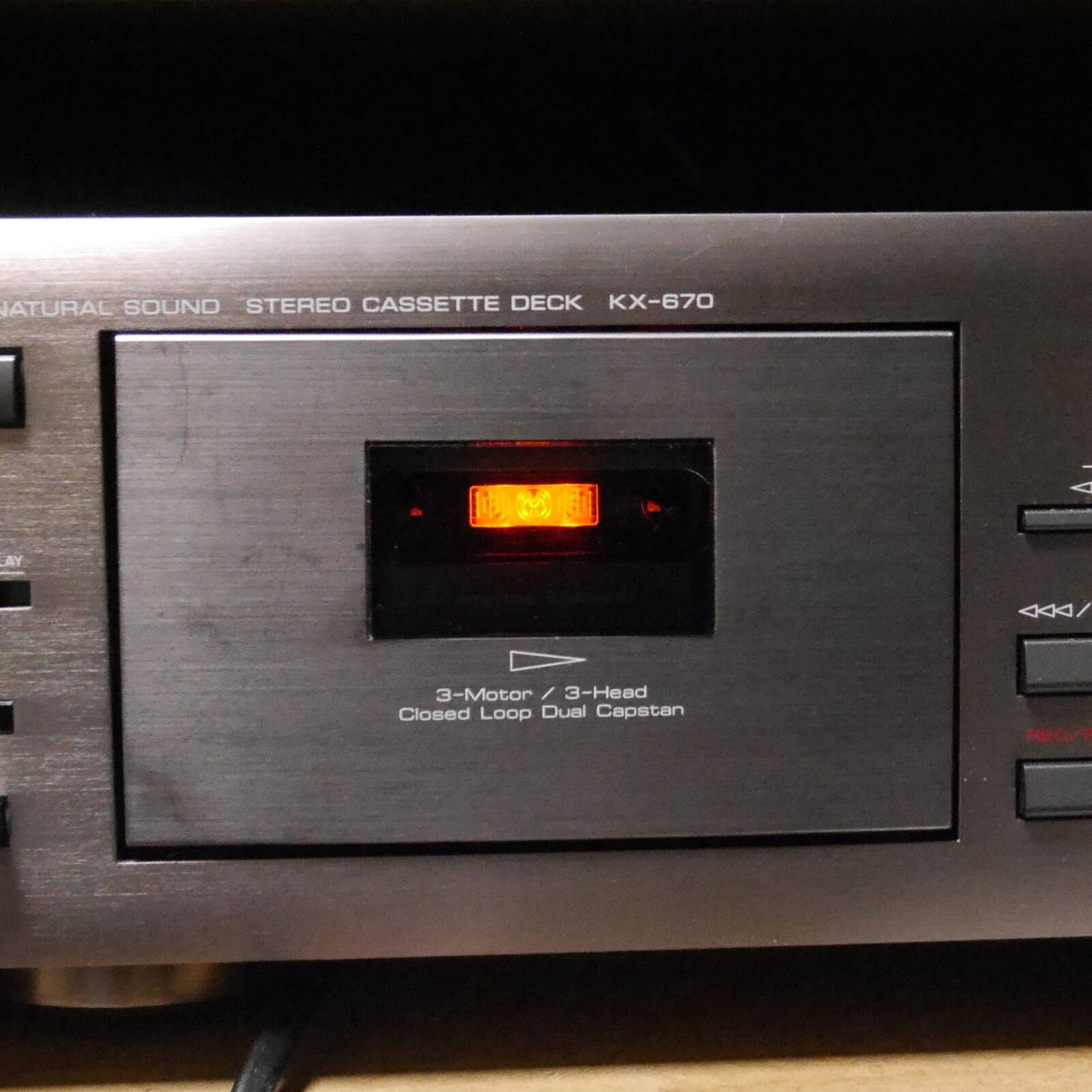

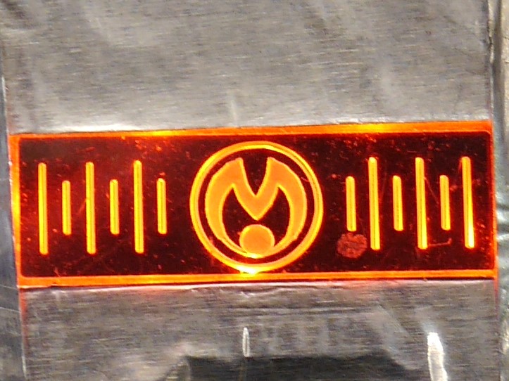

    I didn´t like that my tape deck has no light on the left side, not even a power light. This looks asymmetric for me
    Where a back light should be, is just an orange sticker.
    So i made one.
    I don´t like to cut holes in old Hi-Fi devices, but this time i had no other choice...
    The light is made from 2mm acrylic and 4 amber SMD LED´s (1.6x0.7mm).

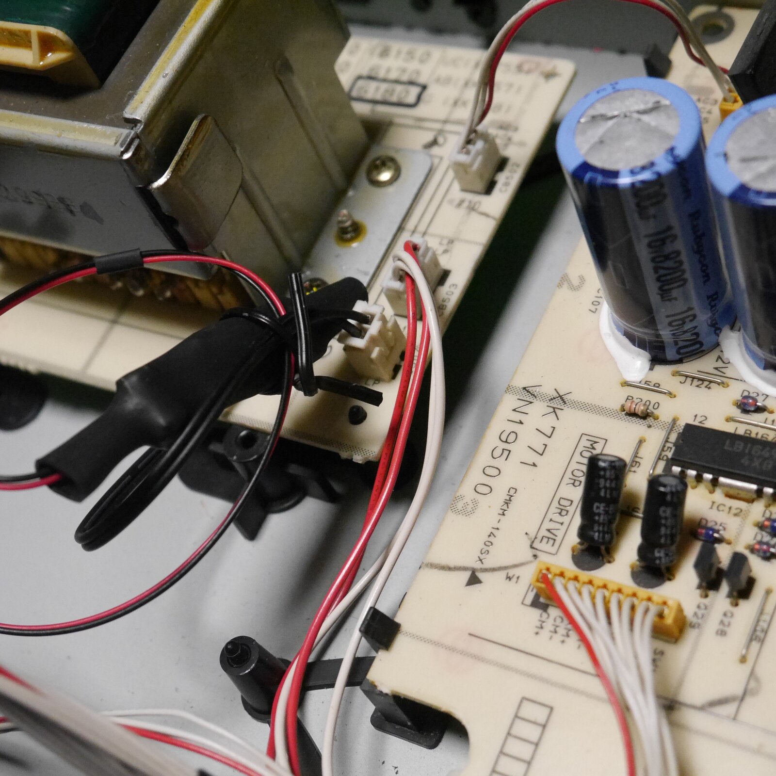

    The power comes from the original power source (7.2VAC) and is sent thru an bridge rectifier and a 100 Ohm resistor to the LED´s. Without a tape, the back light is a bit brighter than the display, but with a cassette it looks pretty equal.
    Insta11.jpg Insat8.jpg Insta7.jpg Insta2.jpg Insta3.jpg Insta4.jpg Insta5.jpg Insta9.jpg Insta10.jpg

    Very interesting .. but you have created a mold for the logo on the front ... if so what technique did you use
    Emmpunkt likes this.
  4. Emmpunkt
    Emmpunkt Member
    16
    13
    Germany

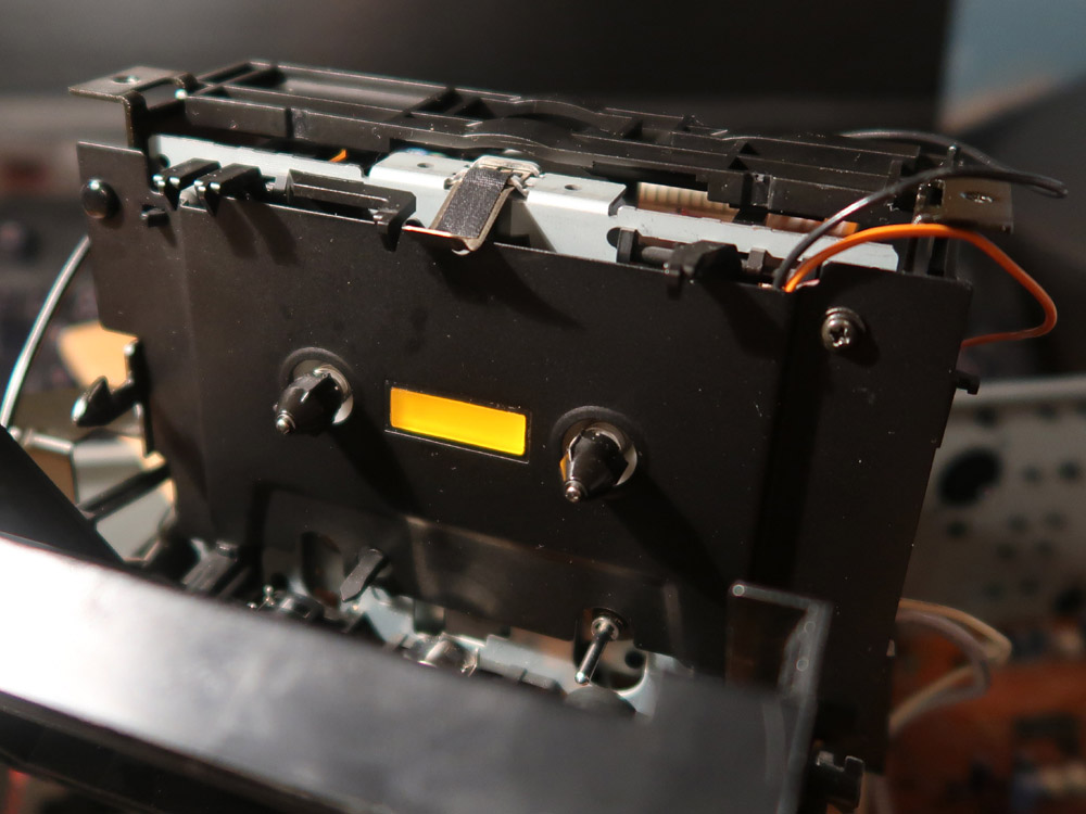

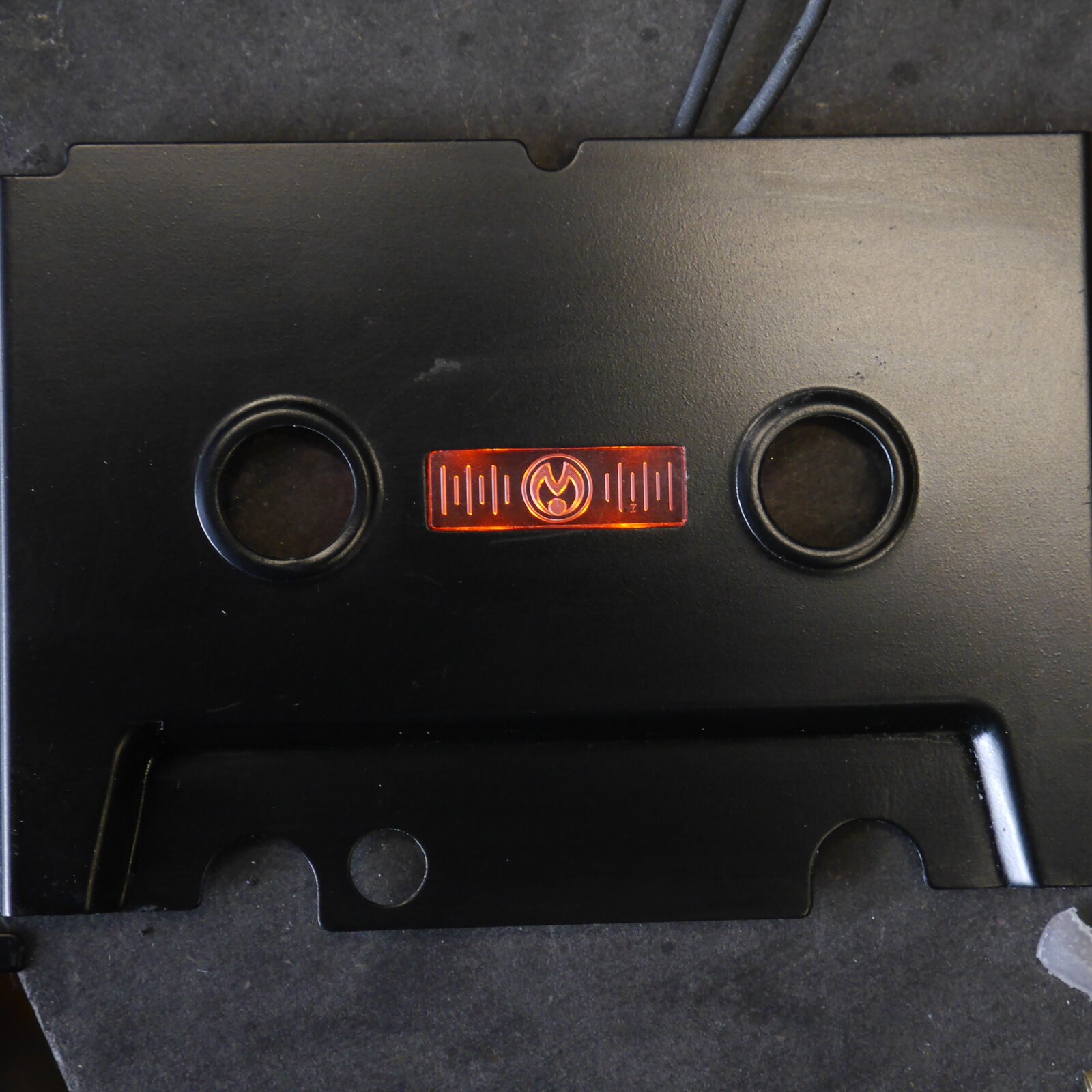

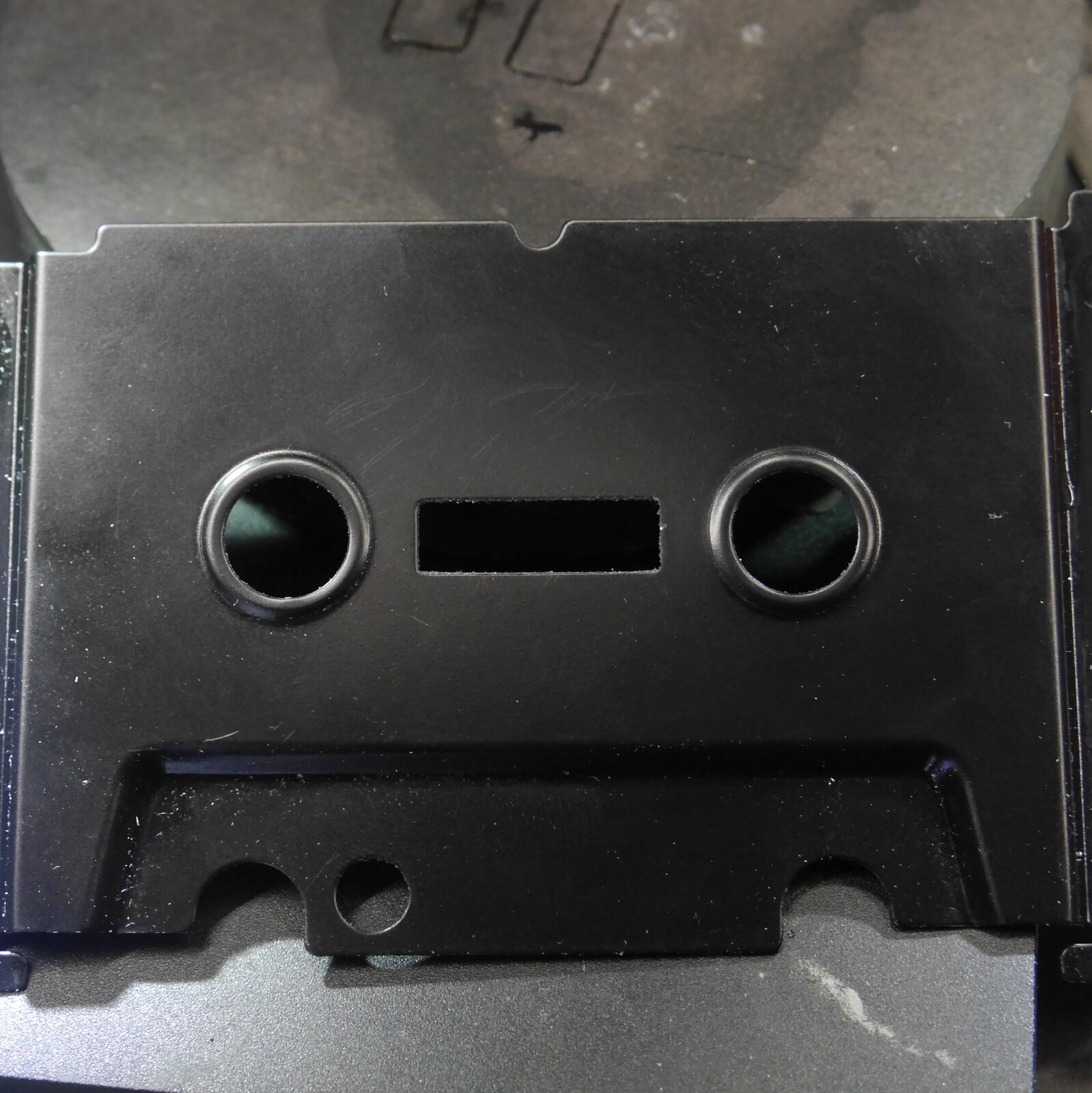

    The Acrylic is milled on my (self made) CNC. So no mold. Its engraved on the backside. Sorry made no Photo of it.
    Both sides are milled. The front is milled around the "window", so it sits flush, the backside has a slot around the window for the LED´s and the engraving. Engraving from the back looks better and makes cleaning easier.
    Here´s a picture from an earlier test....
    There was a fifth LED underneath the Logo wich i removed in the final version

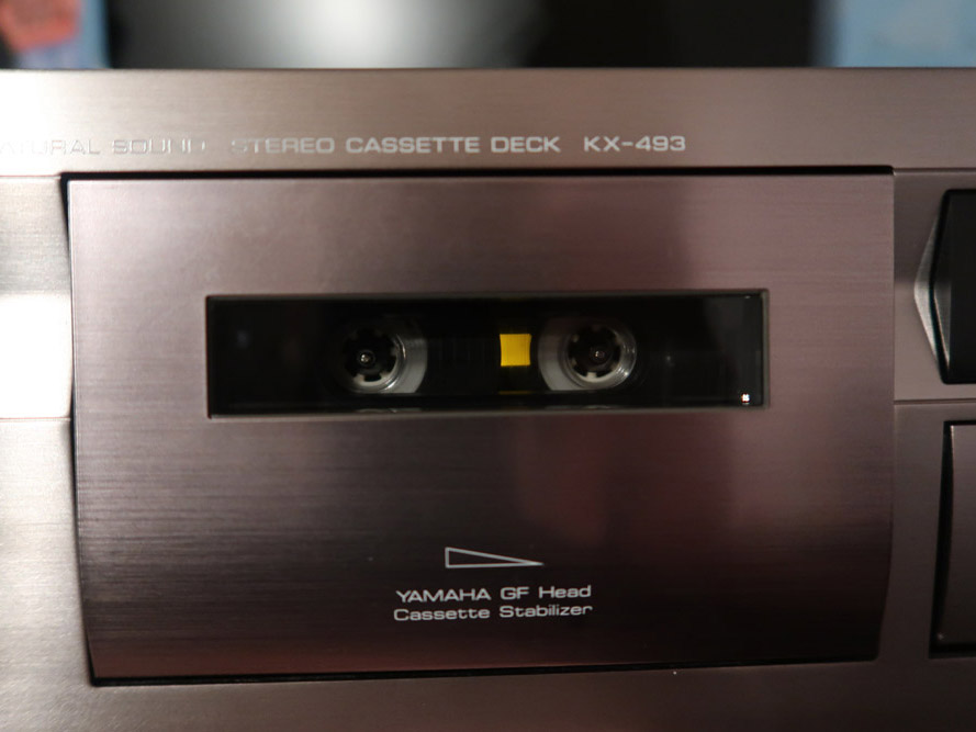

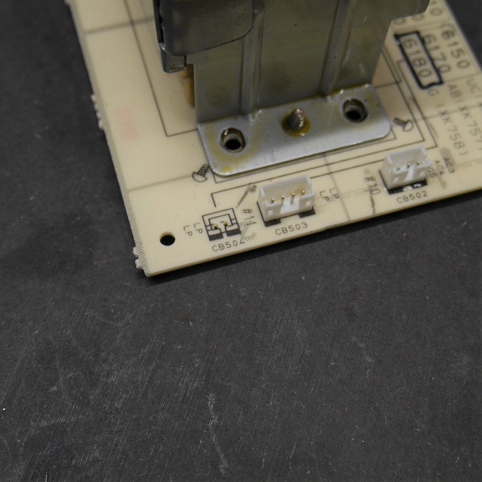

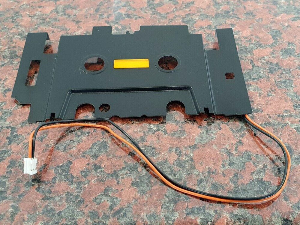

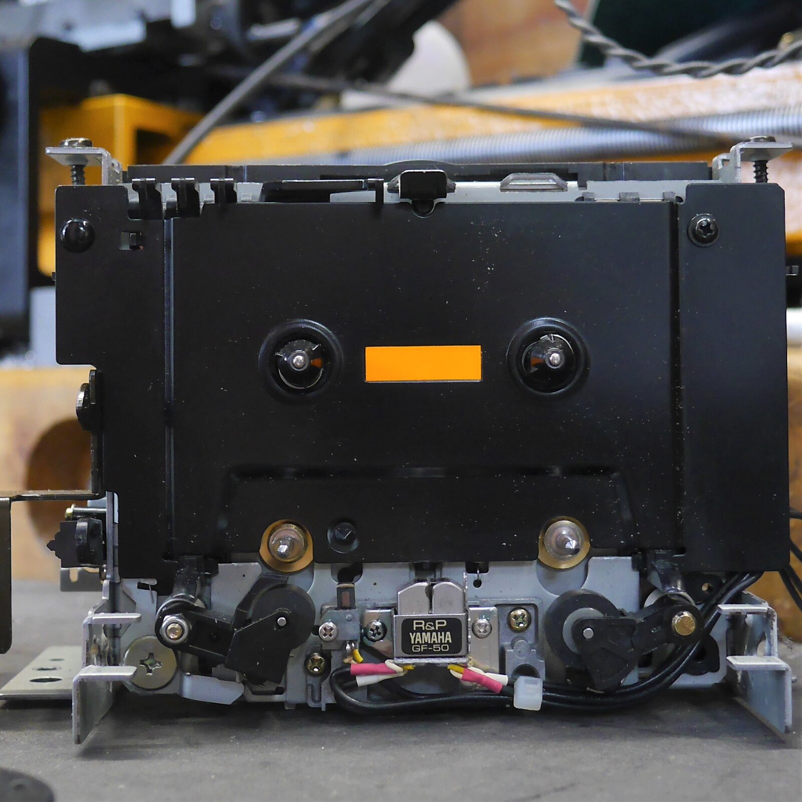

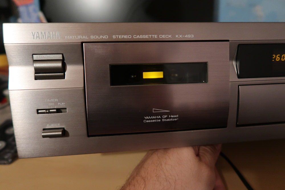

    I decided to shine my Yamaha KX-493 too. I bought used KX-650 backplate with back light. I used 5V from cassette mechanism circuit board, add 180Ohm resistor. As circuit is under voltage even in stand by mode I used TIMER switch to turn on/off light (otherwise light is on even the device is turned off).
    Mister X and wheaties1909 like this.
    14,560
    Those looks so good, it's too bad they didn't light that area up in the old days.
