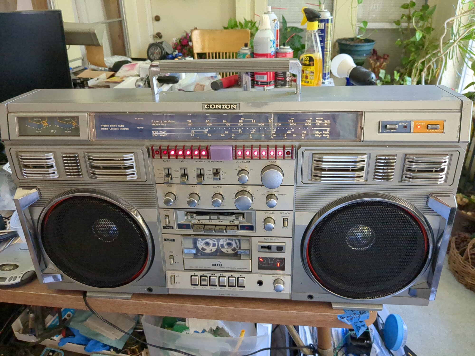

  1. Cassette2go
    1,573
    Back label just so you know.
    Sunday 23 June 2024
    decentman4you2007@gmail.com
    I'll answer any questions.

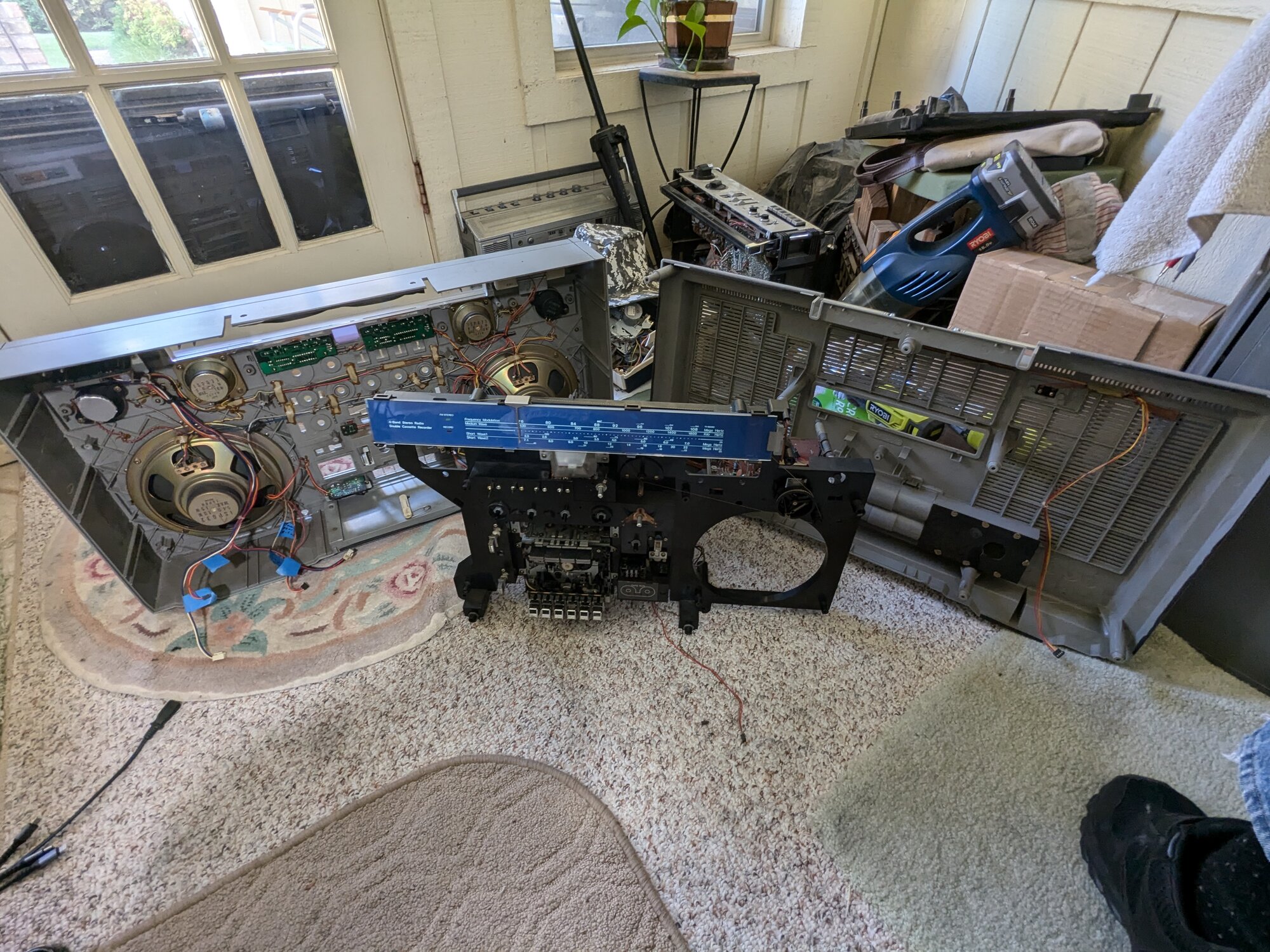

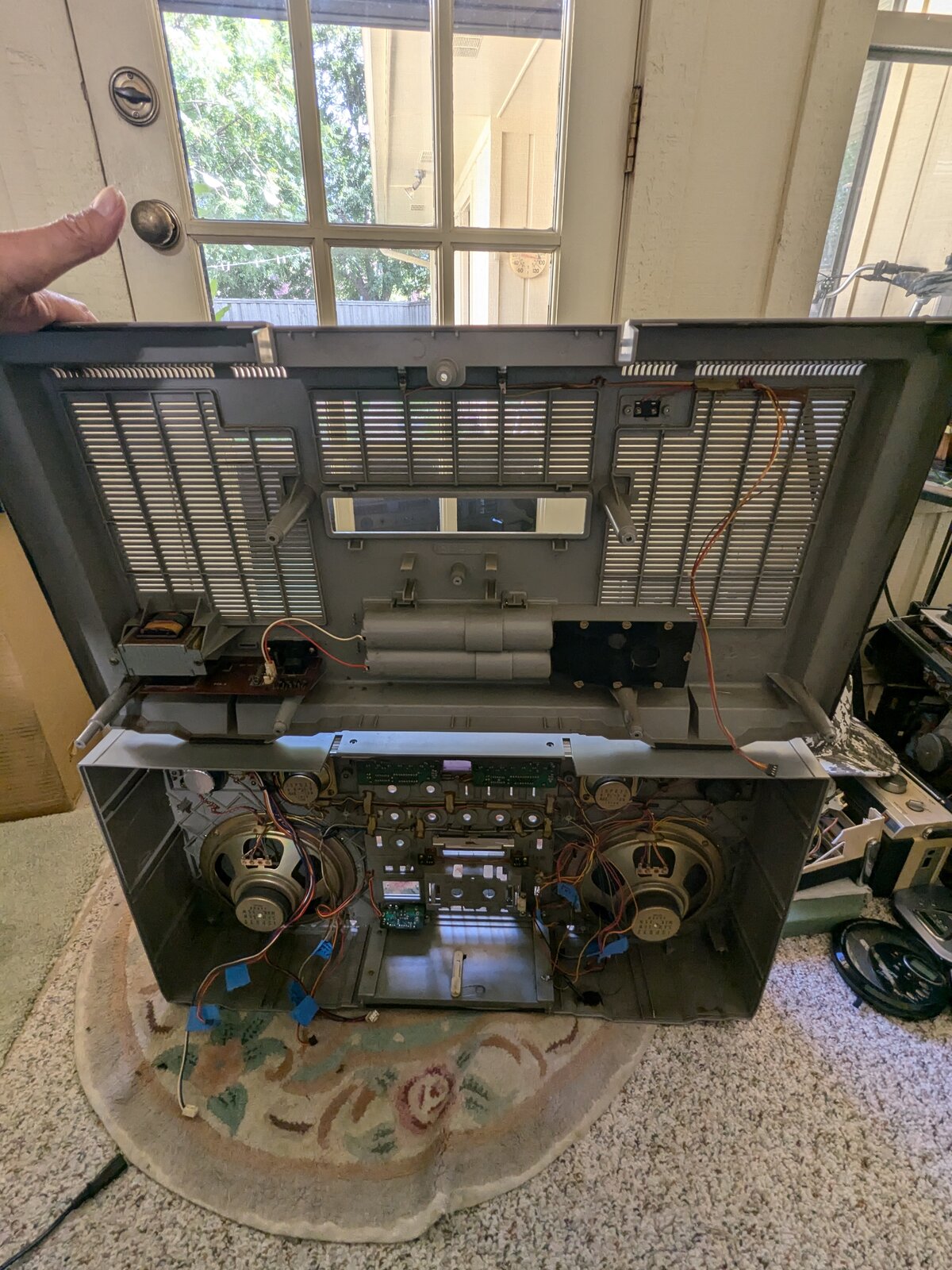

  2. Cassette2go
    1,573

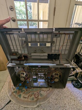

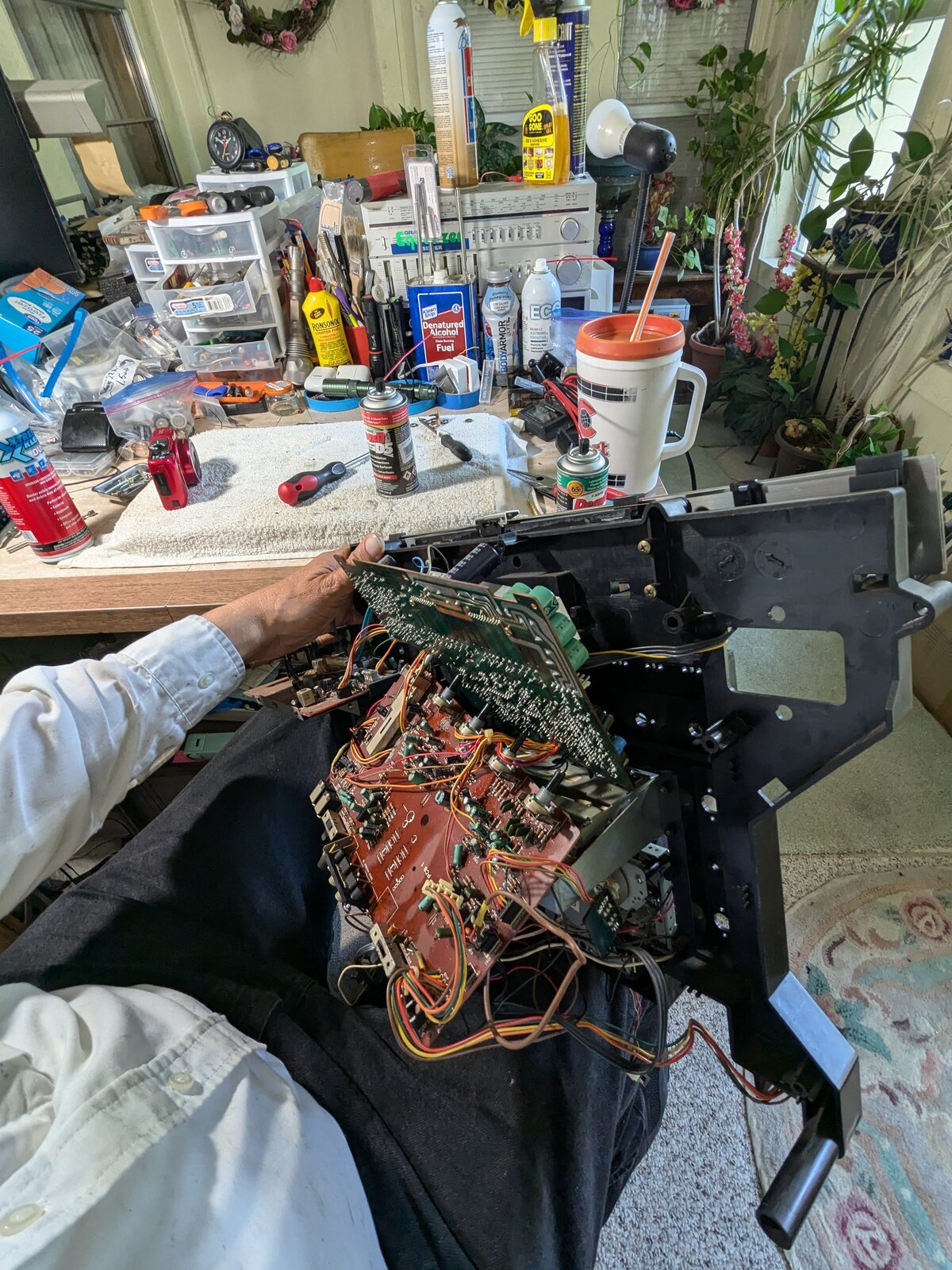

    I can't figure out how to edit this from my phone so I'll just add a picture or two here.
    Yes I really had this all apart so I could put the Deoxit into the controls.
    Front and back from the inside. Cleaned and serviced.
    If you can see in this picture cuz I only took a few, with this pixel cell phone I took a lot more with a regular camera that I normally use . I used painters tape that I wrote on the wires so I know where they plug in at. You have to do it on this model.
    Once again, I'll answer any questions.

  4. Cassette2go
    1,573
    Sounded good as well. My sole purpose was to buy this again, repair it as I can, which I did and then resell it for a little extra money more than I paid for it.

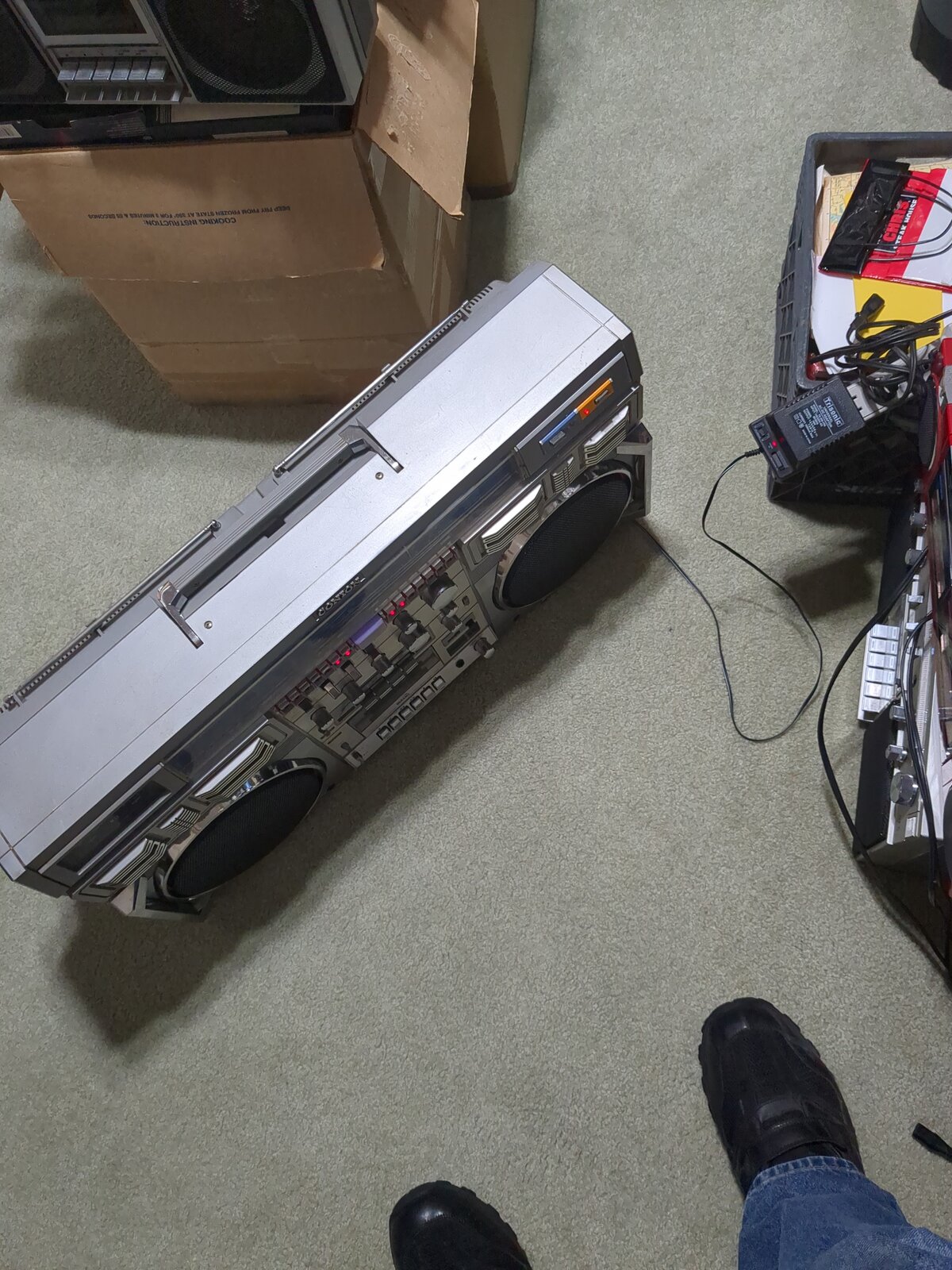

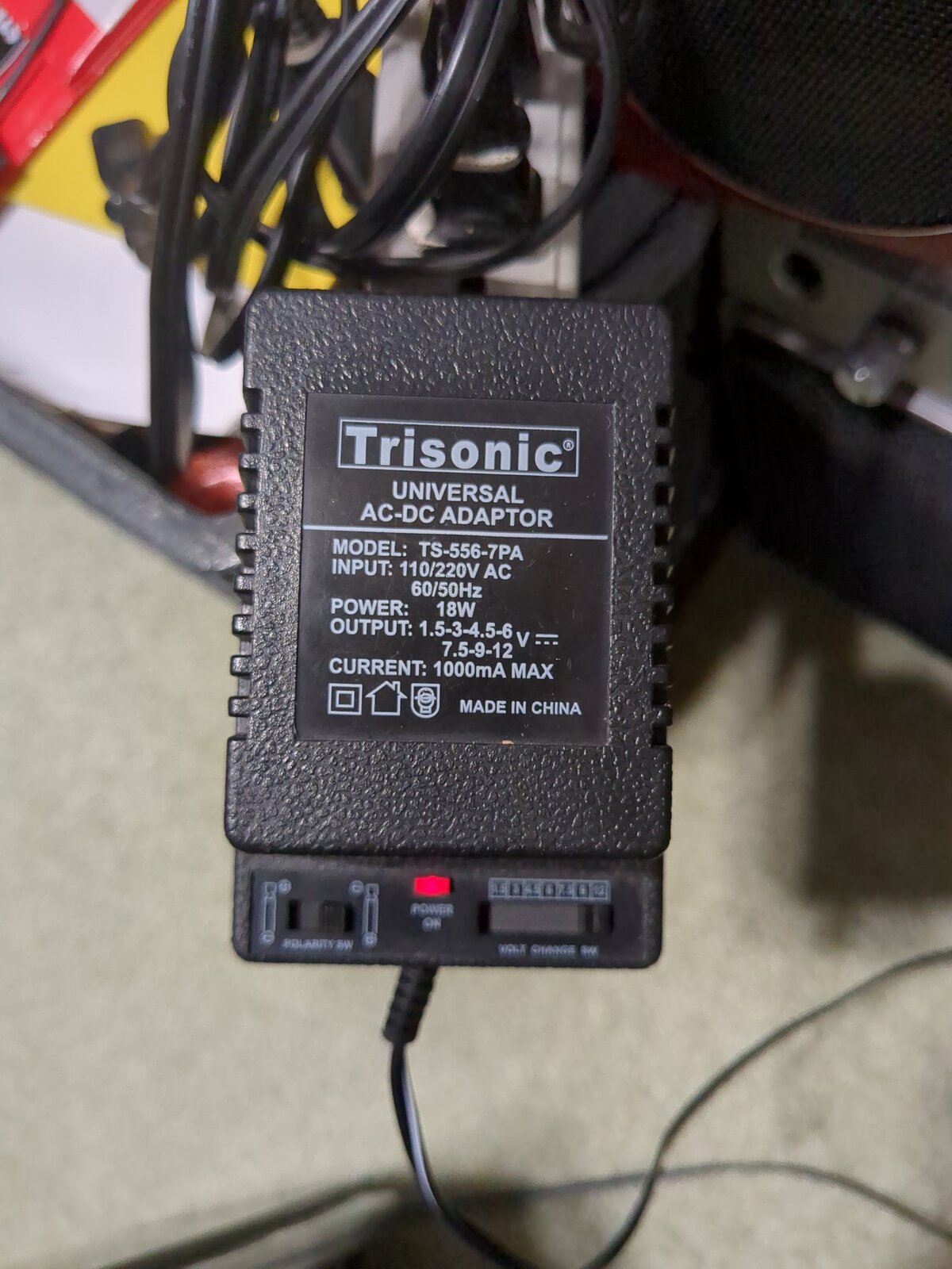

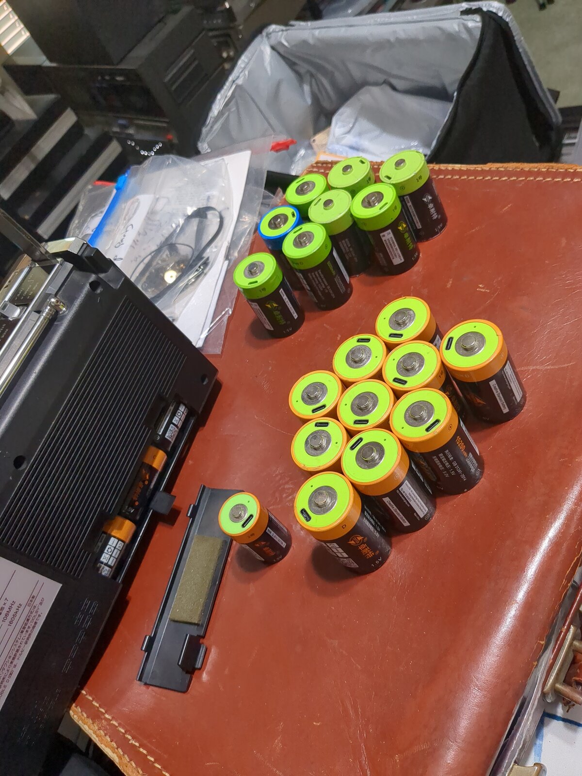

    I live in the USA where the voltage is roughly 117 volts these. That's what I measure it here. Sure you know that everything is built with a tolerance and the Japanese model products are no exception. They have a tolerance to accept USA voltage which is roughly 10 volts more or even 20 volts more without an issue of burning out the transformer by being too hot of a voltage. Now if you really have an issue with that and want to go through the nonsense of getting a step down transformer. More power to you, but I would rather simply get a AC to DC wall-wart and then simply use the DC input to power the radio that it has instead of using the AC input and going through all that malarkey with a step down when you don't need one. Or do like I do and power it with rechargeable D size Znter lithium ion batteries.
    That's Sanyo mr-u4gp uses 7c batteries just so you know.
    It works just fine.
    This is the AC to DC, wall-wart That I use and it Powers the Conion just fine.
