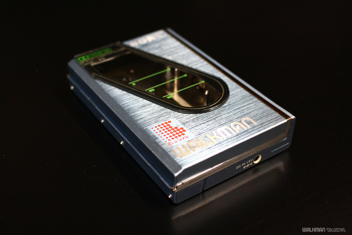

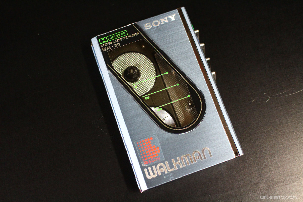

  7. buzbox
    buzbox Active Member
    459
    Australia
    Here is one I made for a blue wm 30 that I sold on ebay sometime ago. Not an exact duplication but very close.

    Printed. Created the image in Adobe Illustrator then reversed the image and printed onto the acrylic sheet. To cut it out I just manually cut it. I scored the edges and snapped them off. The rounded edge was tougher but got it as close as I can then I used a file to finish it off. Polished up the edges with a dremel tool to get the transparency. The chrome parts was the hardest thing to replicate. Took me ages to find something chrome. I was able to use some chrome vinyl (car wrap). Finally some thin double sided tape and presto!!!!
