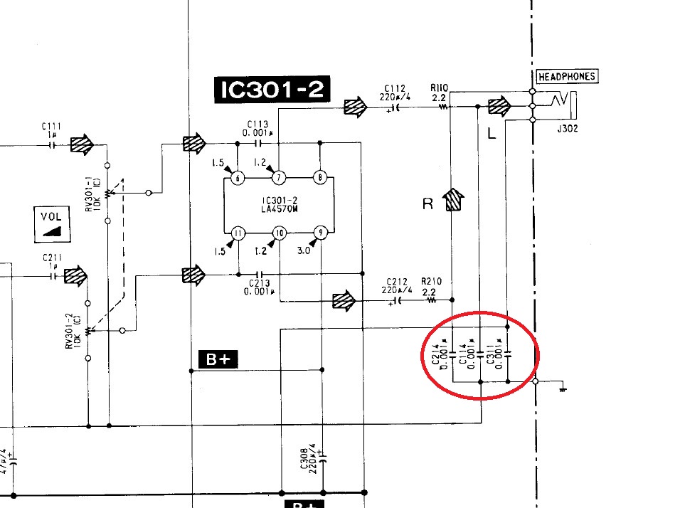

  15. Valentin
    1,531
    I was engaged in a discussion in another thread regarding a DD11 that has a different unrealted problem and I remember something that might be useful.
    There are 3 small ceramic SMD capacitors near the headphone jack and judgind by their capacitance and how they're wired are clearly used for interference supression.
    I think it is worth checking those are properly soldered onto the PCB or if there are any broken traces in that area. Also check the chassis connection, as I see one marked on the schematic that is clearly different than the PCB GND.

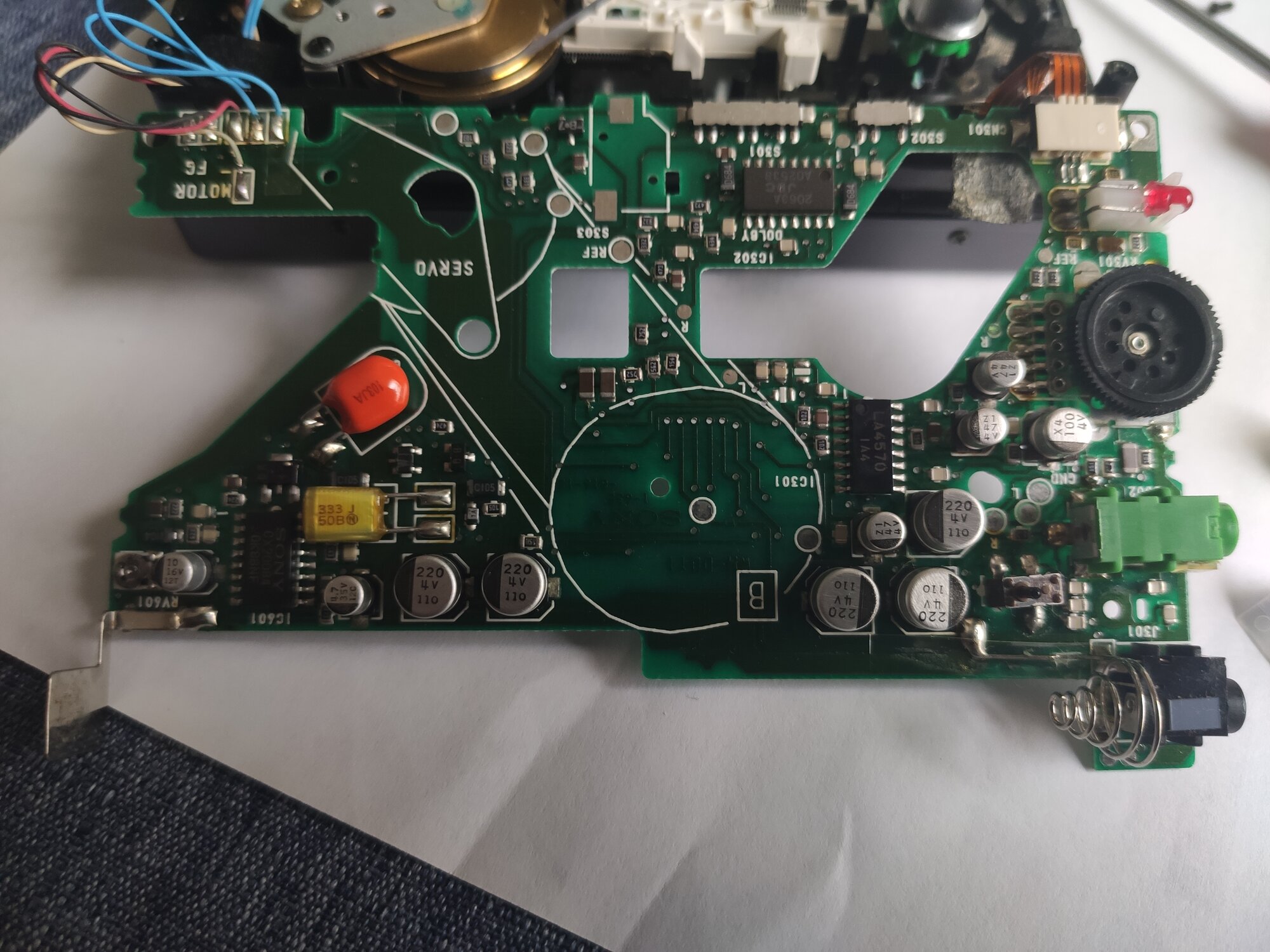

    They looked alright last time I opened things up, thankful to my past self I took a picture before starting work. Looks fine from what I can see, seems like it might just be the nature of the beast.
