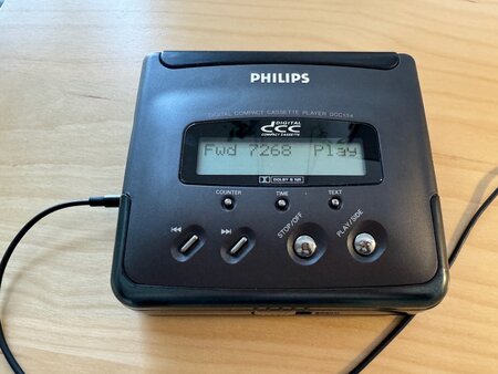

    Hi,

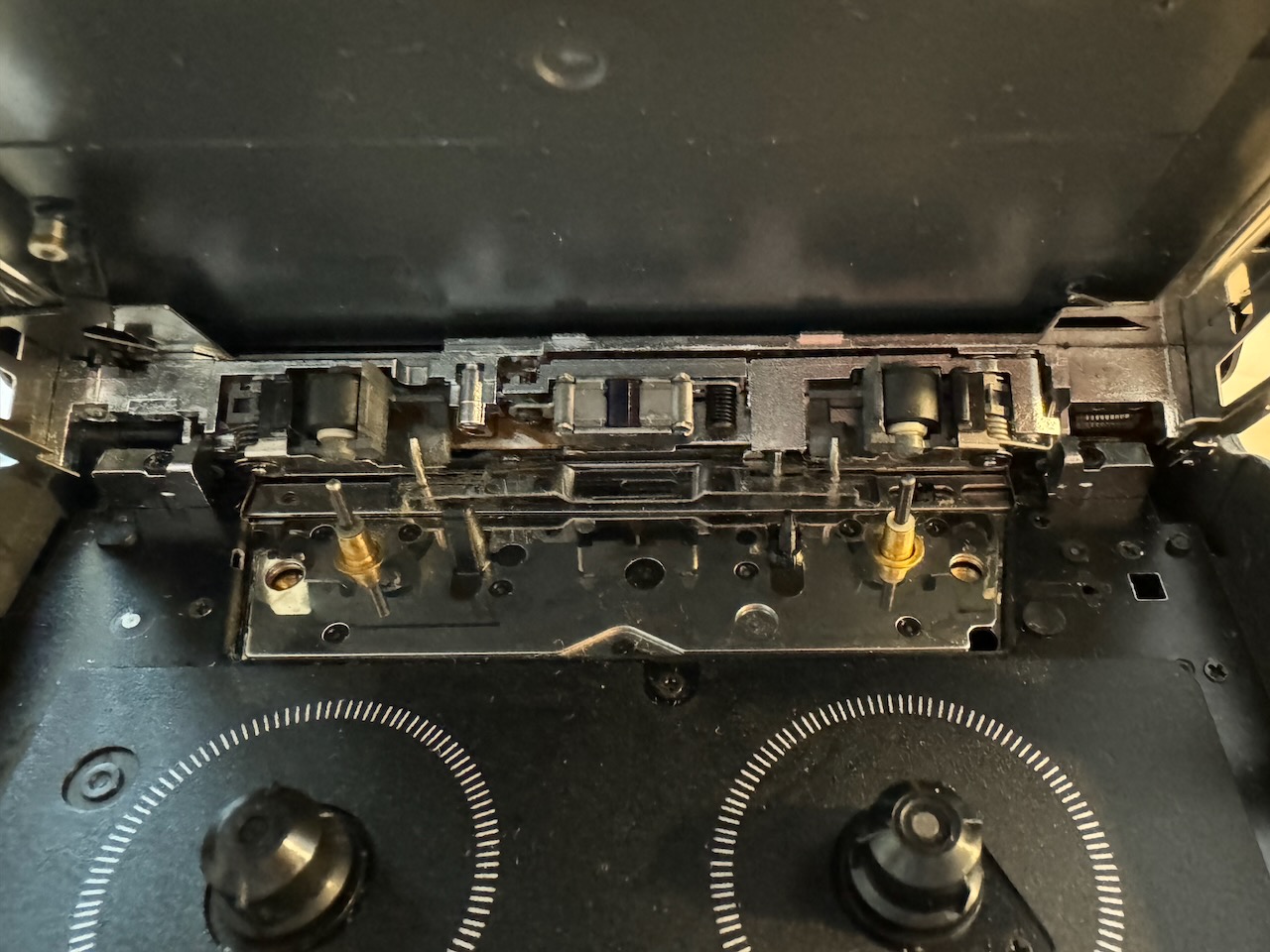

    Recently bought a non-functional Philips DCC134 for fun as I'm normally into walkmans/cassette. After belt replacement it works fine, a little high w/f but I haven't done any cleaning or lubrication yet so I'm hopeful it can be improved.
    It got me thinking though, is DCC a good/great cassette player or is the cassette compatibility a compromise? My initial impression is that it sounds quite good.The head is really different from cassette players.

    It depends from what perspective you look at it. As far as functionality goes, it will work just fine with compact cassettes.
    The wow&flutter figure may be improved by lubricating the rotating parts and eventually replacing the pinch rollers (they look a bit shiny in the picture).
    However, given these units use a Panasonic AR90 mechanism, I wouldn't expect them to get better than Panasonic RQ-S series in terms of wow&flutter.
    So if the reference w&f are SONY DD units (and it probably is given the units in your signature), just don't expect this DCC to get w&f below 0.1% WRMS, it's not gonna happen.
    For critical listening of classical music, it's probably a compromise if we look at it from this perspective. But we do have to keep in mind it wasn't designed for that.
    Problem is in regard to the head and head wear caused by compact cassettes. That's where I would be concerned.
    I watched DCC museum YouTube channel and the guy stated multiple times he doesn't recommend using compact cassettes in DCC units due to potential head wear.
    So what I recommend is watching this YT channel and see what tapes the guy recommends to be used in such units: think chrome ones but don't quote me on that.
