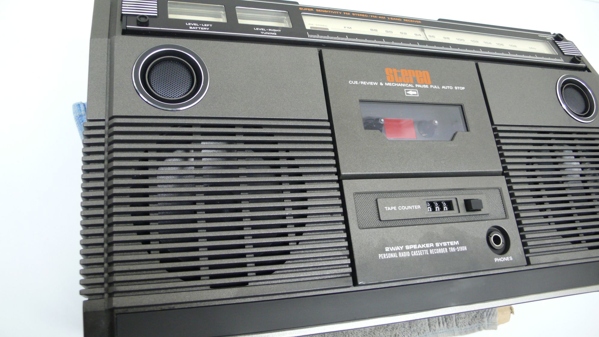

    Recently started a Hitachi TRK8190, belt change and service , it had never been opened , radio was fine .
    All went well , DRPS even came back to life after an alcohol paper pinch .
    All back together and the tweeters sound like they are on their own now , both radio and tape completely muffle unless full volume ..
    can’t see a pinched cable …
    Next steps from anyone with experience would be great
