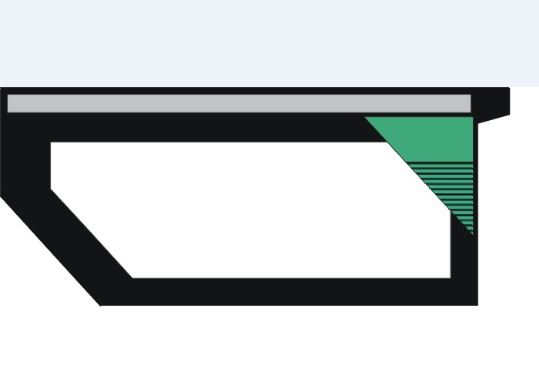

    I broke a WM-W800 acrylic window and am trying to design a new window for it to look exactly as original one.
    I talked to some people who can easily cut the acrylic part with laser and print on on it using a UV flatbed printer.
    So i am trying to design it myself and I got all the measurements but i need advise on what font to use for the writings on acrylic:
    The green color is obviously different and i will choose a better color
    Also any advise on color code is highly appreciated.

    Looks really good so far , maybe with a good photo of the green part of the original window take a color sample , with something like photoshop ,and then use it to color the relevant part to your prototype design above.
    The laser cut window won't have the originals curved edges but I guess it's a small price to pay than having a broken one.
    A much easier method would be to scan the entire window and then print it in 1/1 scale , not sure though about the quality of the scan as ( I think ) the original window is back printed.

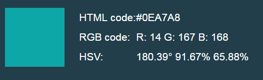

  3. Boodokhan
    2,476
    Thanks
    I use Corel Draw which is extremely powerful software for design.
    I also use https://imagecolorpicker.com/ to pick the right color (or the closest match to actual one).
    I will keep you updated. If I get lucky and make it appealing will send you one for your walkman. The problem with this part is must be design in 2 different colors, 2 different shape to cover all WM-W800 acrylic window.

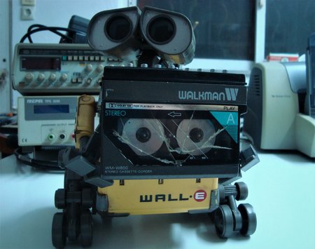

    Thanks Boodokhan really appreciate it .:) Indeed there are A and B side windows and the tuner versions.
    Below Wall-E presents the nasty damage , A-side tuner version.

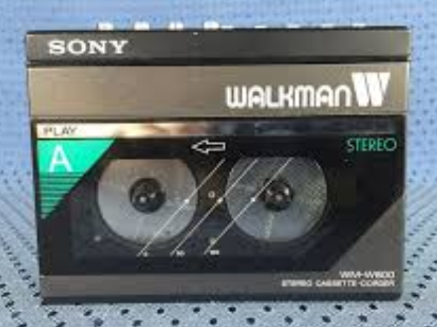

    the design is almost completed and next week I will go for laser cutting. So far I have the closest color matching:
    The problem with the silver part is on original acrylic this is very close to chrome pattern and by printing it loses the shinny feature, So I have to print one to see how it will look like
    will keep you guys updated

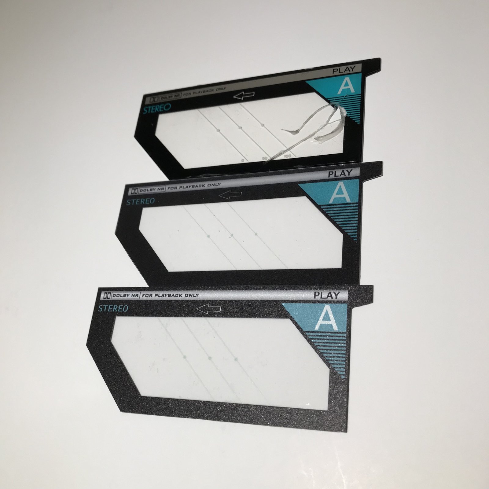

    My first experience on acrylic design is here. It gives me a lot of idea how to improve the quality of work. The top one is the actual one taken from W800. The other 2 are printed version
    The difference between the middle and the bottom one is the key to a better and more closer to ideal design
    As you see the bottom one is not shiny since the design is printer on top of the acrylic sheet but on middle one mirror image is printed (actual print is on the bottom surface) 3A9096A8-741A-42EB-9195-2CB2B888BA82.jpeg
    I need to work a little bit more, to make it better

    I think the middle one would be the right way to go? It's the side that's printed on the original one as well right? You get the shine of the acrylic and the print's protected from wear.

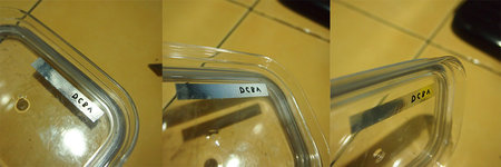

    For the silver bit, might I perhaps suggest leaving it blank, just printing the black text. Then sticking some shiny silver sticker/foil from the back side. Like so: P1016905.jpg

    The middle one, resembling the original method of printing from the back aside the shiny look has also the benefit that the print is protected from scratching off the colors while using the walkman , potential (minor) scratches on the acrylic can easily be buffed out while leaving the print intact.
    For the silver part Sony probably used mirror effect silk screen printing :http://www.seikoadvance.co.jp/en/pdf/sp/emirror.pdf

    the final print definitely will be a mirror image one. I would like to make it everything by printing and not to use any chrome sticker on the back ( I might do one just for a comparison).
    Next step is to find the appropriate glue not to affect the print/ design. Since the final print will be on the back of acrylic and glue can destroy the pain/ print. Anybody has any experience/ recommendation???.

    Nicely done. Using the same printer I used when I made the window for the WM-30. If that printer has High Definition mode then the text will be a lot sharper. Takes a lot longer to print but better result. As for adhesives I would simply use thin double sided tape with high to medium tack.

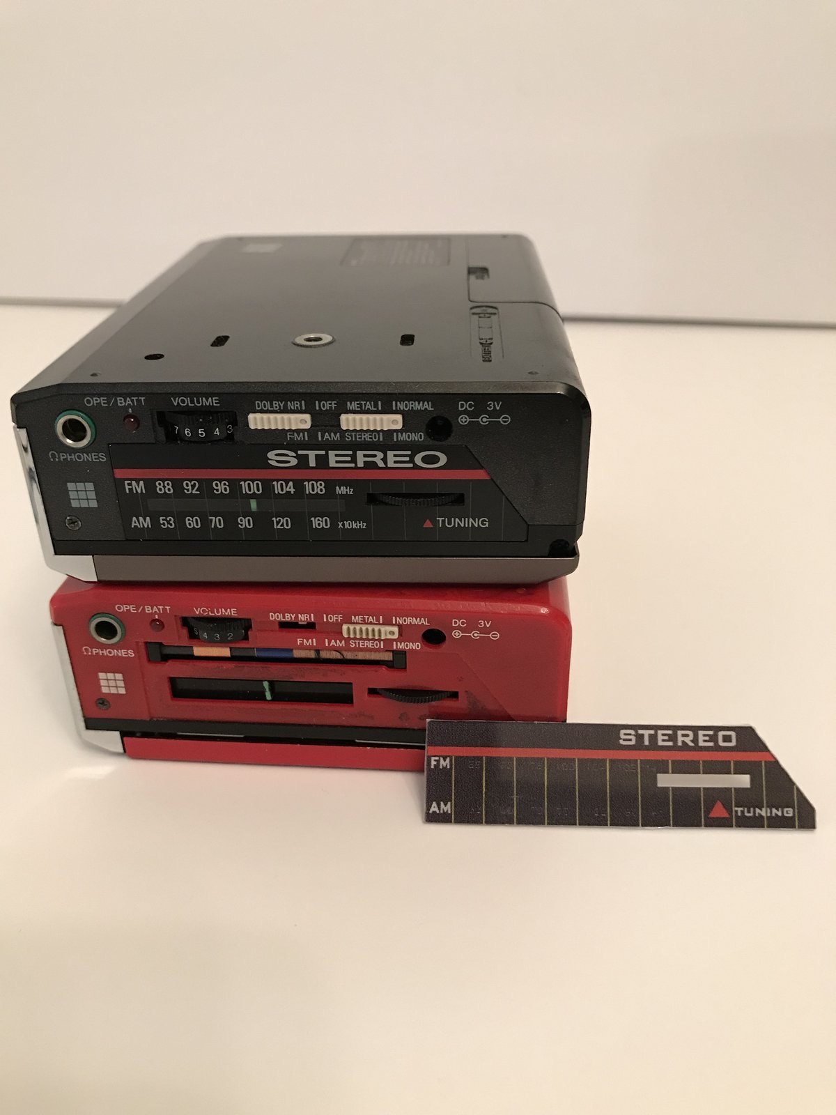

    This one was an easy design but the writing needs some modification
    Red walkman missing the acrylic. See the top one which has the original acrylic and i designed it based on that one but choosing yellow color and thin font was not a good idea. So i have to go with original color/font and use the mirror image to be shinny
