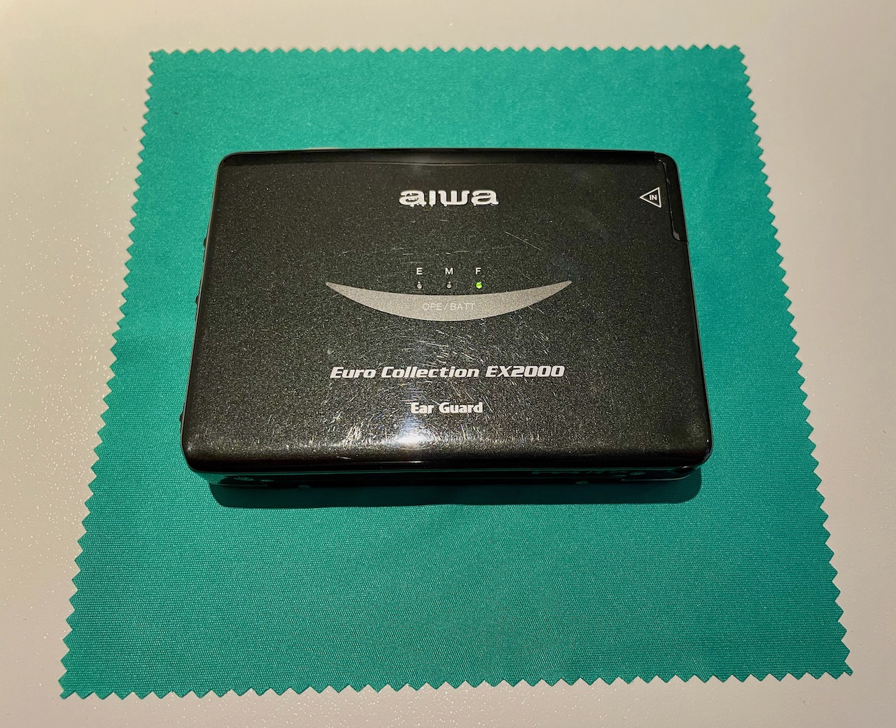

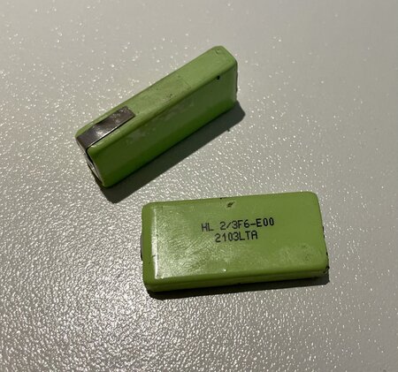

    I found that the smaller gumstick batteries are hard to obtain nowadays (July 2021). After a bit of (re)searching I ordered a non-branded Siemens Gigaset (cordless phone) replacement battery from Amazon.
    Link: https://www.amazon.nl/gp/product/B005NINQDC/ref=ppx_yo_dt_b_asin_title_o00_s00?ie=UTF8&psc=1
    As soon as I received the package I removed the first protective layer of plastic and low and behold, 2 of the right gumstick batteries.
    Also note I taped the lead that was soldered to one of the batteries in place to make better contact with soda can (-) lead.
    Happy to have my old Aiwa HS-EX2000 up and running again without external battery case or adapter.
    See the tiny green LED, it is lit! Still the fingerprint magnet, hence the piece of cloth.
    For around 6 euros, I’m a happy camper :)

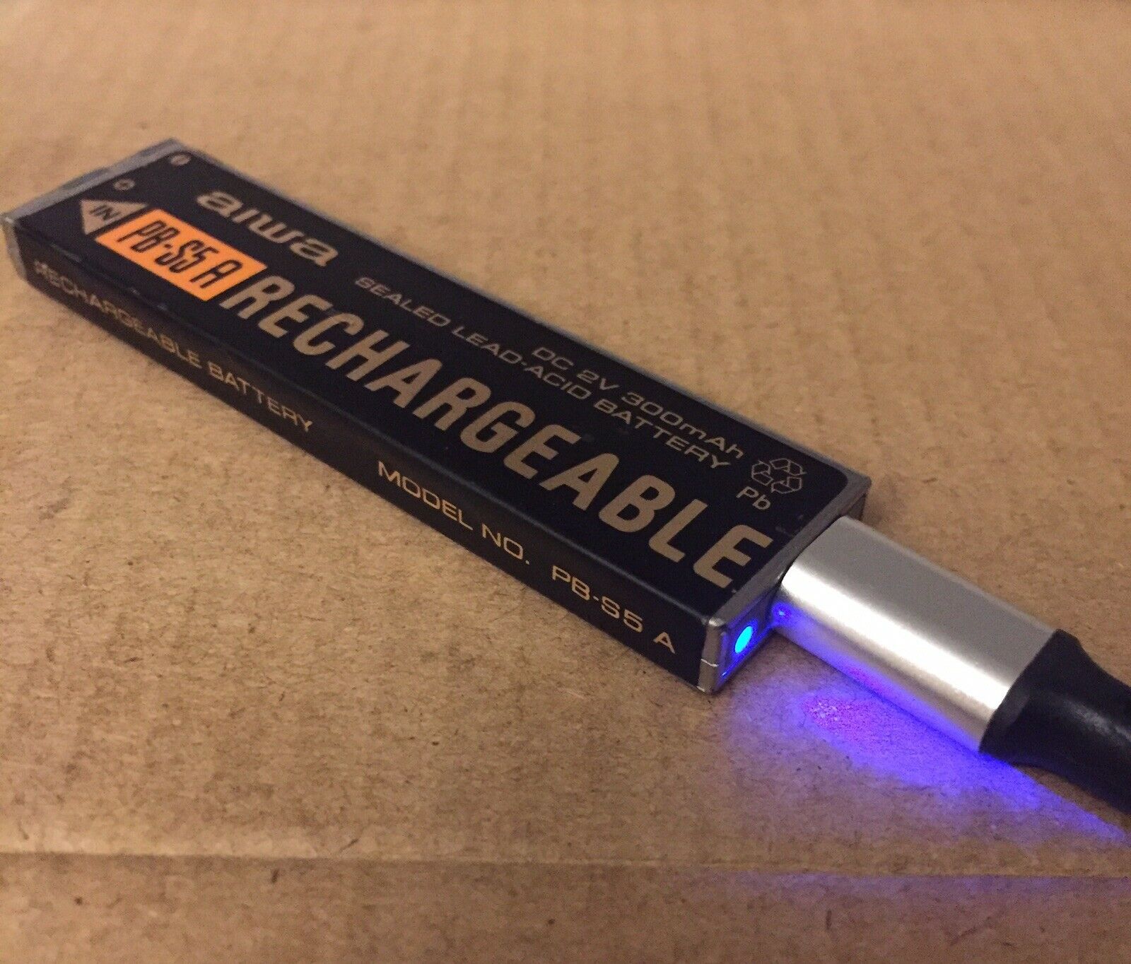

    Nice to see, that my mod from over 10 years years ago will be still repeated.
    Here is the original thread from 2011 which lost most of the pictures:
    http://www.stereo2go.com/topic/index.php?content_oid=228719286779384460&board_oid=193392314111653425
    But I posted it also in a German forum, which still has all pictures:
    http://www.hifi-forum.de/viewthread-125-7223.html

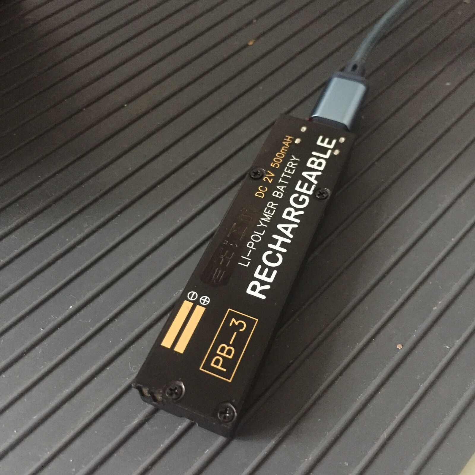

    I use both mods for PB-S5 and PB-3 still today and non of my Walkman's got damaged because of slightly higher voltage.
    But meanwhile there are new built replacement batteries avilable. For PB-S5 and PB-3/4. They come from Singapore and can be charged per USB.
    https://www.ebay.com/itm/284597122696
    https://www.ebay.com/itm/284597097468
