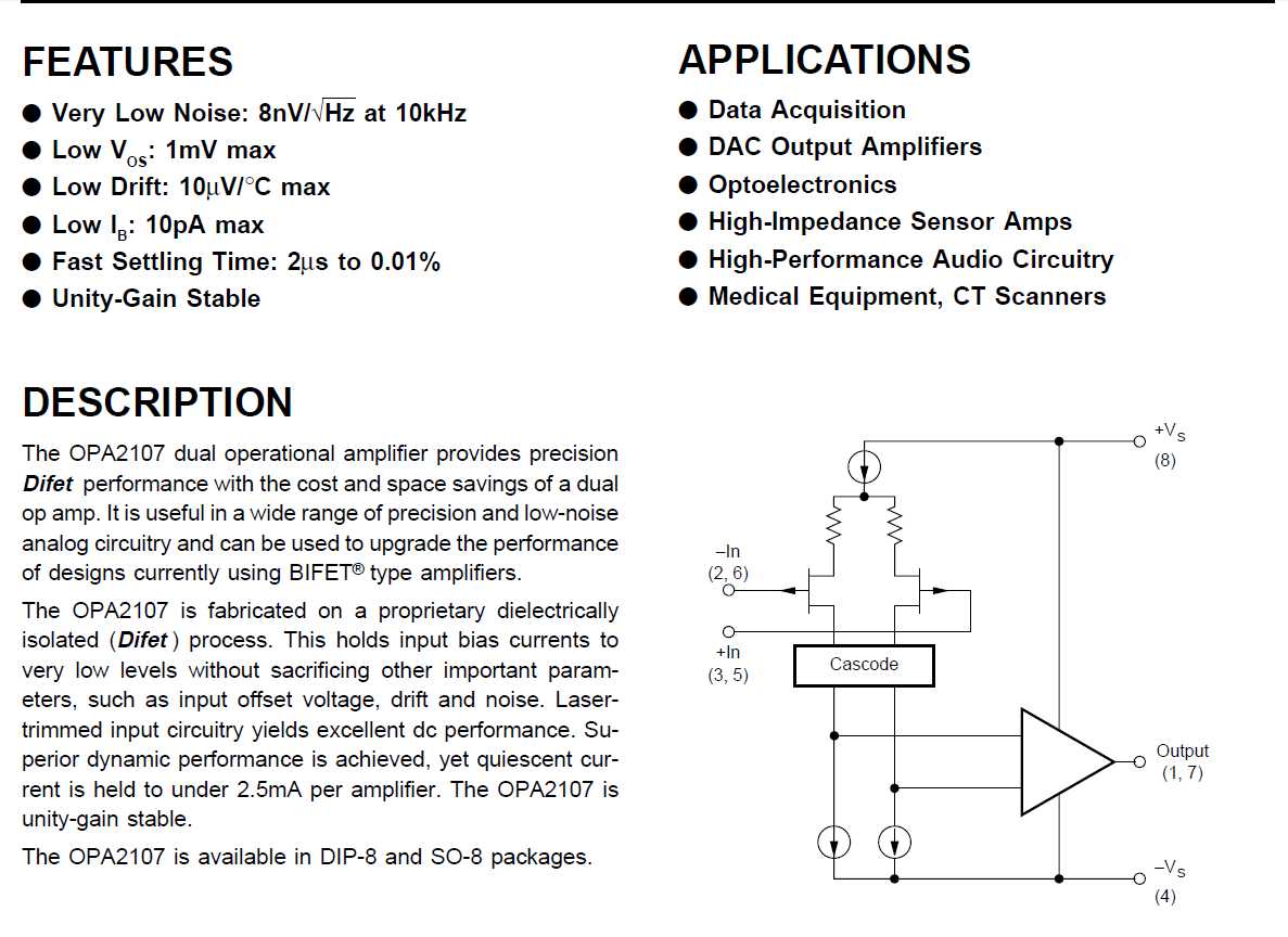

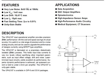

    Datasheet says a few words about its better specs, laser-trimmed resistors:
    Sooo, I am willing to try it on some of my hi-end Discmans

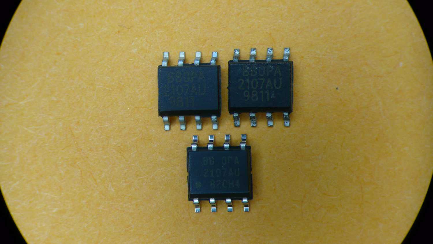

    BUT: there are some choices here. $29.06 from Digi Key, $12 off US seller on eBay, $1.50 (+$4.00 s/h) from China. $12 from "US seller" whose English is even worse than mine had never arrived, and below is the photo of one bought from DigiKey (bottom) + two from China (on top) OPA2107:
    Is there any way to check (except for actual listening which I am going to do!) that $1.5 Chinese chips are exact copies of the 'real thing'?

    In the picture you posted, all 3 parts seem to look a little bit different, but the 2 on the top seem more similar than the bottom one. Of course, simple judgement will tell you the DigiKey one is the most likely to be the genuine, but that's also the most expensive (too expensive in my opinion).
    What I would do is buy a sample from DigiKey and compare it to the one sold on ebay. In terms of font used, how the capsule looks, if there is any color difference, markings on the back. Keep in mind different batches may have small differences, but nothing too significant.
    The Chinese one I would exclude becuase the price is just too low to be true. That one is fake for sure in my opinion. Chinese even manufacture counterfeit versions of the Sony CX20084, which is very requested (a genuine one costs about 50-70euros, Chinese sells them 20$/5pcs).
    Note that the price on TI's website is $11.16/pcs (in 1000pcs+ quantity), but it is out of stock. So the ebay seller does actually pretty good in terms of price, if the ICs are genuine.

    Even from packages it can be difficult to tell. At work we had some Maxim parts that wouldn't work in one of our designs.
    The package and writing were noticeably different from the ones we had used in the prototypes. I sent some to Maxim fully expecting them to be fakes.
    To my surprise Maxim said they had tested them and couldn't find any problems with them ! I suspect they were made by Maxim but in a different fab using a different process. At least the difference in markings meant we could tell which parts we needed to fit to make working boards.

    frankly, I did not expect to see any differences between $1.50 and $30 chips: it is easier to fake the shell than 'laser-trimmed input circuitry'. Did not expect to see any rust either. I am pretty sure they work as op-amps, but I am not going to waste any more time on them
    Exactly! I have no idea how to measure, and in this case even I wouldn't trust my own hearing
