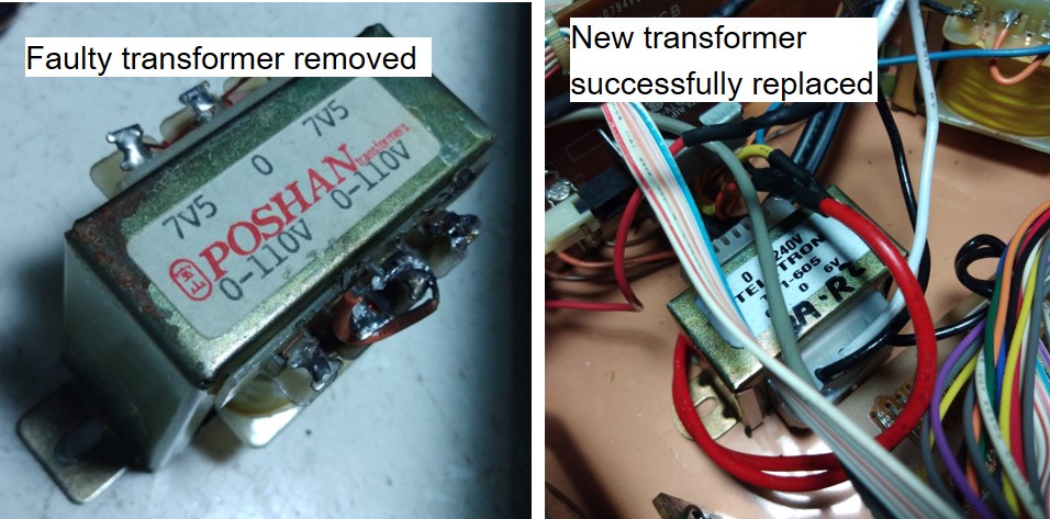

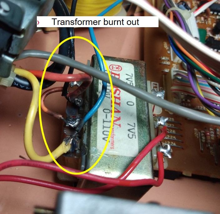

    Got this unit from my cousin last 2 weeks. Very unfortunate due to over excitement, just can't wait to test the deck and not aware that the unit was actually configure under US AC power. Apparently my country AC power is sourced at 240 VAC and guess what the unit just blow up and trip off the circuit breaker of my house.
    The 2nd transformer was safe lucky though as the circuit breaker fast enough to cut-off the power. But I need to reconfigure it for 240VAC.
    Finally the deck was successfully restored, it was fortunate that the control board was not damage.

    that is amazing, that the deck, intentionally or not, protected itself from the voltage by burning the transformer...
