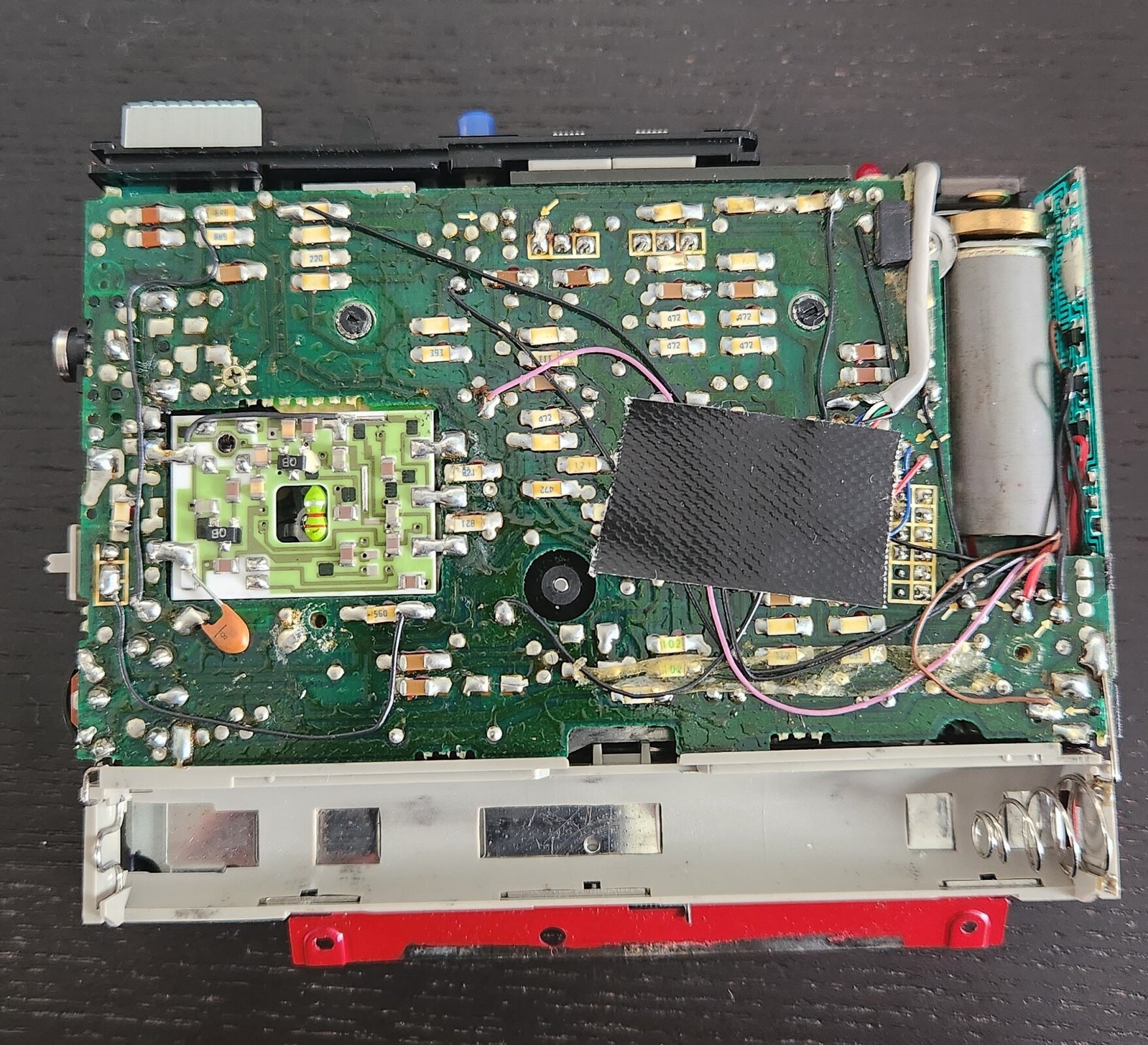

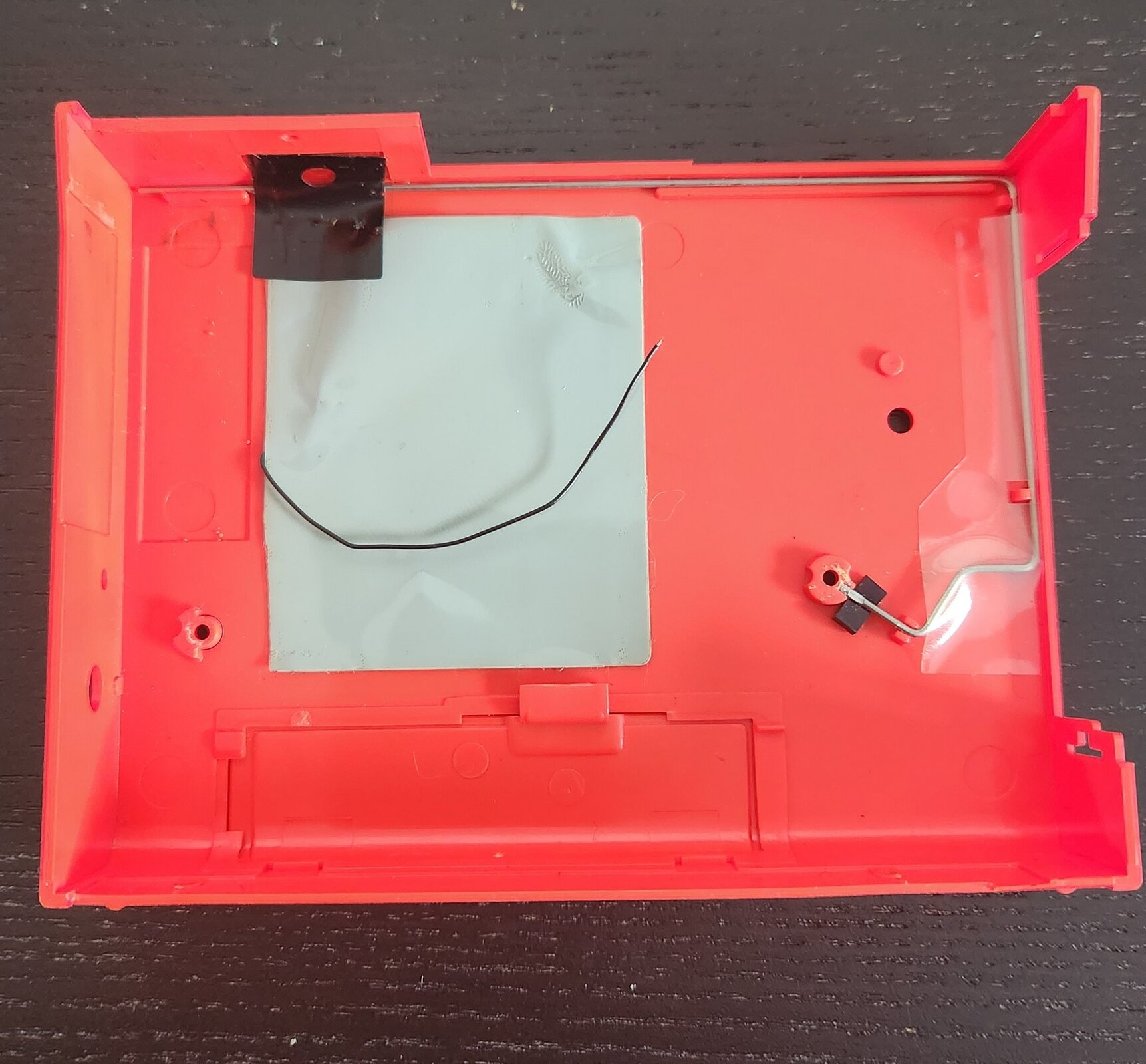

    Thanks T-ster for the info re capacitors, so far so good, the aiwa hs-p3x is working after changing belt its playing etc, just need to find where to solder the black wire connected to the rear case as it came loose.
  4. T-ster
    1,455
    Yeah I dont have a manual for that one either and I cant find one, will be worth throwing up a pic of the board/wire as Im sure we can figure out where it goes.
  5. rappzy
    rappzy New Member
    Luxembourg
    Hi T-ster,
    taken some pictures and uploaded. I am guessing and its only a guess that the black wire from the back plate should be soldered top middle of the circuit board where there is a gold arrow only because the solder blob below the arrow there looks different to all the others I prefer actuals to guesses though. Ideally need someone who has a p3x they can open and post a pictture with wire connected or the manual to be 100% sure. My feeling is that the black wire completes the antenna loop that you can see turns into a bar which is connected to another point on the pcb when the case is screwed in. I know the fm transmitter is working but you need to be darn close to pick up the signal and the little black wire is the key I think , or I could be completely wrong and its just an earth!

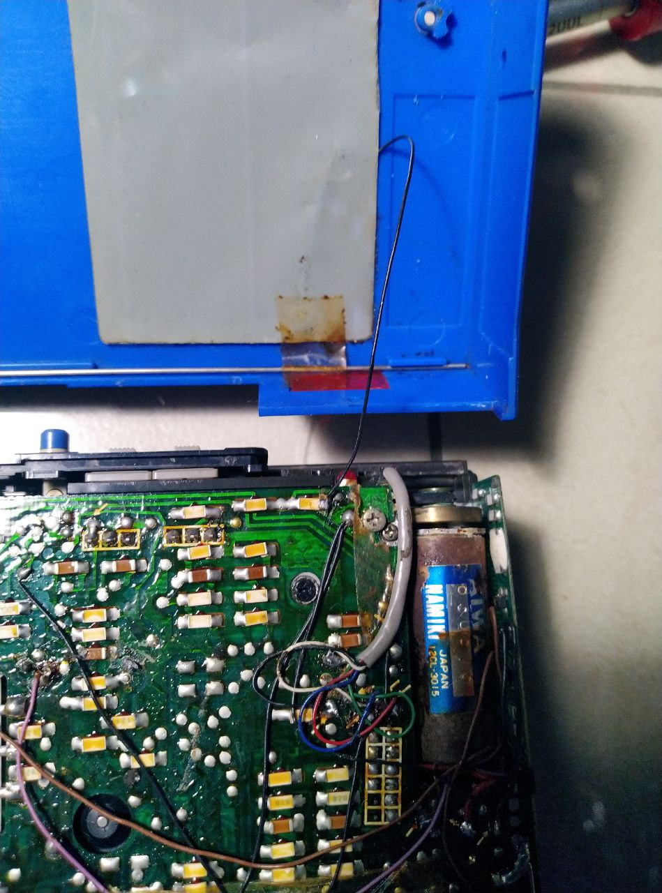

    Glad I could help! I't's been a while since I last held this one, but I managed to find it and took a peek inside.
    On mine the wire's connected to a point near the LED indicator light. On yours, there's already another wire there, but on mine that wire is connected on the same point as the other black wire just beside it.
    rappzy likes this.

    Oh wow, you sir are a super star, thank you so much, grabbing soldering iron right now
    stuck-in-time likes this.
  12. rappzy
    rappzy New Member
    Luxembourg

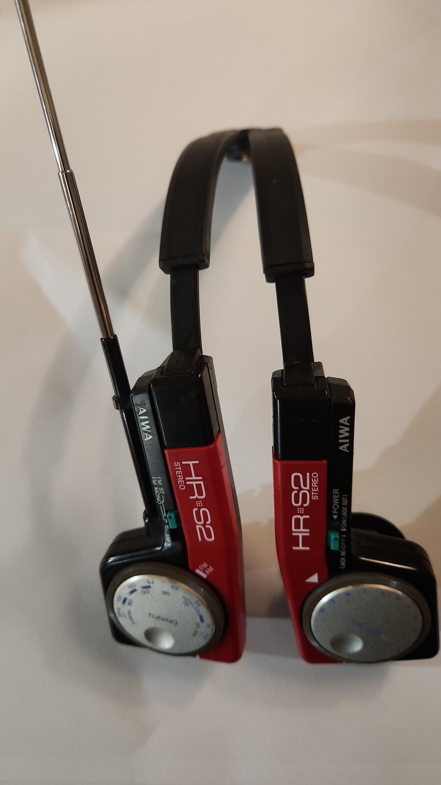

    Now working with it's original headphones, need to find someone who is good with fm transmitters I remember the range of the Walkman being better but that was 40 years ago and we are spoiled with Bluetooth etc nowdays
