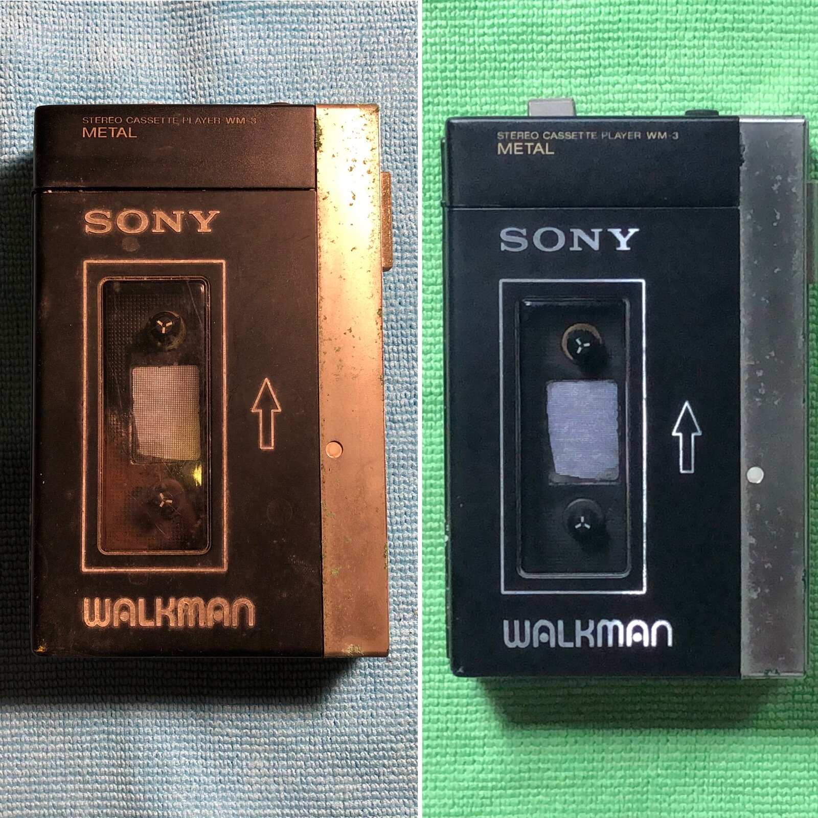

    9A103B78-EA0E-4404-96C8-3EF3DC17F32D.jpeg Hello! I am new to this platform. My main goal is to help anyone who needs help restoring Sony Walkmans. In particular the WM-3 and TPS-l2. These early models don't have much information of the internet and I found it very difficult to find such information to fix my WM-3. So after restoring my wm-3 and learning a lot of thing from it, I am happy to help!
