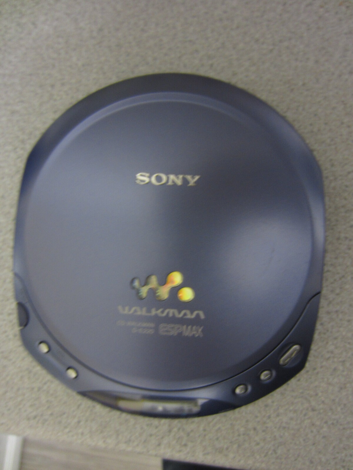

    Personally I like the newer players like the D-E220.
    Do you realise that ESP can degrade the sound quality as the audio isn't kept in the memory at full CD resolution ?
    One thing I like about these players is that you can turn the ESP off and even then they are very shock resistant. Much much better than my first portable CD player that was a Sanyo.
    Another thing I like is the battery life that is much better than the earlier players.
    I'm not sure if they were ever made in a non metallic finish though. The one I have to hand is a Blue-Grey Metallic finish.
    The best thing about this one was that it only cost about £5 at a car boor sale

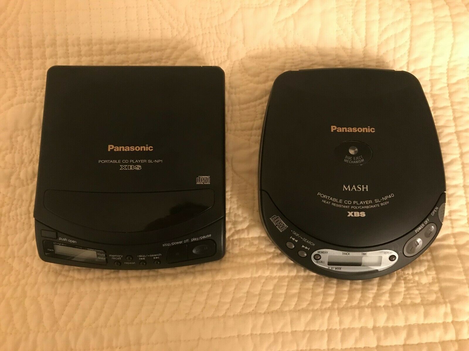

    In terms of fit'n'finish Technics/Panasonic polycarbonate bodies have much more 'expensive' feel than Sonys. I am watching this listing: Panasonic (Technics) SL-NP1 & SL-NP40 Portable CD Player (2 players, both work!)
    Good example of 16-bit and 1-bit DACs side by side. Without ESP or '10-sec Memory' so sound quality is decent.
