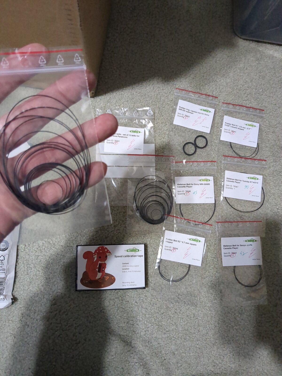

  5. Cassette2go
    1,537
    If you get the belt assortment from fix your audio, you might get a smallest belt that you might need. I don't know. Here's what I got 17334199882103244401499764920846.jpg
