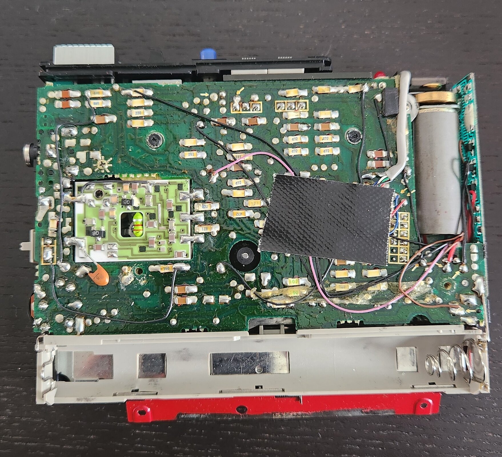

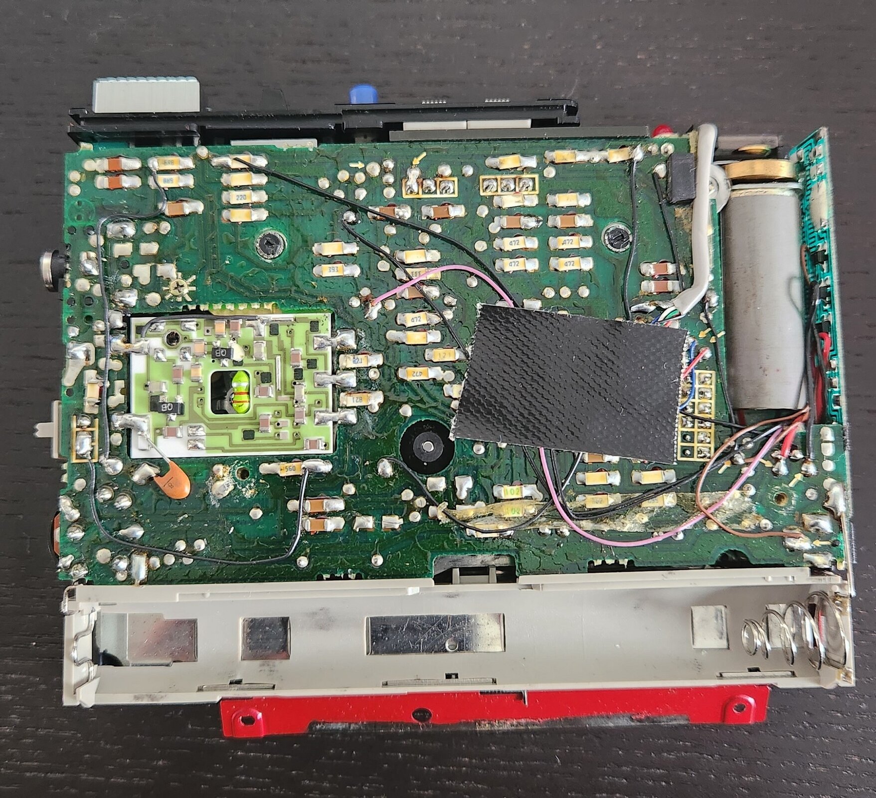

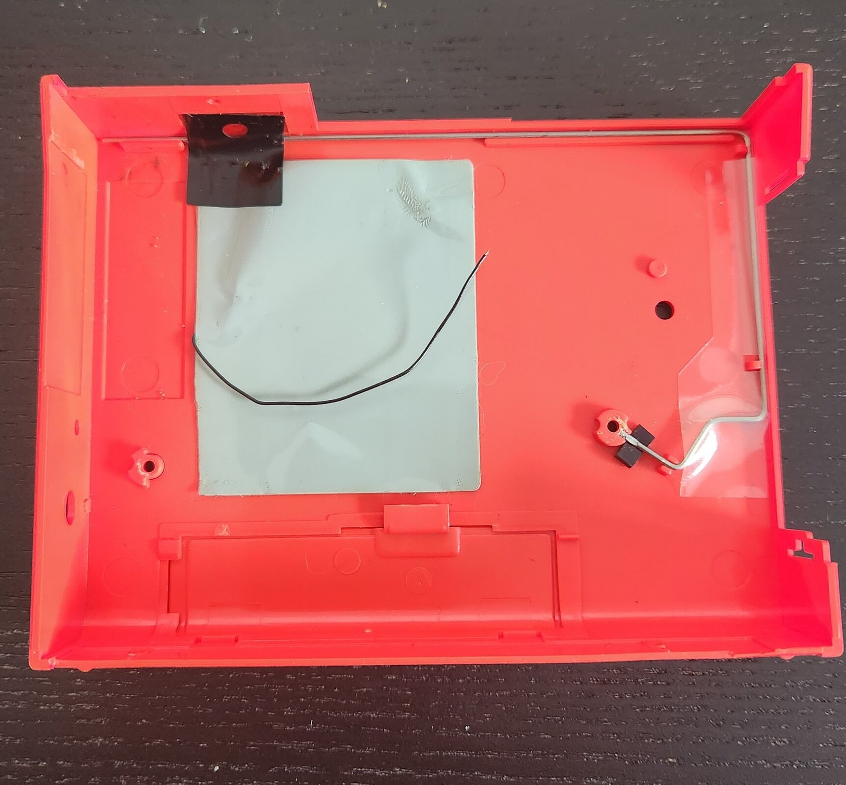

    Hi all,
    Back story i'm getting old and feeling nostalgic so my father collected all my electronics stuff up in the loft and posted it to me as part of my bday present, that obviously led to work of cleaning and replacing drive rubbers etc.
    The Aiwa HS-P3x has one loose wire which connects from the rear case where there is an aerial loop to the pcb.
    I cannot find a manual, been scouring Buyee.jp and youtube just incase someone has opened one up and it shows the pcb pin to solder too no joy. I had enough fun working out which drive rubber I needed found out the internal drive mechanism is exactly the same as a HS-J02 so that is sorted .
    So i am after some knowledge and or wisdom, manual or picture of a HS-p3x with the rear cover removed with black wire still attached to pcb if anyone has any info would really appreciate it. Please see pics of the
    unit, can post more if needed.
