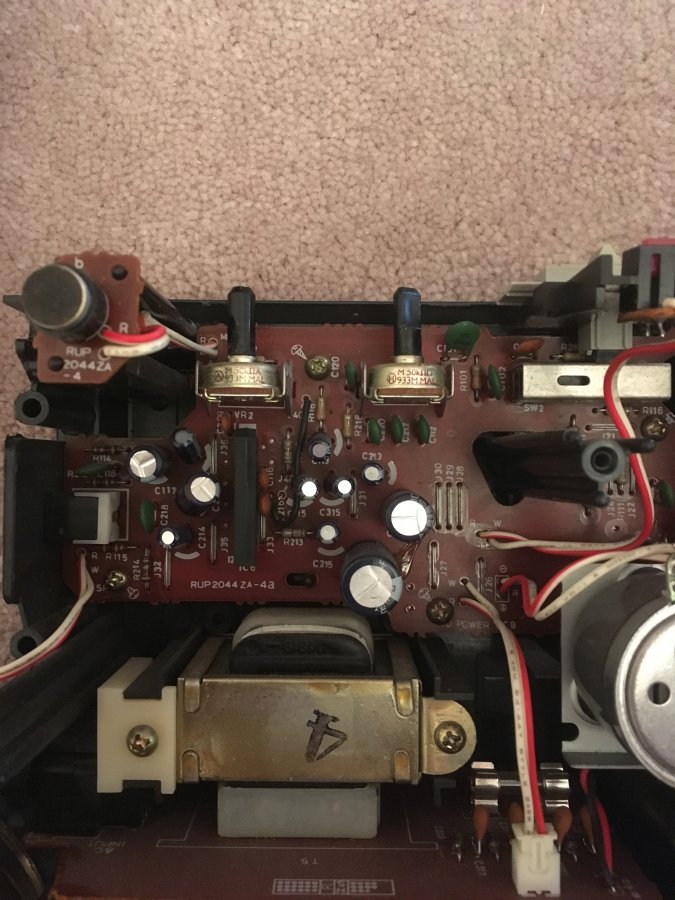

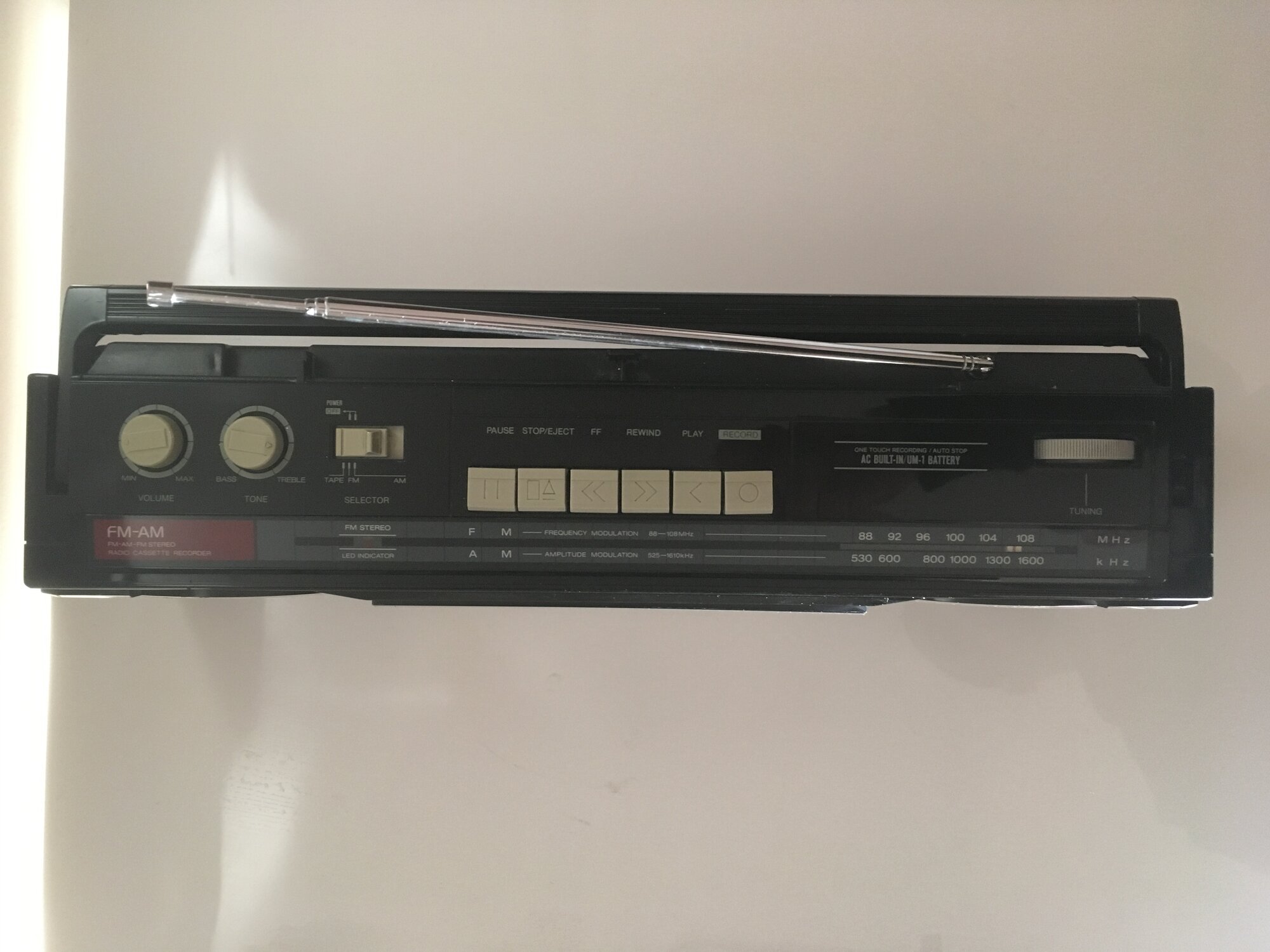

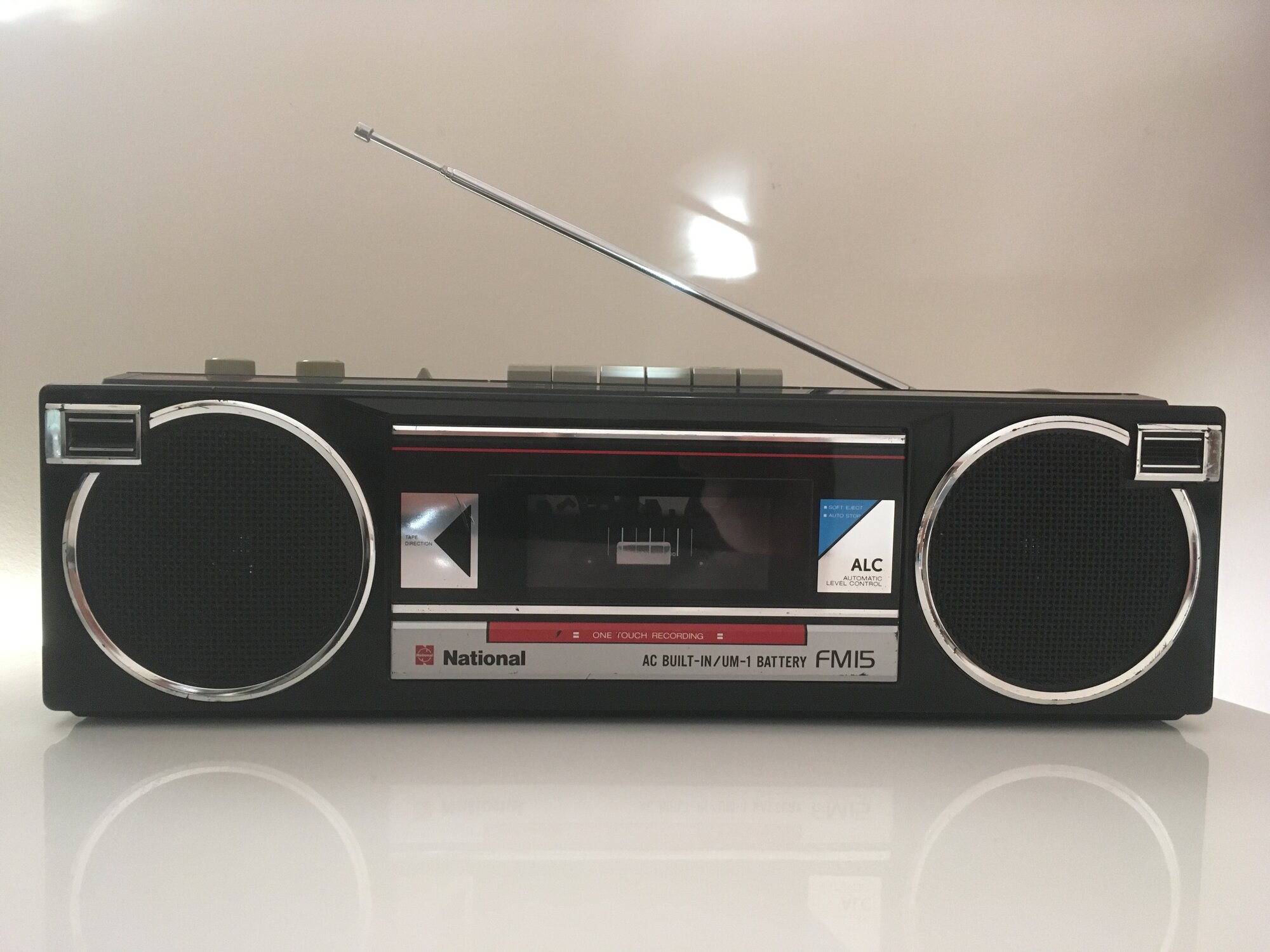

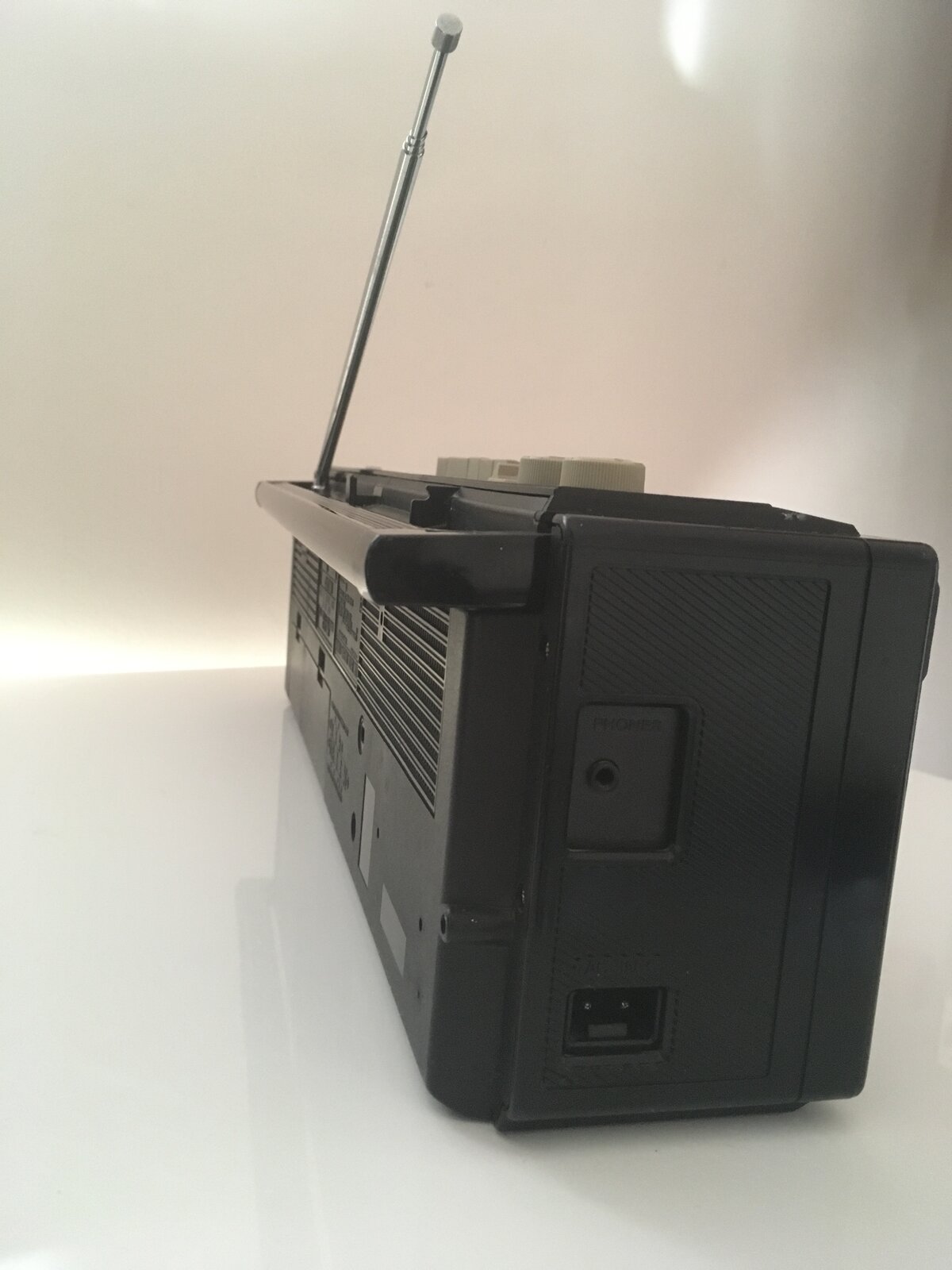

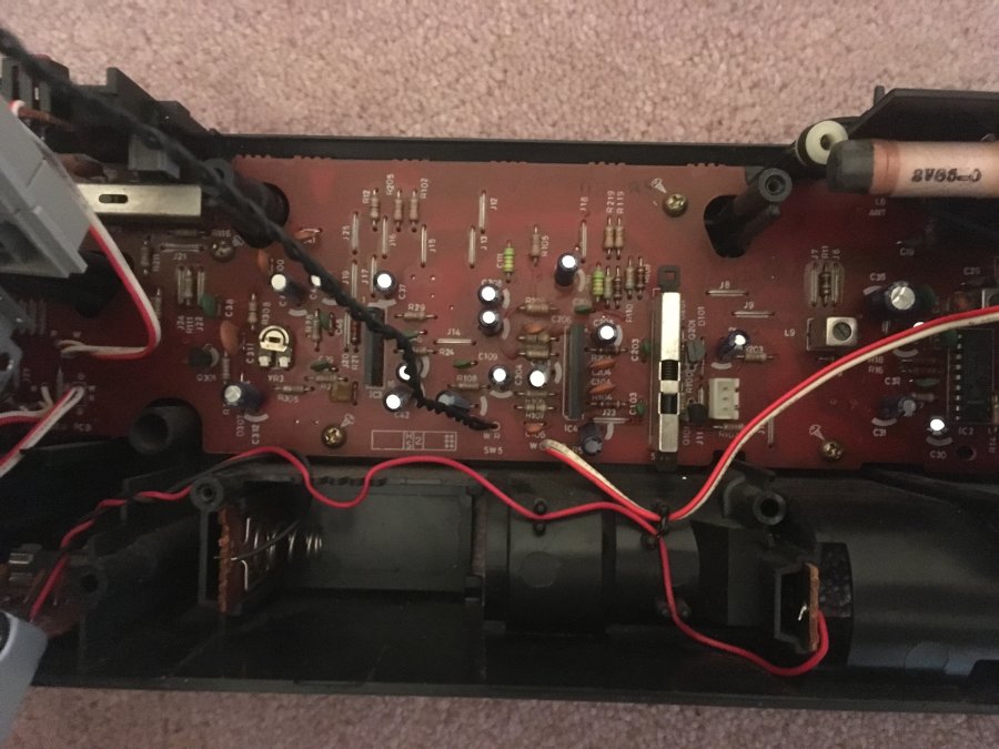

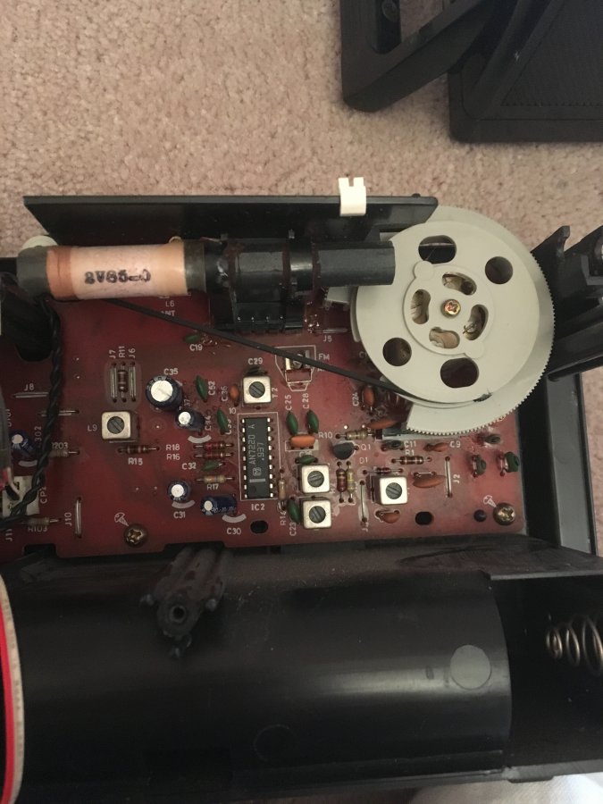

    Hello everyone, I recently picked up a National FM15 boombox.
    I replaced the belts and gave the machine a good clean and it plays cassettes like it new, however when I record of live broadcast and play the tape back it sound's very low and distorted.
    I temporarily replaced the head with a similar one from a Panasonic RX-CT800 which recorded well before it died with a brand new blank cassette and got the same result.
    I have posted a few photos of the boombox and internal board.
    Anyone have any ideas on what else could cause this issue in a cassette player?
    IMG_3406.JPG IMG_3407.JPG IMG_3408.JPG 5EF1C623-5EC3-4830-A4BE-2D474E7A65D8.jpeg 23A3F979-63AE-43F7-927C-CDED8A371AFE.jpeg DA2F8E31-C62E-4BF1-BC20-CD8C46CE02A7.jpeg

    I headed to Bunnings this morning and picked up the WD40 specialist contact cleaner and cleaned in the following order to try find out what is causing the problem.
    Cleaned the Tape/FM/AM switch a few times while moving it from side to side
    Cleaned the Record switch behind the tape mechanism while moving it up and down
    Sprayed all over the board front and rear
    Checked caps on board (everything looks good)
    Replaced head with one I had not tried before
    Changed back to the original head
    Recorded my voice through the mic (no difference)
    Is there anything else you would try?
